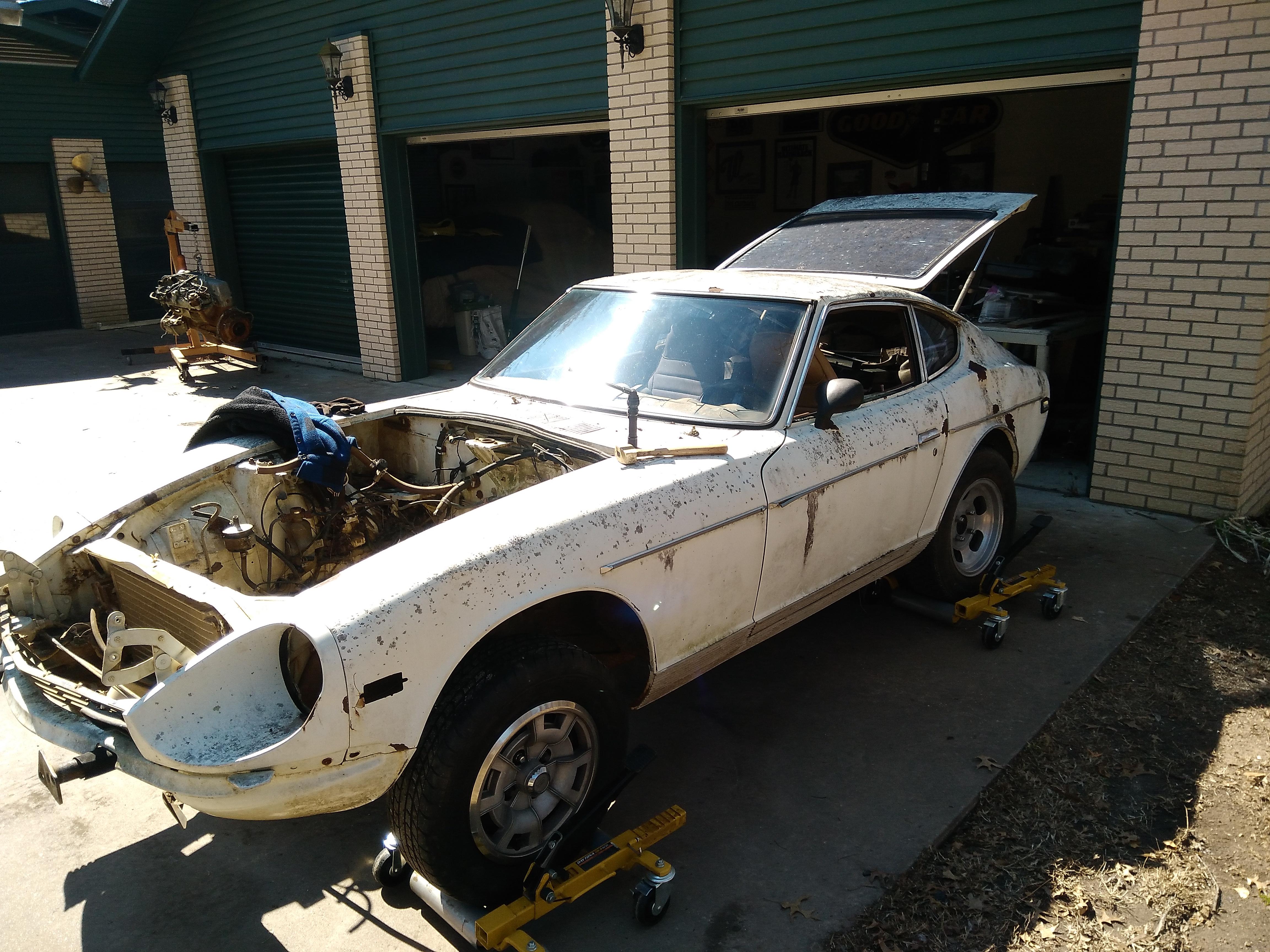

My plans are to get it out of the driveway as soon as possible!   Just mainly the glass left to come out.
Do you want your commision sent to your usual off shore account or added to your Zcon beverage budget?   LOL
You are the man, man. 3 car garage with a Z in front. I recently read that's a sickness like a @Diseazd. LOL
