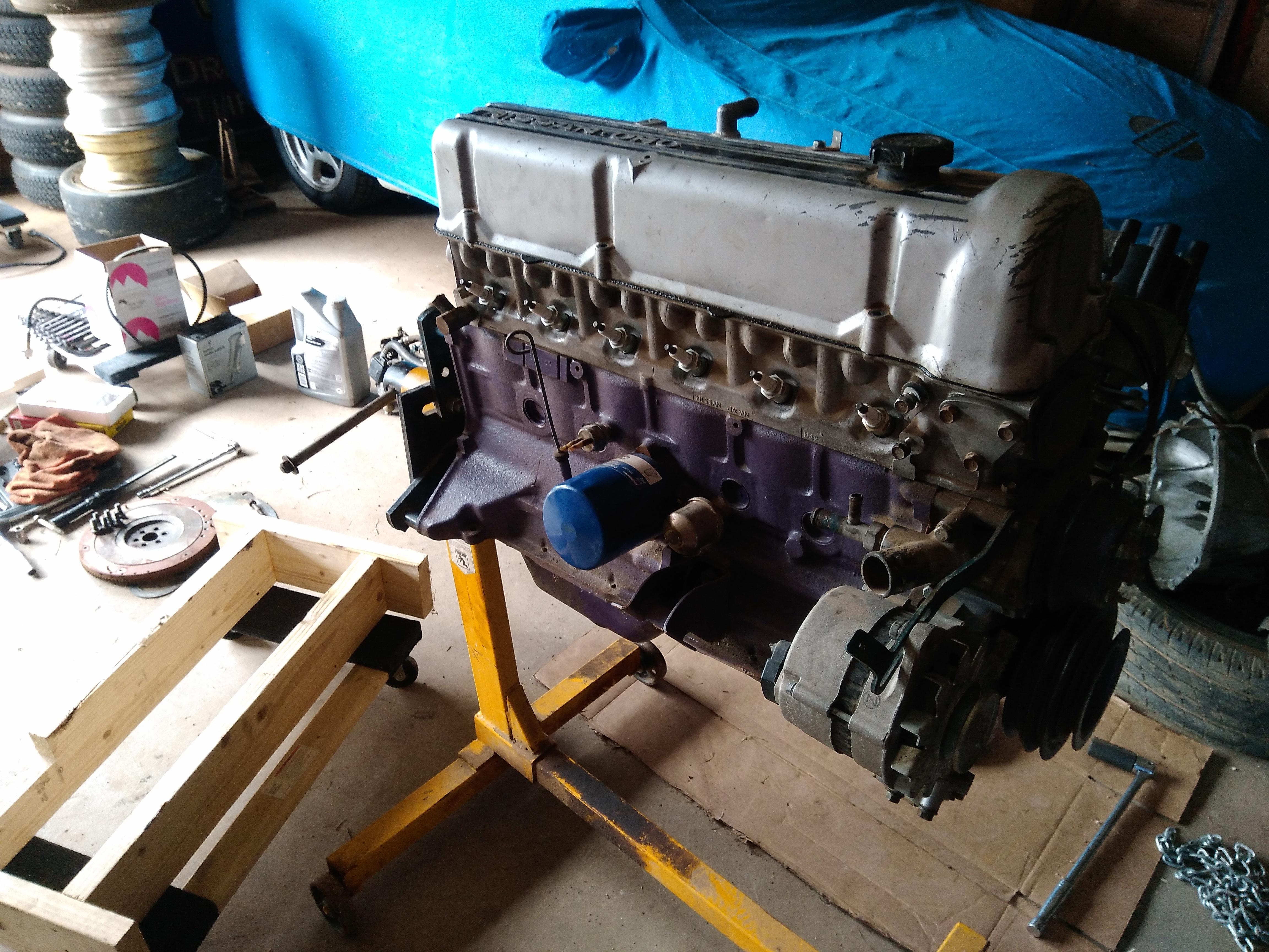

Last year I acquired a interesting 2.8 motor and am now getting around to looking more closely at it.  It is interesting in that it was claimed to have been rebuilt and never installed.  (kind of like ran when parked, lol)   It is a F54 block with a N42 head.  Turbo oil pan but NA intake & exhaust manifolds.  I had it sitting on a nice cradle & dolly, so easy to move around.

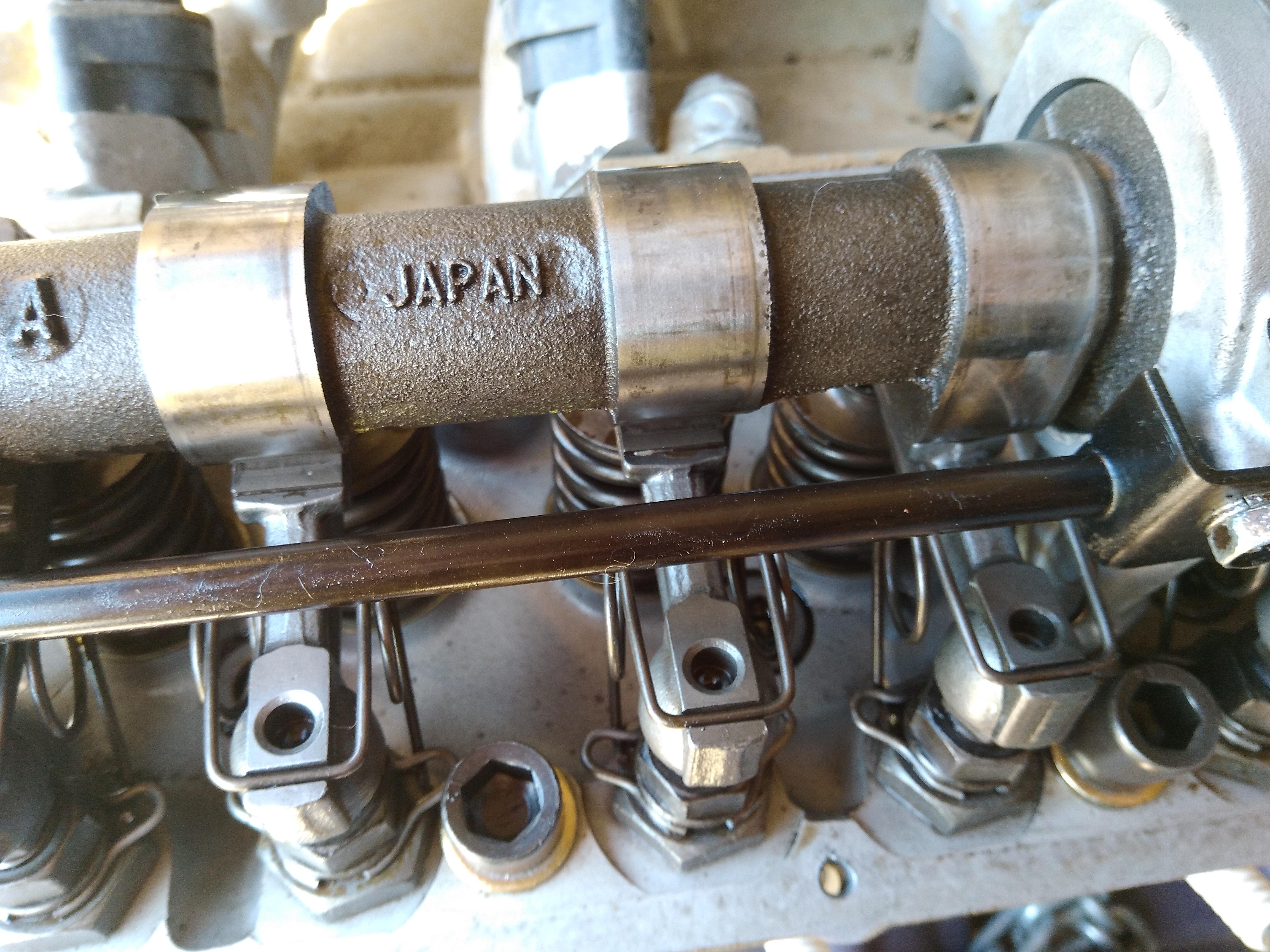

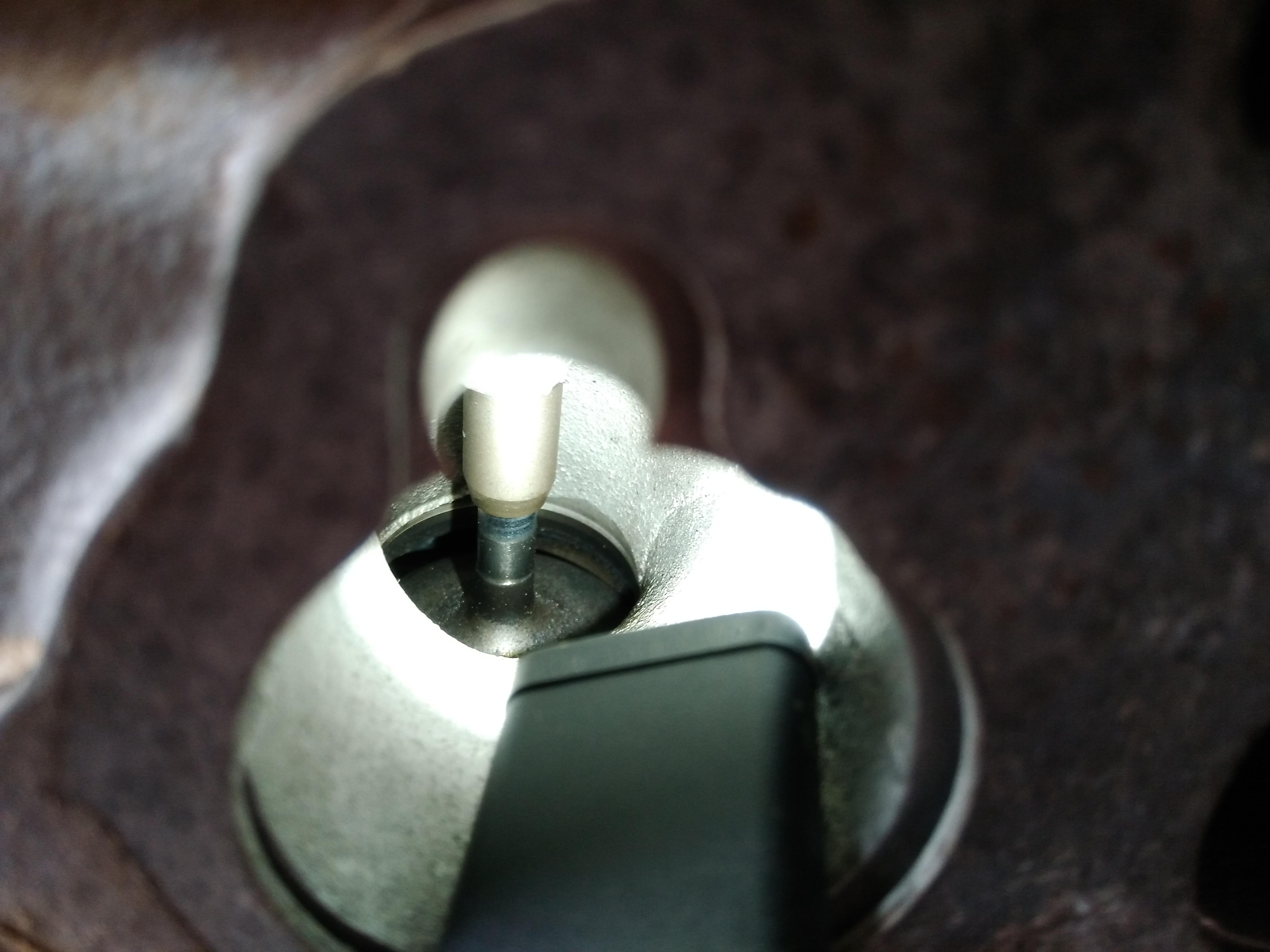

I pulled the plugs, which are new NGK's and never fired.  Got my laptop and borescope camera, inspected the cylinders and found it has dished pistons and what looks like a fresh hone.  All looked very clean.  Next, I removed the valve cover and lubed the valve train with some high zinc oil, added about 2 or 3 quarts more and turned it over by hand.  All appeared to be well.  Then bolted on a bell housing so I could add a starter and do a compression test.

With the dished pistons, and Atlantic Z's calculator, looks like about 8.25 to 1 CR.   Going to flat top pistons, approximately 9.7 to 1 CR.    I am trying to decide if it is worth the trouble to source and install the flat top pistons.  From my quick research, it looks like this heads design is not the best choice with flat tops.    Since the head looks like it was totally redone - valve job etc. it would be nice to keep it on there as that is most of the money saved.     What do you guys think my options are..

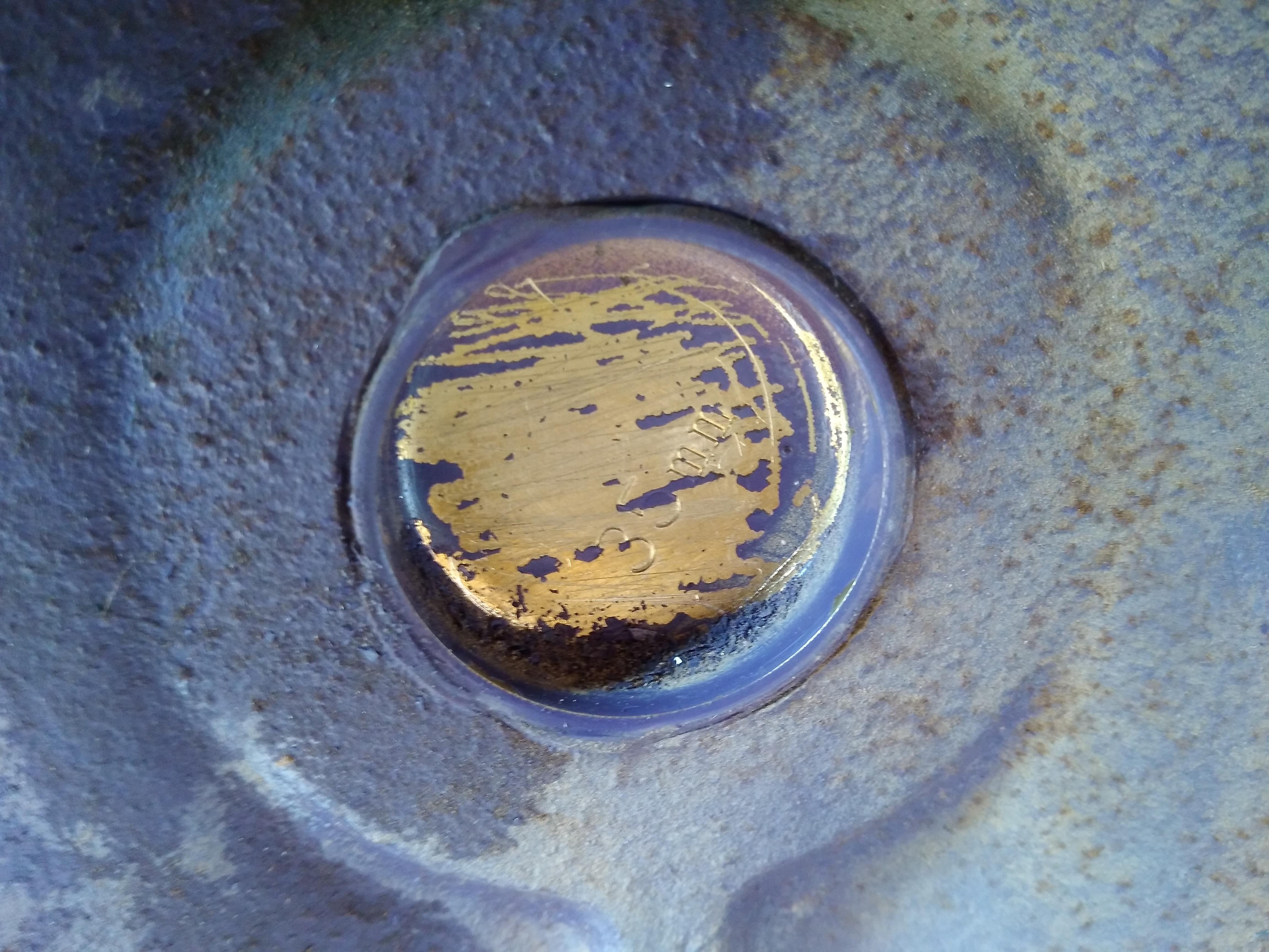

From what I see so far with this motor,  it does indeed appear to show all the signs of a rebuild.   The head / cam area are very clean, manifold gasket is new, scraped some purple paint from a few frost plugs to reveal new looking brass ones.   Just transferred it to a engine stand and have not pulled the pan off yet to take a look at the bottom end.

You might check the wipe pattern and examine the quality of the rocker arm lash pads.  See if they've been reground or the builder just put old ones back on.  Cam lobe wiping seems to be the most common damage to newly rebuilt engines.

Thanks for all the comments.   I'll continue with the inspection of the motor, cam wipe pattern, verify valve timing setup etc.
