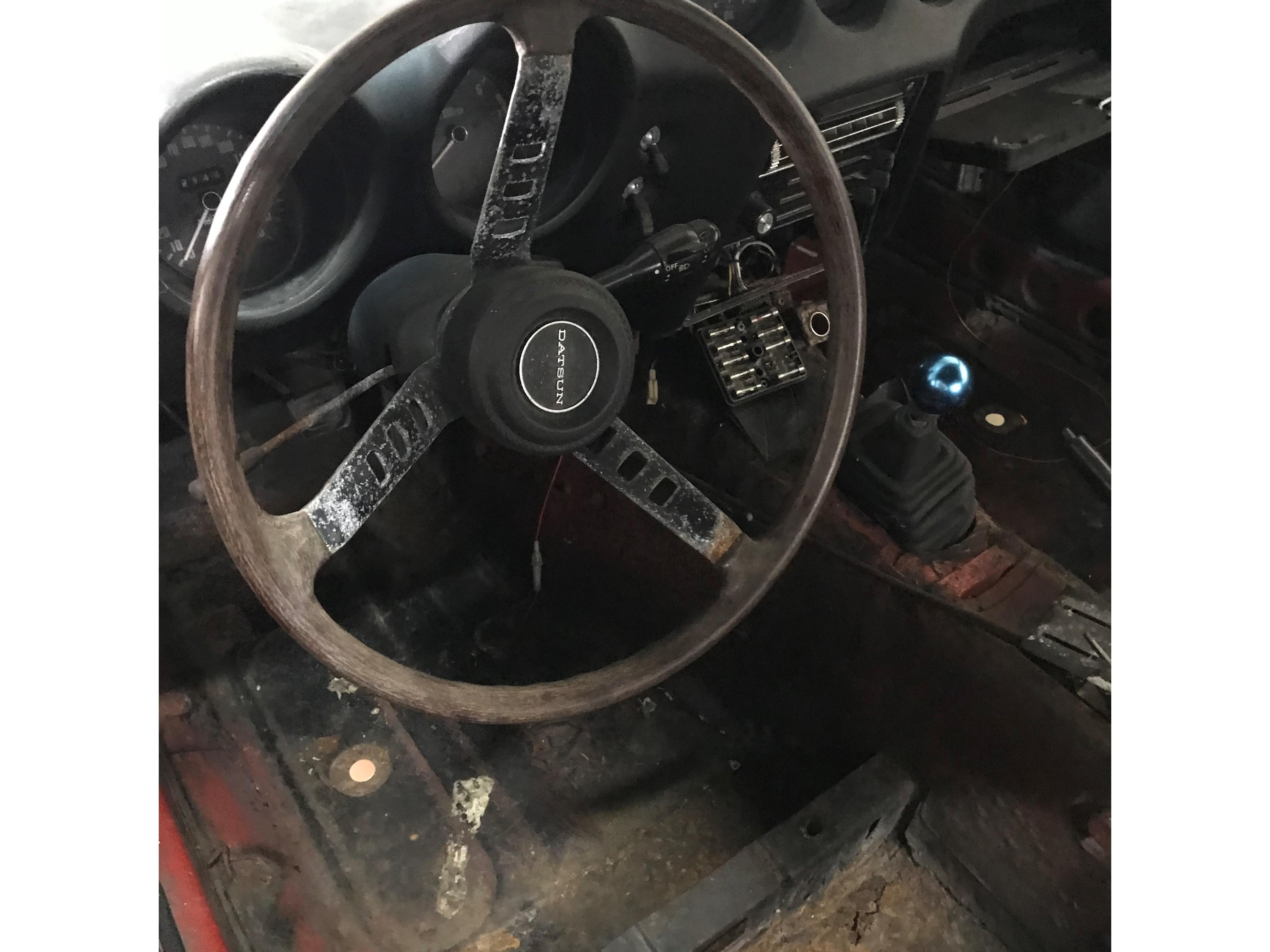

another photo of inside
Looks like a ZX short throw shifter to me, that's a good thing if it's in decent condition. Borg Warner T5.  https://datsunzgarage.us/borg/
maybe it's just the close ratio ZX. Not the T5. Sorry, just waking up with some coffee.
Edited by siteunseen
Hi siteunseen, Im not a super knowledgable engine guy.. I do know its the stock L24 in there and it matches the frame. - there was no extra engine work done.. only some electrical stuff for some lights i ripped off...  what is the zx short  shifter?? - all i know is the tranny seems ok as it stiff shifts fine...
is it rare to have an L24 left in these things?? lol...  especially matching,,,,,

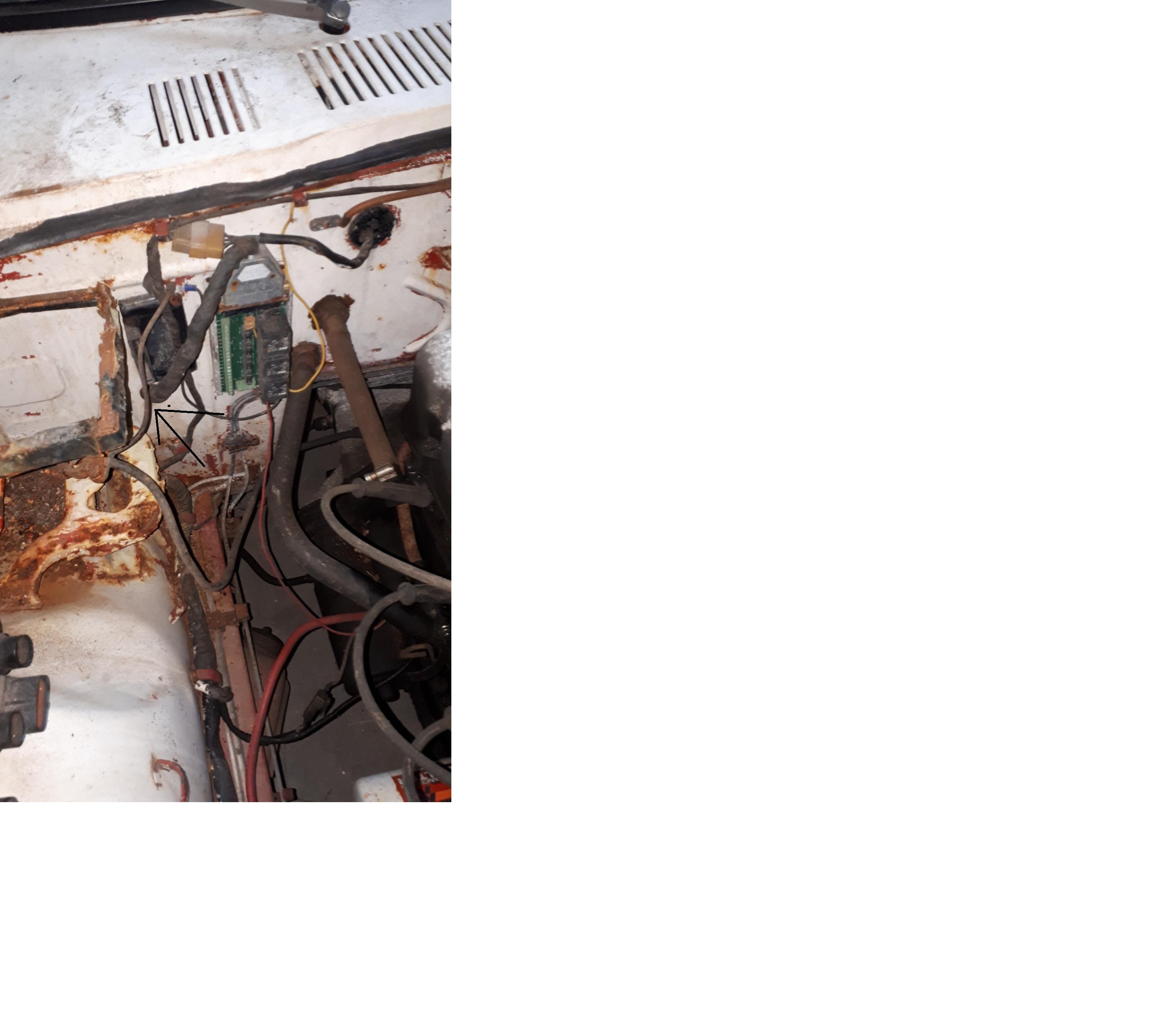

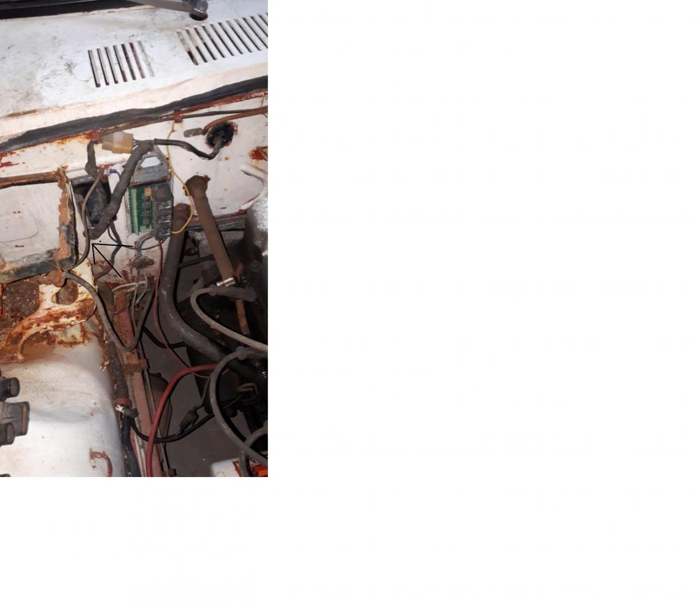

these are the crazy electronics in this.///
how did they get that cable through the firewall????
It looks like you've removed the battery.  That's good.  You asked about the negative battery cable before.  It attaches to one of the mounting bolts for the starter, I think, or any bolt that is attached to the engine block.

It's not rare to have the original motor, it's actually common on this forum. I prefer originality as most others do. We upgrade parts to newer and better versions but always keep the old parts so what you do is reversible.
In my opinion, judging by your photos, that car could very well have had an L2.8 at some point in the past. The engine bay has obviously been painted which would pretty much require removal of the motor(s). The signs of EFI are another clue to me. Someone could have used the lightweight 240 body and upgraded to a higher horsepower motor but kept the 2.4 you have now reinstalled.
The ZX transmission is a 5 speed. Your car came with a 4 speed.
I'm just ASSuming here. It's not in anyway a mechanic's opinion. LOL
