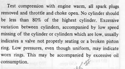

March 30, 20214 yr comment_618901 2 hours ago, Jughead said: Cylinder PSI 1 152 2 149 3 154 4 179 5 152 6 179 179 x .8 = 143. You are right on the edge. Most engine builders today use 10%, not 20% (actually 80% of highest by Nissan's description). Your backfiring and popping could be caused by "missing". Raw fuel in the exhaust pipe. Link to comment https://www.classiczcars.com/forums/topic/65170-cam-sprocket-position/?&page=4#findComment-618901 Share on other sites More sharing options...
March 30, 20214 yr Author comment_618904 I need to redo test - forgot to open throttle. What does "choke open" mean? Full choke? I wonder why that would make a difference... I'll update compresion test results tonight. @Zed Head's is a good question: Should the carb pistons be lifted/roved for the compression test? Edited March 30, 20214 yr by Jughead clarification Link to comment https://www.classiczcars.com/forums/topic/65170-cam-sprocket-position/?&page=4#findComment-618904 Share on other sites More sharing options...
March 30, 20214 yr comment_618908 I don't lift the carb pistons. I remove all the spark plugs, adjust the valves, turn the engine over with the starter until the gauge shows oil pressure, install the c gauge, open the throttle all the way and turn the engine over until the c gauge needle won't go higher. I always start with #1 and the #2-#6, then I repeat #1. Frequently the reading on #1 will improve slightly because of increased oil circulation after repeated engine revolutions. Link to comment https://www.classiczcars.com/forums/topic/65170-cam-sprocket-position/?&page=4#findComment-618908 Share on other sites More sharing options...

March 31, 20214 yr comment_618964 20 hours ago, Jughead said: I need to redo test - forgot to open throttle. What does "choke open" mean? Full choke? I wonder why that would make a difference... Throttle open simply allows air into the cylinders. I haven't lifted the pistons either, but it's possible doing so could change the results. As long as you are consistent, it shouldn't matter. With compression testing, it's more about cylinder to cylinder variation than actual numbers. Most gauges will vary a bit. I can't see where opening the choke would make any difference as all it does is lower the needle to enrichen the fuel mixture. That shouldn't matter at all. Link to comment https://www.classiczcars.com/forums/topic/65170-cam-sprocket-position/?&page=4#findComment-618964 Share on other sites More sharing options...

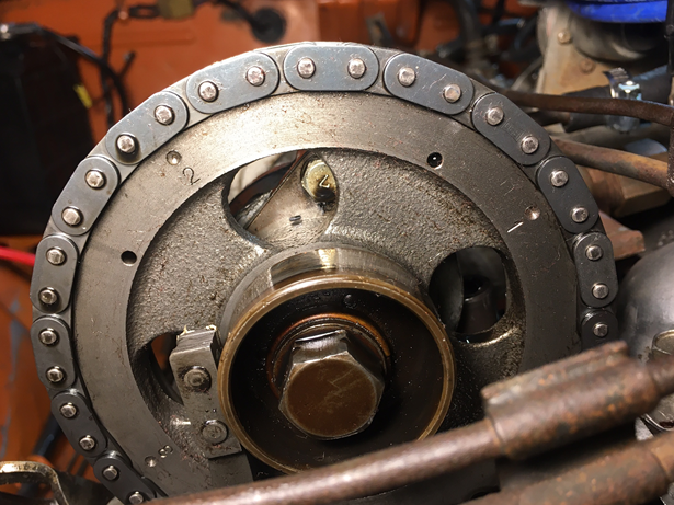

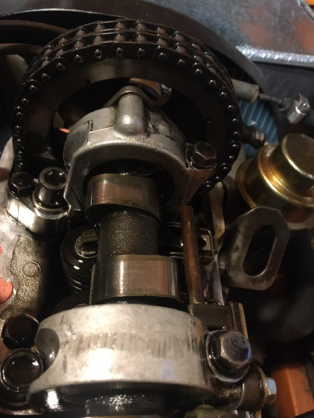

April 4, 20213 yr Author comment_619177 Gentlemen, Here's the latest update: 1) I redid the compression test using with better tester and throttles open. The readings look good (to me): 1=165 2=160 3= 174 4=170 5= 160 6=165 2) I removed valve cover again to recheck cam sprocket position @ TDC on compression stroke. Please see new pics below, and give me a sanity check on the following: a. The notch on the sprocket is directly below the groove, on the camshaft locating plate. (This is factory setting, per Haynes). b. The distributor/oil pump shaft “tongue” seems to be positioned correctly. (I did confirm that distributor shaft was NOT installed 108 degrees off!) c. The #1 cylinder cam lobes are in the “bunny ear" position d. I used a zip tie to verify TDC, and checked that the rotor was in #1 position to verify I was on the compression stroke. e. Question: Should I be concerned that the #1 mark on the cam sprocket is not on the “bright” light. (It looks to be on the adjacent one.) I have no idea whether the other bright link is correctly positioned on the Crank sprocket.) Everything else seems to be spot on... 3) Hooked up vacuum gauge and, after adjusting timing and mixture, I got between 19-20 psi of vacuum. The engine "purred" at these settings (at idle). And yet, when I test drove, I got backfiring & sooty plugs (again). And (again), when I adjusted to lean out, I got backfiring (i.e. "front-fire") out of the carbs. I've sprayed starter fluid on the manifolds and didn;t notice any reaction. So now I'm focusing on the distributor. I'm looking for a new/rebuilt dizzy to swap in & see what happens. Anyone have a solid distributor they'd like to sell? I also need a cam oil spray bar ("oil distribution tube"). Thanks all, for hanging in there with me!!! Jughead Link to comment https://www.classiczcars.com/forums/topic/65170-cam-sprocket-position/?&page=4#findComment-619177 Share on other sites More sharing options...

April 5, 20213 yr comment_619201 I don’t know guys - looks like that dizzy drive shaft is off a tooth if that’s TDC . Link to comment https://www.classiczcars.com/forums/topic/65170-cam-sprocket-position/?&page=4#findComment-619201 Share on other sites More sharing options...
