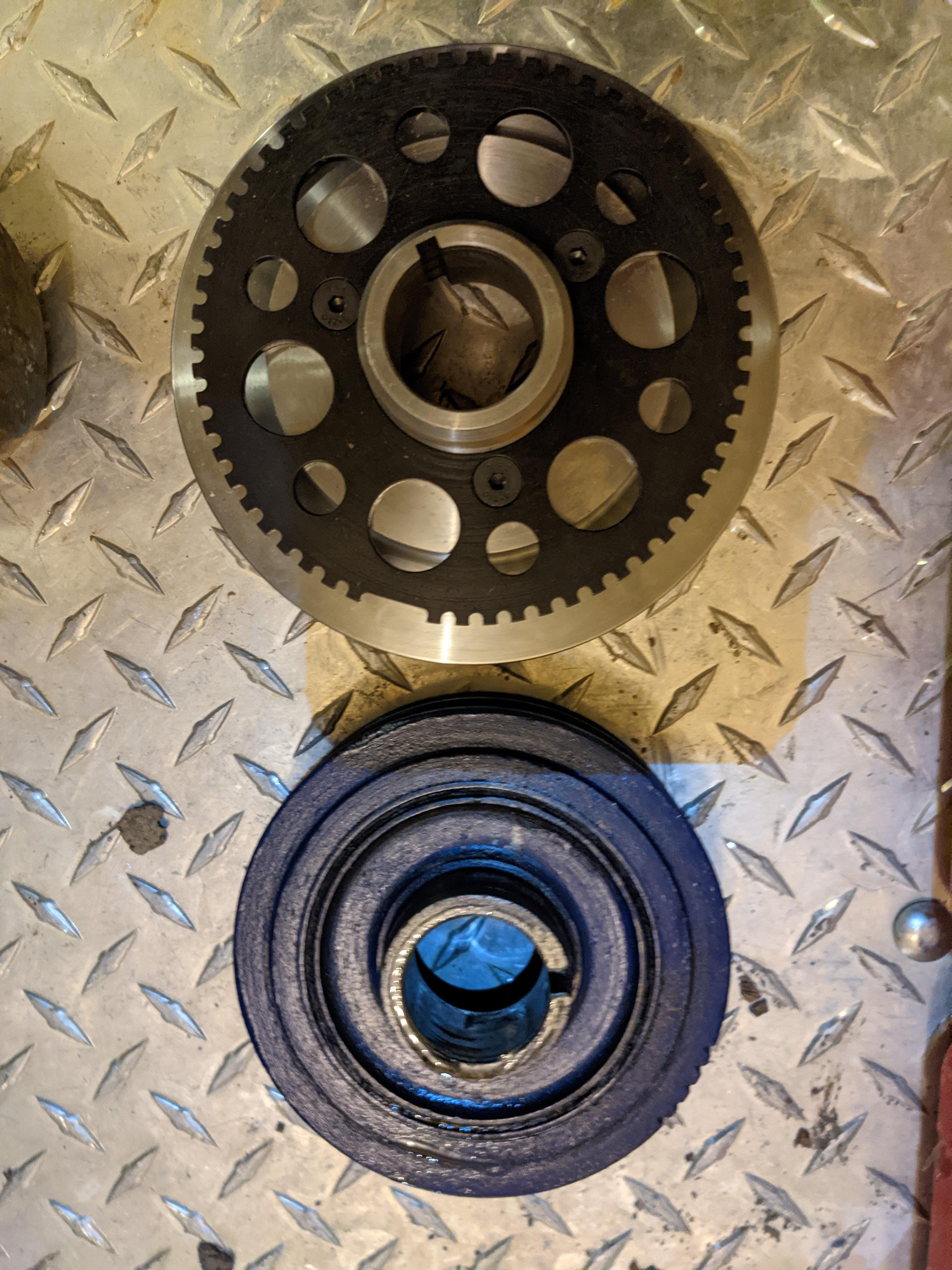

March 20, 20214 yr Author comment_618162 18 minutes ago, Racer X said: What are all those nicks and gouges on the front cover? I see a toolmark on the edge of the seal bore that has displaced meta into the bore. Take a jeweler's file and smooth that back down to restore the radius of the bore before putting a new seal in. Use a shop vac while filing to suck the metal bits away from the crankcase. No idea. I'm not the first owner. Good call, I notice that mark there on the right side of my picture now. 18 minutes ago, Racer X said: But you only need one. I have a 2nd engine, I don't think it has a slinger either. Link to comment https://www.classiczcars.com/forums/topic/65190-woodruff-key-disappeared-into-the-abyss/?&page=3#findComment-618162 Share on other sites More sharing options...

March 20, 20214 yr comment_618165 19 minutes ago, Awk34 said: No idea. I'm not the first owner. Good call, I notice that mark there on the right side of my picture now. Ah, I see. Some people get carried away and break out the prybars and hammers when a puller will do. Quote I have a 2nd engine, I don't think it has a slinger either. Oh, well then, now your covered. The key that fell inside is likely in the oil pan, so no worries there. The oil pickup has a screen so it won't get sucked into the lubrucation system. It is too heavy to get sloshed into the rotating assembly. You may find it again at an oil change, in fact you may want to pour your used oil through a screen until you find it. I stole the strainer from Mrs. Racer's kitchen stuff for a similar job in the shop. Works great. She asked me recently if I had seen it. I didn't come clean. Her birthday was last Monday and she got a brand new one. Edited March 20, 20214 yr by Racer X Link to comment https://www.classiczcars.com/forums/topic/65190-woodruff-key-disappeared-into-the-abyss/?&page=3#findComment-618165 Share on other sites More sharing options...

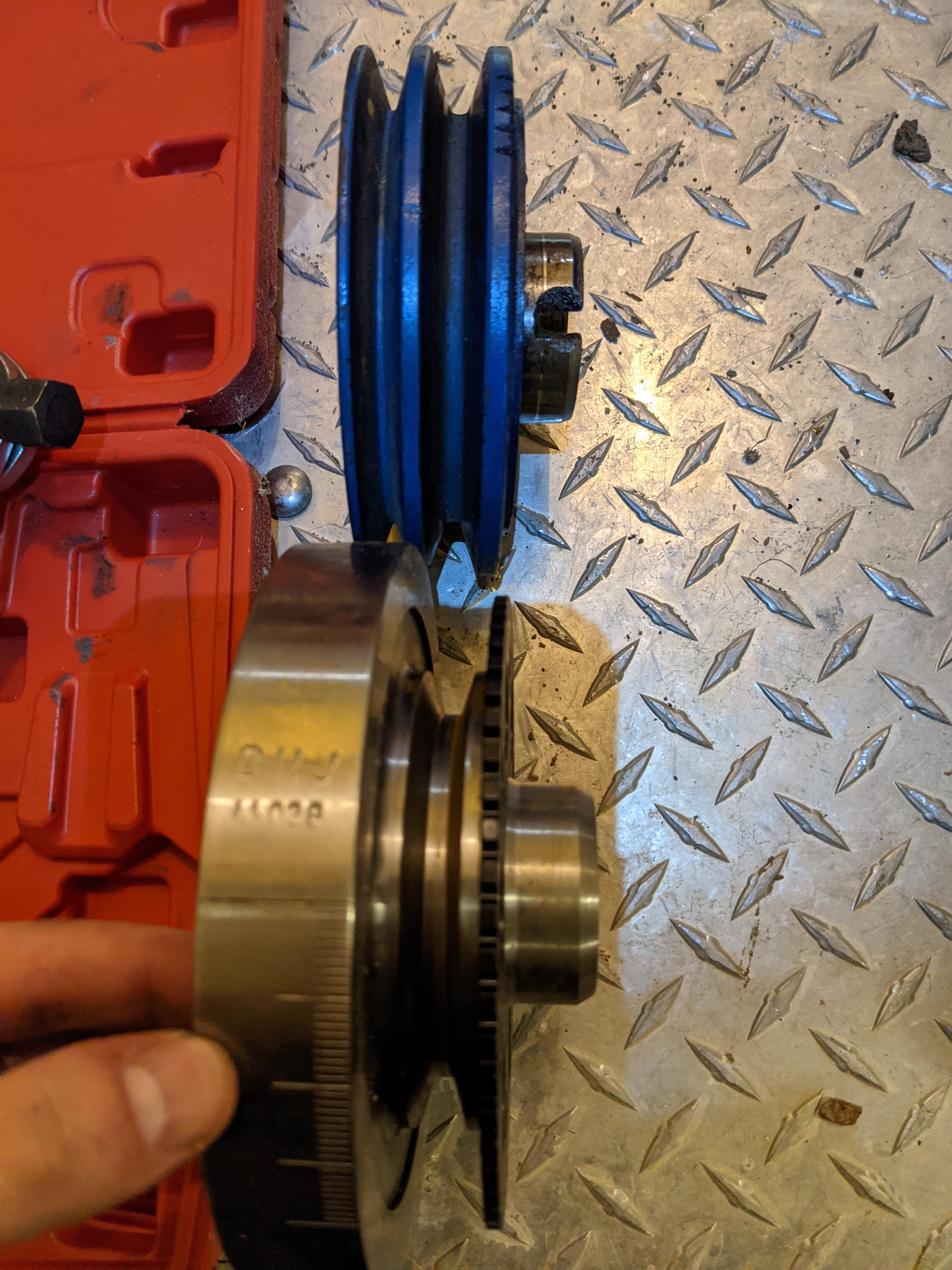

March 20, 20214 yr Author comment_618169 @Racer X Thanks! lots of great info in your post. You're saying to chamfer the keyway on the damper a bit to make it easier to seat onto the key, right? One other thing is that my new damper doesn't slide onto the crank very easily. I slid it on by hand as much as I could, and then used it's installer tool. 1 hour ago, Racer X said: Ah, I see. Some people get carried away and break out the prybars and hammers when a puller will do. Take a look at the side profile picture of my old damper. The previous owner did something wrong to that poor thing. I only discovered it when I was pulling the timing cover off for some other maintenance. That's one of the reasons I decided to go ahead and get a new damper. Link to comment https://www.classiczcars.com/forums/topic/65190-woodruff-key-disappeared-into-the-abyss/?&page=3#findComment-618169 Share on other sites More sharing options...

March 20, 20214 yr comment_618171 It looks substantially under sized at the pulley area? Link to comment https://www.classiczcars.com/forums/topic/65190-woodruff-key-disappeared-into-the-abyss/?&page=3#findComment-618171 Share on other sites More sharing options...

March 20, 20214 yr comment_618174 43 minutes ago, Awk34 said: @Racer X Thanks! lots of great info in your post. You're welcome, I hope it helps. Quote You're saying to chamfer the keyway on the damper a bit to make it easier to seat onto the key, right? You just need to break the edge so it isn't sharp. No more than a couple thousandths of an inch. It keeps the key from hanging up. In fact, if you take a close look at the key, you'll see the edges aren't sharp, but slightly rounded. And it is nearly perfectly smooth. Smooth is good. Quote One other thing is that my new damper doesn't slide onto the crank very easily. I slid it on by hand as much as I could, and then used it's installer tool. It should slip all the way on by hand. It shouldn't be loose, or move noticeably once fully seated, but you should be able to slide it off and on by hand. Try some emery cloth, concentrating at the outer third of the bore. Be sure to clean thoroughly before each test fit. Quote Take a look at the side profile picture of my old damper. The previous owner did something wrong to that poor thing. I only discovered it when I was pulling the timing cover off for some other maintenance. That's one of the reasons I decided to go ahead and get a new damper. Uf da! Edited March 20, 20214 yr by Racer X Link to comment https://www.classiczcars.com/forums/topic/65190-woodruff-key-disappeared-into-the-abyss/?&page=3#findComment-618174 Share on other sites More sharing options...
