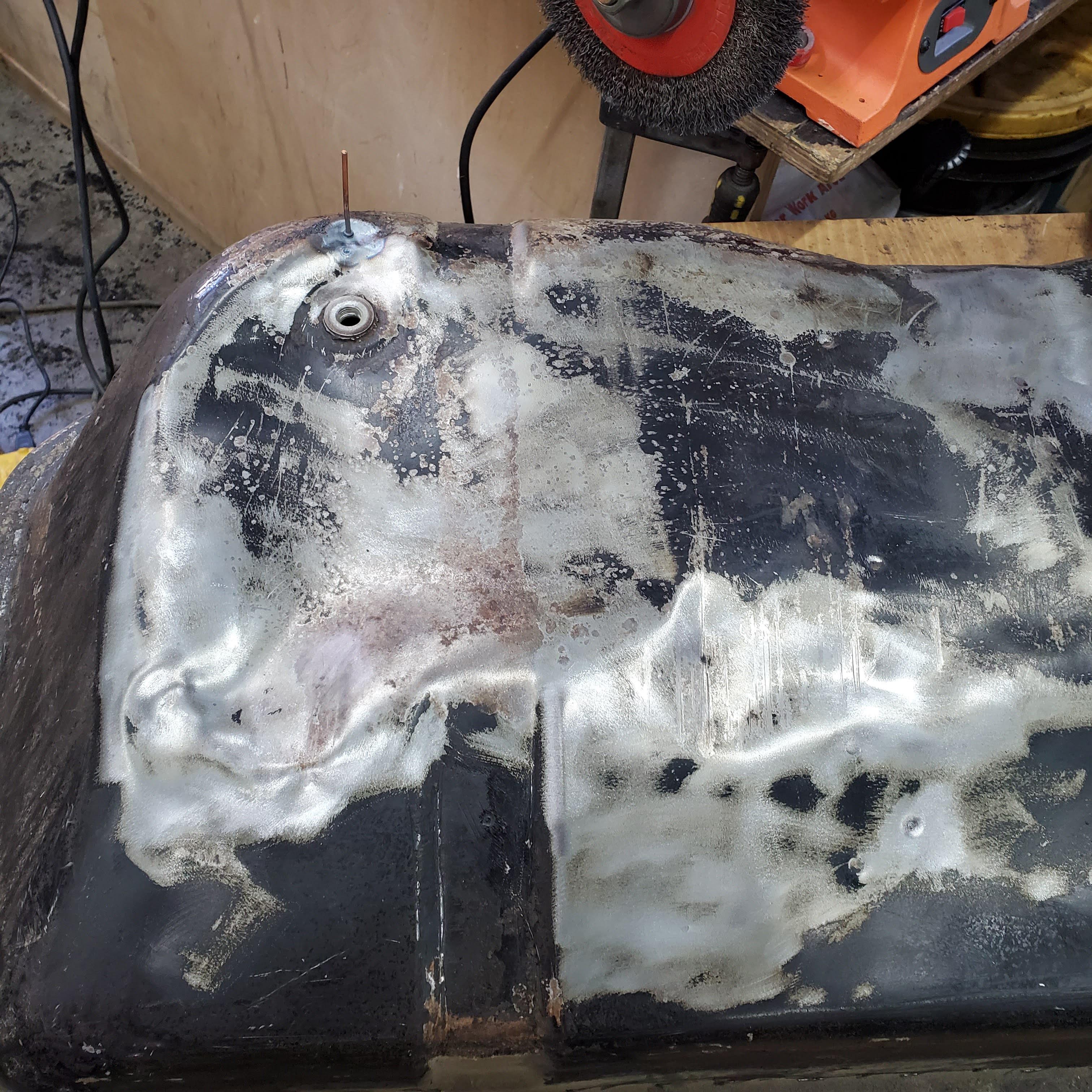

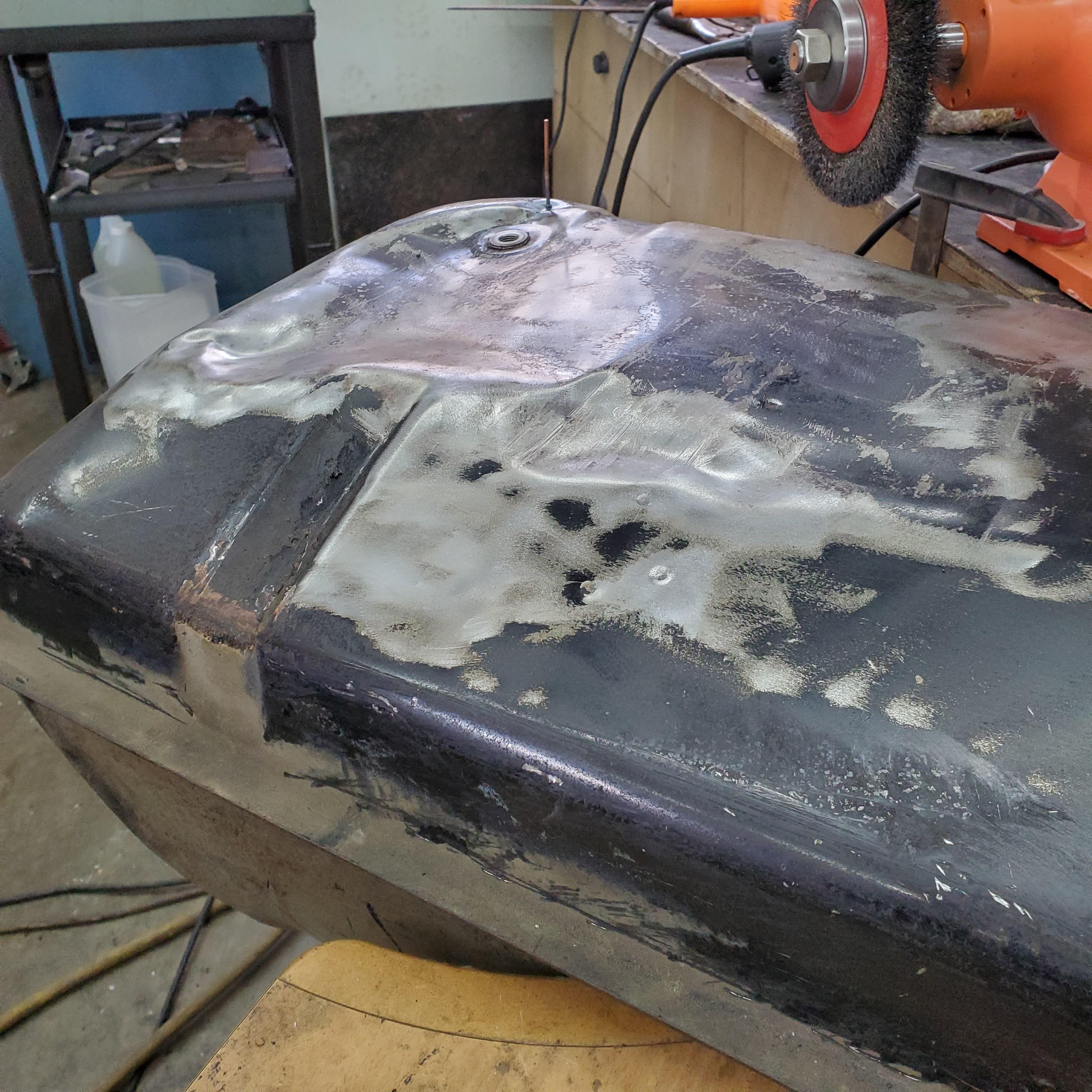

I am attempting to repair some "body damage" to the bottom of my fuel tank.
So far, I have tried hot glue techniques and weld-on pins for use with a puller.  I specifically avoided going with a typical dent puller requiring holes for obvious reasons.  So while pulling on the pins, I've managed to produce two good sized holes.  Annoyed, but not crushed, I can now do whatever I need to remove the dents - including opening up the tank  to permit some hammer and dolly work, as the pulling techniques were a bust.

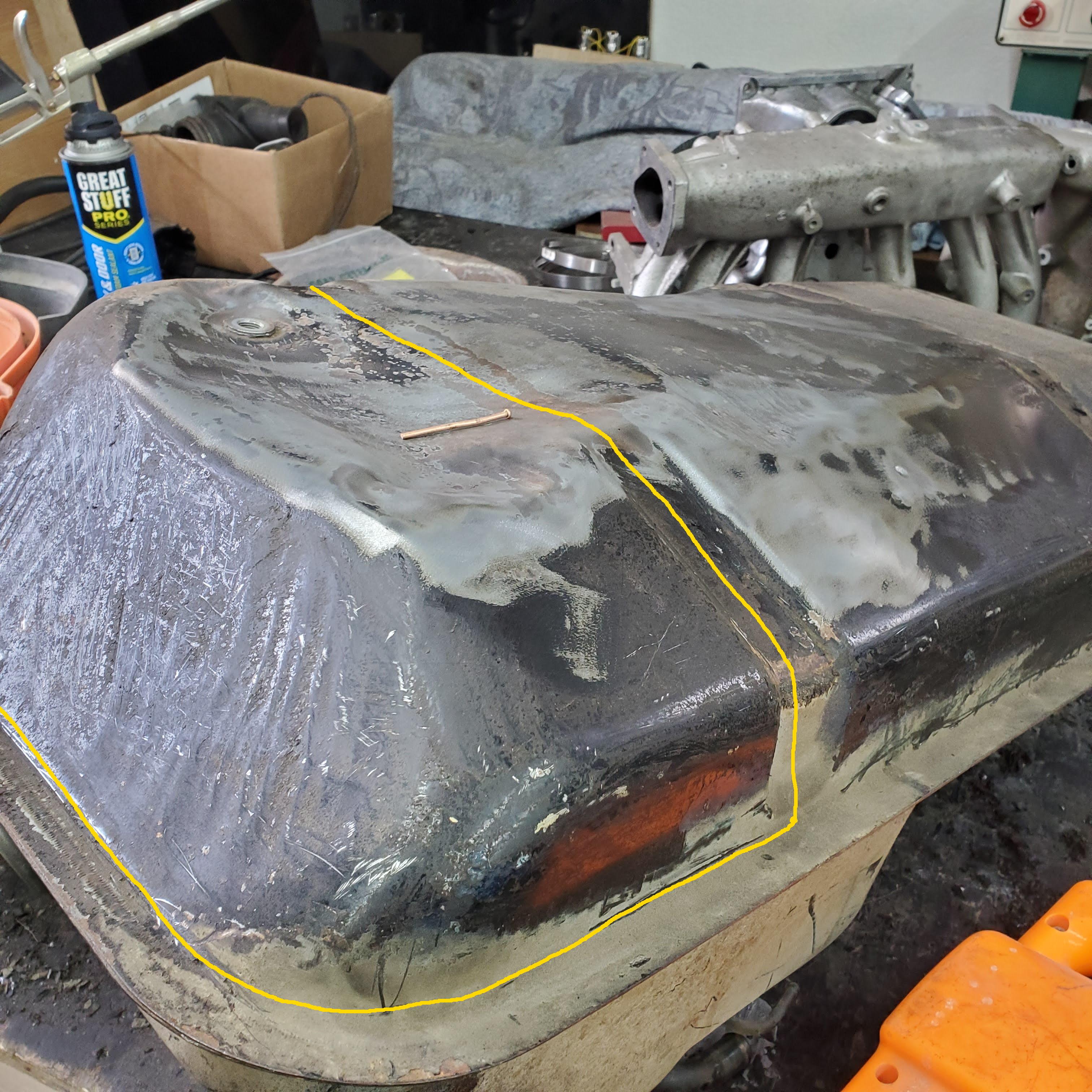

My thought was I'd cut around the welded seam along the side of the tank and then across middle of the support strap recess.  That way the new weld line will not be visible once installed (try as I might, I cannot get a welded joint to look quite like the ones Trev does on his YT channel - Trev's Blog.  The guy is a wizard).
The tank has the slightest damage from surface rust in a couple small areas including a very small patch inside, so it is completely restorable.  I just can't bear the thought of using it being so beat up.  So I am looking for any advice, suggestions, etc. that anyone cares to share.  Thanks!

I plugged all the holes except two, taped an air chuck onto an inlet and cut the tank all along the seem. Blasted and welded back together.

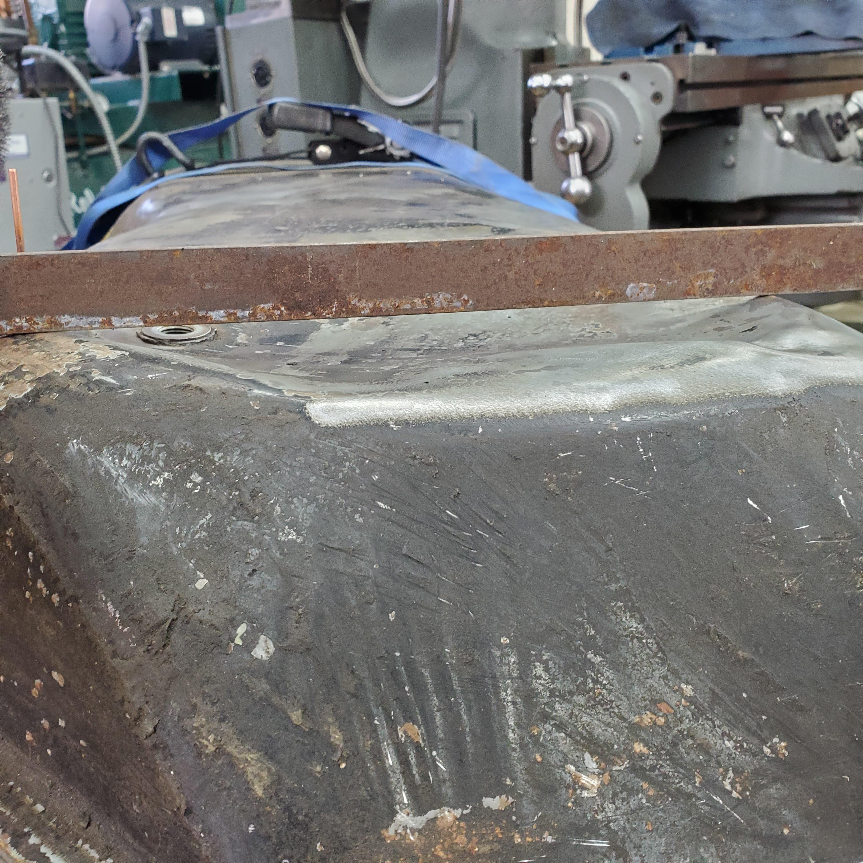

Alas, that tank is still in two pieces.  The job of gluing it back together has been kicked back from the forefront of efforts/work more times than I care to recall.
Absolutely,  cutting it apart was the best (only way for me) to get the metal right.  Fortunately,  there's very little interior corrosion, just bad bruises (which I still cannot figure out it happened).  The one remaining area to straighten that is inaccessible from inside is immediately below the in-tank filter.  I'm thinking of deleting it altogether to get the dents, and I want to slosh around some tank sealant and the prospects for getting fuel the filter look terrible at best.
