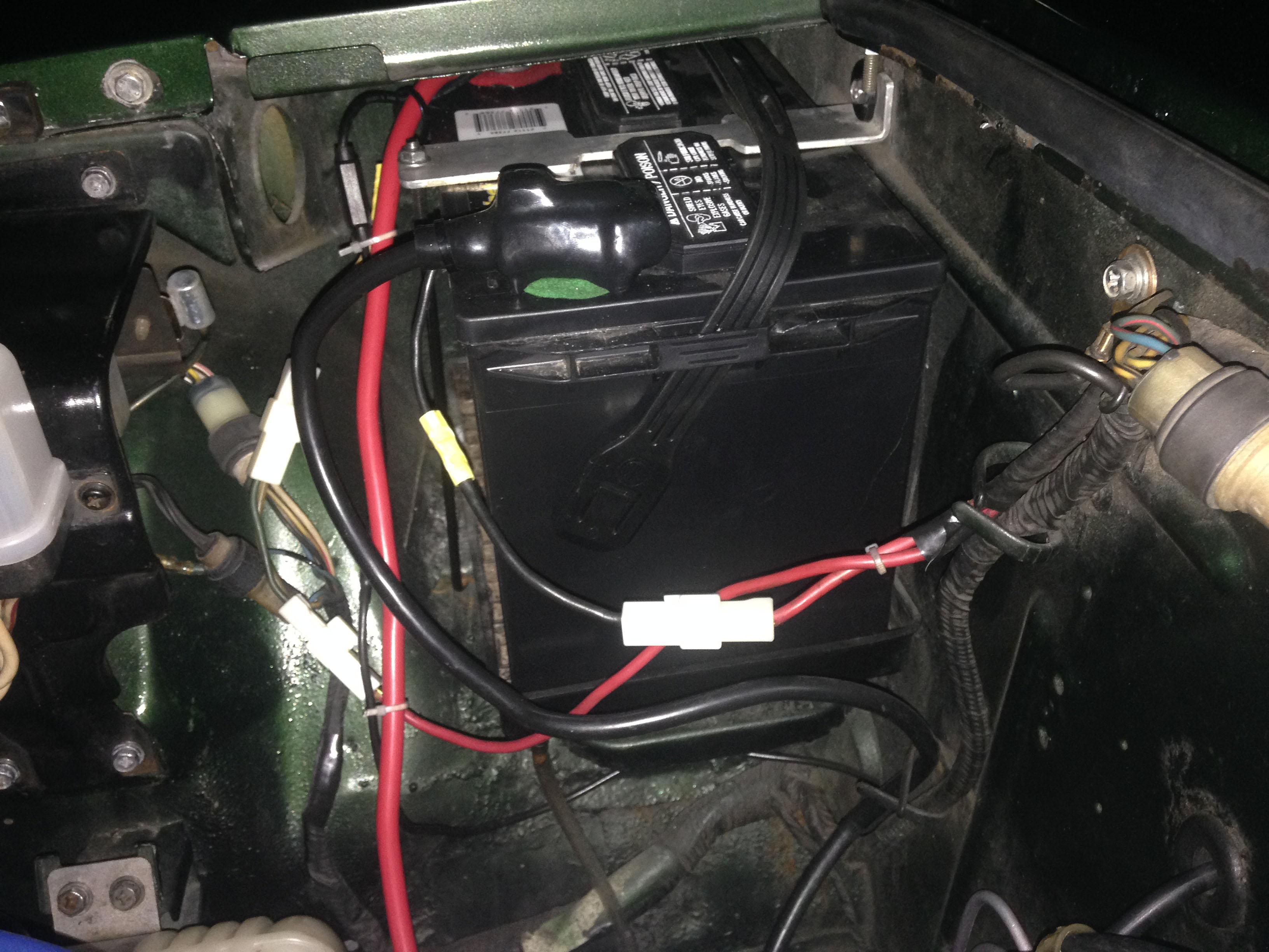

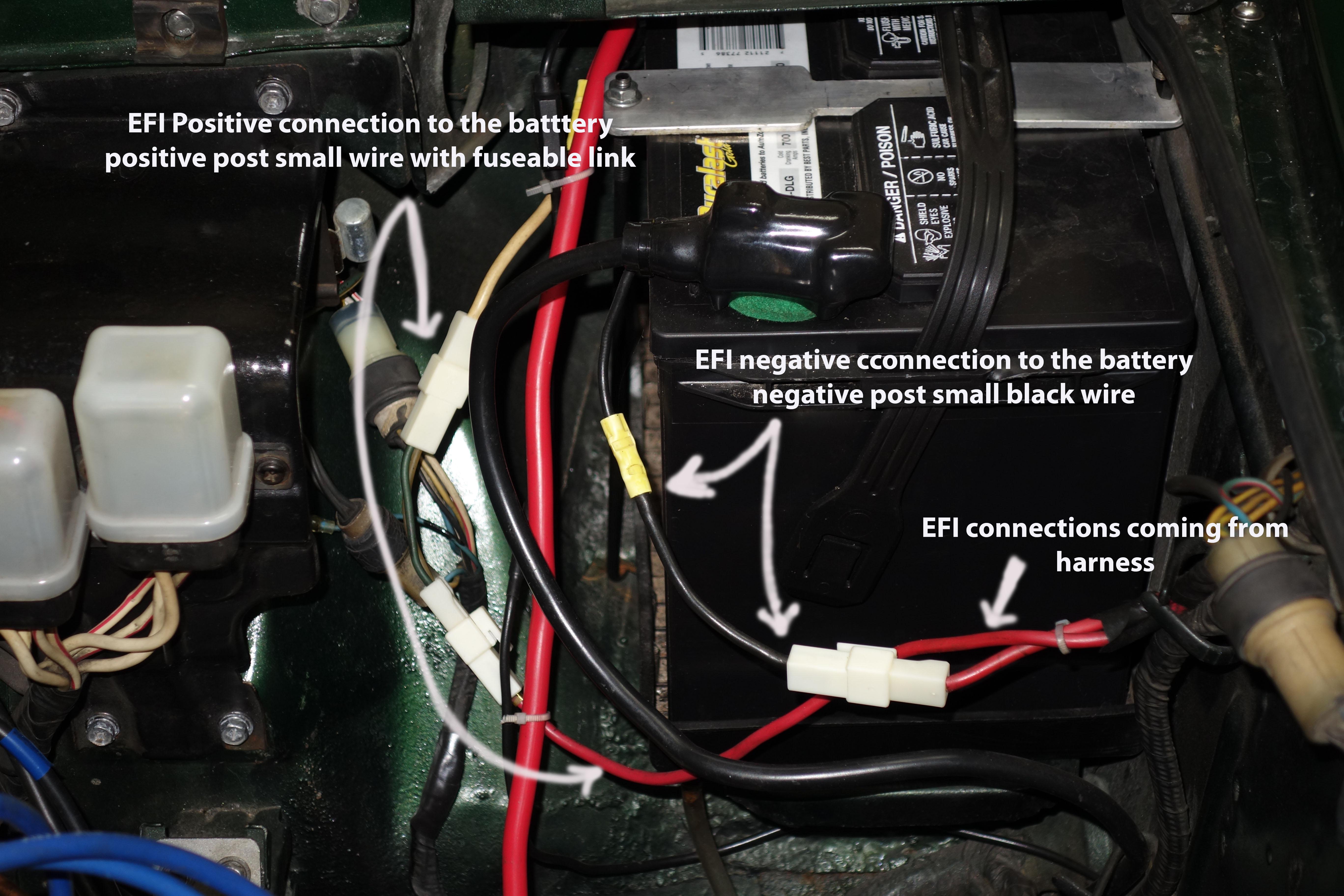

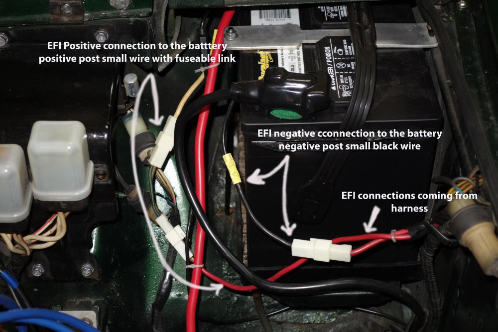

March 31, 20214 yr comment_618927 What is the current state of the battery connections? Can you take pic of that and the fuseible links? Maybe there is a fuel issue..The EFI harness powers off the battery with fusible links on the battery connections like these on the positive and negative cables. How are you checking fuel pressure? a lot of 280 owners put a fuel pressure gauge in line between the fuel filter and fuel rail just to keep an eye on fuel pressure every time the open the hood. Link to comment https://www.classiczcars.com/forums/topic/65210-280z-starting-problems/?&page=4#findComment-618927 Share on other sites More sharing options...

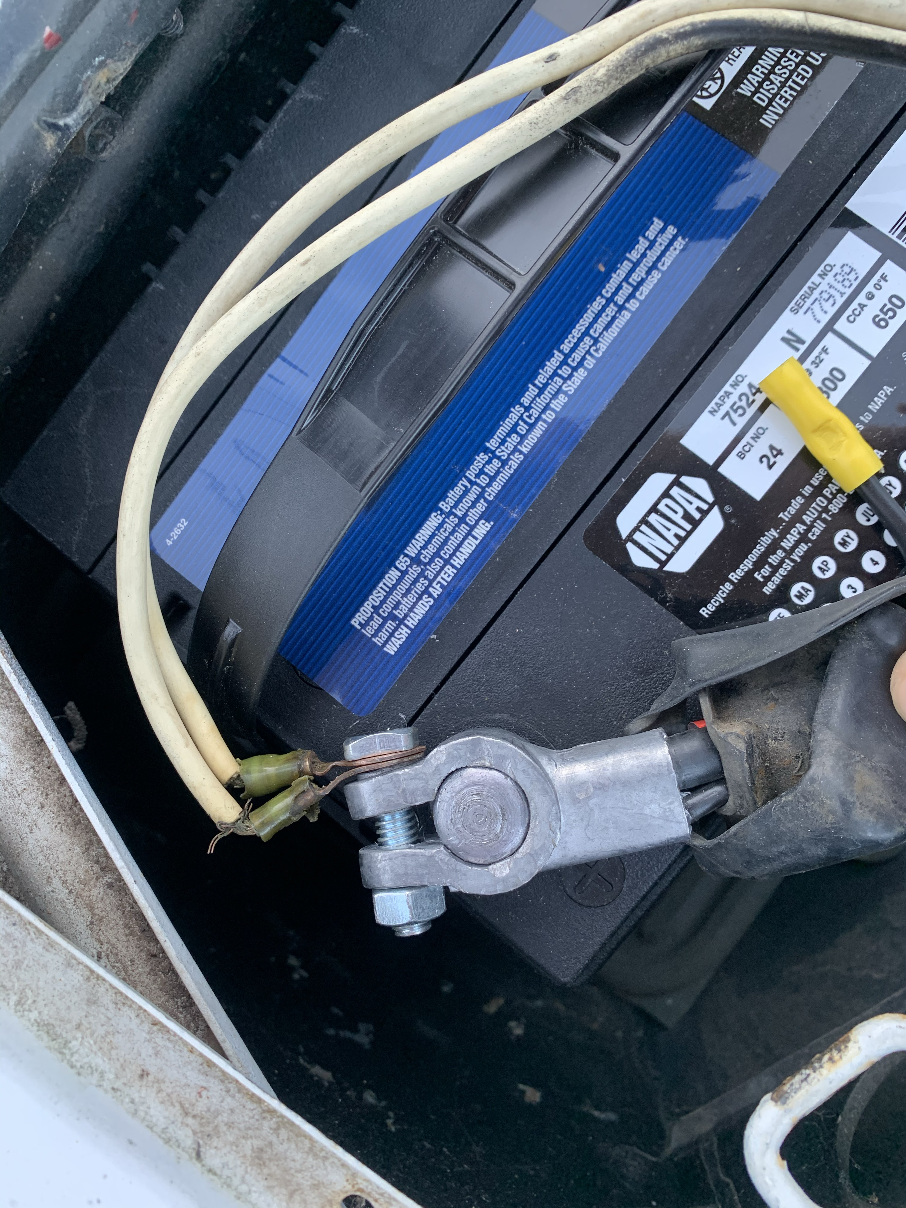

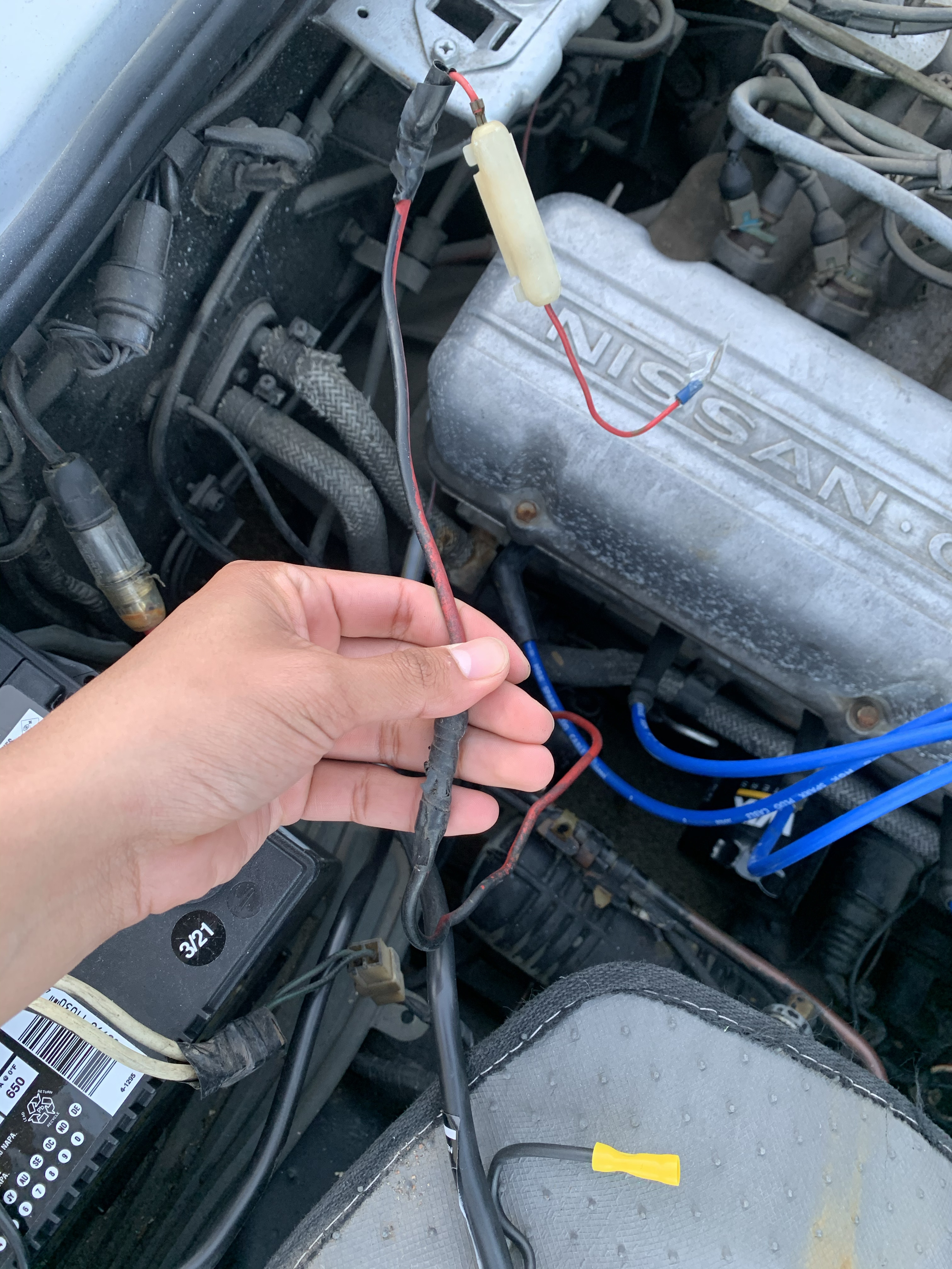

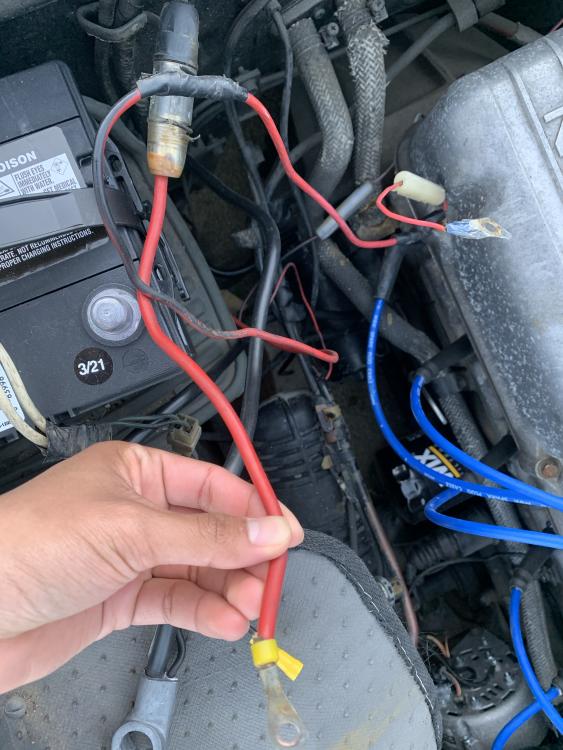

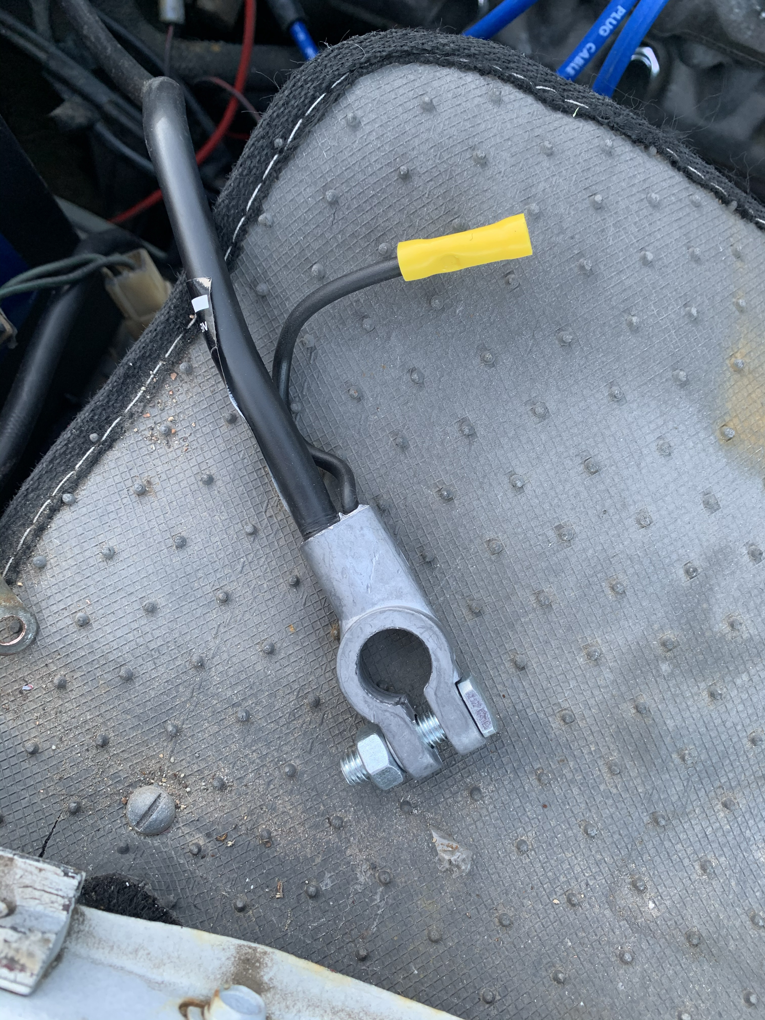

March 31, 20214 yr Author comment_618940 On 3/31/2021 at 12:26 AM, gwri8 said: What is the current state of the battery connections? Can you take pic of that and the fuseible links? Maybe there is a fuel issue..The EFI harness powers off the battery with fusible links on the battery connections like these on the positive and negative cables. How are you checking fuel pressure? a lot of 280 owners put a fuel pressure gauge in line between the fuel filter and fuel rail just to keep an eye on fuel pressure every time the open the hood. The battery connections are new, I had already gotten 2 new battery cables so the connections are clean and nice. I can update you with some better photos of the links tomorrow as of right now I’m out. I checked by attaching a line to the fuel filter, and disconnecting the starter solenoid, the gauge read at 20-25psi. There are no extra wires connected to my negative battery terminal. There are 2 white wires to my positive which go into the wiring harness under the fusible links, There is an extra red wire which I’m figuring out what it does that seems to run along into the the dash board area on the driver’s side, under the brake cylinder, and an extra red wire which runs under the car. I figure the one cable under the car that is currently hanging out is the previous owners bad wiring attempt at a Subwoofer which ruined a lot of wiring. The picture are the new links I installed.Sent from my iPhone using Tapatalk Link to comment https://www.classiczcars.com/forums/topic/65210-280z-starting-problems/?&page=4#findComment-618940 Share on other sites More sharing options...
March 31, 20214 yr Author comment_618942 The positive cable is the one with the two white wires. The skinny red wire I assume is their poor job at a subwoofer, and the thick red wire has a job and I’m going to be adding it to the positive terminal cable.Sent from my iPhone using Tapatalk Link to comment https://www.classiczcars.com/forums/topic/65210-280z-starting-problems/?&page=4#findComment-618942 Share on other sites More sharing options...
March 31, 20214 yr comment_618955 Bear in mind that electrical is definitely not my strong suit so I'll wait to see some better photos, but I'm going to guess that the EFI harness is not hooked up. I can't stress enough that you need to know where each wire connects to. Guessing can make HUGE mistakes and when you run into PO hacks, it makes it more difficult. Have you downloaded the FSM for you car yet? If not, it's under the resources tab on the header or click here. https://www.classiczcars.com/files/. You can also get the color wiring diagram for your 78' there, also along with the EFI Bible. These will give you a wealth of info, and in particular how things should be. But basically, you'll need to find the EFI Harness and trace the wires. It connects to the ECU in the cabin and comes into the engine bay through the firewall underneath the clutch master cylinder. It splits from there and goes down along the frame rail and to up tothe fuel injectors. It also goes up and across the firewall over to the battery. These are the wires that should make connections to the battery. They should be in a loom but it doesn't look like it and I'm going to guess that the loose wire that crosses over the hood latch in one of your photos is one of them. Maybe that other wire you suspect to be for a subwoofer might be part of that EFI harness also. Trace it to be sure. Link to comment https://www.classiczcars.com/forums/topic/65210-280z-starting-problems/?&page=4#findComment-618955 Share on other sites More sharing options...

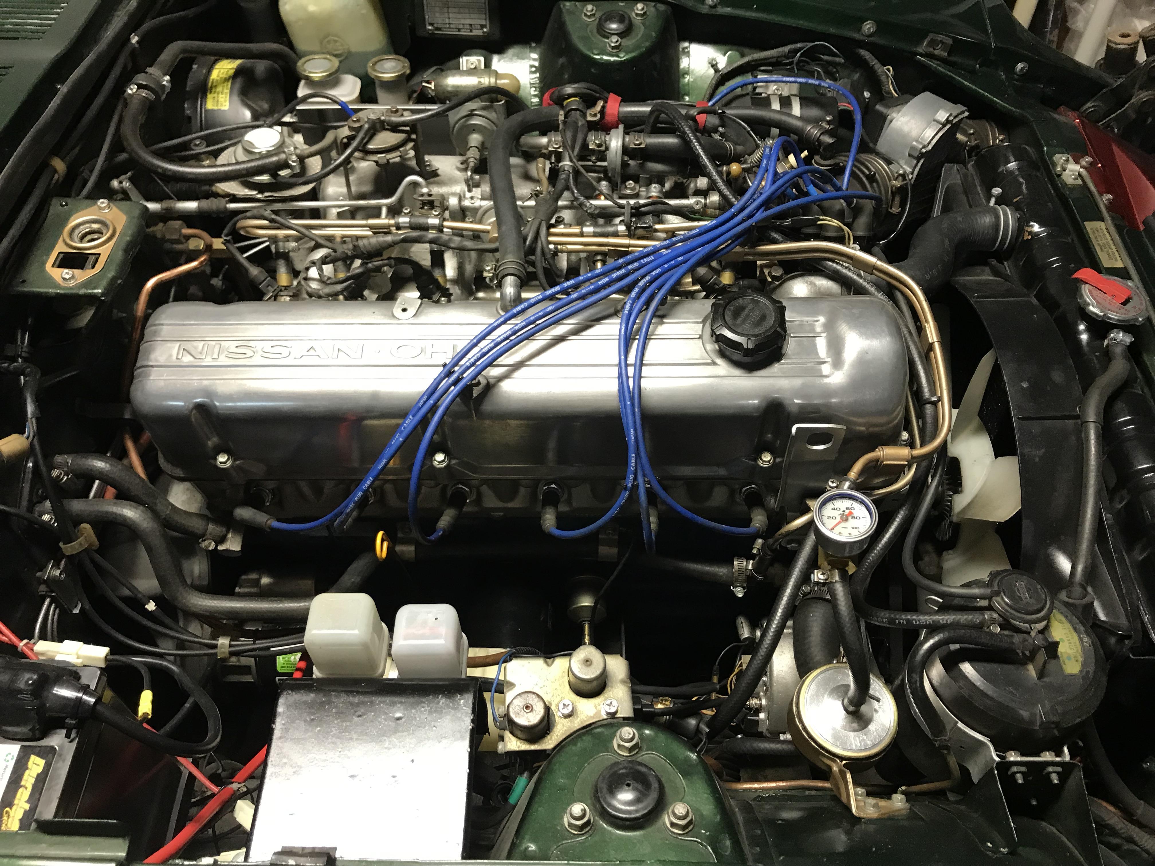

March 31, 20214 yr comment_618976 fyi, another possible cause for low fuel pressure is clogged fuel lines, make sure your pump is not having to work too hard to get the fuel in the 1st place. the fuel should siphon thru the supply line when disconnected from the pump lnlet. If it does not you have a restriction. check this before popping for a new pump. There is also the possibility of poor electrical supply to the pump itself (thru wire and relays), check the voltage AT the pump. There will be losses along the way but you should still see at least 10v with the key on, engine off, pump running. It will prob be higher if you test with the engine running (since the voltage will be closer to 14v at the battery. I tested my by observing the voltage key in start engine off, using the start position with the solenoid disconnected to get the pump running using the start circuit. Make sure you have good solid hookups to the pump. 1975 Datsun fuel pump voltage drop - YouTube Edited March 31, 20214 yr by Dave WM Link to comment https://www.classiczcars.com/forums/topic/65210-280z-starting-problems/?&page=4#findComment-618976 Share on other sites More sharing options...
