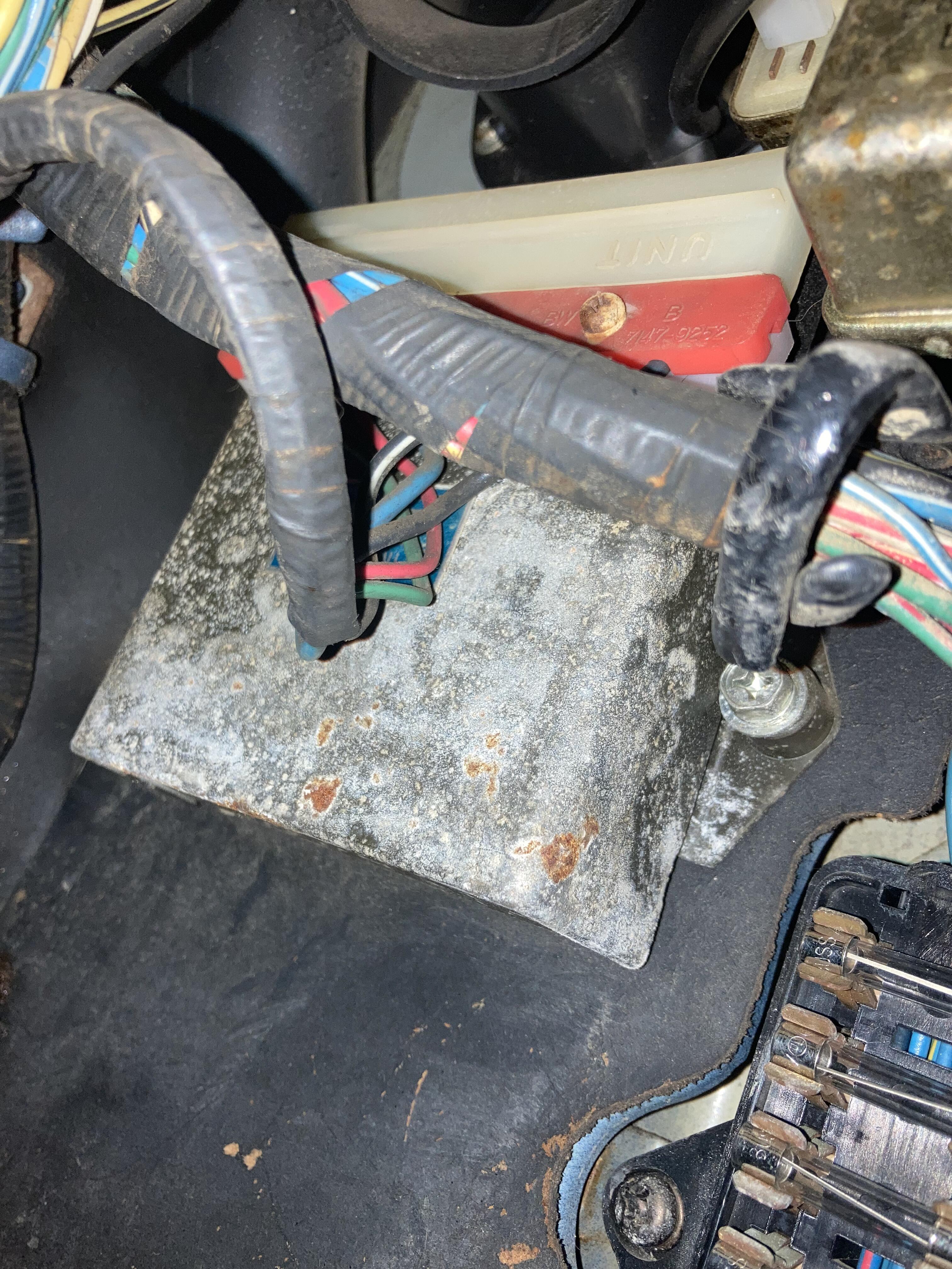

      However, I still have a problem with how smooth the motor runs. At idle it still bucks and jerks like it has a misfire and with the exhaust off the misfire is clearly audible. I can notice the engine bucking till about 3000 rpm, to where the motor seems to run smooth. Now as a last ditch effort to see if it was still fuel, I pinched the return line to see if it would smooth out. All that happened was the idle ran higher (with fuel leaks beginning to sprout), but still had the consistent stumble, so I doubt fuel pressure is an issue. I also want to note that I tested the fuel injection control unit, and all of the FSM tests checked out great.

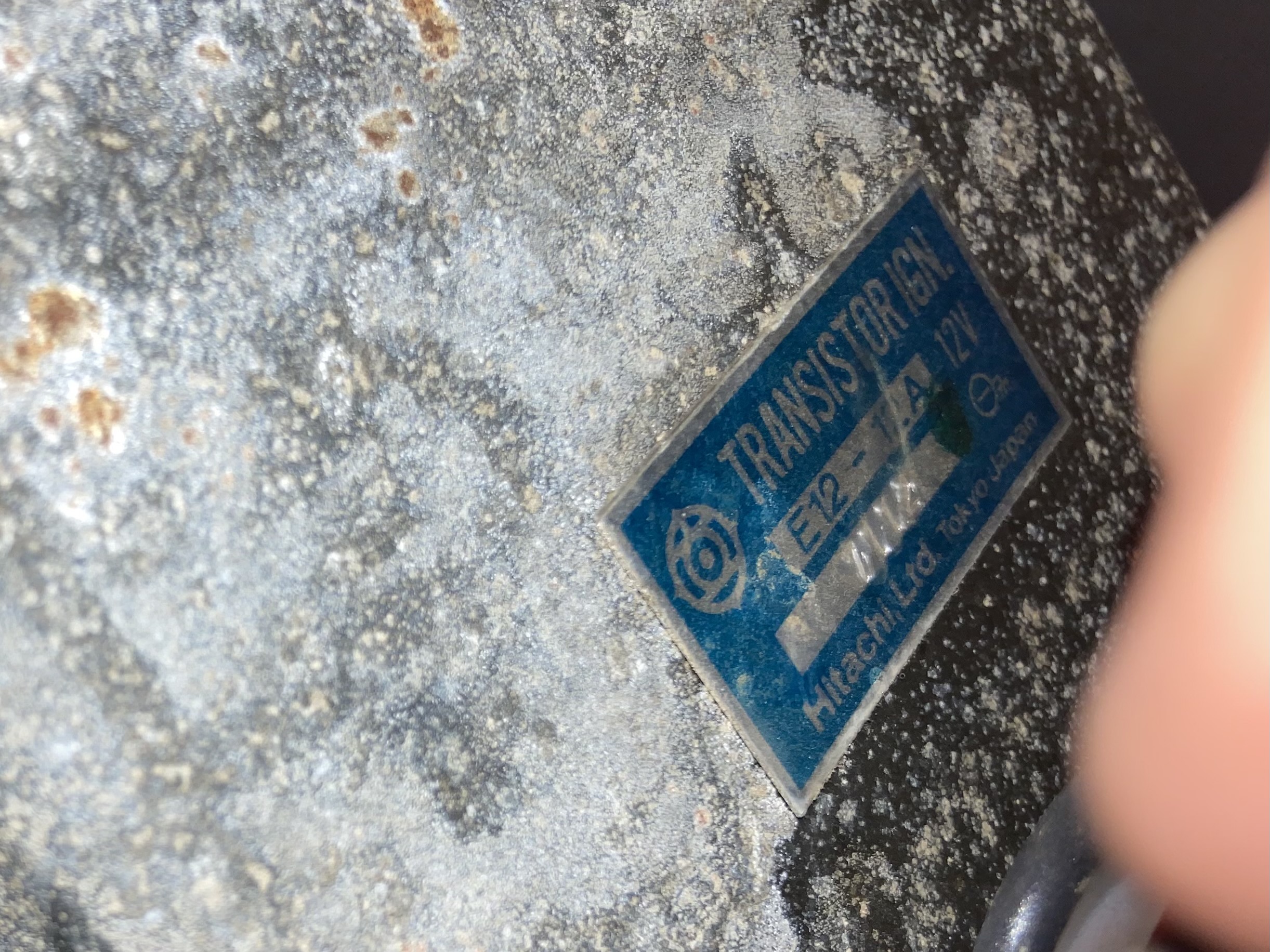

       This makes me think it must be spark. However, I have a new distributor cap, spark plugs, coil, spark plug wires, and rotor. So the issue must be more complicated. I was thinking that it possibly could be the distributor? It has a small amount of side by side play, but I gap checked everything and it was almost perfect. So I am wondering if it is the transistor ignition unit on the passenger side kick panel. Does anyone know how to test this. I looked at it, and it looks pretty nasty. What are the signs of one that has gone bad? Tell me what ya'll think.
