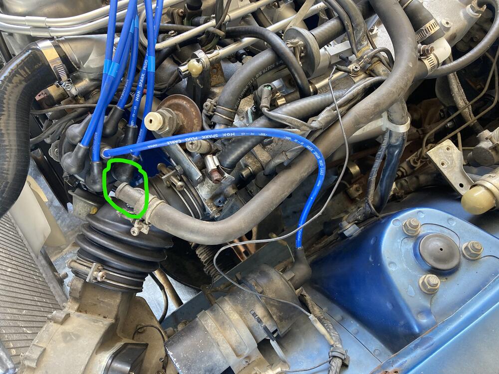

November 13, 20213 yr comment_631461 I that an open ended "T". Link to comment https://www.classiczcars.com/forums/topic/65230-1977-280z-efi-nightmare/?&page=15#findComment-631461 Share on other sites More sharing options...
November 13, 20213 yr comment_631464 1 hour ago, kickstand80 said: I that an open ended "T". No, it's fine. They sealed off the other end (the end you can't get a good look at) with a brazed on cap. Not sure why they felt like it needed to be that complex, but that's what they did. Link to comment https://www.classiczcars.com/forums/topic/65230-1977-280z-efi-nightmare/?&page=15#findComment-631464 Share on other sites More sharing options...
