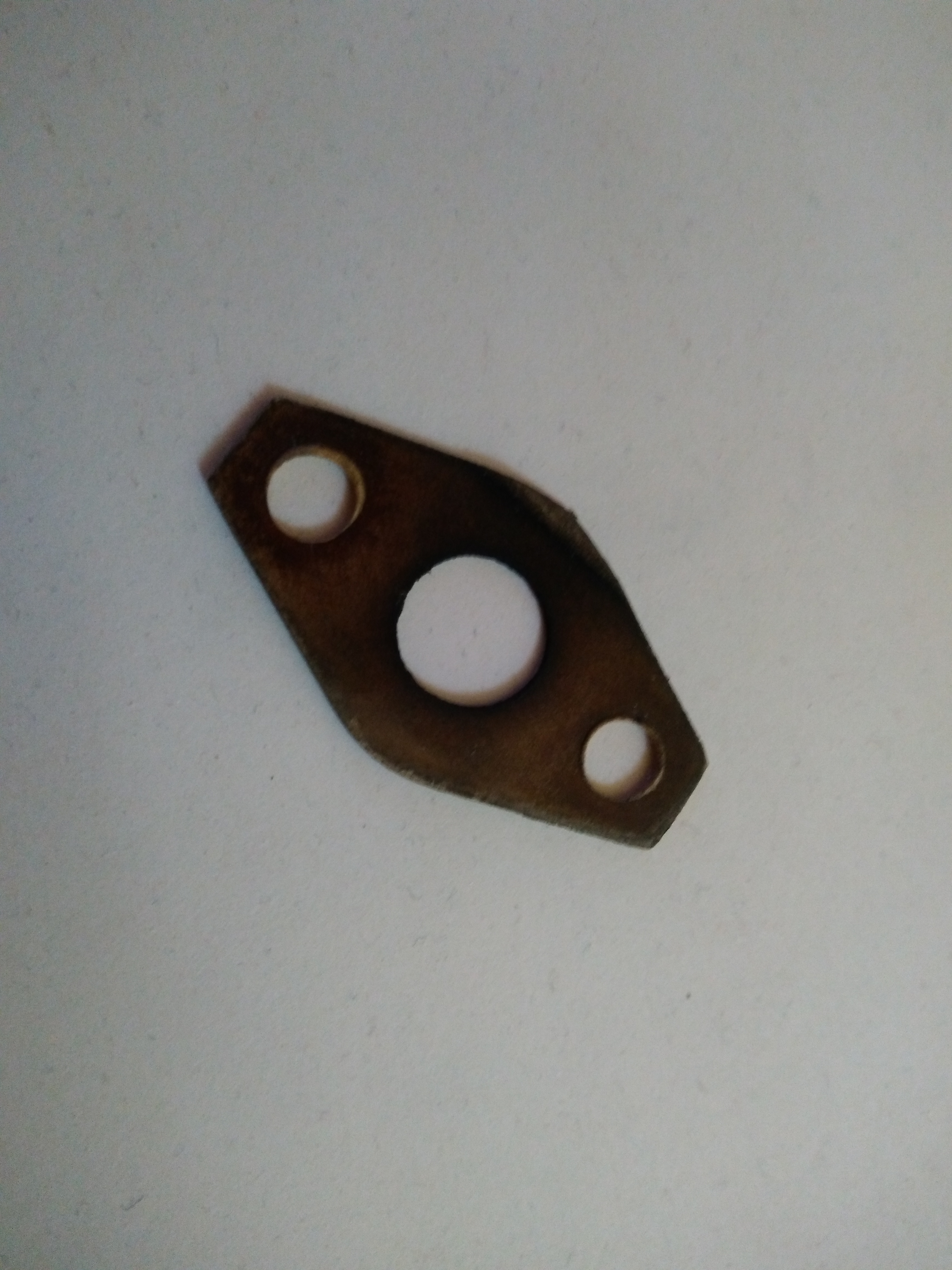

Just pulled it off to double check. Behold... no gasket 🙃  I am amazed the car even ran haha. With all these leaks adding up it had to of had literally zero vacuum.
Looking online I could not find a gasket for the AAR, only for the CSV. I did see there was a gasket for the CSV luckily. Does anyone know where to get the AAR gasket from? Only place I could find it was on MSA and it was unavailable.
Edited by ckurtz2
1 hour ago, Mark Maras said:
I've used a cereal boxes, scissors and a hole punch for paper to make gaskets similar to that. I coat the gasket with a bit of oil and assemble. I've never had one fail.
You're who I learned that from!
Take that elbow off and lay it on whatever you choose and lightly tap an impression on the material. Cut it out with an exacto knife and a hole punch.
