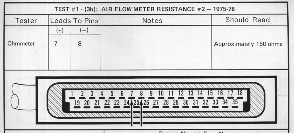

May 2, 20213 yr comment_620921 I'm not sure where you're getting your specs. from. AFM Test #2 in the 1980 EFI book says ~150 ohms, not zero. And 60 ohms is the typical resistance of a relay solenoid so I think that those are probably right also. And, yes, leaking injector seals would be a big problem. Those are kind of hard to install wrong but it does happen. Lube them up well and maybe install each injector separately before installing the rail. It's tempting to try to do it with them all on the rail but it can cause problems, especially with the three piece 77 rail. Make sure that the injector securing pieces are not cracked and that the screws are giving good clamping force. Intake manifold torque values are in the FSM, probably in the engine Mechanical chapter, but I remember something like 11 ft-lbs. It's like one hand on a ratchet wrench tight. Here is AFM Test #2 on page 75 of the 1980 EFI book. 20 hours ago, ckurtz2 said: AFM #2: Fail 183 ohms. Should be 0 Link to comment https://www.classiczcars.com/forums/topic/65230-1977-280z-efi-nightmare/?&page=6#findComment-620921 Share on other sites More sharing options...
May 2, 20213 yr Author comment_620922 24 minutes ago, Zed Head said: I'm not sure where you're getting your specs. from. AFM Test #2 in the 1980 EFI book says ~150 ohms, not zero. And 60 ohms is the typical resistance of a relay solenoid so I think that those are probably right also. Ok that's good to know. I got my specs from 280z EFI Bible . Who knows it may be wrong. The test I am talking about was the AFM #2 or 3b. I guess it says small resistance, but I am not sure what it considers small. Also thank you @Zed Head for listening to me. I know I am posting a ton, but it is a good way for me to log what is happening as I go along, and any advice given has been super helpful. In addition, I can confirm that one of the injector seals was leaking (nearest the front of the engine where I heard hissing). It had a big tear across the small o-ring. In addition, I spilt water all over the intake and let it dry before I loosened any bolts. I hoped that the water would find its way around the manifold and seep into areas where the gasket was leaking. It turns out that a large part of the intake gasket was moist where I could hear the engine hissing. Do you think it's possible the gasket is bad here? the nuts were torqued on pretty tight, so I don't think it was too loose, but I could have been wrong. I actually think it was way over torqued. Here are some photos of what I mean. On the intake itself, you can also see where fuel seepage was happening. If I over torqued things is the gasket reusable? I put it on in January as new. Edited May 2, 20213 yr by ckurtz2 Link to comment https://www.classiczcars.com/forums/topic/65230-1977-280z-efi-nightmare/?&page=6#findComment-620922 Share on other sites More sharing options...

May 12, 20213 yr comment_621523 On 5/1/2021 at 3:44 PM, Zed Head said: When you moved the AFM vane you were adding fuel. Seems like a vacuum leak somewhere, or the typical "lean AFM/electronics" problem. The "temp sensor tweak" is the cure for that. Not sure what's going on with your voltages. Are you sure there's not a decimal on the display? What kind of meter? http://www.atlanticz.ca/zclub/techtips/tempsensorpot/index.html This modification really is worth trying. It has worked for many many 280Z owners. The hissing might be the FPR. They hiss as fuel squeezes through. Link to comment https://www.classiczcars.com/forums/topic/65230-1977-280z-efi-nightmare/?&page=6#findComment-621523 Share on other sites More sharing options...
May 13, 20213 yr Author comment_621533 @siteunseen now that you mentioned it that had me thinking. Took a peep though and all looked good @Zed Head that tweak is very intriguing, and I won't hesitate to use it as a last resort. However, for now I am trying to get the system to function as it should without any extras, but if she is too stubborn I'll just have to do it haha. Now, I pulled the AFM to give it a nice "bench test" instead of going through the car's wiring harness. Thought it would give a more accurate result. Everything was pretty much the same! However, between pins 7 and 8 I was reading 182.2. It is supposed to read "approximently 150ohm". In addition, pins 6 to 8 read exactly 182.2 (supposed to be 180 so that one checks out good). I found it interesting how both of these tests are the exact same resistance. What could that mean? What is the function of pins 7 to 8? Simply put, pins 7 to 8 have about 21.3% more resistance than it should, which isn't "approximately 150ohm". I am not afraid to put a new AFM from zcarsource on her, I just want to hear honest opinions of you think I should get it done. Link to comment https://www.classiczcars.com/forums/topic/65230-1977-280z-efi-nightmare/?&page=6#findComment-621533 Share on other sites More sharing options...
