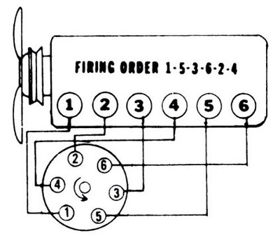

I stand corrected. I am praying that this might rest the demons once and for all. I had the firing order different, adjusted after the following photo I attached. Is this wrong? If it is I wonder how the hell this car ran enough to even try and idle.
Now that I look at it though, the order seems the same, the distributor just seems rotated on one of the photos. Correct me if I am wrong

Actually, not trying to one-up anyone, but the vacuum advance on the Z's is ported vacuum.  So it's closed at idle, no vacuum.  But, if you have the vacuum advance hose on the wrong port you might get full vacuum advance at idle.  Which would screw up your timing light reading and your idle timing.  I'd hook up the light, then remove the vacuum hose.  If timing changes the hose is on the wrong port.
If you're still not sure of firing order and timing, then set your damper pulley mark at zero to ten and remove the distributor cap.  The rotor should be pointing at whatever terminal is "number 1".  Move your number one wire to that terminal and check your timing again.  If things are screwed up then you might have a problem with your damper.
Make sure you know where you started so you can at least get back there if things don't work.
