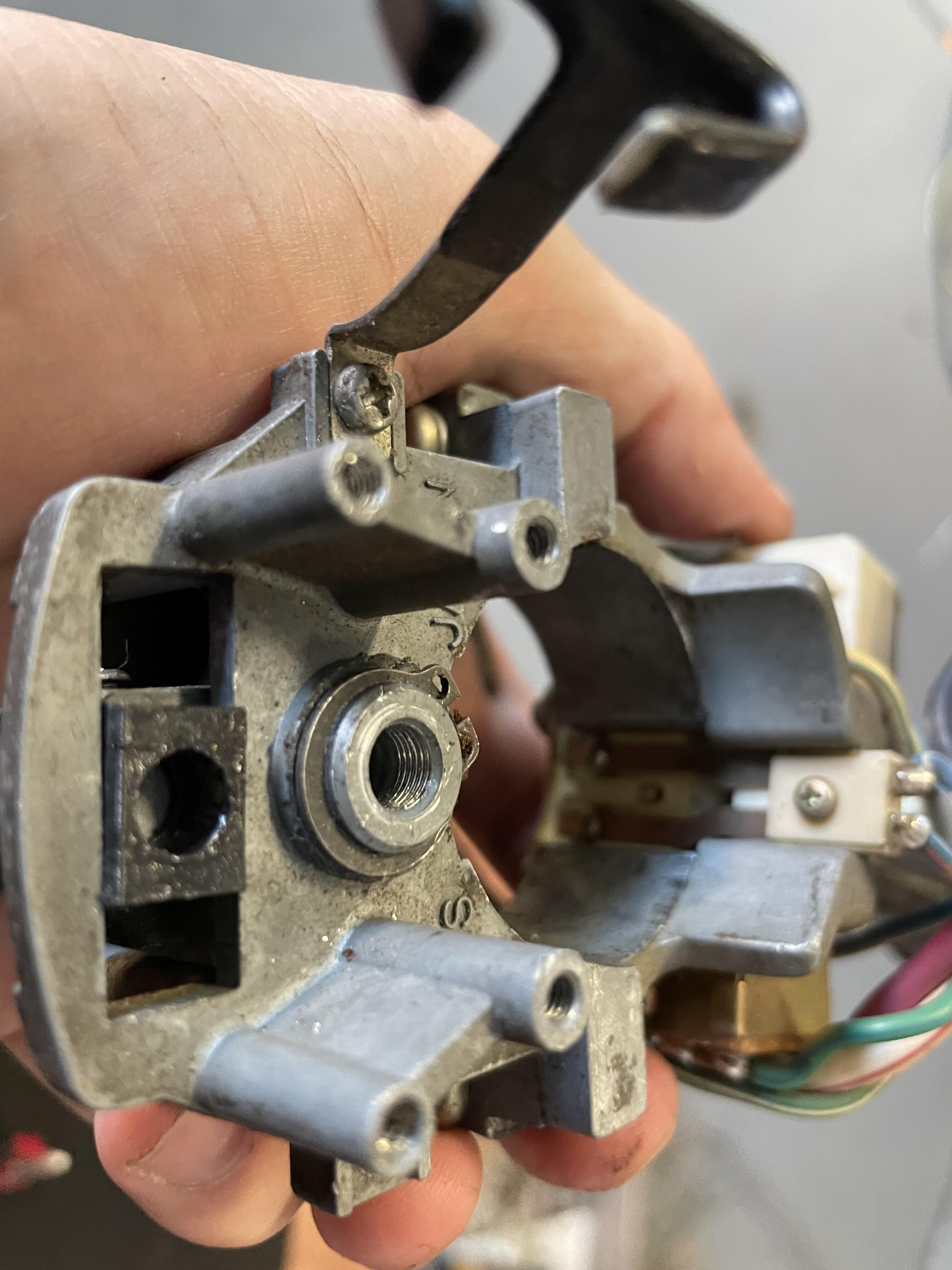

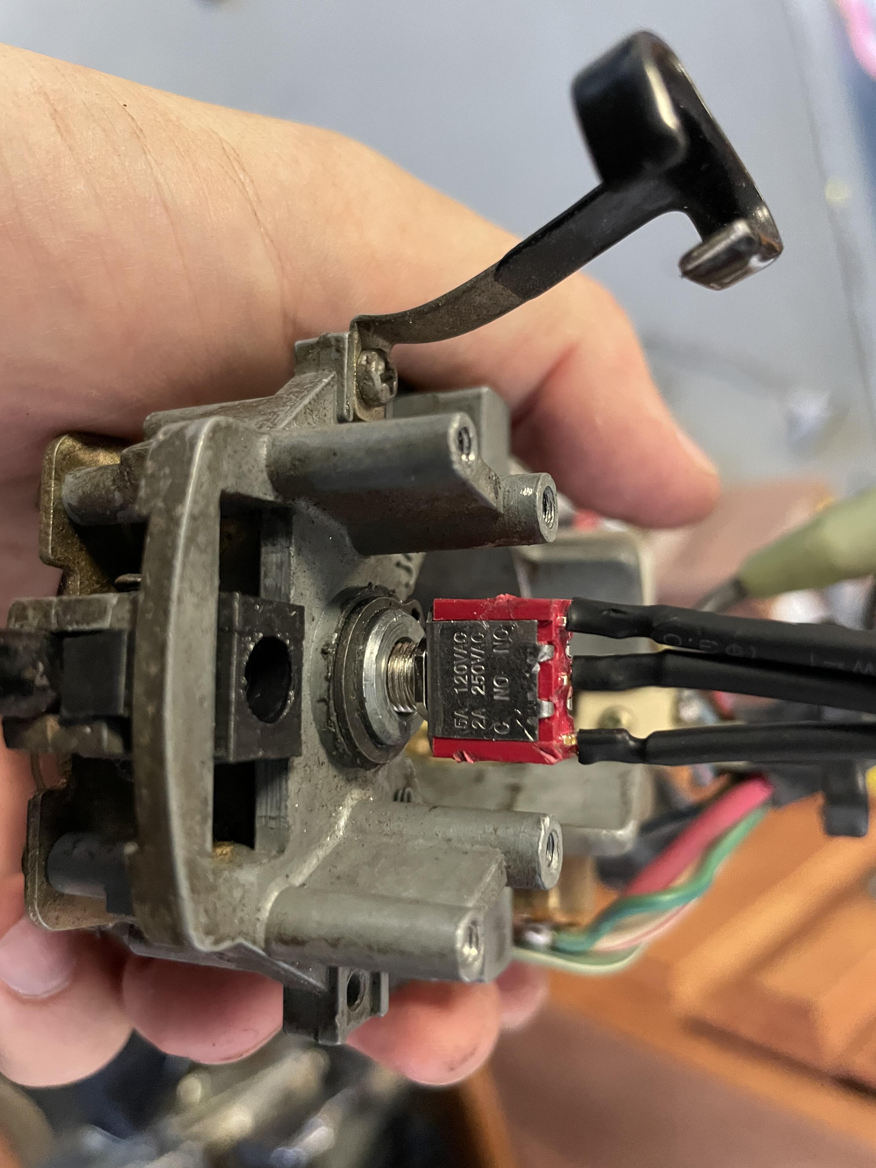

Ah, I remember now why I didnt use the original stalks for headlights! The high beam switch is baked into the turn signals. Pull the lever to activate. I took a wild guess at a 3 way switch and to my amazement, it fits perfectly. I needed power to 1 pole of the switch and always be on for a second pole (Low Beams) and when pressed, it would swap to a third pole (High Beams). The trick was I needed the switch to be a momentary one as well. So that when I release, it went back to my low beams and did swap between the two outputs for each press. This switch accomplished exactly what I needed and the size needed no modifications either:
https://www.amazon.com/gp/product/B079D923V9/ref=ppx_yo_dt_b_asin_title_o05_s00?ie=UTF8&psc=1
Just be careful when you solder this little bugger. I put too much heat at first and I think I ruined the contacts. With my wires soldered up, I could work with mounting. I originally planned to 3d print a mount similar to my turn signal switch. But when aligning everything up I was shocked at how well the threads matched the rear of the stalk. A quick tap:
and viola!
There is a satisfying click when pulled as well so you know when it is on or off. Not mushy at all. I still may 3d print a brace since I have the provisions for a mount and its a super simple shape. But for now I am not worried about this coming loose.
Now my original stalk works again for turn signals, headlights, and high beams!

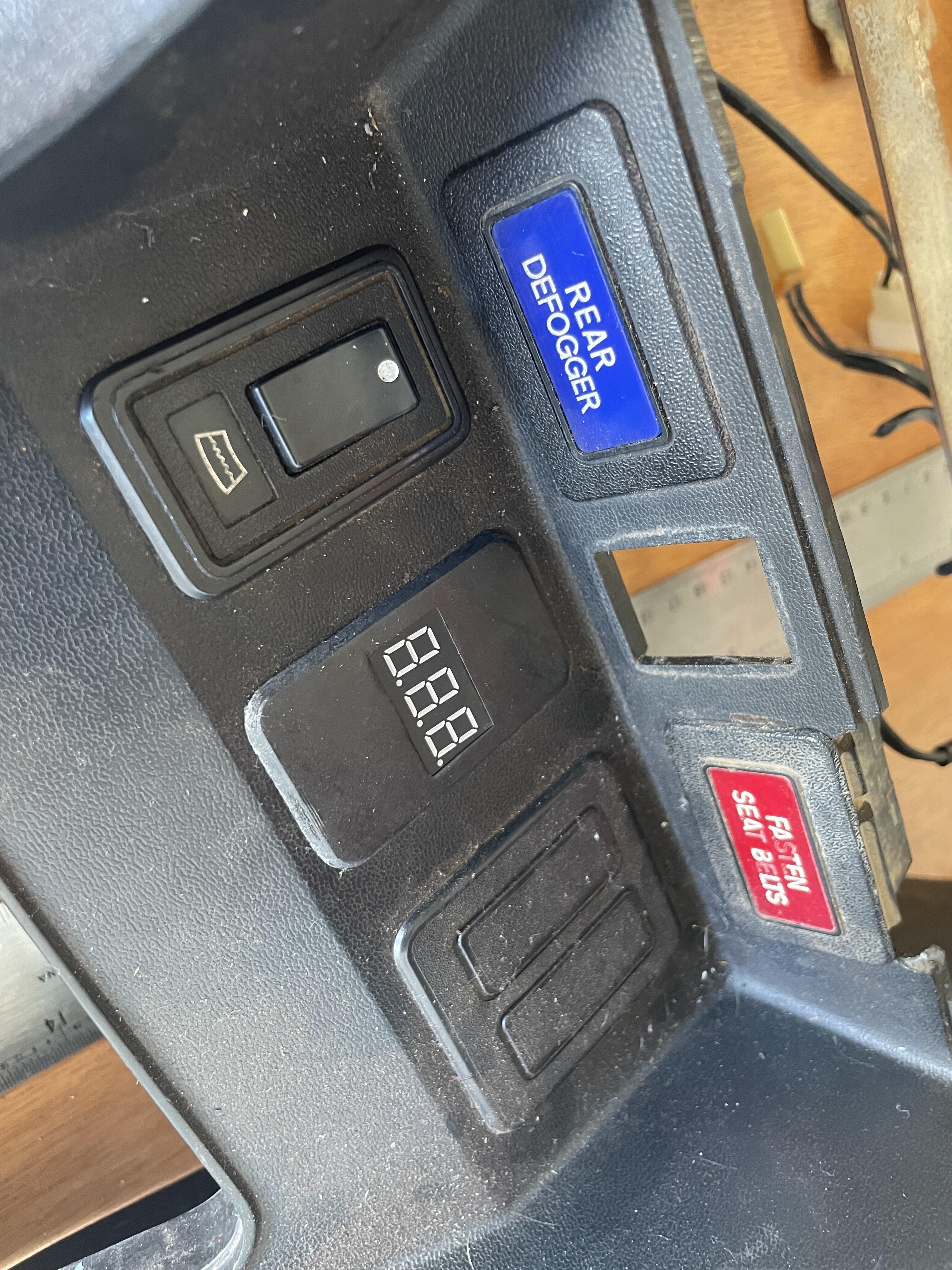

Lastly, a quick model for my center console. I was missing a plate next to my rear defogger and created an adapter for a volt meter. Nice to have since my wiring is all new and I can monitor it at all times. If you recall, I took out my shunt so I wont be using the amp meter. I may look into adding a small USB port here as well, but I dont want to get too cluttered up. Sorry for the dusty console 🙂

And about your voltmeter placement... You aren't missing a plate next to your defroster switch. You're missing your HAZARD switch. right?
I’ve never thought about leaving them on actually! I rarely ever use high beams and if I do it’s mainly for signaling people. If I find I want to leave them on I could always go to a switch that swaps between two outputs 🙂
Thats right! I wasn’t sure what that spot was meant for.
