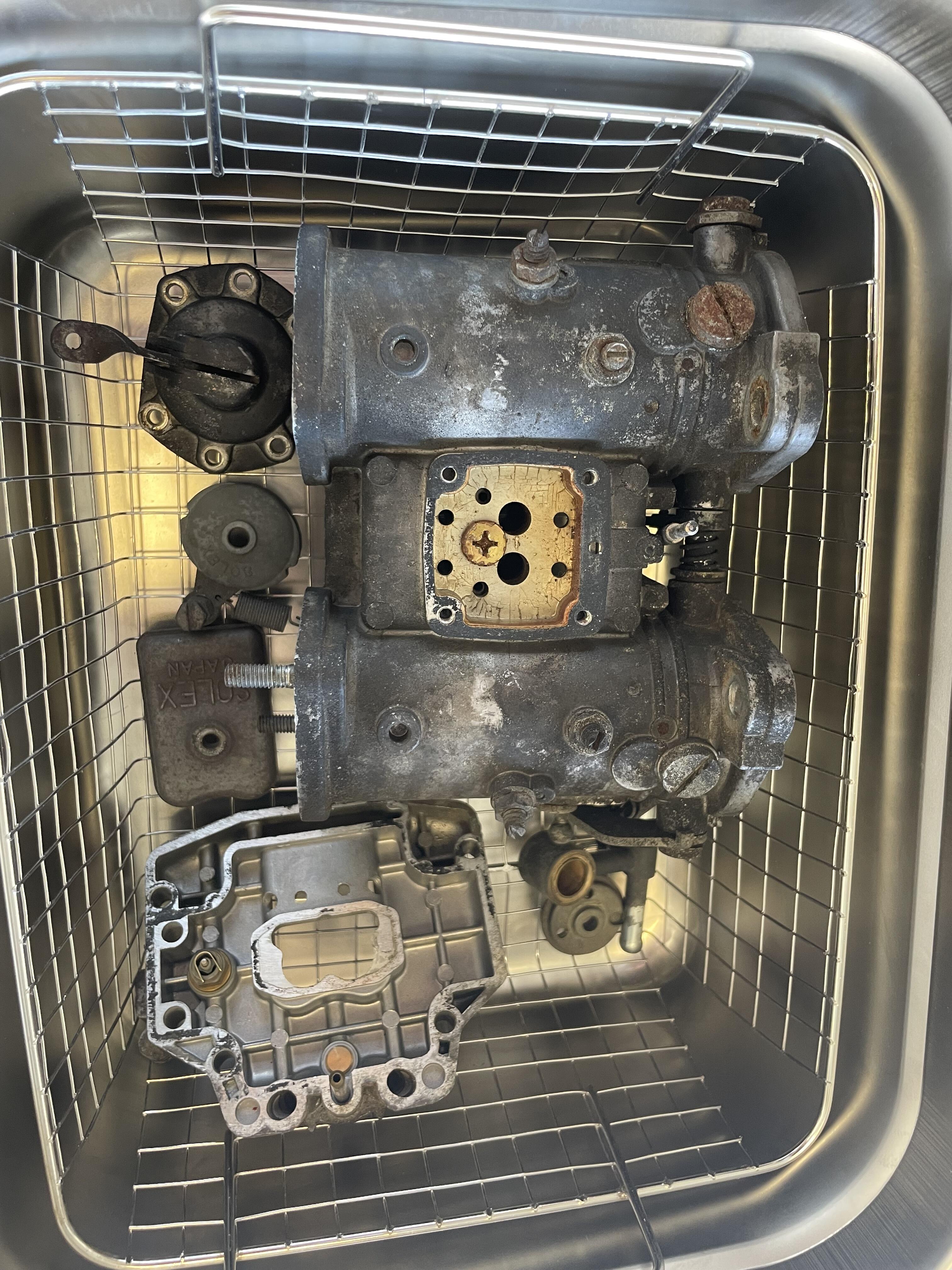

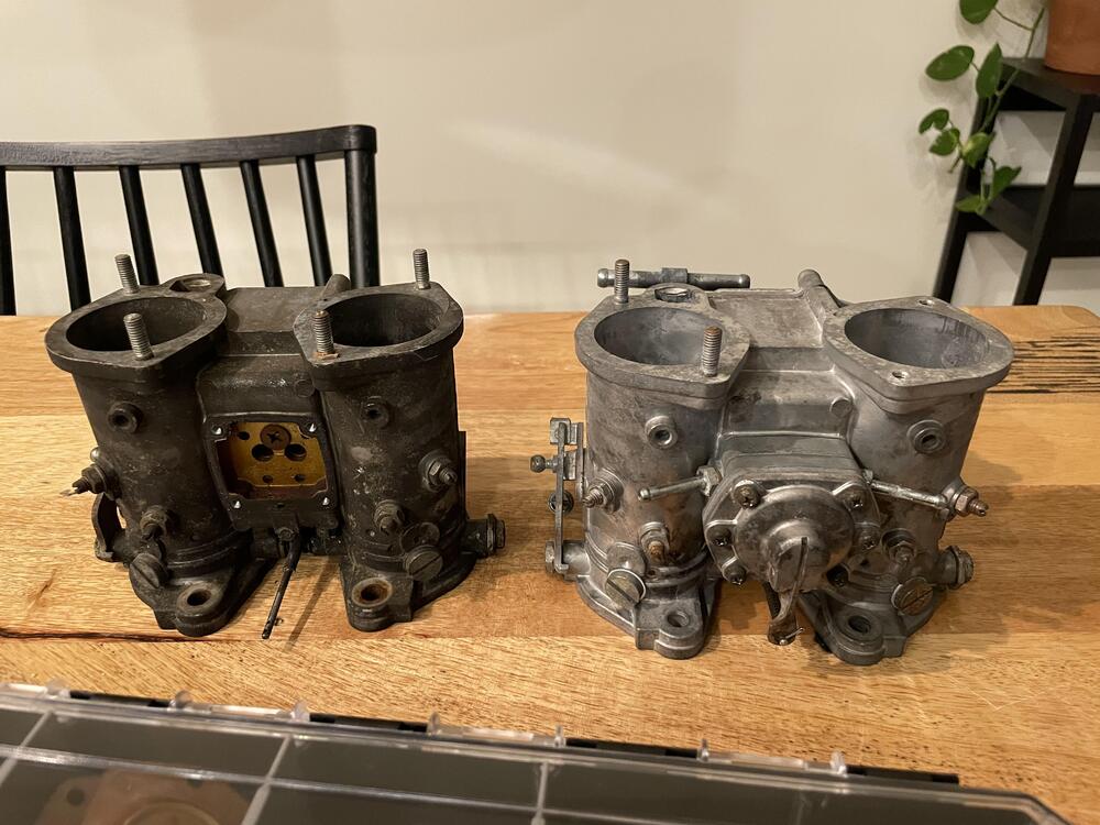

Now that the wiring is done, I was able to start working on cleaning up the Mikuni's. I purchased an ultrasonic cleaner large enough to fit the main body of the Mikuni and started to disassemble. They were pretty nasty and one even had some old gas that smelled horrible! I didn't take too many photos but here are a few:
The first carb going in! I had enough room for cleaning almost an entirely disassembled carb in one shot with the 10 liter size. I used Simple Green Purple HD (safe on metals) mixed 1:3 to water. I set the temperature to 75 Celsius and ran it at 20 minute intervals.
They came out great. Now perfect or new by any means, but for a "set and forget" clean, zero scrubbing, I'm very happy!
If anyone is familiar with the PHH carbs, there is a check ball in the accelerator pump assembly that can get seized. 2 of my 3 were not moving when I started cleaning. They took almost a total of 2 hours of cleaning in the ultrasonic machine before they broke free. But it worked! I was worried as these are no longer in production.

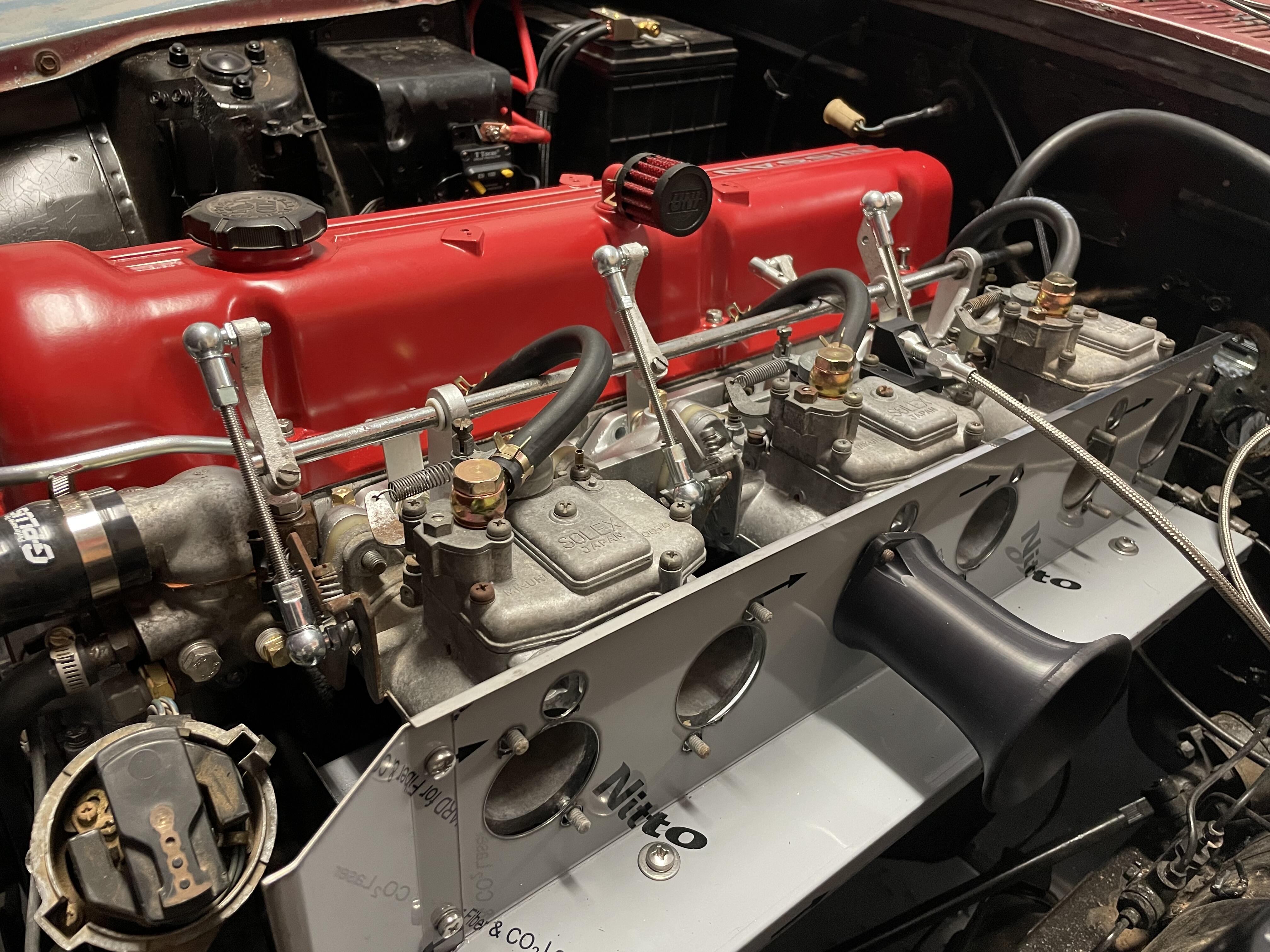

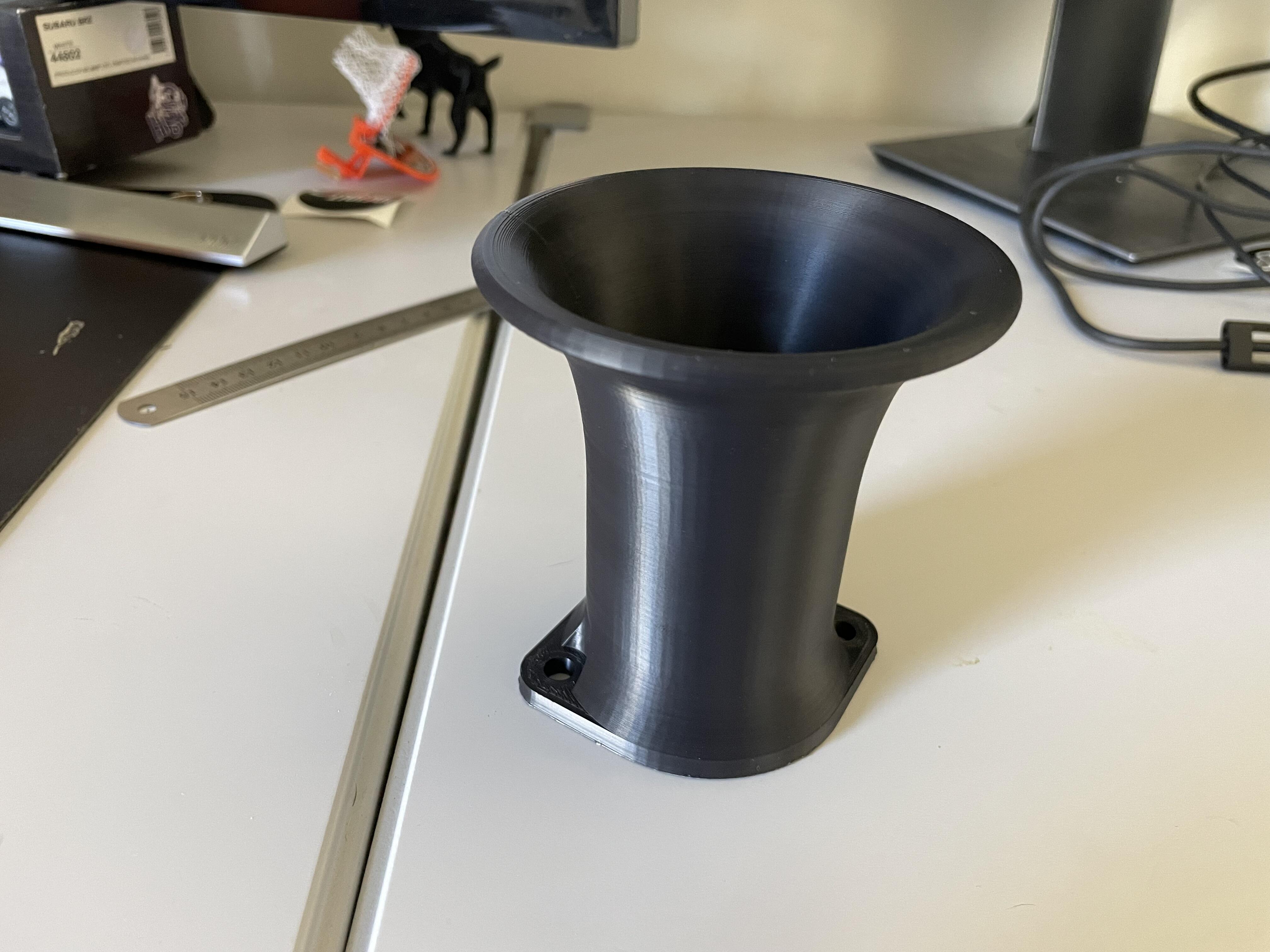

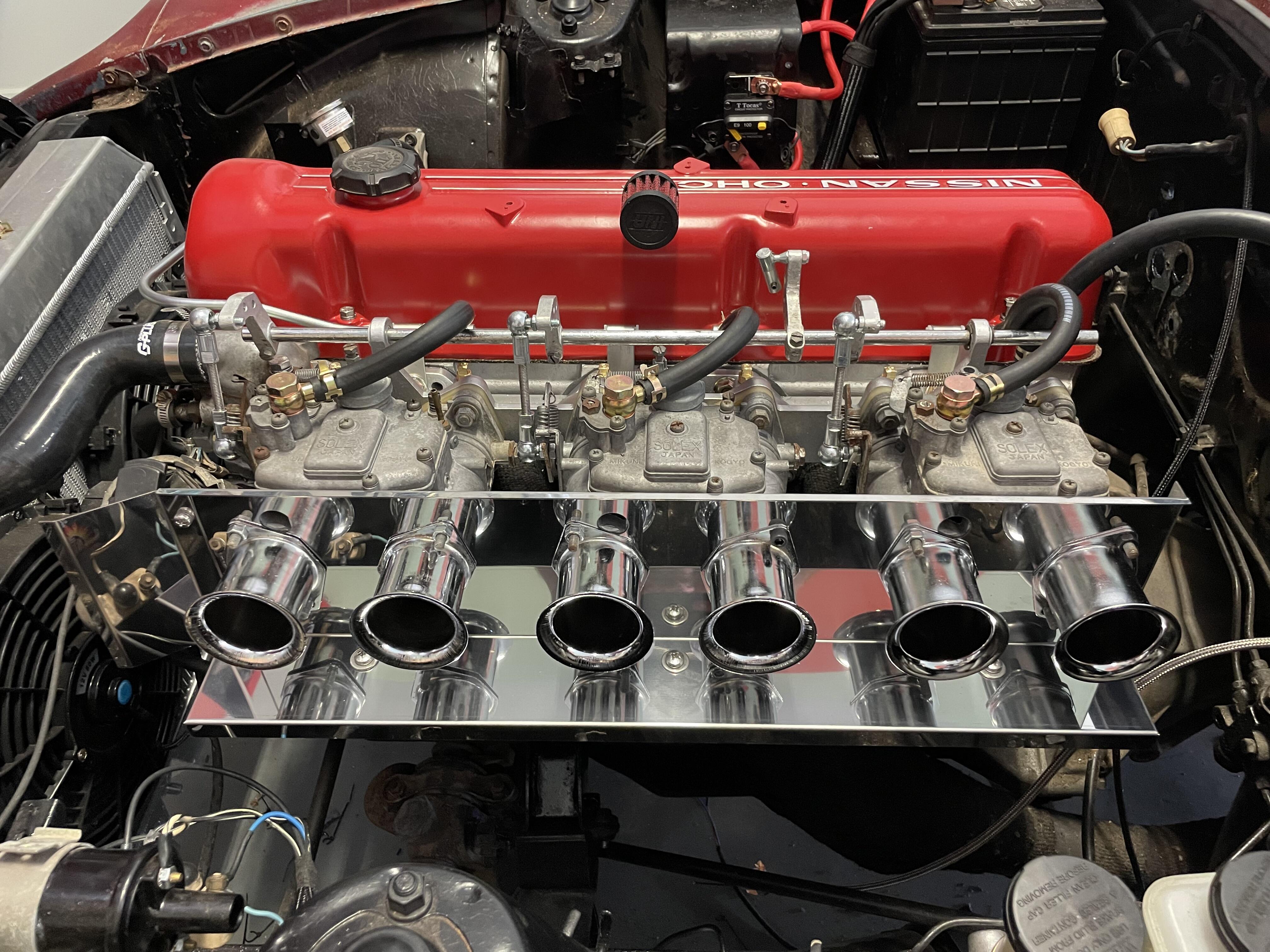

While I was cleaning, I finalized my velocity stack design and set my printer to work. I love how my first came out! This is ASA material which can withstand about 100C before deformation. It'll be interesting to see if the header wrap and heat shield is enough mitigation or not.
The first mock up:
But then I found a set of aluminum stacks for dirt cheap and I couldnt resist!! They look so good and I am glad I bought these. I still want to toy with the printed stacks as they are a more ideal length (100mm vs 55mm). Maybe once I find the perfect design via printing, I will order a machined set.
I want to find angled banjo bolts. I dont like how I have to run excess line to prevent rubbing on my throttle linkage. These will work for initial tuning at least.

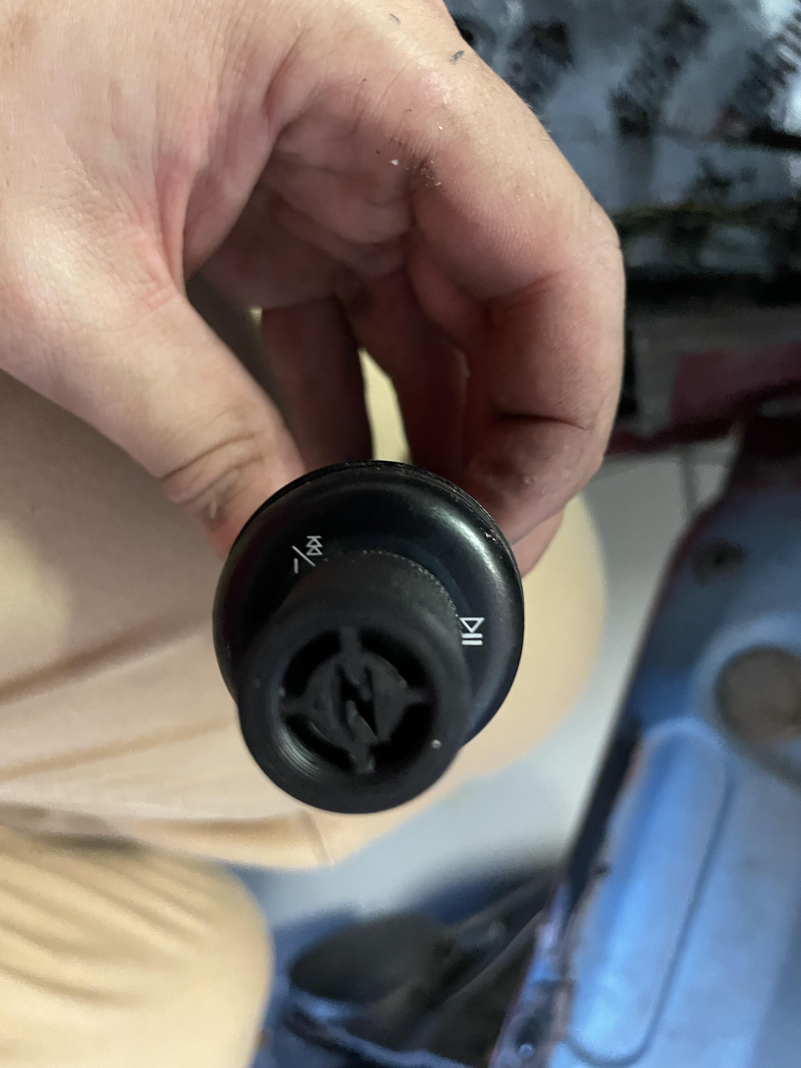

Lastly, I was bored and printed a new knob for my Bluetooth receiver for the car. I modeled it after the side Z badging:

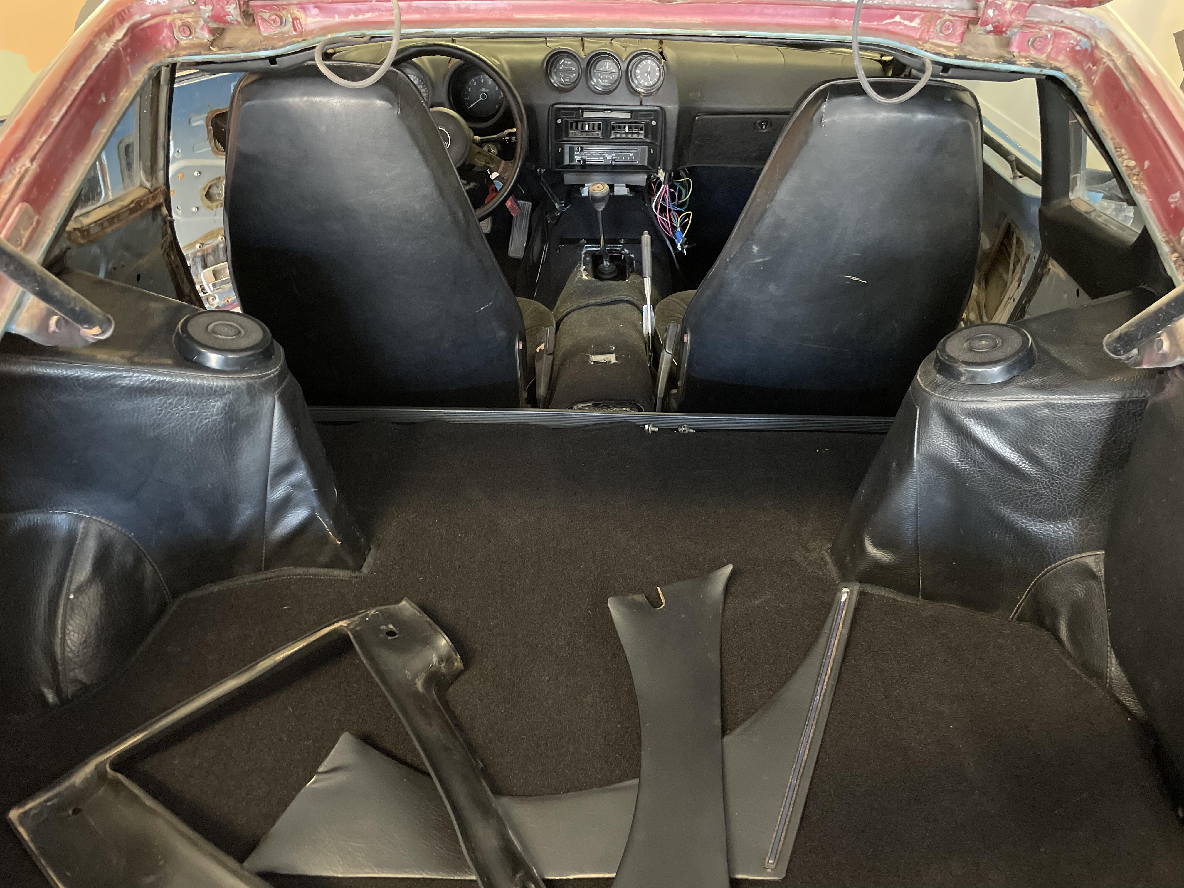

I cant wait to hear these run but first I need to get my interior back in. The carpet has arrived and I am letting it air out in prep for the install.

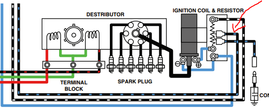

Lastly, I have one question for the wiring guru's. My ballast resistor is confusing to me. There is a Black/Blue wire that see signal only during cranking:
Why is this?
I did not notice this getting power only during cranking and supplied 12V during my test. The ballast became very hot after a a few moments (obviously because I wired wrong!) and I was not seeing spark. Disconnecting this wire gave me spark consistently.
EDIT: I found out why it is getting so hot. I ran it to GROUND not 12V power. So now that makes sense at least. But I am still confused as why this sees 12V only during cranking and if it is still needed. Thanks all

In the mean time I have been putting the interior back in as I get the pieces. Carpet is done minus the inner scuff plates. 31019CA1-734D-4FEB-A2A5-C90E13967384.jpeg

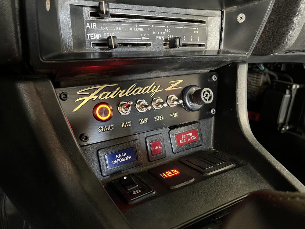

I finally got around to completing my switch plate and radio housing. I used a laser cutting service to get some plates printed. I played around with some materials and loving the Brass. Kinda old school mixed with new. Shines nicely with the sunlight.
Flipping my BAT switch to show the start light and volt meter.
The Z knob on the right is my Bluetooth radio. I’m glad with how it all came out. I have multiple cuts of the plates so I’ll toy around with trying to get a texture finish for the black to blend in better. I’m thinking wrinkle coat maybe?
