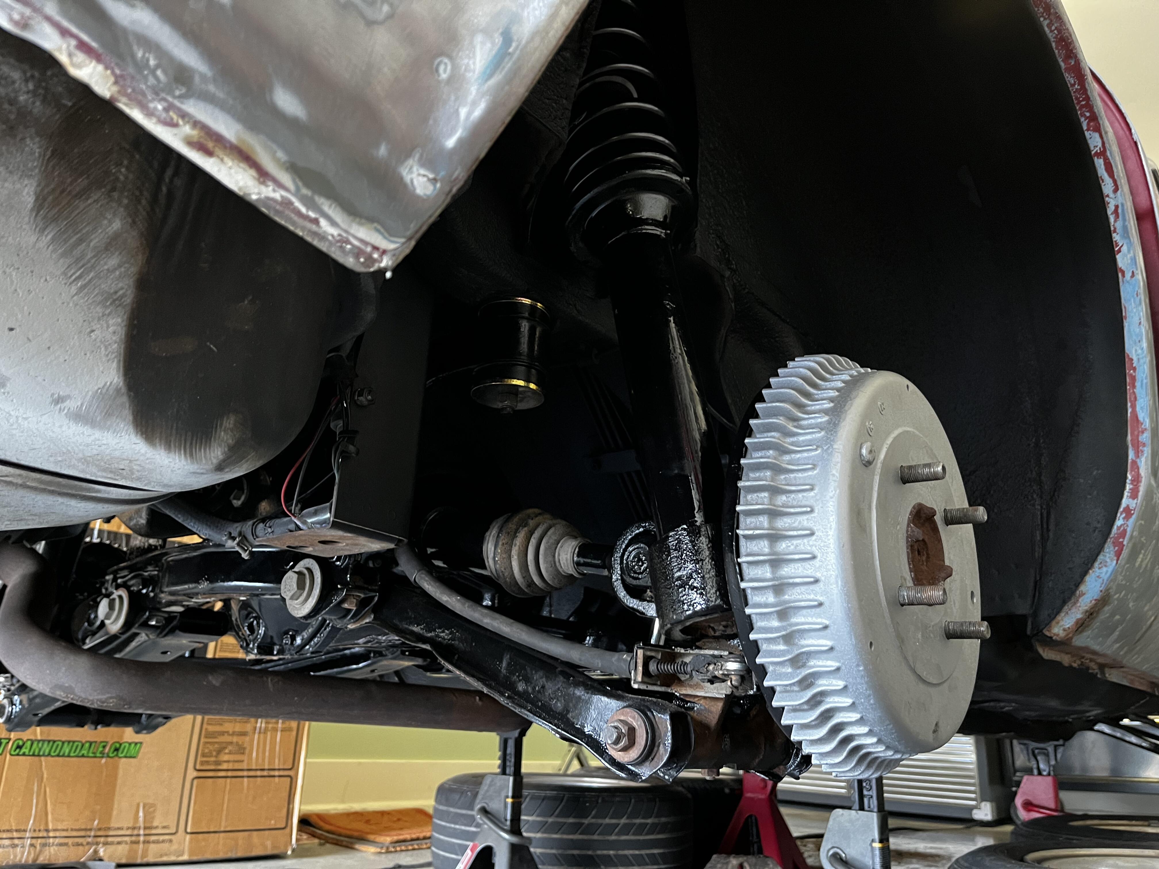

May 5, 20222 yr Author comment_640046 I can’t wait to try them out! I finished painting all the parts and removing the bushings. I’ve started to reinstall the front end and making progress but it’s definitely slower than removal! Link to comment https://www.classiczcars.com/forums/topic/65237-barefootdans-280z-build/?&page=23#findComment-640046 Share on other sites More sharing options...
May 5, 20222 yr comment_640055 Looks like you have a helper! Undercarriage bits look FANTASTIC. Dumb question: Do you need the camber adjustment kits when using lowering springs like the Eibachs? On 5/5/2022 at 3:41 PM, Barefootdan said: it’s definitely slower than removal! Absolutely! It's taken me 10x longer to reassemble everything than it did to take it all apart! Link to comment https://www.classiczcars.com/forums/topic/65237-barefootdans-280z-build/?&page=23#findComment-640055 Share on other sites More sharing options...

May 11, 20222 yr Author comment_640268 I was able to wrap up installing all the remaining suspension bits! Definitely not a fun job alone 😅 aligning the diff, lifting the strut assemblies, and that damn sway bar! Overall it went in smooth with only two hiccups. First being I installed the passenger side control arm upside my first time around. Second was the spindle pin does have a direction! I must’ve guessed correctly on the passenger side because when I did the driver side I noticed the locking pin wouldn’t line up. Needless to say, I think the spindle pin curse struck me on install since I didn’t pay my dues during removal. I still have some finishing touches before I can take a spin. Bleed the brakes, adjust emergency brake, torque bushings, adjust toe and camber. For those that have tightened the bushing bolts without a lift, any tips on reaching all the bolts with the car on the ground? I’m looking around to see if any friends or family have some ramps I can drive up as that was my first thought. Link to comment https://www.classiczcars.com/forums/topic/65237-barefootdans-280z-build/?&page=23#findComment-640268 Share on other sites More sharing options...
May 11, 20222 yr comment_640277 On 5/11/2022 at 5:13 AM, Barefootdan said: For those that have tightened the bushing bolts without a lift, any tips on reaching all the bolts with the car on the ground? I’m looking around to see if any friends or family have some ramps I can drive up as that was my first thought. I jacked mine up and then set it back down on four small moving dollies (from HF). Lifts the car up high enough to be able to get under it and also allows the suspension to squirm around to neutral position which is important when tightening the suspension bolts. Put a plank or two of 2 x 10 across these: Don't let your car roll out into the street on the dollies. Link to comment https://www.classiczcars.com/forums/topic/65237-barefootdans-280z-build/?&page=23#findComment-640277 Share on other sites More sharing options...
