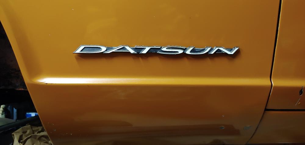

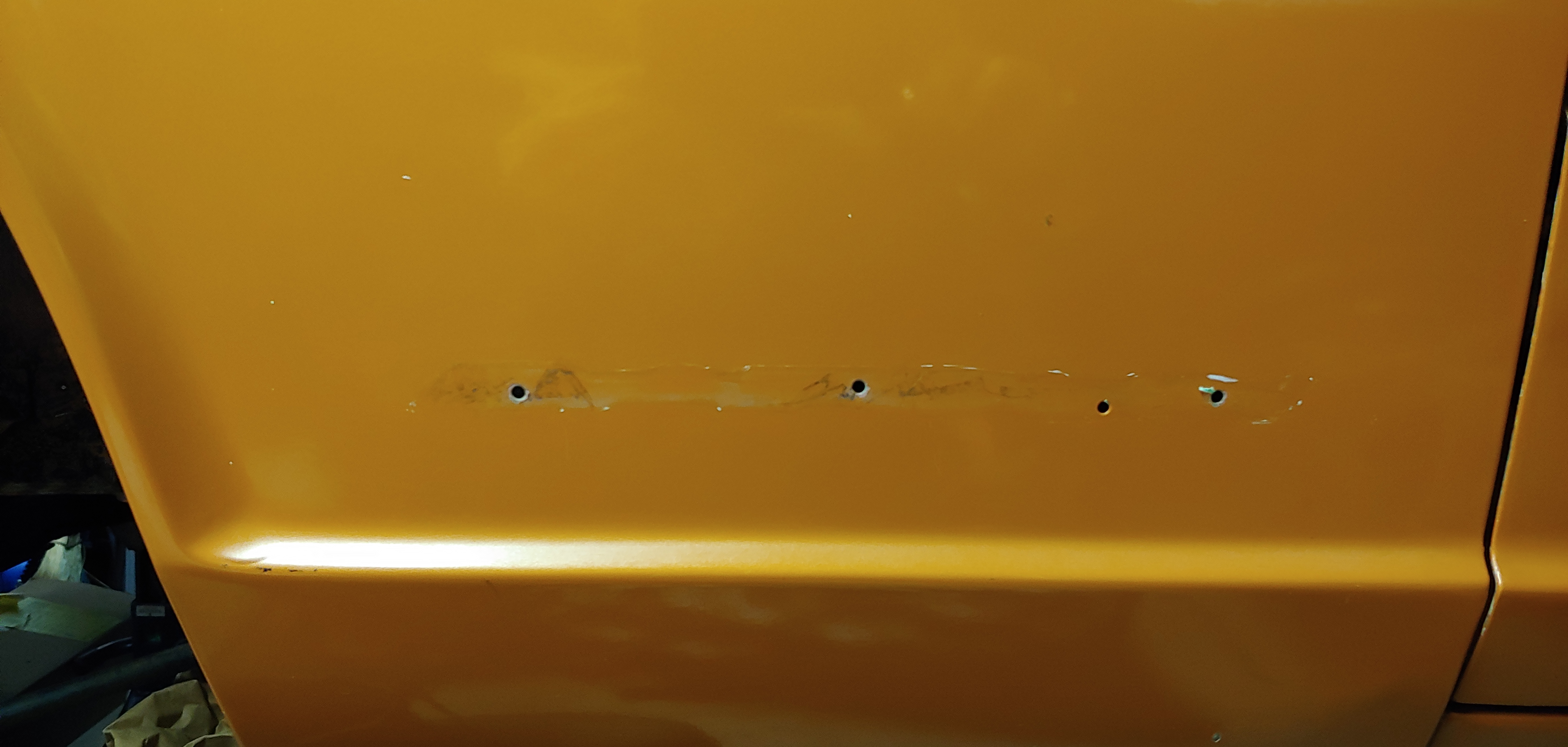

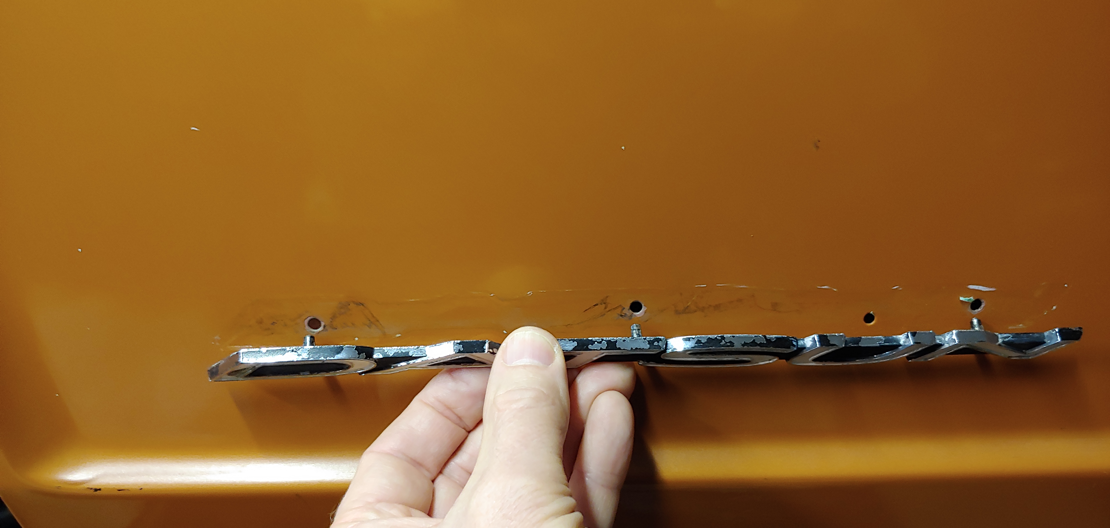

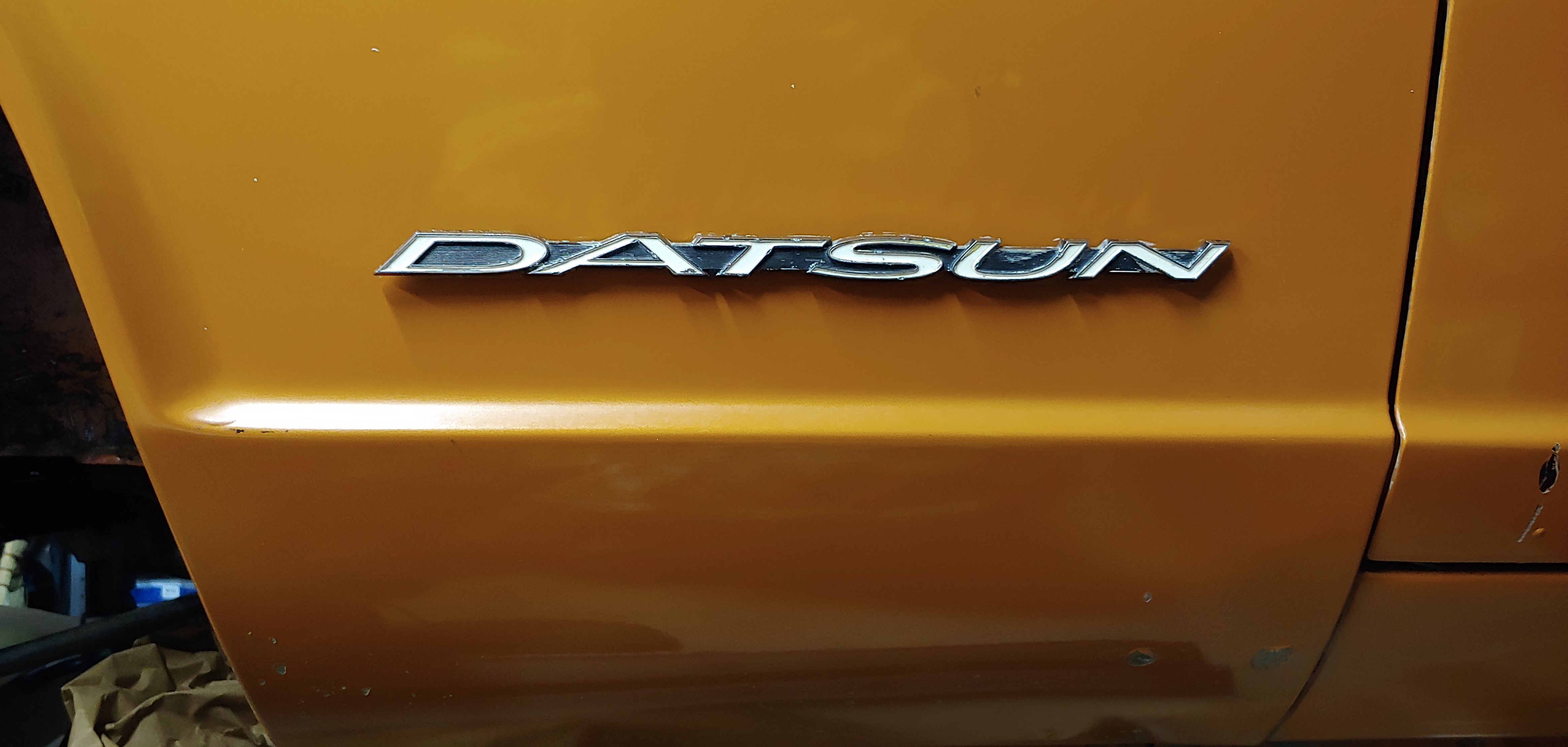

Just heading off to work but here are a few pictures. I can take some measurements tomorrow morning. Strangely there are four holes but only three pins on the emblems. Same but opposite on the right hand side. And of course the three pins are not in a perfectly straight line. The pin behind the "D" is slightly lower.
Here is a snippet from the picture @SpeedRoo posted in another thread of his RH OEM fender, it has same four hole pattern. My fenders are also OEM replacements that I purchased in the early eighties from my local Datsun dealer for my first restoration.

FWIW, here are the fender emblem hole measurements from my one owner, no accidents, 1971 240Z.
I used a precision micrometer and measured from the edge of each fender at the door seam gap to the center of the closest mounting hole.  I then measured from the peak of the ridge below the mounting holes to the center of each of the holes.  Measuring from the ridge peak is inexact as the peak is rounded, but I tried to measure from what I felt to be the highest point of the curve.
Driver's Fender:
3.87 inches from fender edge to mounting hole center
Mounting hole closest to fender edge 2.48 inches above peak of fender ridge
Mounting hole farthest from fender edge 2.34 inches above peak of fender ridge
Passenger's Fender:
4.25 inches from fender edge to mounting hole center
Mounting hole closest to fender edge 2.26 inches above peak of fender ridge
Mounting hole farthest from fender edge 2.43 inches above peak of fender ridge
The center peg on each emblem can be marked after locating each end pin hole on the emblem.
My car may differ from your car, but consider this as a starting point for your search.
Have fun!
Dennis
