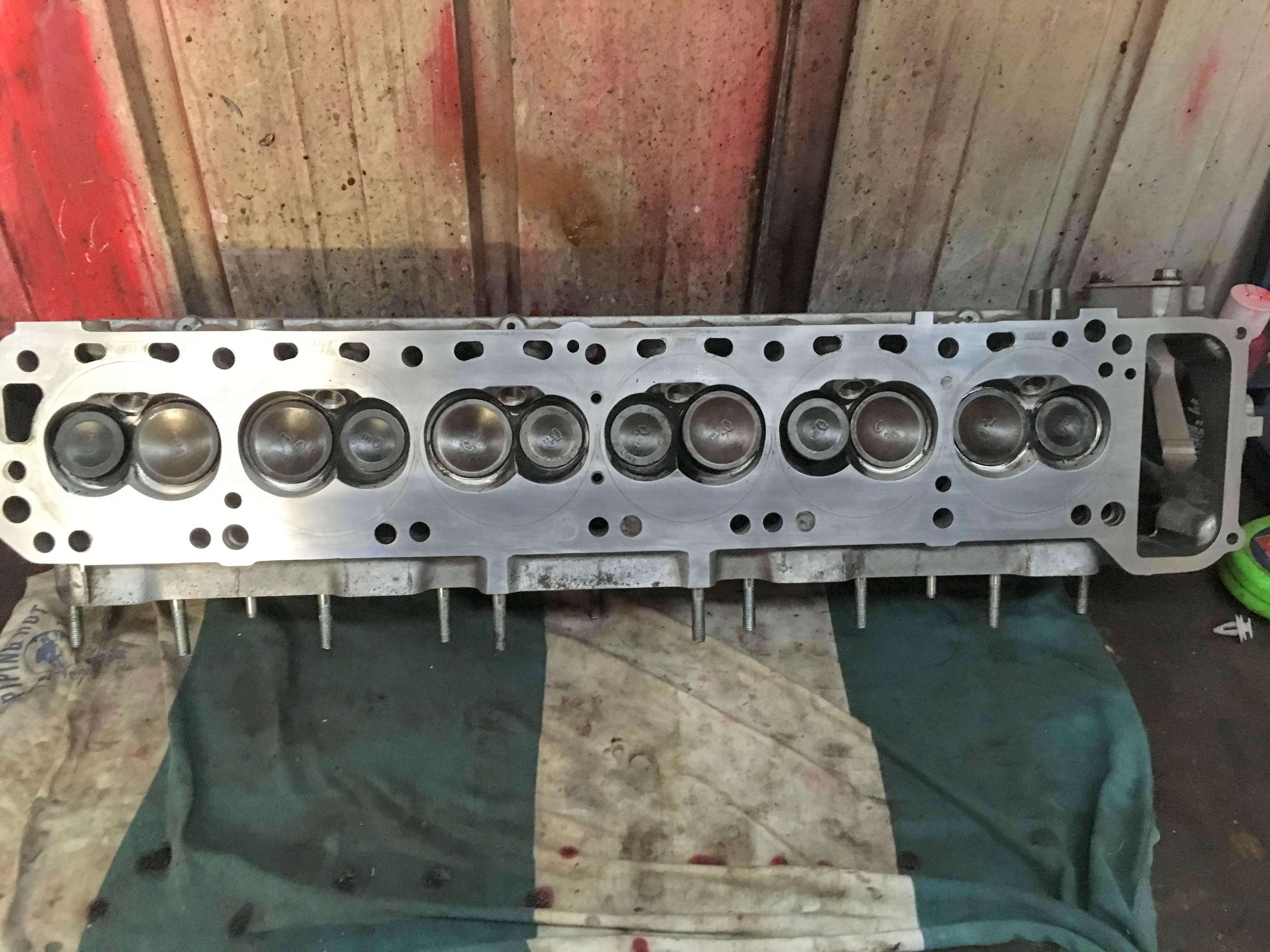

April 5, 20214 yr comment_619207 Yeah, my thought was welded chambers and grind to shape Link to comment https://www.classiczcars.com/forums/topic/65248-best-head/?&page=3#findComment-619207 Share on other sites More sharing options...
April 5, 20214 yr comment_619230 Yes! welding and grinding by someone talented, not me 😊 Link to comment https://www.classiczcars.com/forums/topic/65248-best-head/?&page=3#findComment-619230 Share on other sites More sharing options...

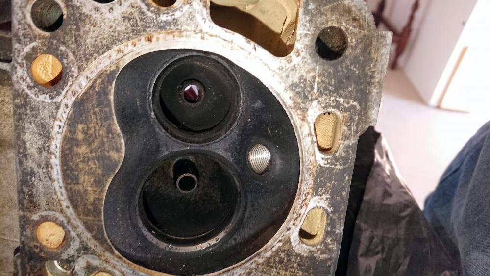

April 5, 20213 yr comment_619240 Jon, What's something like that worth? I've got a P90 here collecting dust that someone has done that kind of work to. Not quite as extensive, but similar. Link to comment https://www.classiczcars.com/forums/topic/65248-best-head/?&page=3#findComment-619240 Share on other sites More sharing options...
April 5, 20213 yr comment_619255 3 hours ago, Captain Obvious said: Jon, What's something like that worth? I've got a P90 here collecting dust that someone has done that kind of work to. Not quite as extensive, but similar. quite a lot I'd think, its a good start for a 300 bhp engine. Link to comment https://www.classiczcars.com/forums/topic/65248-best-head/?&page=3#findComment-619255 Share on other sites More sharing options...

April 6, 20213 yr comment_619284 8 hours ago, jonbill said: quite a lot I'd think, its a good start for a 300 bhp engine. Here's a pic of one of the cylinders. Not as much material added as the one in your pic, but definitely a bunch added. Does this look reasonable? My days of building up a 300 bhp motor are behind me. Link to comment https://www.classiczcars.com/forums/topic/65248-best-head/?&page=3#findComment-619284 Share on other sites More sharing options...

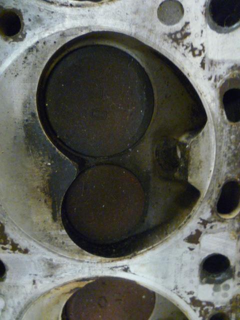

April 6, 20213 yr comment_619293 12 hours ago, Captain Obvious said: Here's a pic of one of the cylinders. Not as much material added as the one in your pic, but definitely a bunch added. Does this look reasonable? My days of building up a 300 bhp motor are behind me. Here's an unmodified P90 (I think it's unmodified anyway!) So yours has been filled in quite a lot on the left side, and maybe also around the spark plug boss (but that also could just be a big skim maybe?) I'm surprised there's not more of a chamfer on that infill - isn't 'unshrouding' the valves part of head porting 101? Link to comment https://www.classiczcars.com/forums/topic/65248-best-head/?&page=3#findComment-619293 Share on other sites More sharing options...
April 7, 20213 yr comment_619324 Yes, mine has been filled in a lot on the left, and around the spark plug as well. That's not just a shave that made the spark plug area look like that. I was also thinking that the wall down towards the valves was too abrupt. But that could easily be sloped off a little more gradual by removing some of the infill. By it's next owner. Link to comment https://www.classiczcars.com/forums/topic/65248-best-head/?&page=3#findComment-619324 Share on other sites More sharing options...
