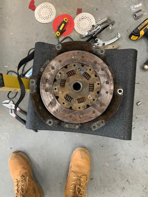

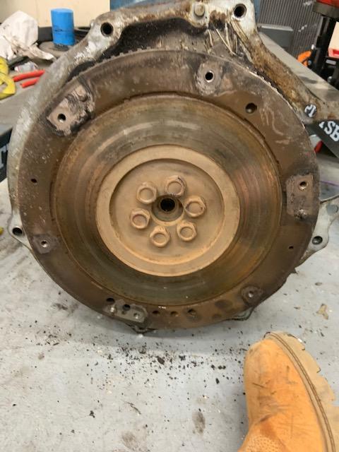

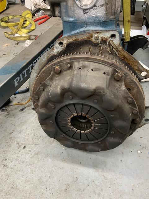

Posted April 7, 20214 yr comment_619373 decided to just rebuild my engine. have a machine shop guy i know who is helping me out for decent price. I took engine and tranny apart. I am wondering if i should buy a clutch kit. Nothing looks bad to me but i dont really know what to look for either.. any thoughts. is it worth 200bucks to do? Link to comment https://www.classiczcars.com/forums/topic/65264-clutch-kit/ Share on other sites More sharing options...

April 7, 20214 yr comment_619378 Looking at the pics it looks like the clutch disc lining is worn down to the tops of the rivets. I see what I think is a few shiny rivets. If it's down to polishing the rivets, it's time to replace it along with the release bearing and pilot bushing. And, "as long as you're in there" having the flywheel resurfaced or even lightened. Link to comment https://www.classiczcars.com/forums/topic/65264-clutch-kit/#findComment-619378 Share on other sites More sharing options...

April 9, 20213 yr comment_619465 Looks like one of the "tall" 240Z pressure plates. If you don't get another tall one you'll need a different throwout bearing sleeve/collar and maybe a different slave cylinder. People have problems with the early 240Z stuff. Beware. zKars posted a link to a place that sells tall pressure plates in one of his past threads. Link to comment https://www.classiczcars.com/forums/topic/65264-clutch-kit/#findComment-619465 Share on other sites More sharing options...
April 10, 20213 yr comment_619493 Yes, replace the clutch and surface the flywheel. They both look like they have been hot. Link to comment https://www.classiczcars.com/forums/topic/65264-clutch-kit/#findComment-619493 Share on other sites More sharing options...
April 10, 20213 yr comment_619516 I can't imagine not replacing all the clutch parts, including the slave cyl. and the pilot shaft bushing while you are in there. I always buy a "clutch kit" so that it all works together as it should. Mixing parts from different models/years can get you in trouble. Lot's of info here about what to avoid. Link to comment https://www.classiczcars.com/forums/topic/65264-clutch-kit/#findComment-619516 Share on other sites More sharing options...

April 12, 20213 yr comment_619647 On 4/7/2021 at 9:26 PM, Wally said: decided to just rebuild my engine. have a machine shop guy i know who is helping me out for decent price. I took engine and tranny apart. I am wondering if i should buy a clutch kit. Nothing looks bad to me but i dont really know what to look for either.. any thoughts. is it worth 200bucks to do? I agree with the other guys, new clutch disc and cover, throw out bearing and pilot shaft bushing, resurface the flywheel. Also, the machine shop that balances the rotating assembly should also include the flywheel and clutch cover, and the vibration damper/crank pulley when balancing everything, and mark the flywheel/clutch cover and crank hub so it can all be reassembled in the orientation it was in when balanced. Link to comment https://www.classiczcars.com/forums/topic/65264-clutch-kit/#findComment-619647 Share on other sites More sharing options...
