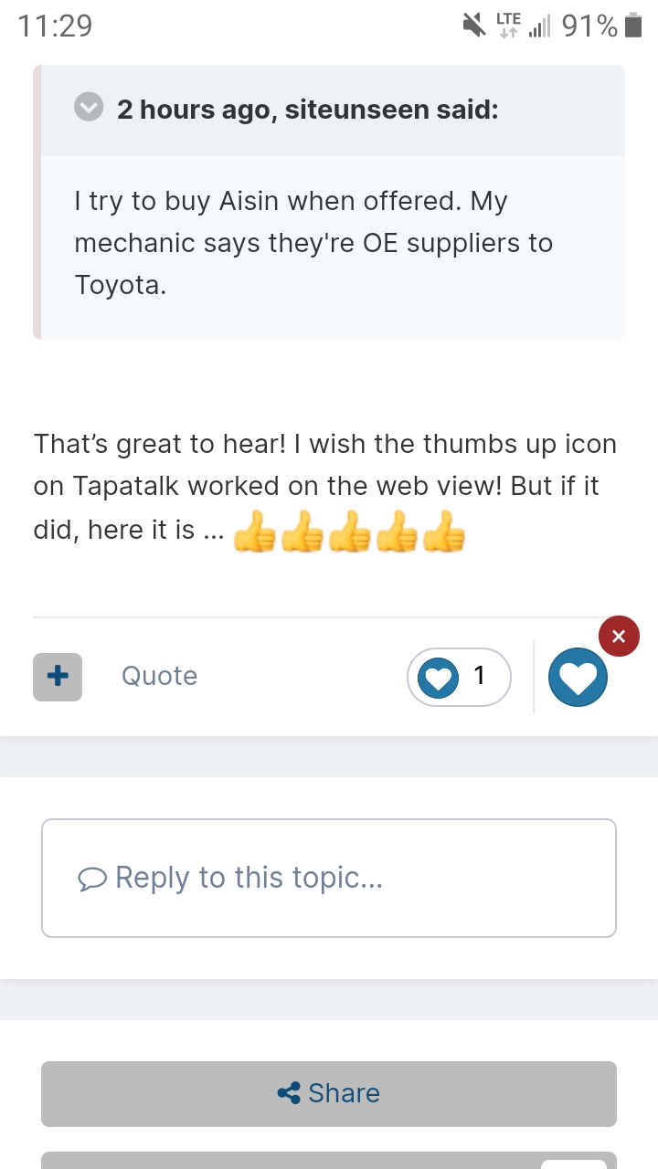

I try to buy Aisin when offered. My mechanic says they're OE suppliers to Toyota.
That’s great to hear! I wish the thumbs up icon on Tapatalk worked on the web view! But if it did, here it is ... [emoji106][emoji106][emoji106][emoji106][emoji106]

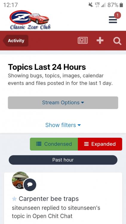

Tapatalk is a forum app for the phone and I REALLY like it and prefer it to web based forum UI.
The home page for me looks like this and allows me to quickly scan the forums I’m interested in / registered with without putting in login details every time. Sadly it was dropped from the UK Zclub forum which means I’m less on there than I used to be - as the mobile optimised web interface isn’t as easy / user friendly to use. :(
Here's what I see and I'm always logged in.
I can have my laptop running classiczcars.com and someone wants a picture. I grab my phone take the photo and post it from my phone. Laptop and phone working at the same time. It's pretty cool looking at my laptop and see my post pop up from my phone. Silly what it takes to amuse me.
