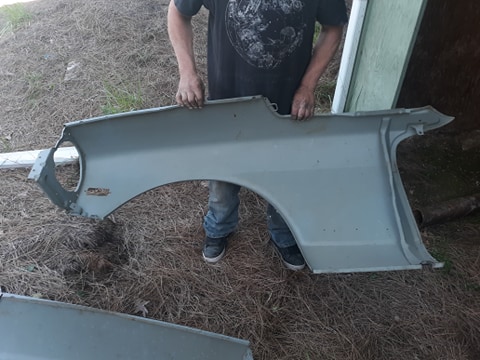

Posted April 13, 20214 yr comment_619729 They have the original grey/cream coloured primer on them. Should I strip them to bare metal or just paint over the top? Link to comment https://www.classiczcars.com/forums/topic/65278-just-picked-up-a-couple-of-new-old-stock-240z-fenderswings/ Share on other sites More sharing options...
April 13, 20214 yr comment_619733 Does it come off with lacquer thinner? Link to comment https://www.classiczcars.com/forums/topic/65278-just-picked-up-a-couple-of-new-old-stock-240z-fenderswings/#findComment-619733 Share on other sites More sharing options...
April 13, 20214 yr comment_619745 If they really are NOS then I would wash them well with either hot soapy water or wax & grease remover, give them a light scuff with Scotch pad or 400 grit and paint them. Link to comment https://www.classiczcars.com/forums/topic/65278-just-picked-up-a-couple-of-new-old-stock-240z-fenderswings/#findComment-619745 Share on other sites More sharing options...
April 13, 20214 yr comment_619747 I might strip them if it is an uncatalyzed paint. If it doesn't come off with lacquer thinner, then I would do like Grannyknot suggested Link to comment https://www.classiczcars.com/forums/topic/65278-just-picked-up-a-couple-of-new-old-stock-240z-fenderswings/#findComment-619747 Share on other sites More sharing options...
April 13, 20214 yr Author comment_619750 Thanks guys...I'll try thinner on them. Were in their boxes since the 1970/80s. Owner passed away and they were never fitted to a car. Saves me doing bodywork straightening the ones on my car out. Link to comment https://www.classiczcars.com/forums/topic/65278-just-picked-up-a-couple-of-new-old-stock-240z-fenderswings/#findComment-619750 Share on other sites More sharing options...
April 14, 20214 yr comment_619763 I would go back to metal forsure! My painter (pro) advised to go to metal because you would be working on a very old surface and you don't know what it's going to do with the new paint chemicaly.. I would not gamble! take it off! Use a 60 sandpaper on a rotary it go's fast. other painters say do not use chemical stuff to get it of because you have to clean it very well and then still you find it back in the new paint.. they say.. 🙄 Edited April 14, 20214 yr by dutchzcarguy Link to comment https://www.classiczcars.com/forums/topic/65278-just-picked-up-a-couple-of-new-old-stock-240z-fenderswings/#findComment-619763 Share on other sites More sharing options...
April 14, 20214 yr comment_619764 I agree, I would not chemical strip or even blast them. If you decide it needs to come off, then sand it off Link to comment https://www.classiczcars.com/forums/topic/65278-just-picked-up-a-couple-of-new-old-stock-240z-fenderswings/#findComment-619764 Share on other sites More sharing options...
April 17, 20213 yr comment_619942 Agreed take them down to metal. Where did you find them? I need the same parts as I’m sure every S30 owner does. Edited April 18, 20213 yr by SurferD Link to comment https://www.classiczcars.com/forums/topic/65278-just-picked-up-a-couple-of-new-old-stock-240z-fenderswings/#findComment-619942 Share on other sites More sharing options...
