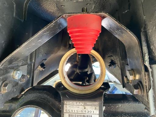

I did indeed use the original everything. In the end I went over FSM torque with some thread-lock + a fine paint brush of yellow acrylic paint to mark the final position of the nuts / bolts. That way, I could identify if anything had moved and so far, with some serious hooligan antics, so good. I also ditched the stock nuts at the diff end of the half shafts and went for serrated flange nuts - which again haven't moved, yet!! 😉

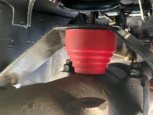

On diff arrester, I made my own in the end as the RT mount was way too expensive (£120) by the time you did the crappy GBP: USD exchange / postage and import duties. Total cost on mine ended up about £20 I think.
https://zclub.net/community/index.php?threads/the-“ak”-mount.27293/
The thread needs updating as the final version was much wider and I gave up trying to use the strap brackets. there is a 1mm gap under the red bush and a 3mm rubber washer between it and the mount to reduce vibrations.

I need to find the source of the vibration at highway speeds, no more thumping. And thrashing it’s just loud. Maybe I should trim the bushing on my RTmount more.
I literally just wrote a comment in the Old RT mount thread. taking about this, you’re saying there is a 1mm space between the top mount and the diff?
[mention=32052]AK260[/mention]
oh interesting I should have came back and updated this thread.
Yes sir - if I did it again I’d probably go for a 3mm gap below it. The diff will always have some lift at highway speed but not enough to stress the diff Mount insulator. The red bush / stop is really very solid, so it will transmit a fair bit of noise. Under acceleration, the diff will try to lift more but you won’t hear it as much over the exhaust / engine note.
