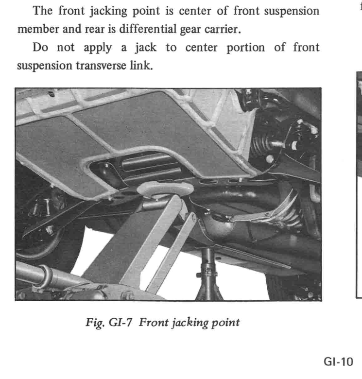

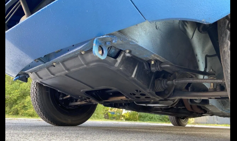

Not sure about S1 having it as standard but it it was meant to have one: look under your car, you will find 4 captive nuts at the bottom of your rad panel.
The improve the aero and I found that on mine it improved cooling.
Also if you get one beware that 250 ones are different from late 260/280.
You have to Google this but someone in Europe I think started to reproduce them.
