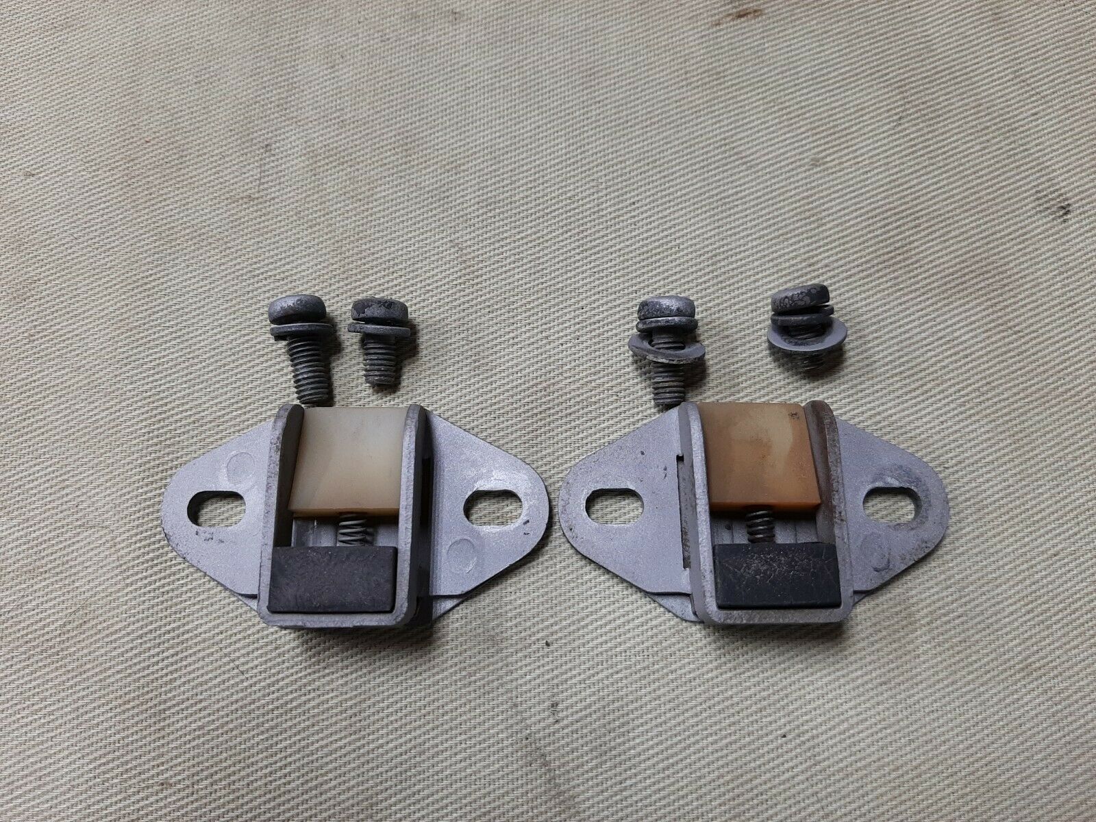

Here's a pic from ebay with a pair of those in pretty good shape. I think this is what they looked like at one time. Not sure if they changed the color of the rubbery nugget over the years though.

I am pretty sure that is correct. These and the piece on the hatch itself are both clear zinc. I see some people yellow them as well as a lot of other parts that should be clear.

It looked like this when new. Still available from Nissan. $21.47 each
Yup them be the ones! Rear hatch post.  Recommend I replace it based on that corklike mush sitting in the pocket?  Can I just get rid of that brown stuff and keep the post as is (not rusty).

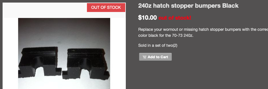

I would. At least contact 240zrubberparts and see if he can make a set for you. He lists "Out of stock" a lot, but will make things if requested.
They hold the spring in place and act as a stopper for the white plastic slide piece. The little feet on the sides hold them in and often break off. Used ones like CO's eBay set would also be a way to go.
I might even have an extra set.
