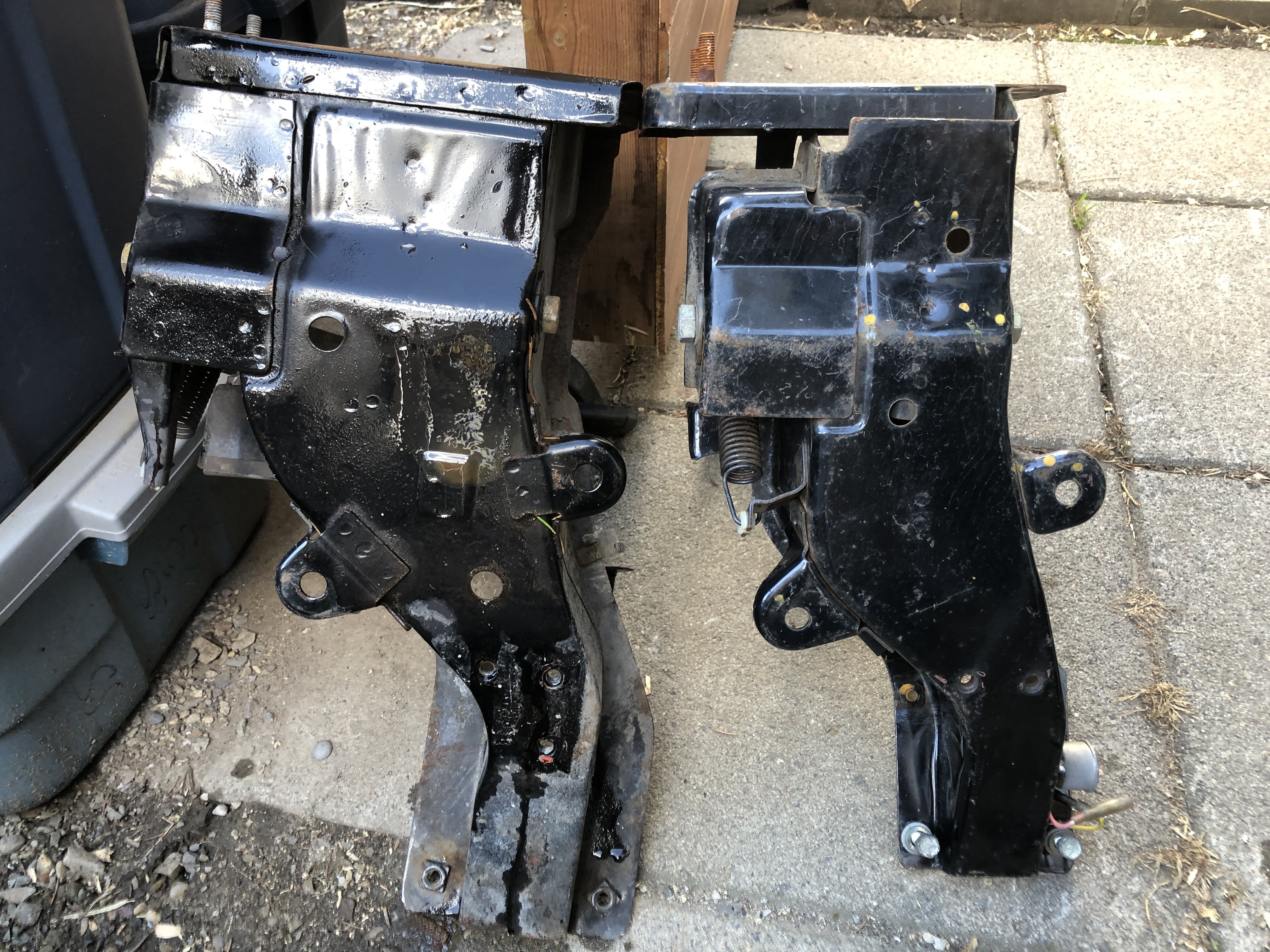

I’ll put the two side by side and post a picture and you can decide.
My guess is there is enough dimensional difference that it would not be worth the effort. What exactly is your problem with the  current setup?

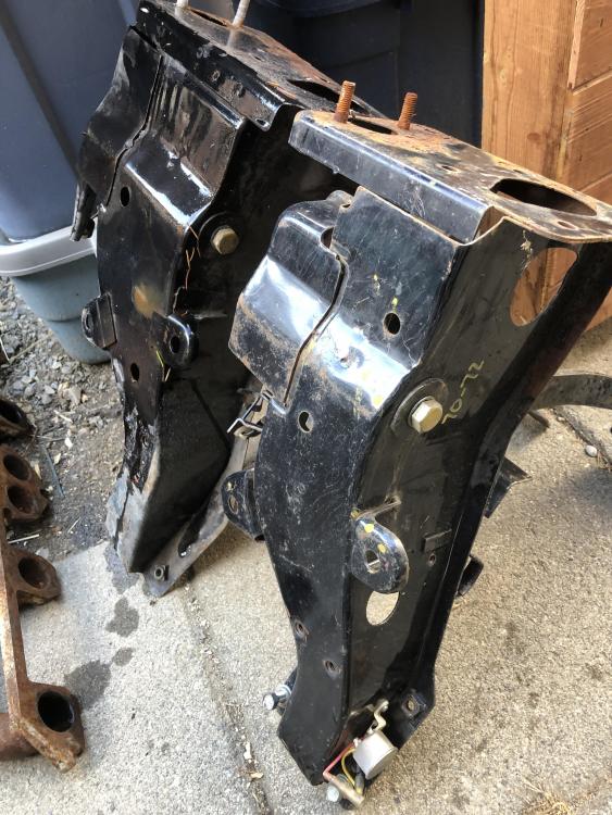

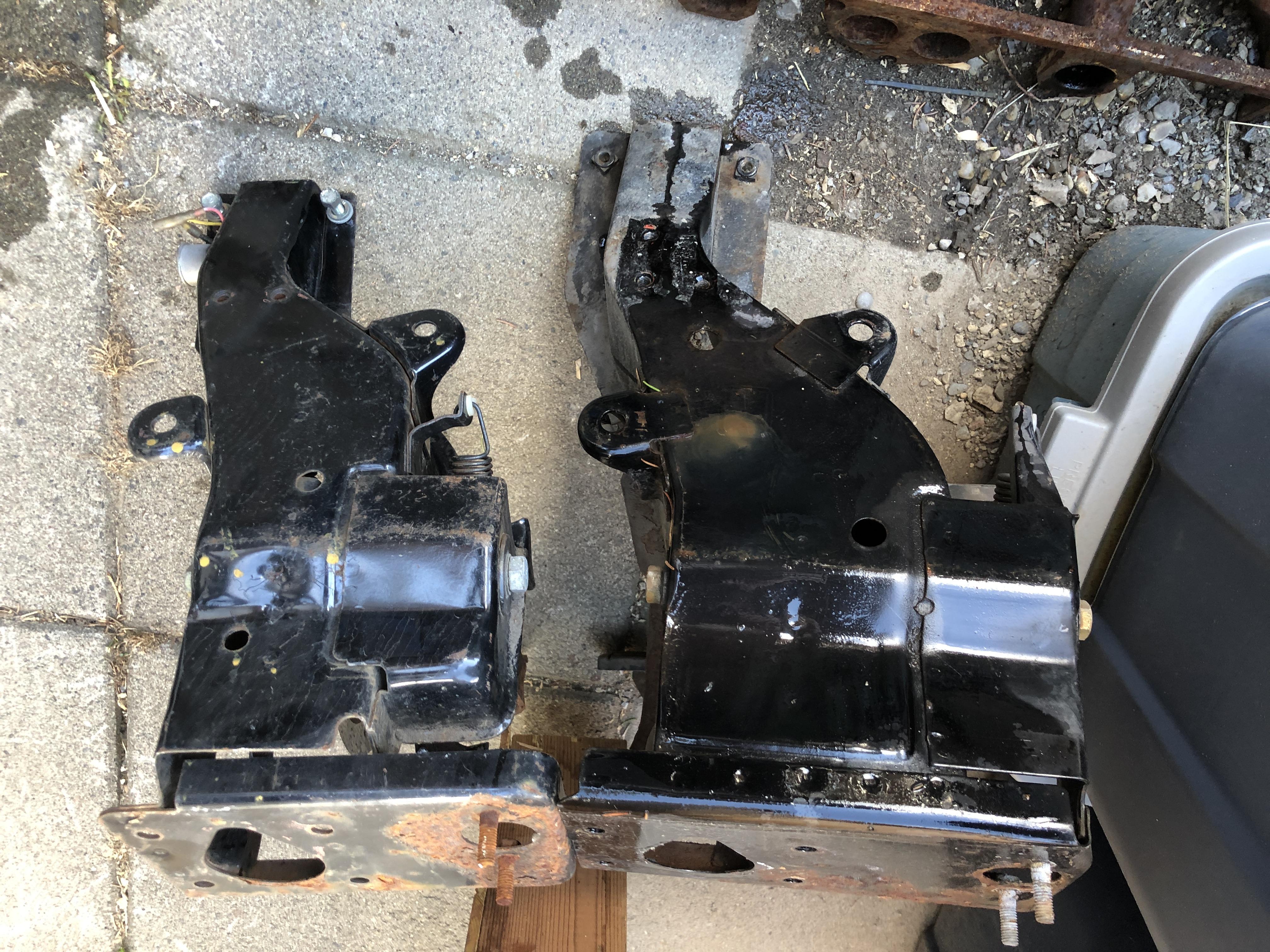

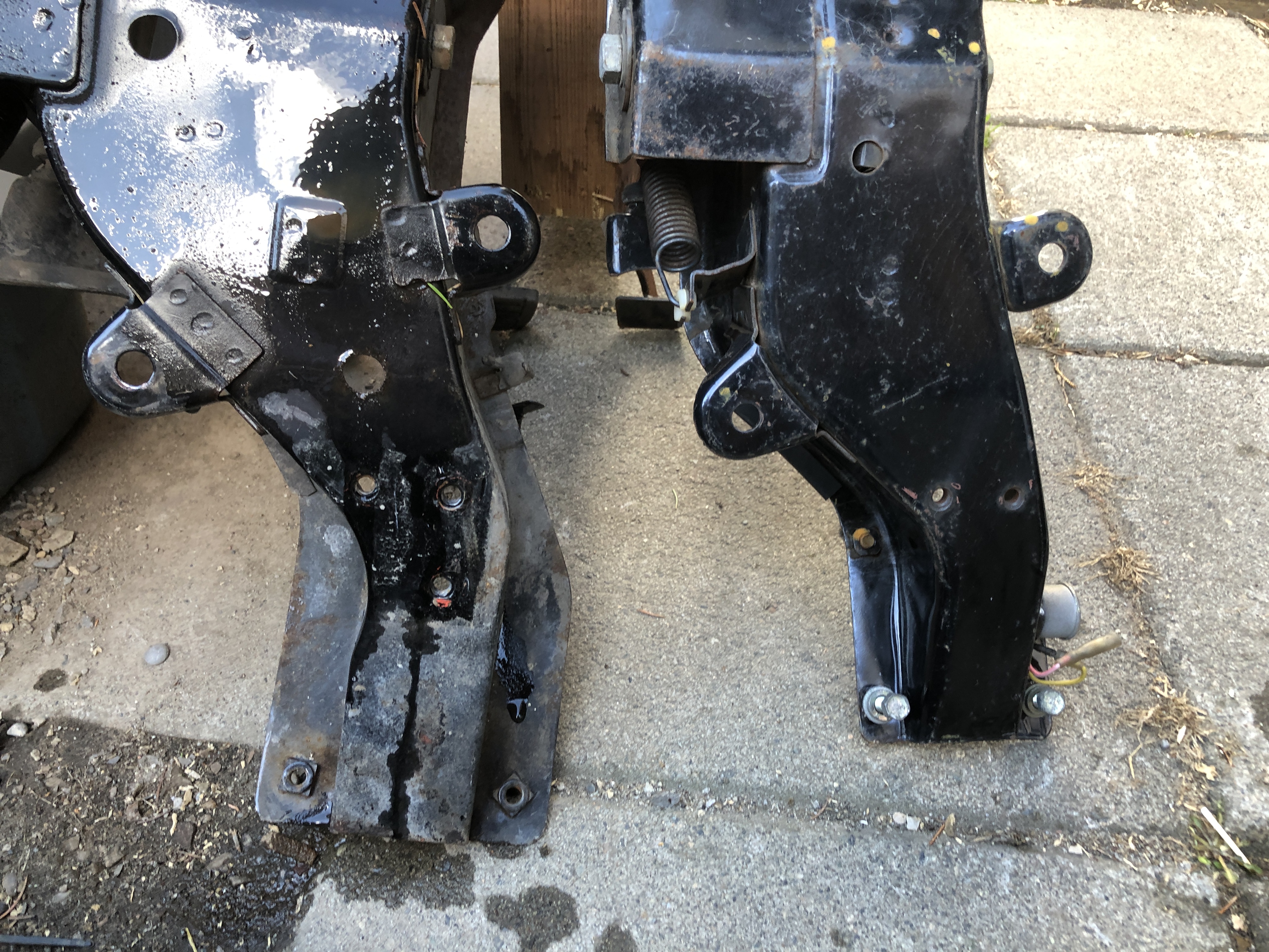

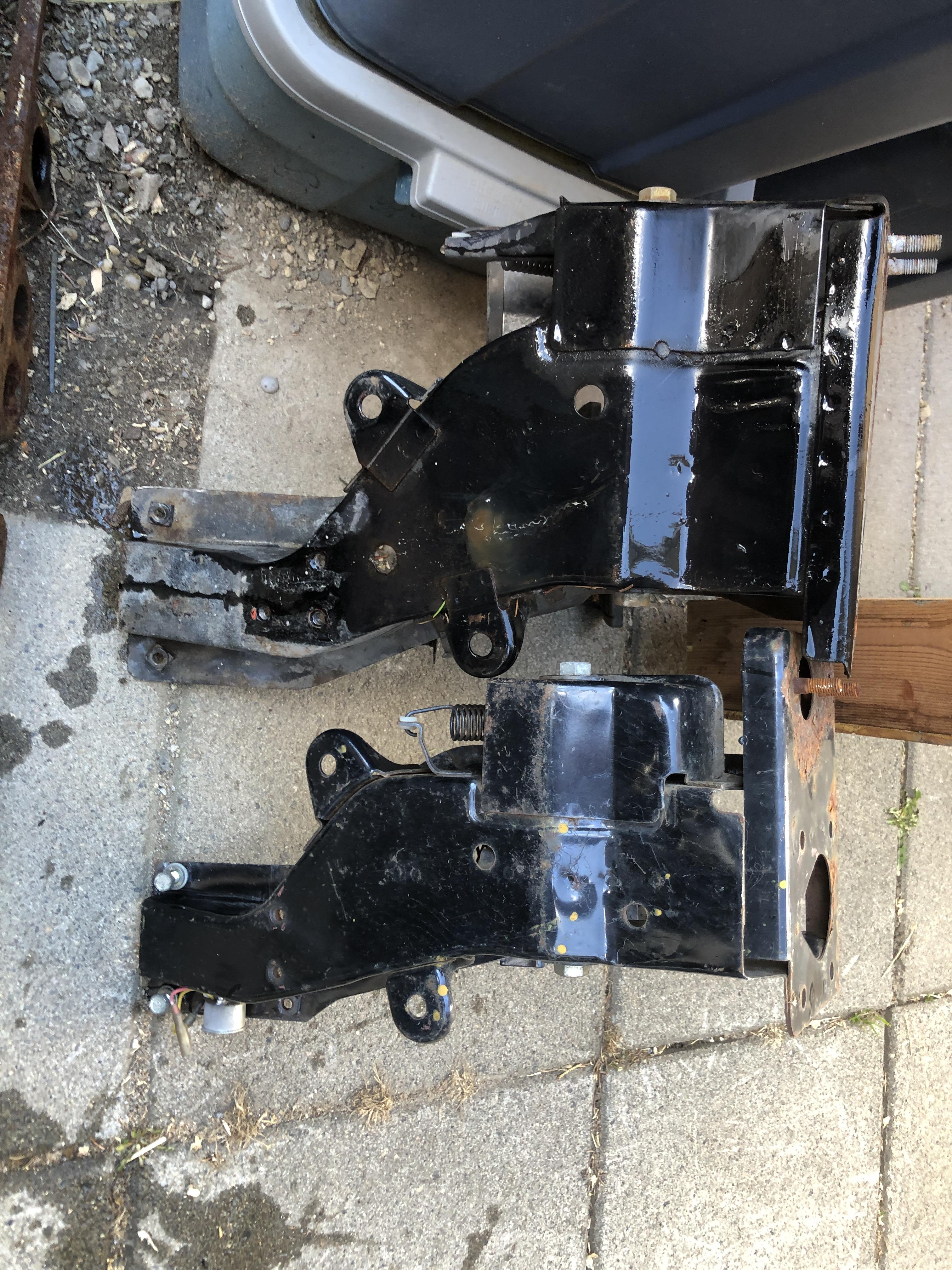

Here are pics of them side by side. 280 box is obviously wider (larger booster), yes two holes under the dash at the front vs 4. 280 box is also deeper from fire wall to dash mount.  The two tabs that stick out the side look about the same.
Wow, thank you for the thorough pictures! Someone local to me has one for sale, so I might grab it and see how much work it will take to adapt. Worst case scenario I can always sell it.
