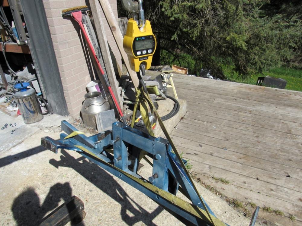

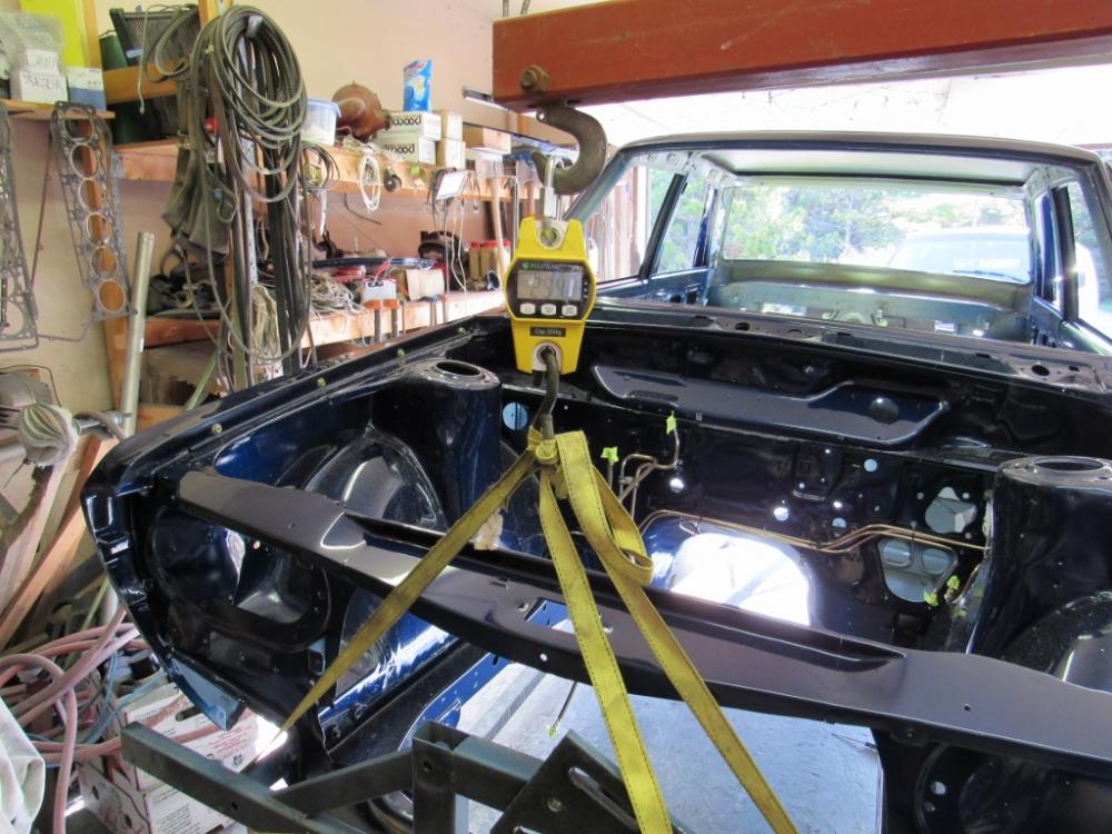

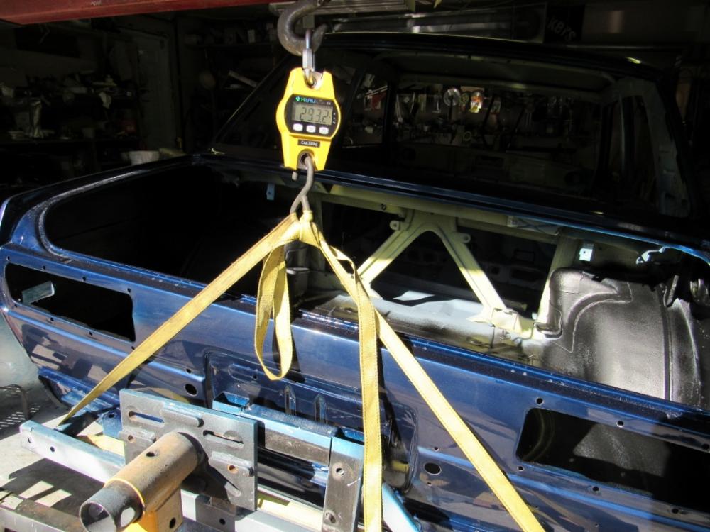

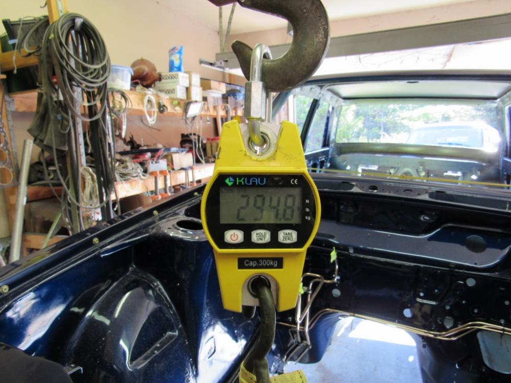

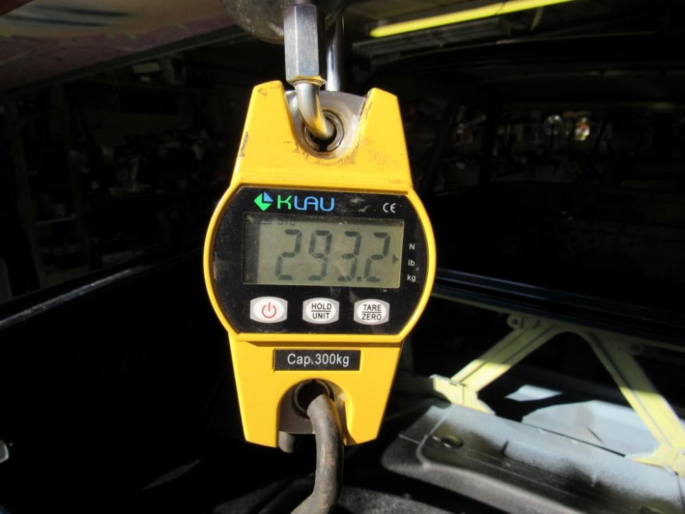

Posted May 15, 20213 yr comment_621658 I got the scales out before taking the 510 off the rotisserie, front weighed in at 295lbs, the rear at 293lbs equaling 588lbs, minus both of the stripped doors at 40lbs a piece and 32lbs for the rotisserie mounts. So total stripped weight for a 73/2dr 510 comes out at 476lbs. Link to comment https://www.classiczcars.com/forums/topic/65386-510-weighed/ Share on other sites More sharing options...

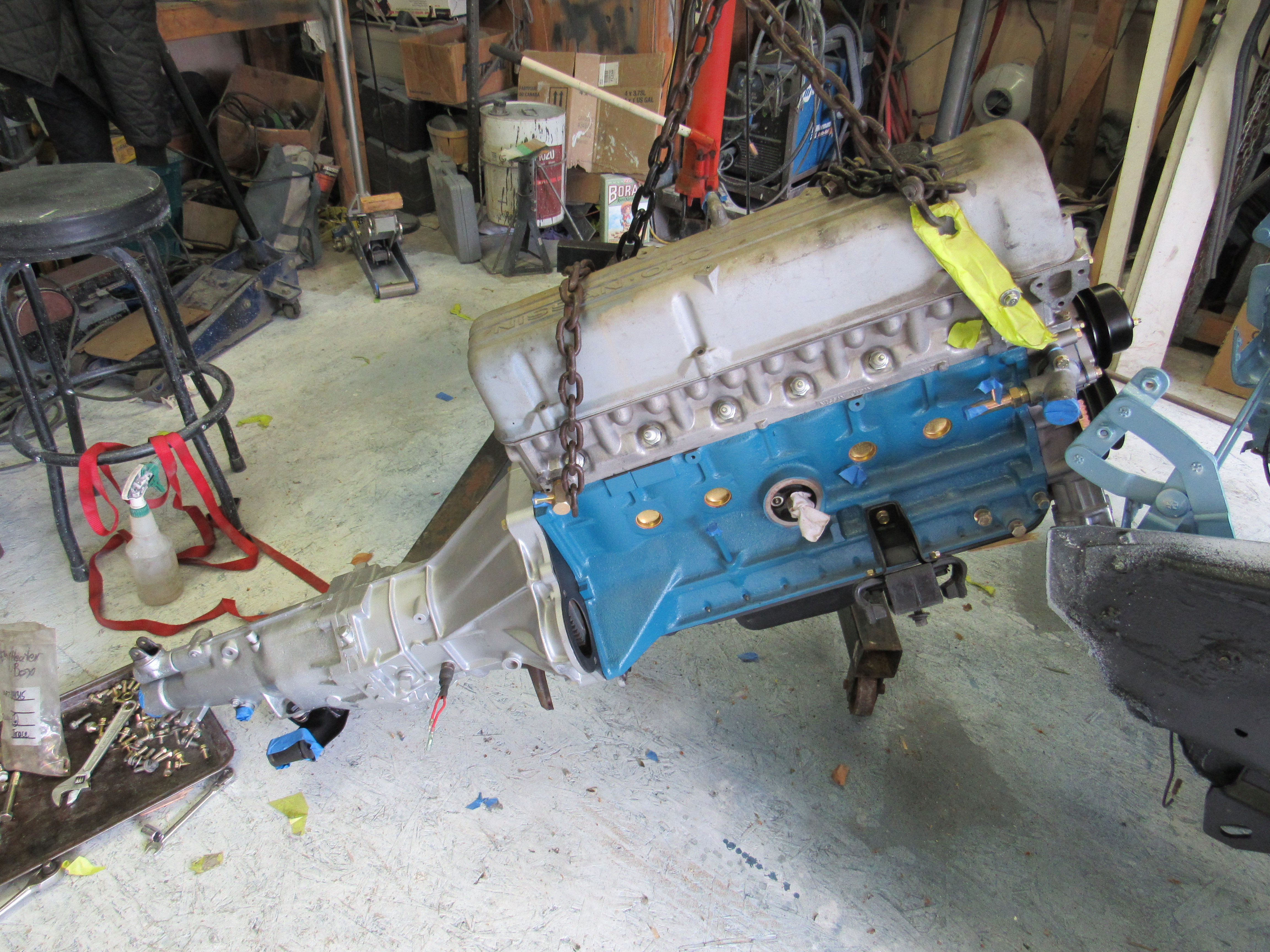

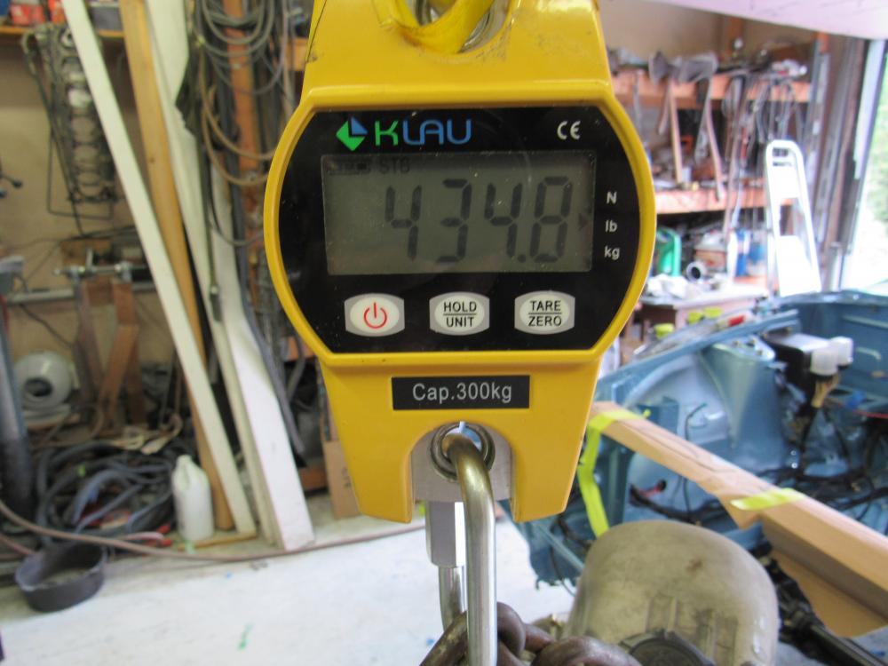

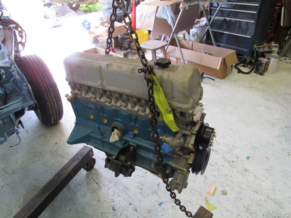

May 16, 20213 yr Author comment_621693 6 hours ago, Namerow said: I can't recall: Did you do similar weight measurements for the 240Z? If so, what were the front and rear weights? And engine (or engine + transmission)? I didn't own a scale when I did the 240 but I weighted the 280 a couple of years ago and the stripped shell was 530lbs so the 240 is probably close to 500lbs. A bare bones L28 engine is 304lbs and with the 5speed attached they weigh in at 435lb. Link to comment https://www.classiczcars.com/forums/topic/65386-510-weighed/#findComment-621693 Share on other sites More sharing options...
