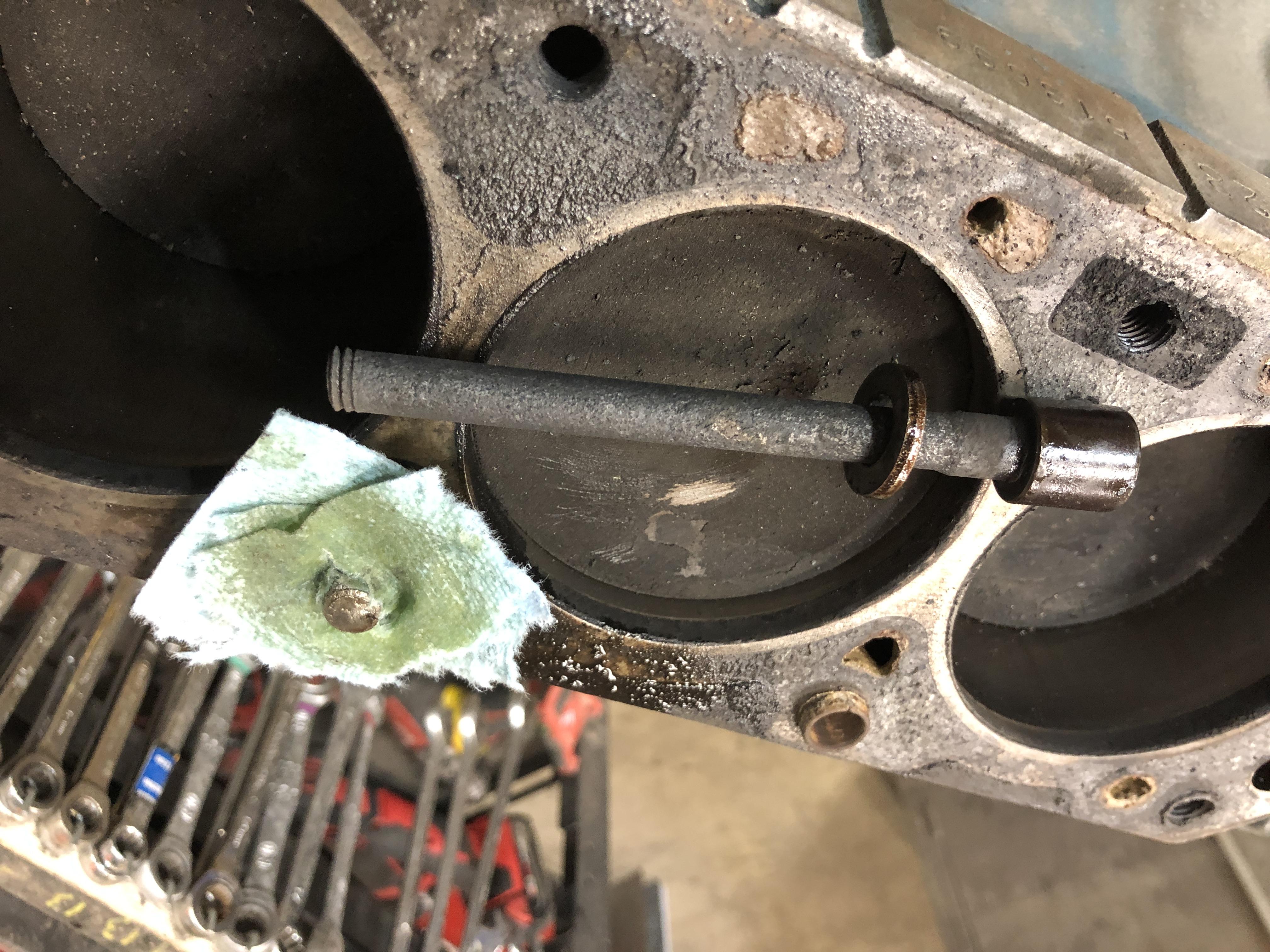

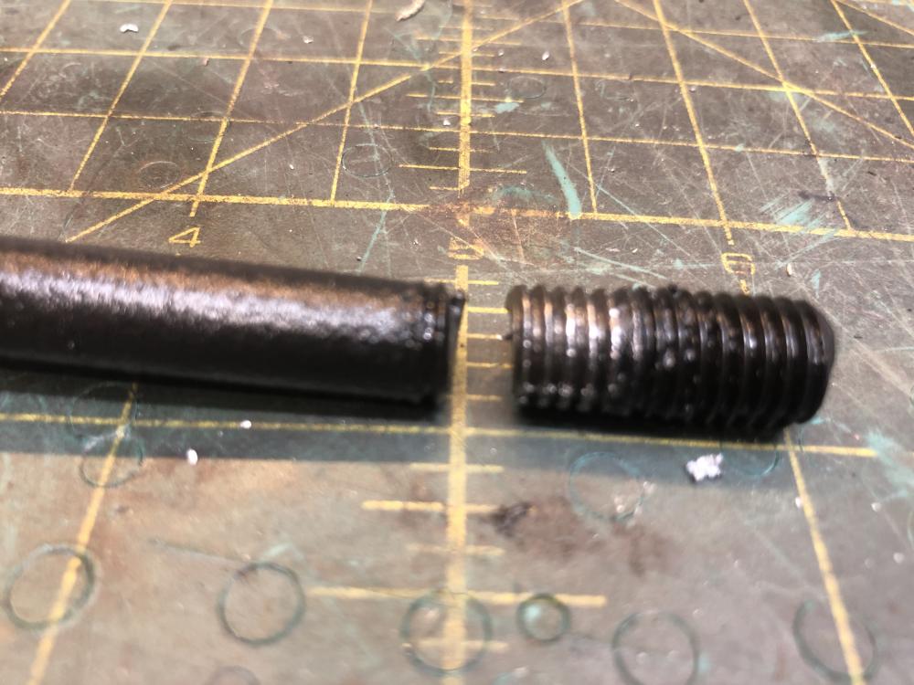

Posted May 23, 20213 yr comment_622032 It is common I have found to struggle with the removal of two particular head bolts. Left side, #4 and 5 from the front. Coolant seems to get there and rust them into place. So the recent engine (N42/N42) needed the head off, and sure enough, all were easy to break free, but #4 was a struggle, and #5 broke. Here we go again. Took the head off, and found stage one of the birthday present. The bolt broke a good 3/8” of and inch above the block! Yahoo! Look at the crud around that bolt. The head gasket was mostly eaten through here. Old engine, old coolant. Link to comment https://www.classiczcars.com/forums/topic/65411-best-birthday-present-broken-head-bolt/ Share on other sites More sharing options...

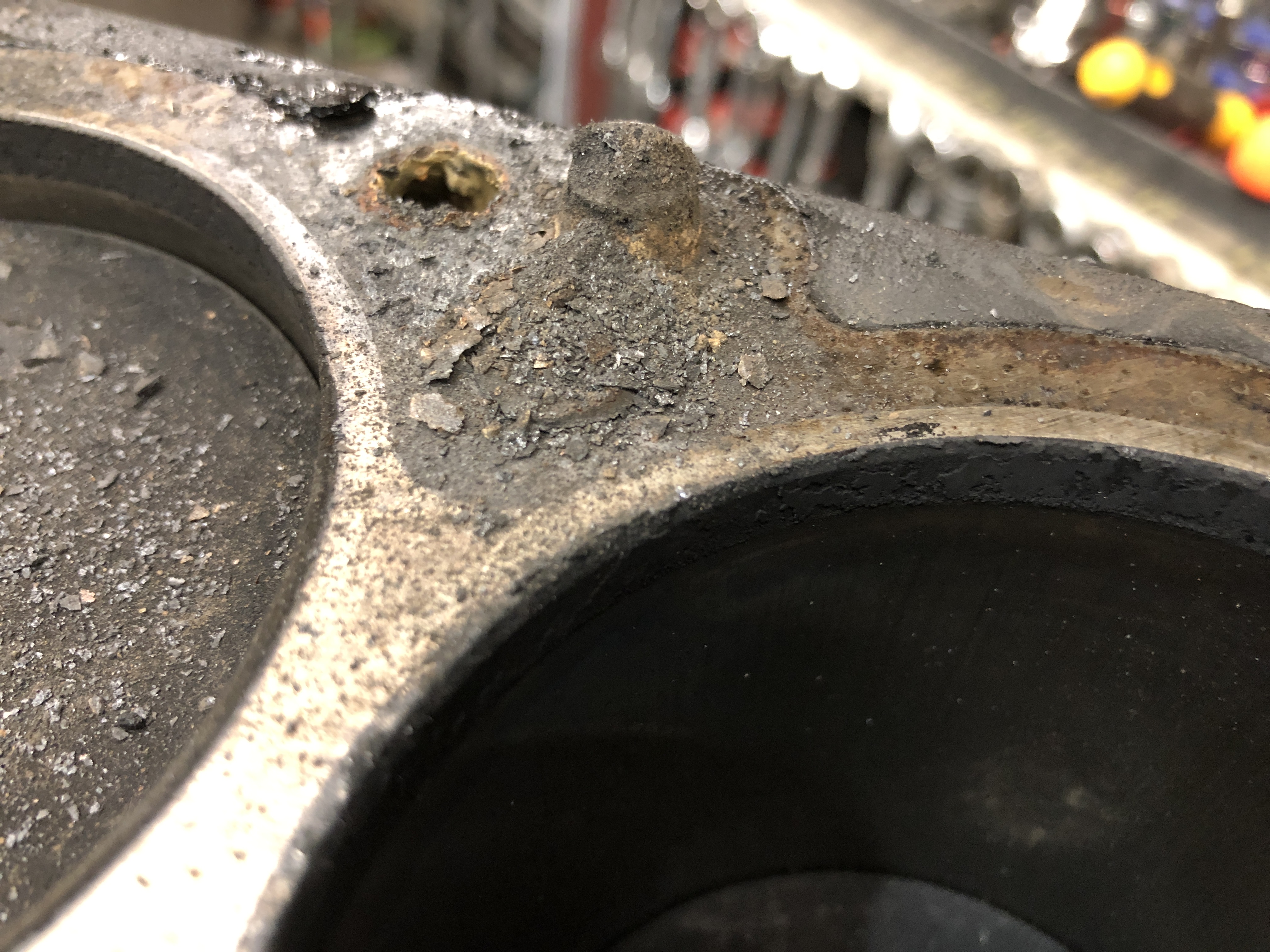

May 23, 20213 yr Author comment_622033 So I wire brushed the stub clean and set up a rag pad around it to hold penetrating oil and let her sit for 24 hours with hourly application of more weasel squeezings.... Link to comment https://www.classiczcars.com/forums/topic/65411-best-birthday-present-broken-head-bolt/#findComment-622033 Share on other sites More sharing options...
May 23, 20213 yr Author Popular Post comment_622034 And today, the final stage of my birthday present, I was able to put a vise grip on the stub and easily break it free then unthread it by hand. Yahoo! It never goes this smooth.... What do you think? Buy new head bolts or just re-use the old ones? Edited May 23, 20213 yr by zKars Link to comment https://www.classiczcars.com/forums/topic/65411-best-birthday-present-broken-head-bolt/#findComment-622034 Share on other sites More sharing options...

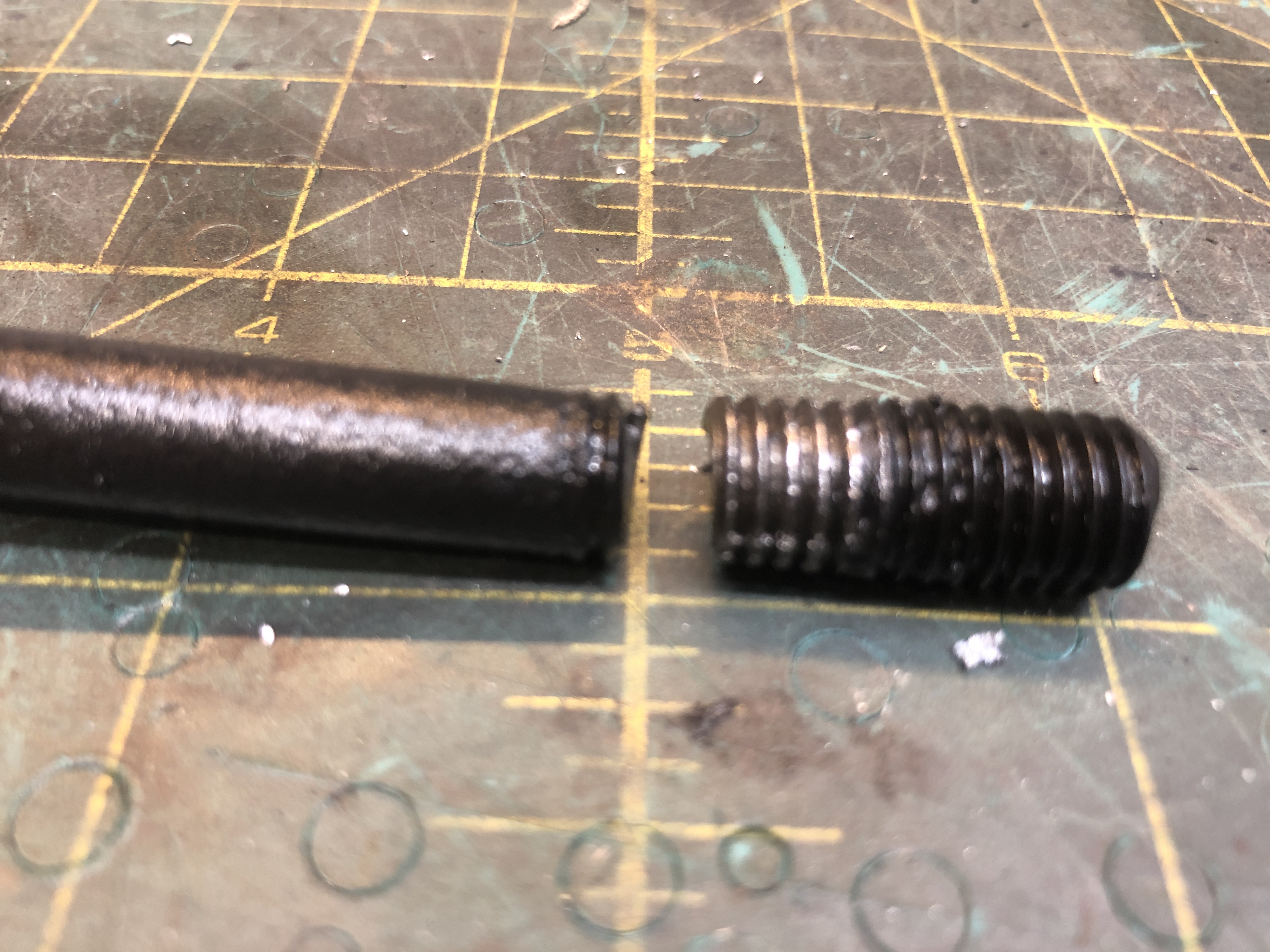

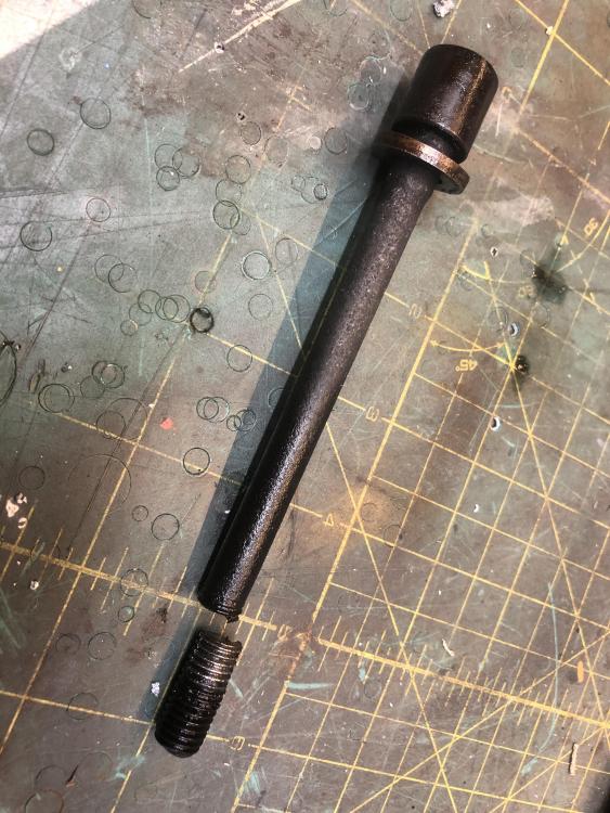

May 24, 20213 yr comment_622041 There's no way I would reuse that bolt. I would chuck up the remains of the bolt in the lathe and drill a hole in the end. Do the same thing to the threaded stump, and then turn a metal dowel pin to fit the holes. Press the dowel pin into place to align the two while you run a small weld bead around where it broke. If your welding skills are good, they say "the weld is stronger than the base metal". Link to comment https://www.classiczcars.com/forums/topic/65411-best-birthday-present-broken-head-bolt/#findComment-622041 Share on other sites More sharing options...
May 24, 20213 yr Author comment_622043 1 hour ago, Captain Obvious said: There's no way I would reuse that bolt. I would chuck up the remains of the bolt in the lathe and drill a hole in the end. Do the same thing to the threaded stump, and then turn a metal dowel pin to fit the holes. Press the dowel pin into place to align the two while you run a small weld bead around where it broke. If your welding skills are good, they say "the weld is stronger than the base metal". I’m totally doing this! New bolts are a fortune! Thanks! Link to comment https://www.classiczcars.com/forums/topic/65411-best-birthday-present-broken-head-bolt/#findComment-622043 Share on other sites More sharing options...

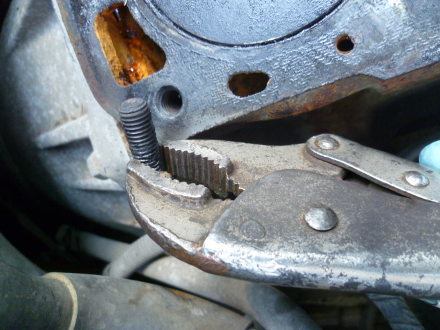

May 24, 20213 yr comment_622049 10 hours ago, zKars said: I’m totally doing this! New bolts are a fortune! Thanks! Just trying to do my part. For solidarity, I got lucky too. Did a happy dance: Link to comment https://www.classiczcars.com/forums/topic/65411-best-birthday-present-broken-head-bolt/#findComment-622049 Share on other sites More sharing options...
May 24, 20213 yr comment_622050 zKars, You would need to hold a gun to my head in order for me to reuse any of those old head bolts. Bite the bullet and get a fresh, new set. They won't break most banks. They are about a hundred bucks for a set of OEM bolts! Link to comment https://www.classiczcars.com/forums/topic/65411-best-birthday-present-broken-head-bolt/#findComment-622050 Share on other sites More sharing options...
May 24, 20213 yr comment_622052 Interesting. I've had good luck removing frozen fasteners with vise-grips over the years. My theory is that it comes from the shock created when the pliers -- adjusted to a strong over-centre setting -- are clamped closed. You can almost hear the pliers ring when they go over-centre and lock. No penetrating oil required. Link to comment https://www.classiczcars.com/forums/topic/65411-best-birthday-present-broken-head-bolt/#findComment-622052 Share on other sites More sharing options...
