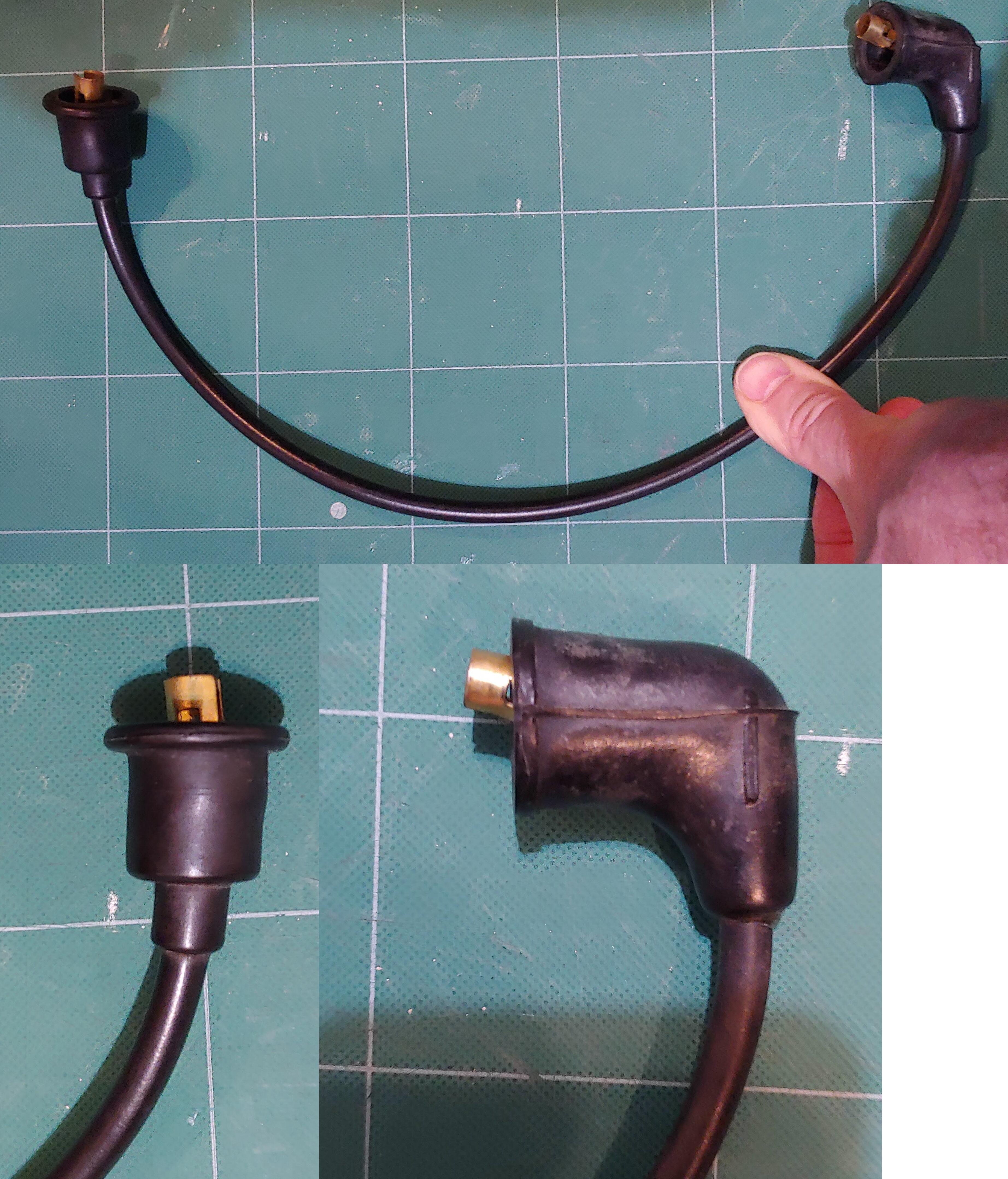

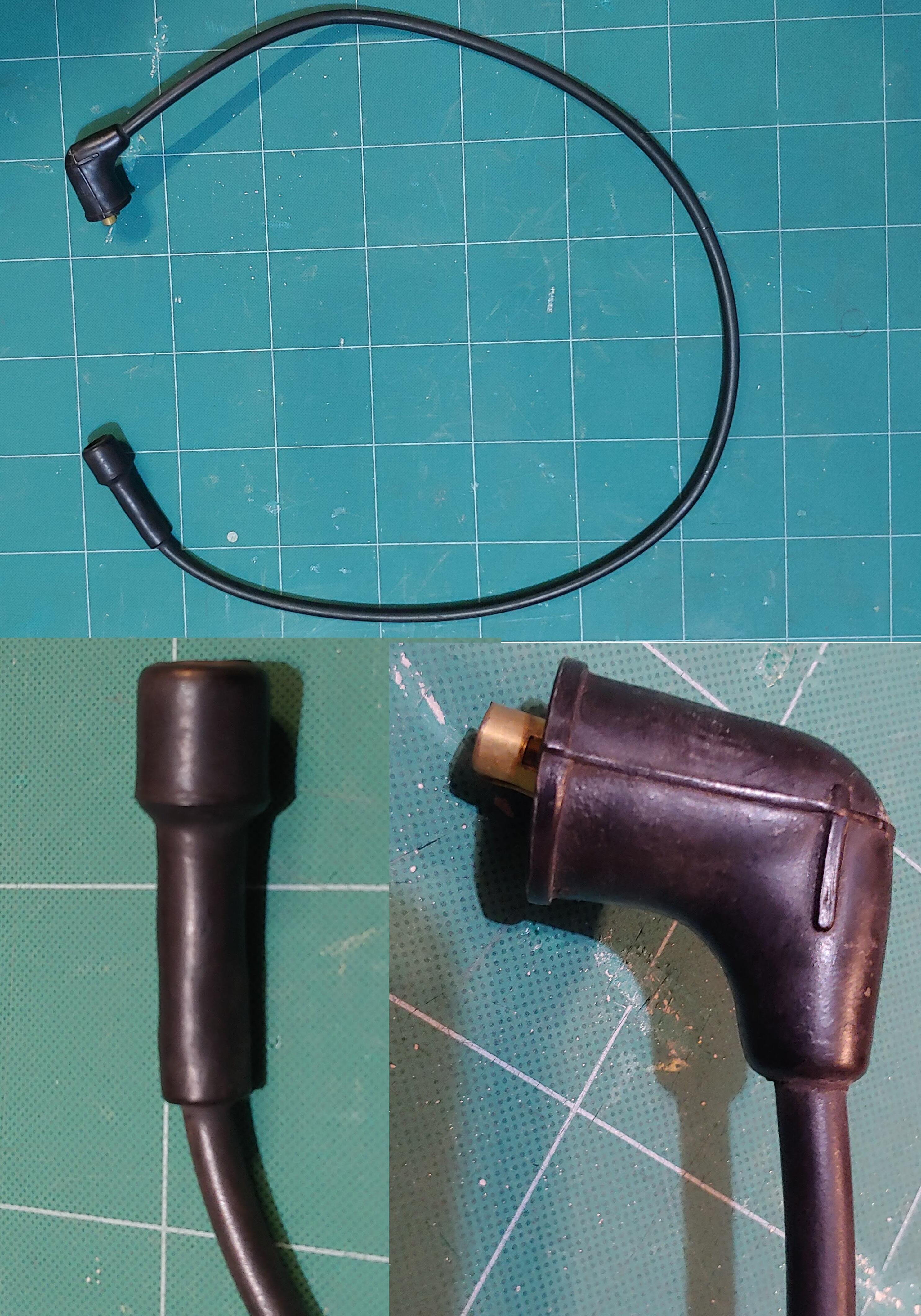

June 26, 20222 yr comment_641821 Even though Yazaki is printed on the ignition wires/plug leads it seems there were a number of companies producing them back in the 1970s. Most of them used the same rubber boot on the plug end but the distributor end had a unique rubber boot, that's the one I'm after. Here's a picture from @CanTechZ It seems Yazaki and OYS used this boot, so the hunt is on for an original. Once I find that it's full speed ahead making up a set to test. Link to comment https://www.classiczcars.com/forums/topic/65414-documenting-my-original-yazaki-spark-plug-leads/?&page=3#findComment-641821 Share on other sites More sharing options...

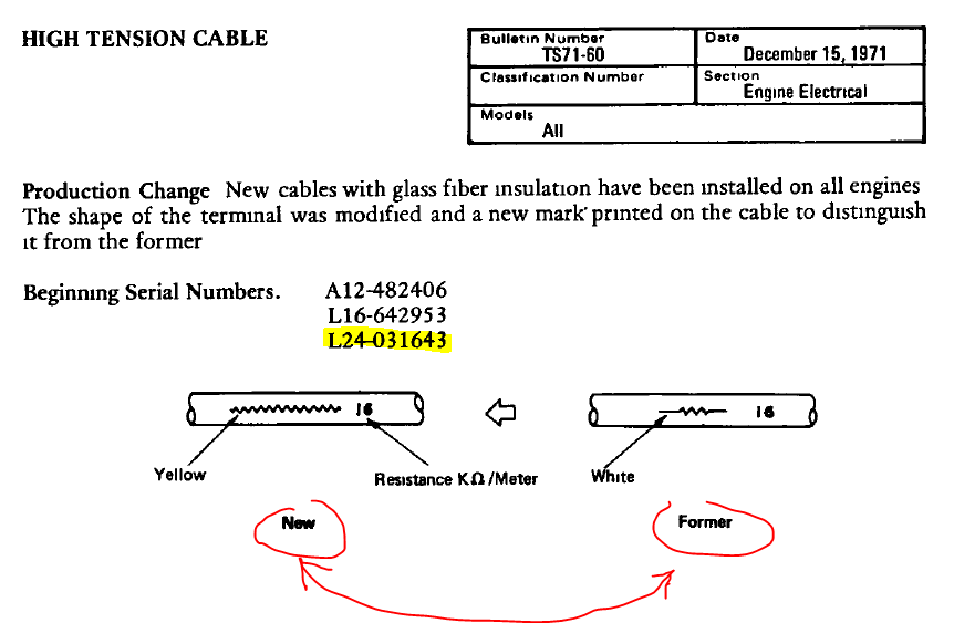

April 3, 20232 yr Author comment_652118 2 hours ago, AZ-240z said: @SpeedRoo, please put me on the list for a set for my 1/1971 when you do 1971 sets! @AZ-240z with your car being a 1/71, I would think that it would have come the the early spark plug leads, assuming the TSB is correct. The newer type that had white text and the angled boot on the number 6 started at engine number L24-031643 which according to @Carl Beck's register would not have been until 3/1971. It also makes we wonder when Nissan would have started to install leads with the 1971 date. Is you car an early 1/71 car? Would they have used up the 1970 leads before changing over to 1971? Interestingly the TSB has an error with the "New" vs "Former" labels. Link to comment https://www.classiczcars.com/forums/topic/65414-documenting-my-original-yazaki-spark-plug-leads/?&page=3#findComment-652118 Share on other sites More sharing options...
April 3, 20232 yr comment_652121 2 hours ago, CanTechZ said: @AZ-240z with your car being a 1/71, I would think that it would have come the the early spark plug leads, assuming the TSB is correct. The newer type that had white text and the angled boot on the number 6 started at engine number L24-031643 which according to @Carl Beck's register would not have been until 3/1971. It also makes we wonder when Nissan would have started to install leads with the 1971 date. Is you car an early 1/71 car? Would they have used up the 1970 leads before changing over to 1971? Interestingly the TSB has an error with the "New" vs "Former" labels. @CanTechZ, you are absolutely correct. My engine is L24-027116, so the early 1970 cables would most probably have been delivered with my car. I’ll correct my request with SpeedRoo, and thanks! Dan Link to comment https://www.classiczcars.com/forums/topic/65414-documenting-my-original-yazaki-spark-plug-leads/?&page=3#findComment-652121 Share on other sites More sharing options...
April 3, 20232 yr comment_652122 4 hours ago, AZ-240z said: @SpeedRoo, please put me on the list for a set for my 1/1971 when you do 1971 sets! Correction, please put me on the list for a set of the early 1970 cables. @CanTechZ just made me aware, because I wasn’t paying attention, that my series 1 L24-027119 1/71 car would probably been delivered with the early 1970 cable set. Thanks. Dan Link to comment https://www.classiczcars.com/forums/topic/65414-documenting-my-original-yazaki-spark-plug-leads/?&page=3#findComment-652122 Share on other sites More sharing options...
