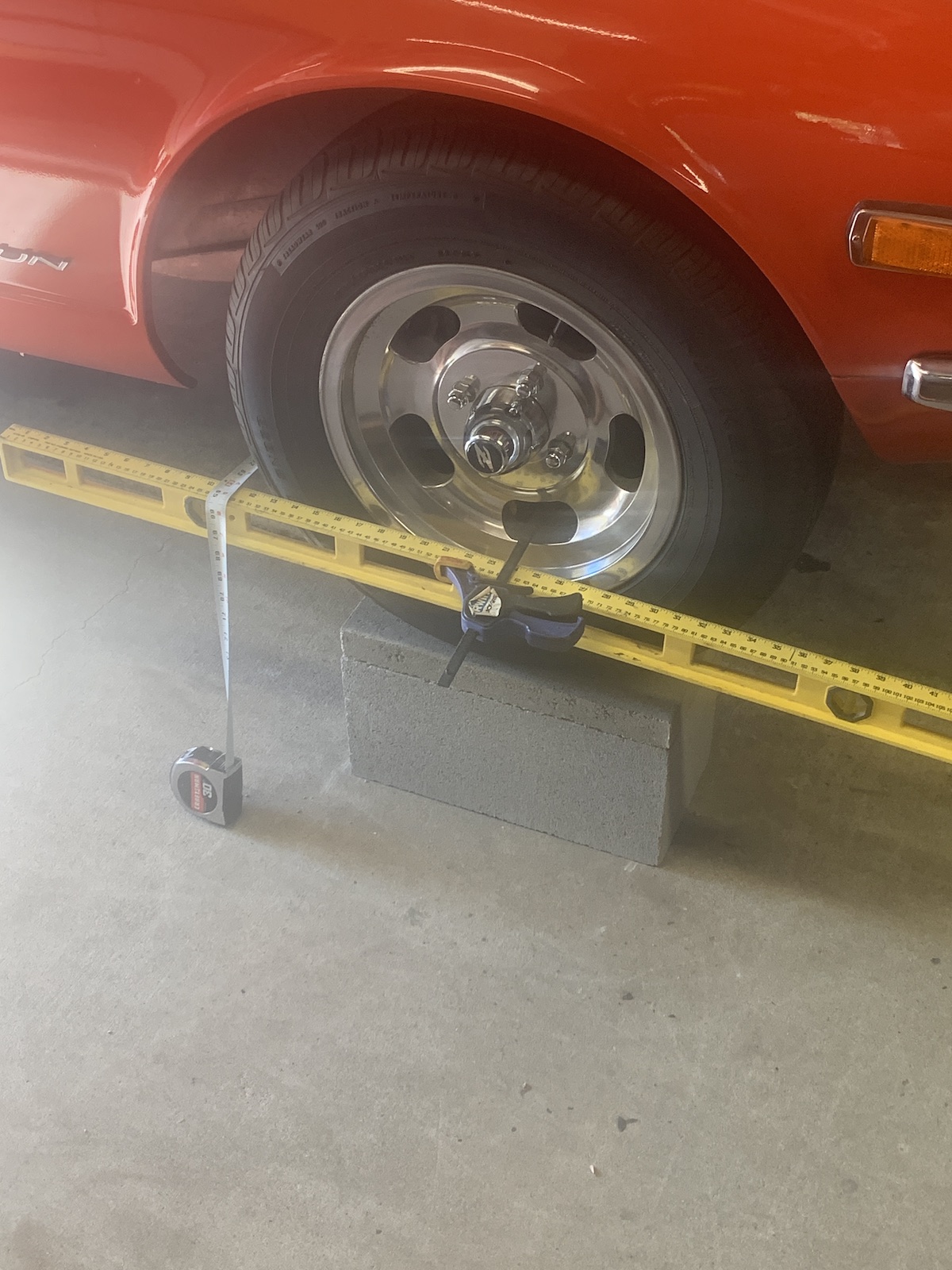

August 2, 20213 yr Author comment_626189 On 8/2/2021 at 12:01 PM, Namerow said: How did you get your Z up on the elevator pads?Oh, those? I’ve got hydraulic rams under my shop floor, so I just hit a button to raise and lower the Z. You should see it when it goes 6 feet high for those oil changes!Kidding! [emoji16]. It was on jack stands, so I just had to jack up each corner a few inches to slide a concrete block under each tire. [emoji106]Sent from my iPhone using Tapatalk Link to comment https://www.classiczcars.com/forums/topic/65437-another-suspension-rebuild/?&page=5#findComment-626189 Share on other sites More sharing options...

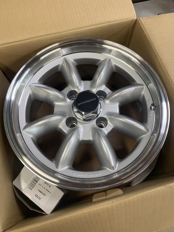

August 7, 20213 yr Author comment_626438 After adjusting the toe-in, it actual tracks pretty good. I'll be curious to see how close I got it when I take it to be aligned. I forgot to tighten the rear strut top nuts, which made quite a racket during its first ride. And the engine developed a miss while sitting for 3 months, probably pull the plugs tomorrow and take a look. Or it could be the crappy California gas. Did I mention I picked up some new wheels from Z Car Garage? 😉 Link to comment https://www.classiczcars.com/forums/topic/65437-another-suspension-rebuild/?&page=5#findComment-626438 Share on other sites More sharing options...

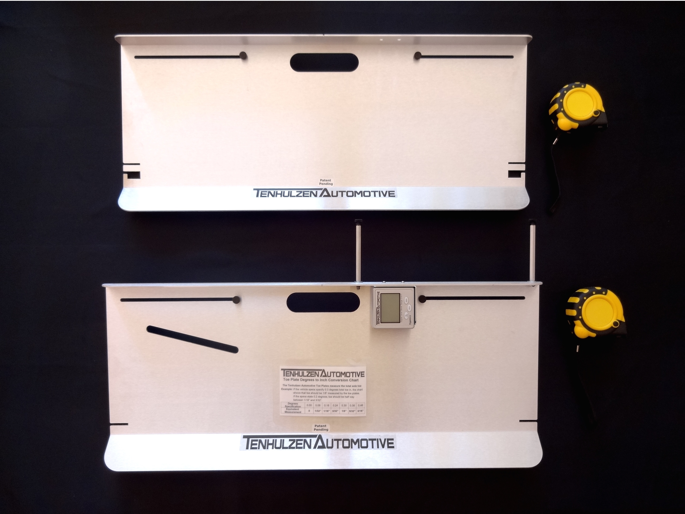

August 7, 20213 yr comment_626451 On 8/7/2021 at 8:01 AM, AK260 said: It doesn’t take many alignments at that price to justify buying a half decent alignment tool This is the diy alignment tool I bought after years of toe adjustments with the string method, https://www.wheelalignmenttools.com/product/2-wheel-alignment-system/ The tool allows you to measure and adjust toe, caster and camber, pretty happy with it. Edited August 7, 20213 yr by grannyknot Link to comment https://www.classiczcars.com/forums/topic/65437-another-suspension-rebuild/?&page=5#findComment-626451 Share on other sites More sharing options...
August 7, 20213 yr comment_626457 On 8/7/2021 at 11:36 AM, grannyknot said: This is the diy alignment tool I bought after years of toe adjustments with the string method, https://www.wheelalignmenttools.com/product/2-wheel-alignment-system/ The tool allows you to measure and adjust toe, caster and camber, pretty happy with it. Oh wow! Thank you for sharing!! There are many out there but it’s great to see one with a personal recommendation from someone who knows their onions! [emoji106][emoji106] Link to comment https://www.classiczcars.com/forums/topic/65437-another-suspension-rebuild/?&page=5#findComment-626457 Share on other sites More sharing options...
August 7, 20213 yr Author comment_626465 On 8/7/2021 at 11:36 AM, grannyknot said: This is the diy alignment tool I bought after years of toe adjustments with the string method, https://www.wheelalignmenttools.com/product/2-wheel-alignment-system/ The tool allows you to measure and adjust toe, caster and camber, pretty happy with it. Ordered! I'd rather put $ toward this than give $ to someone for an easy no-brainer job! Thanks! Link to comment https://www.classiczcars.com/forums/topic/65437-another-suspension-rebuild/?&page=5#findComment-626465 Share on other sites More sharing options...
August 19, 20213 yr Author comment_627247 I'm liking that TenHulzen alignment tool! Measured toe-in I had set with a couple straight edges clamped to the wheels. Came out at 64 5/8" in the rear, 64 9/16" in the front, net of 1/16" in. Going to leave it there. Steering wheel is a spline or two off center, think I'll remove wheel and recenter instead of adjusting tie rods. So, here's the before picture from May, stock springs (I think), worn struts, etc: Here's the after picture, Eibach progressive springs, Koni Yellows, new bushings, mostly rubber. After about 80 miles of driving. Not much of a drop as I was expecting, looks the same to me. 😕 I measured from the ground to the top of the outside wheel well lip before and after, tires are 195/70R14's: Before: After: Camber: RF: 26" 26" -.40 RR: 24 7/8" 24 5/8" -2.05 LF: 26 1/4" 25 7/8" -.50 LR: 25 1/4" 25 1/8" -2.15 BUT, I've gotta say the Eibachs and the Koni Yellows are a great pairing together. It's like driving another car. I'm running them about 1/4 turn from the softest setting for now. Link to comment https://www.classiczcars.com/forums/topic/65437-another-suspension-rebuild/?&page=5#findComment-627247 Share on other sites More sharing options...
