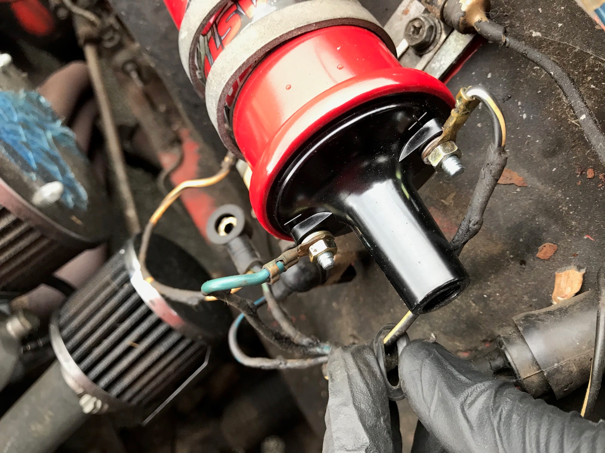

When checking for spark at the coil, this is what I did.
And that was from a 280ZX distributor that had wobble in the shaft, so it didn't have the proper gap at the reluctor.

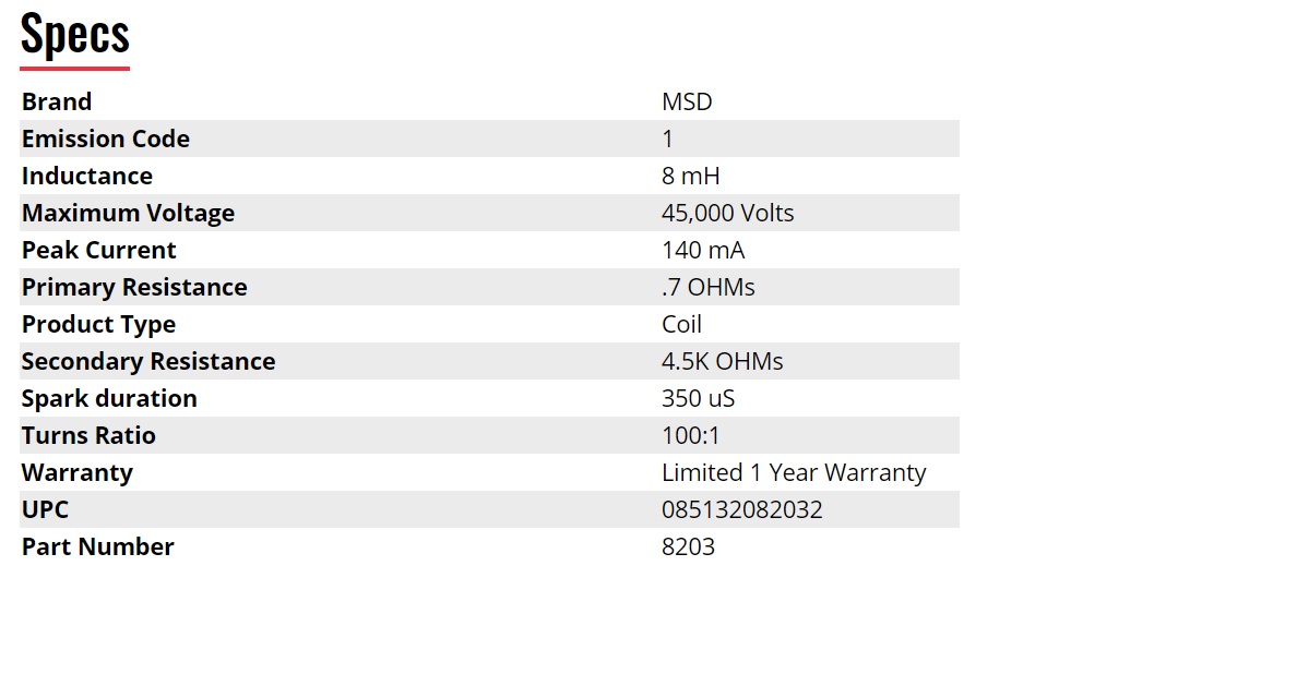

Ok just need to know what’s gauge wire to use for wires from coil to new dizzy.  and will this coil be ok.. Thanks.
Use the wiring  that is already on the car.
And yes, that coil should be fine.

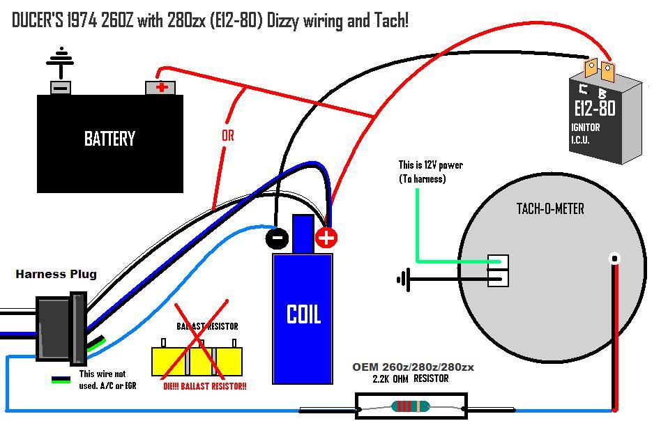

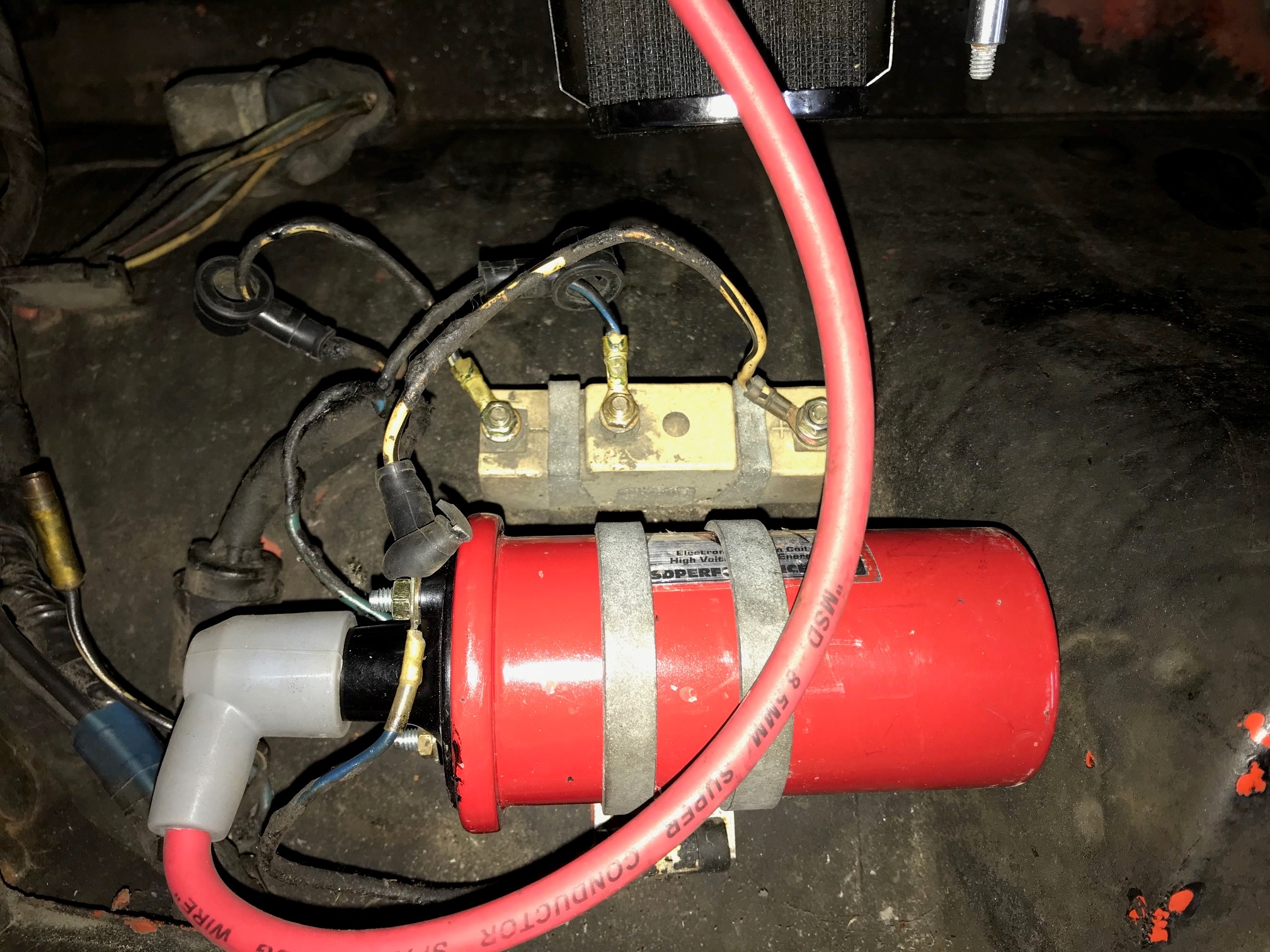

4 hours ago, Shawninvancouver said:
CASE CLOSED - car RUNS!!!!  new  280zx dizzy fixes the problem... took out electronic ignition unit and ballast... thanks for the help..

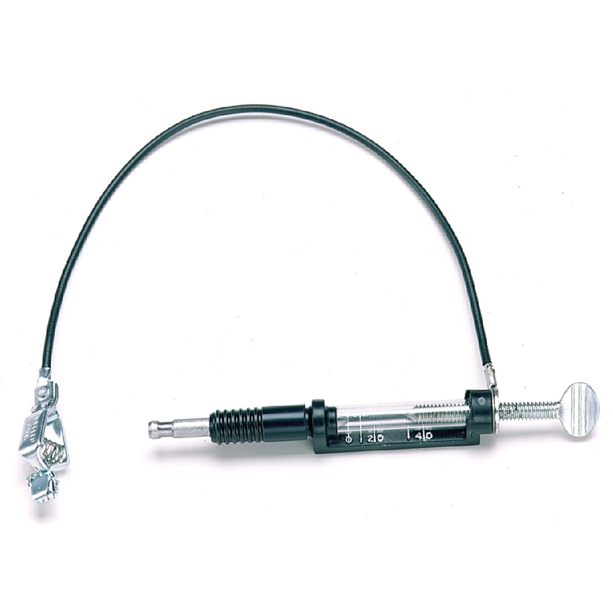

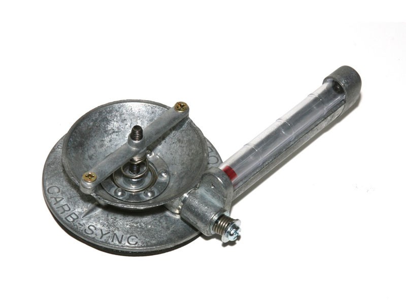

1 hour ago, siteunseen said:
I have one of those, never used it. There isn’t enough room between the carbs and strut tower.
Someone gave me one of these:
It is easy to use and allows enough room to be quick and accurate.
