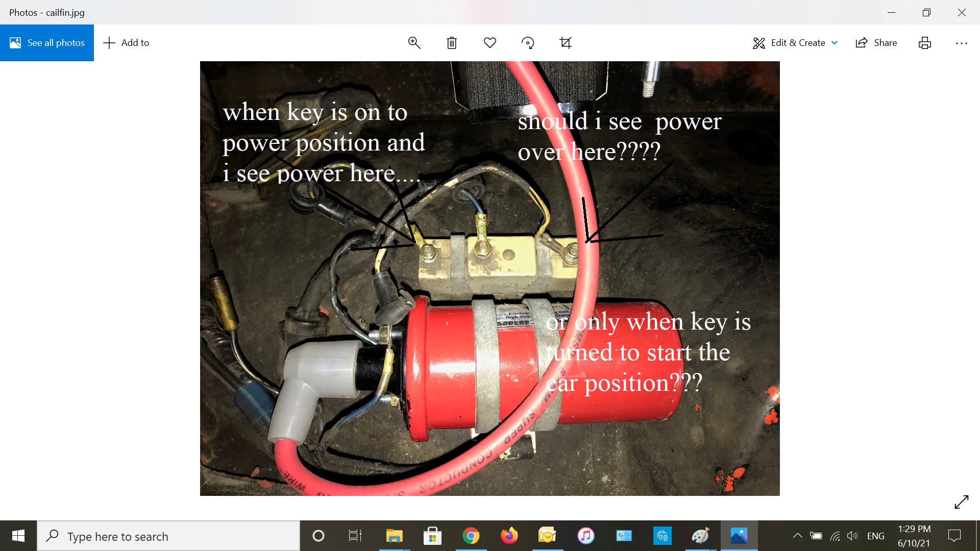

i just watched this video about ballast and coil and he says i should only see power on the last terminal when the engine is cranking..  2:55 of video..
not when the key is in on position..   so was my ballast acting correct when i was testing for electricity with my test light???

yes i have seen that but its a 4 post and mine is a 3 post...  not sure whats on the extra post.    all i really want to know is  -  should i see some sort of power on all 3 posts when i  turn the key to the power position - or only power to 3 on start car ignite position???
