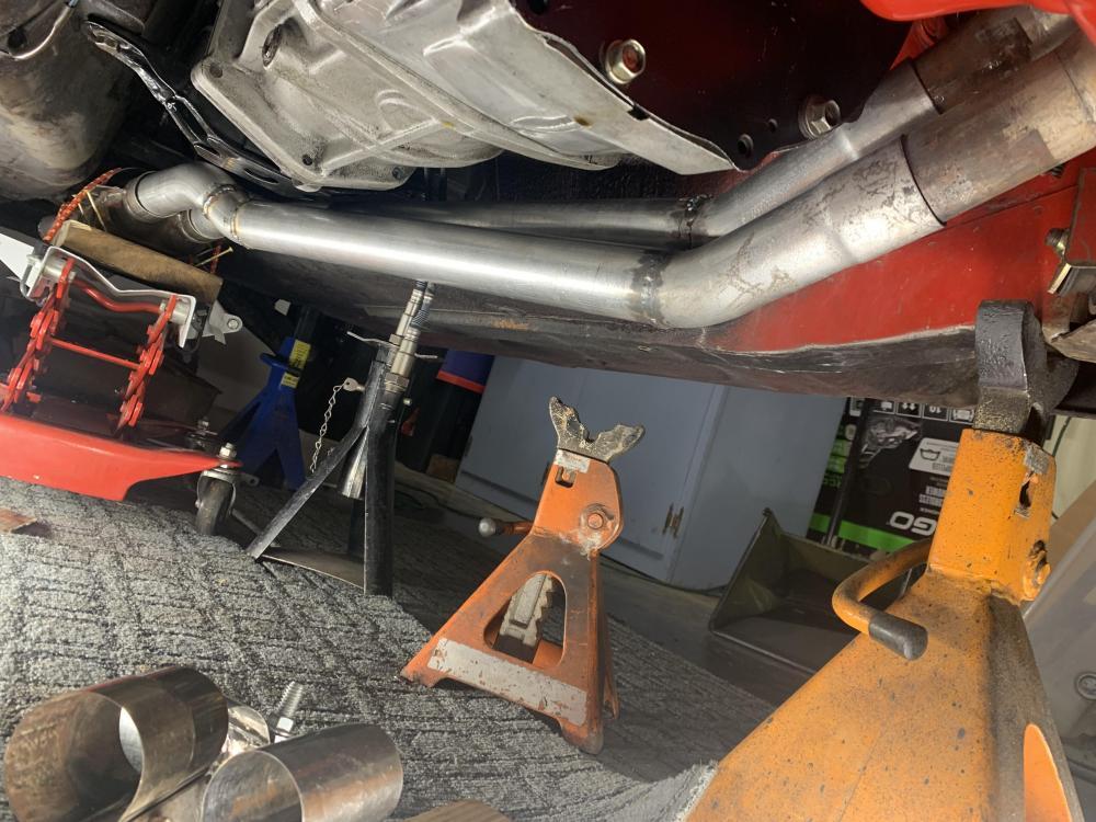

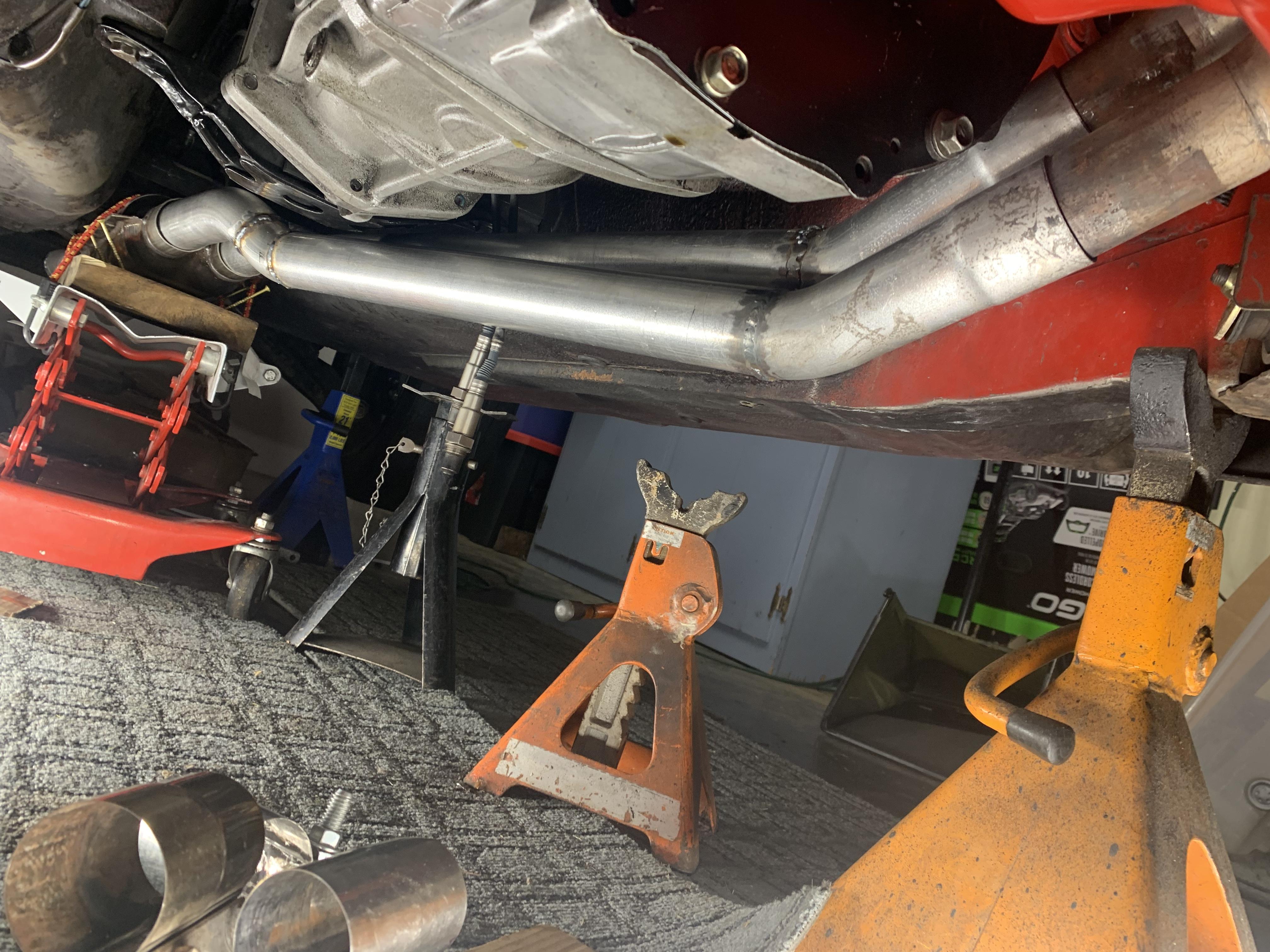

June 19, 20213 yr Author comment_623769 Well I ran out of argon which forced me to go back to my spool gun . Figured out it’s issue ( operator error ), but live and learn . It’s sooooooo much faster with MIG ! This is my initial attempt , but I might redo it . I was hoping for a bit more spacing between the pipes . I could have gained a bit more clearance by get the pipes side by side sooner . It will be a trick , but I have lots of mandrel bends to use . The back half will be the easy part . Link to comment https://www.classiczcars.com/forums/topic/65499-duals-do-over/?&page=2#findComment-623769 Share on other sites More sharing options...
