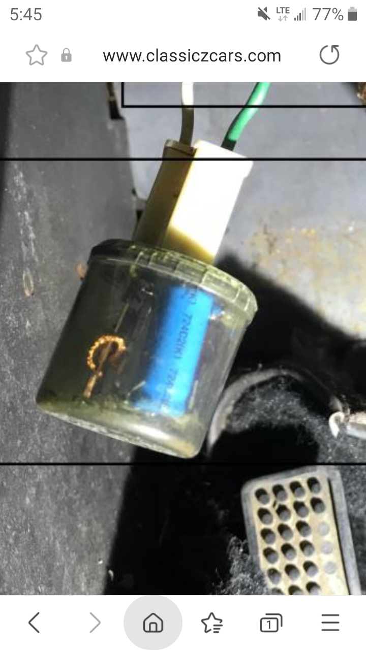

June 22, 20213 yr Author comment_623934 yup also the broken wire off the turn signal area also fixes that.. so signals now work... next thing is WHY DID SOMEWONE PUT A WiRE FROM BLACK WHITE ON IGNITION TO THE GREEN AT THE SIGNAL RELAY??? ALso... NO RUNNING LIGHTS... THAT WIRE on relay goes up to ignition and taps into a black/white.. were they getting no power to signals??? Link to comment https://www.classiczcars.com/forums/topic/65522-260z-horn-signals-wipers-not-working/?&page=3#findComment-623934 Share on other sites More sharing options...
June 22, 20213 yr comment_623935 What the hell is that? A fuel filter. You're going to need a lot of help and you'll get it here. Walk lightly my friend. It took me a year at least before these wunderful guys accepted me into their fold. Edited June 22, 20213 yr by siteunseen Link to comment https://www.classiczcars.com/forums/topic/65522-260z-horn-signals-wipers-not-working/?&page=3#findComment-623935 Share on other sites More sharing options...
June 22, 20213 yr Author comment_623939 That’s a turn signal relay. Put a new one in and signals work. Now trying to figure out why someone tapped a wire in there from the black white by ignition key. Any ideas??? Still have no horn no side markets. Link to comment https://www.classiczcars.com/forums/topic/65522-260z-horn-signals-wipers-not-working/?&page=3#findComment-623939 Share on other sites More sharing options...

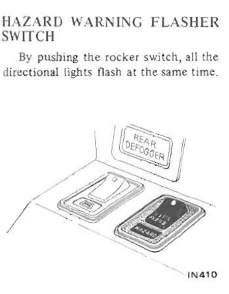

June 22, 20213 yr comment_623940 On 6/21/2021 at 12:46 PM, Zed Head said: It's a flasher. I'm going to guess that somebody tired tried to bypass the Hazard switch. @SteveJ The Hazard switch seems to have some complex circuits inside, I've never had one part, but the Green wire seems to be involved. The switches get dirty inside and stop working. I'm going to guess that somebody was bypassing the Hazard switch. Does the Hazard switch cause the lights to flash? Link to comment https://www.classiczcars.com/forums/topic/65522-260z-horn-signals-wipers-not-working/?&page=3#findComment-623940 Share on other sites More sharing options...

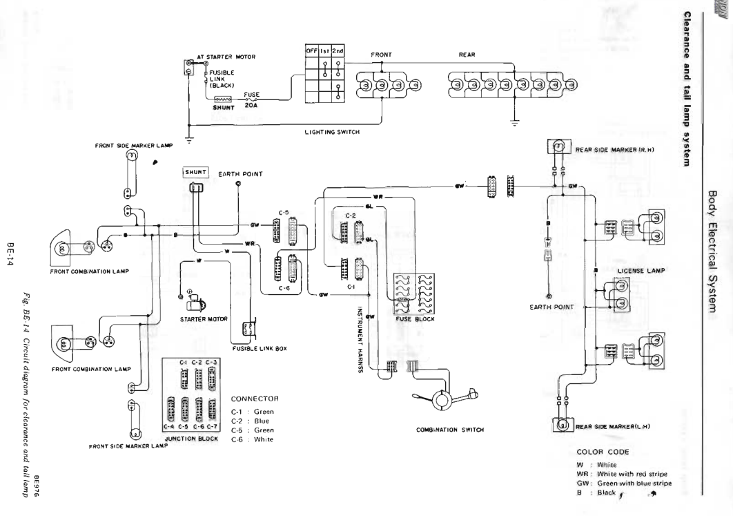

June 23, 20213 yr Author comment_623941 ohhhh the hazzard switch does work.. i cant recall which lights flash... i just now got the two rear side markers working -after i took of the steering wheel controls and some wires bounced around the rear side markers are now on.. but no power to the front markers... any ideas on that?? what is this relay box on drivers side engine compartment below the coil... ?? what is that for??? Link to comment https://www.classiczcars.com/forums/topic/65522-260z-horn-signals-wipers-not-working/?&page=3#findComment-623941 Share on other sites More sharing options...
June 23, 20213 yr comment_623943 8 minutes ago, Shawninvancouver said: but no power to the front markers... any ideas on that?? C-5 or earth point. Link to comment https://www.classiczcars.com/forums/topic/65522-260z-horn-signals-wipers-not-working/?&page=3#findComment-623943 Share on other sites More sharing options...
June 23, 20213 yr Author comment_623944 is that for a 260? Link to comment https://www.classiczcars.com/forums/topic/65522-260z-horn-signals-wipers-not-working/?&page=3#findComment-623944 Share on other sites More sharing options...
June 23, 20213 yr comment_623946 'posed to be. https://www.classiczcars.com/files/category/12-260z/ Link to comment https://www.classiczcars.com/forums/topic/65522-260z-horn-signals-wipers-not-working/?&page=3#findComment-623946 Share on other sites More sharing options...
June 23, 20213 yr Author comment_623947 ok zed - i found that diagram now... clearance and tail lamps.. i was looking for side markers or something else,.... so my silly question is - i see the ground i want to check on the diagram - in red. but how do i actually find that wire...????? what in the world do i look for?? please teach me.. Edited June 23, 20213 yr by Shawninvancouver Link to comment https://www.classiczcars.com/forums/topic/65522-260z-horn-signals-wipers-not-working/?&page=3#findComment-623947 Share on other sites More sharing options...
