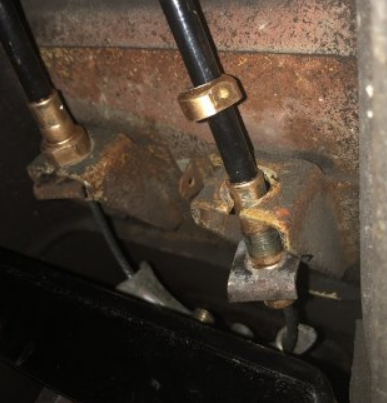

Here's today's ZCD picture.  Looks like they went to a one piece end as madkaw said.  The old picture from hybridz is below it.  Looks like MSA has the same vendor as ZCD used to have.  Crimped/punched collars that slip off when used.
No product failure is ever welcomed, and we will certainly be talking to the manufacturer about this one, and continue to monitor them. We're of course very sorry that both of your products had obvious issues. We have sold over 180 of them since 2016, and these are the first two alerts we know of concerning this issue (possibly 3 assuming the one from Hybrid was the same manufacturer, which is hard to tell for sure, since there have been a few similar options on Ebay over the past couple of years, some of which are no longer around). Hopefully it is not more than 2-3 out of 180 and not indicative of a mass or new problem, we'll certainly look carefully at the next batch we receive. As far as we know the rest of the 180 that were installed are working fine to this day. If other members have had the same issue with this style, please let us know. Certainly Greg and this company have not stayed in business for over 40 years by ignoring reports like this, they are all taken seriously, and again, we'll make sure the manufacturer is aware of it.

It's a poor design and should be discontinued. I guarantee there have been many more failures , but some customers don't even realize it -until maybe their car rolls away. A partial fail won't be noticed until its too late. It should NOT be a 2 piece design for an emergency brake cable .

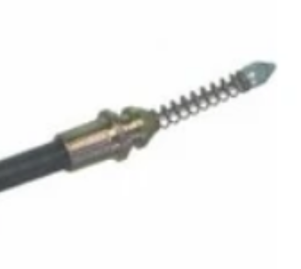

This is the one I used and it’s been great - admittedly with covid I’ve done fewer miles than usual but it gets used nearly daily as I pull the car out of the garage to get to stuff.
https://www.ebay.co.uk/itm/DATSUN-FAIRLADY-260Z-280Z-PARKING-HAND-BRAKE-CABLE-EMERGENCY-/151459145571
  • 2 weeks later...
from AK260 above.
I ordered this cable from ebay as suggested above to check it for fitment and quality.
I am very very impressed. Ordered Jun 23, arrived July 5th. Paid $102.53 CAD shipped and customs fees paid.
Design is nearly identical to the OEM cable. Even came with a new pair of pins for the wheel end.
@Joseph@TheZStoreI would suggest considering investigating if you can source these cables. Highly recommended them.
