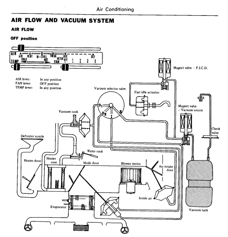

Posted June 23, 20213 yr comment_623972 I'm attempting to install an HVAC system from a 260Z with factory AC to a none AC 280Z. I'm not familiar with the vacuum systems. How does it gets its air from to open close the air ducts and water heater from? I've looked at the fsm but still can't figure it out. Will it work? I've got new compressor and condenser. Anyone done this before? Your help is appreciated. Thanks. Link to comment https://www.classiczcars.com/forums/topic/65532-260z-factory-ac-to-none-ac-280z/ Share on other sites More sharing options...
June 23, 20213 yr comment_623974 It's shown in the AC chapter. There are two solenoids (magnet valves) that control vacuum from a reservoir bottle that gets its vacuum from the intake manifold. This is from 1976. Link to comment https://www.classiczcars.com/forums/topic/65532-260z-factory-ac-to-none-ac-280z/#findComment-623974 Share on other sites More sharing options...
June 23, 20213 yr Author comment_623977 Thanks ZH, looks like I'm still missing a few important components. Is it still possible to get these aftermarket? Link to comment https://www.classiczcars.com/forums/topic/65532-260z-factory-ac-to-none-ac-280z/#findComment-623977 Share on other sites More sharing options...
