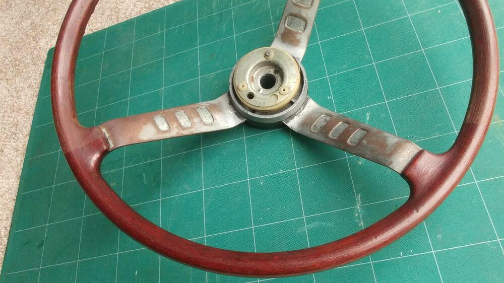

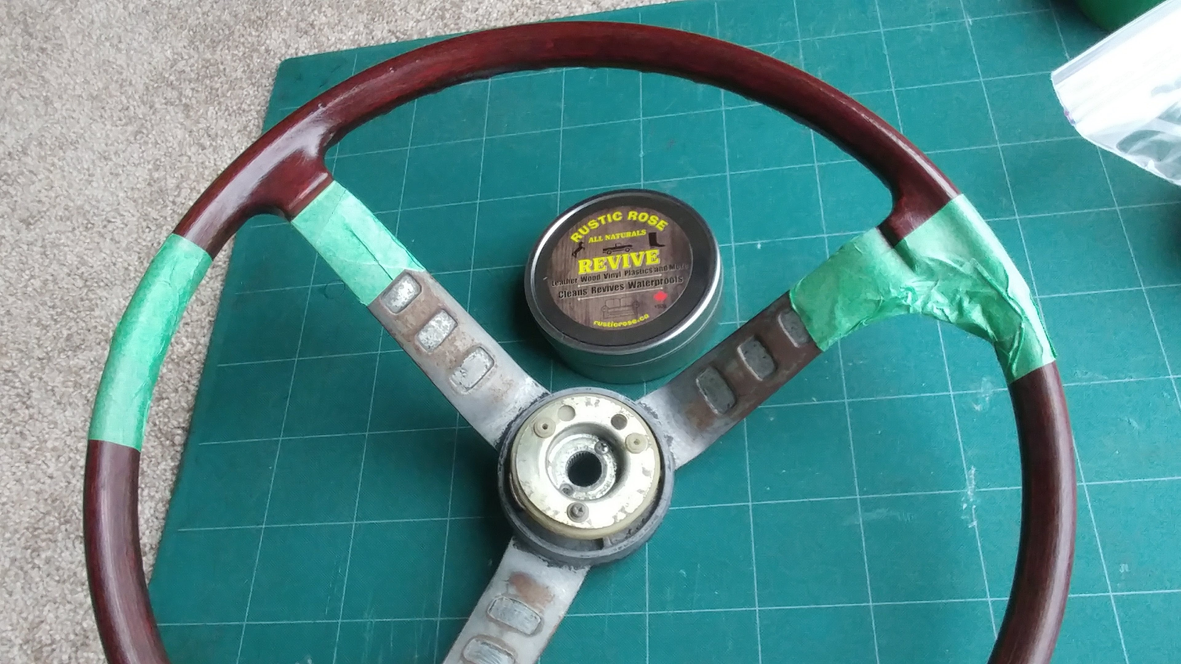

A little of topic but I have tested a product called Revive to refresh the finish of an old steering wheel from my parts car. I was very impressed with the result and there is no greasy feel to the surface. This steering was very grey looking before I started, but I didn't take a picture at that state. I first cleaned the wheel with soap and water and after it was thoroughly dry I applied the product.

Going to check out out this week. Is there anything to look out for with regards to the center gearing where the hub connects to the steering wheel? Or with the electrical for the horn?

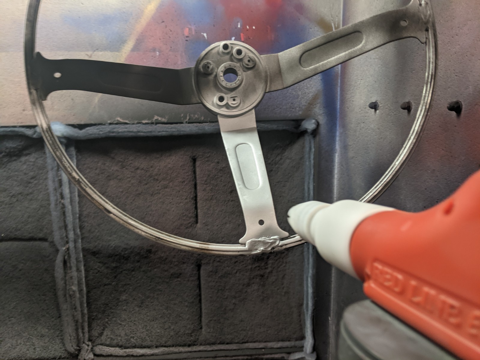

The hub should not require any special care or treatment. Remove the horn elements and set them aside for a good cleaning. Strip and clean the spokes and hub for your paint prep. I found that refinishing the rim before painting the spokes and hub worked best for me. This is a fun and satisfying project, looking forward to your results.

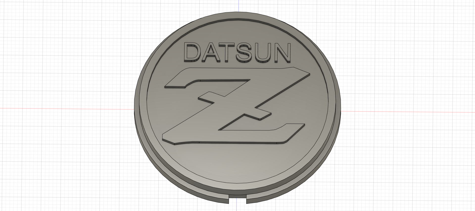

Now I'm waiting on someone to train me in using a Haas Mini Mill to make a new center coin for the padded horn button.
You've got access to one of those? That would be really sweet!

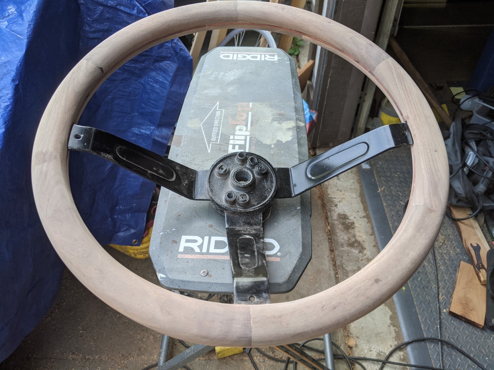

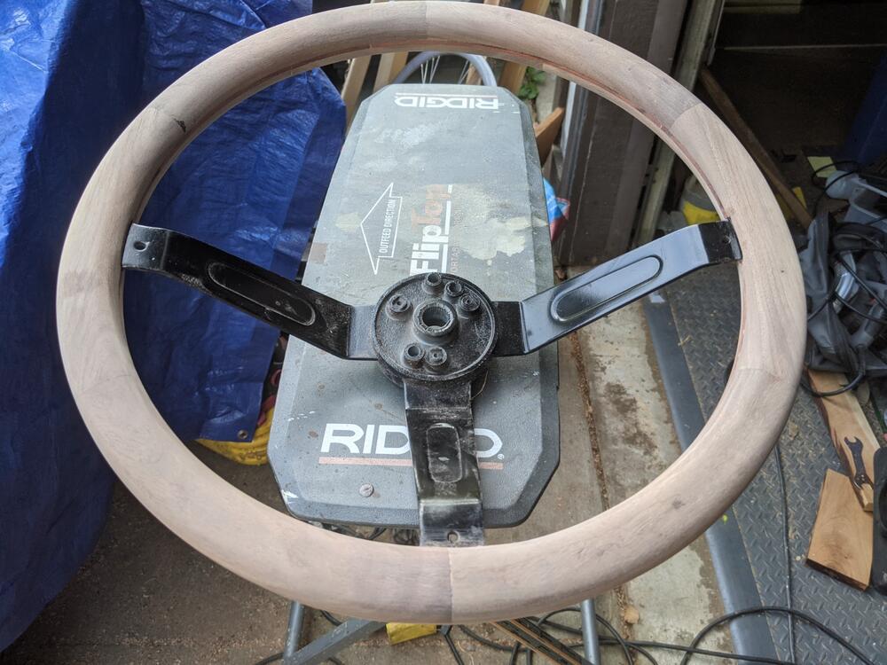

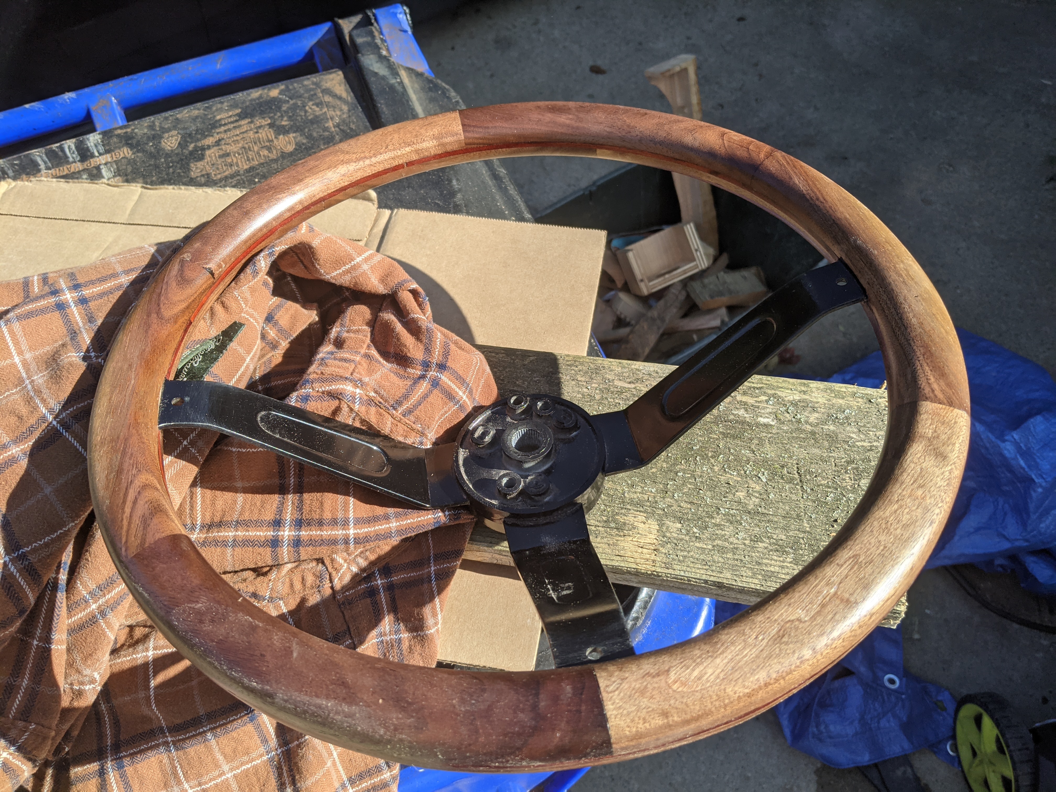

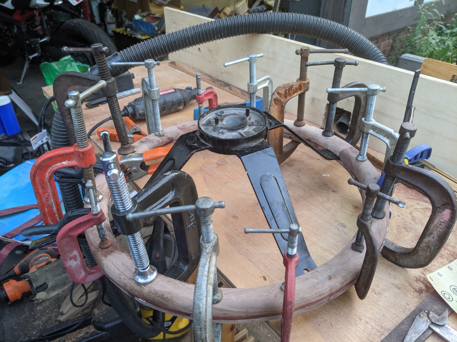

13 hours ago, Jeff Berk said:
Finished with wipe on varnish.

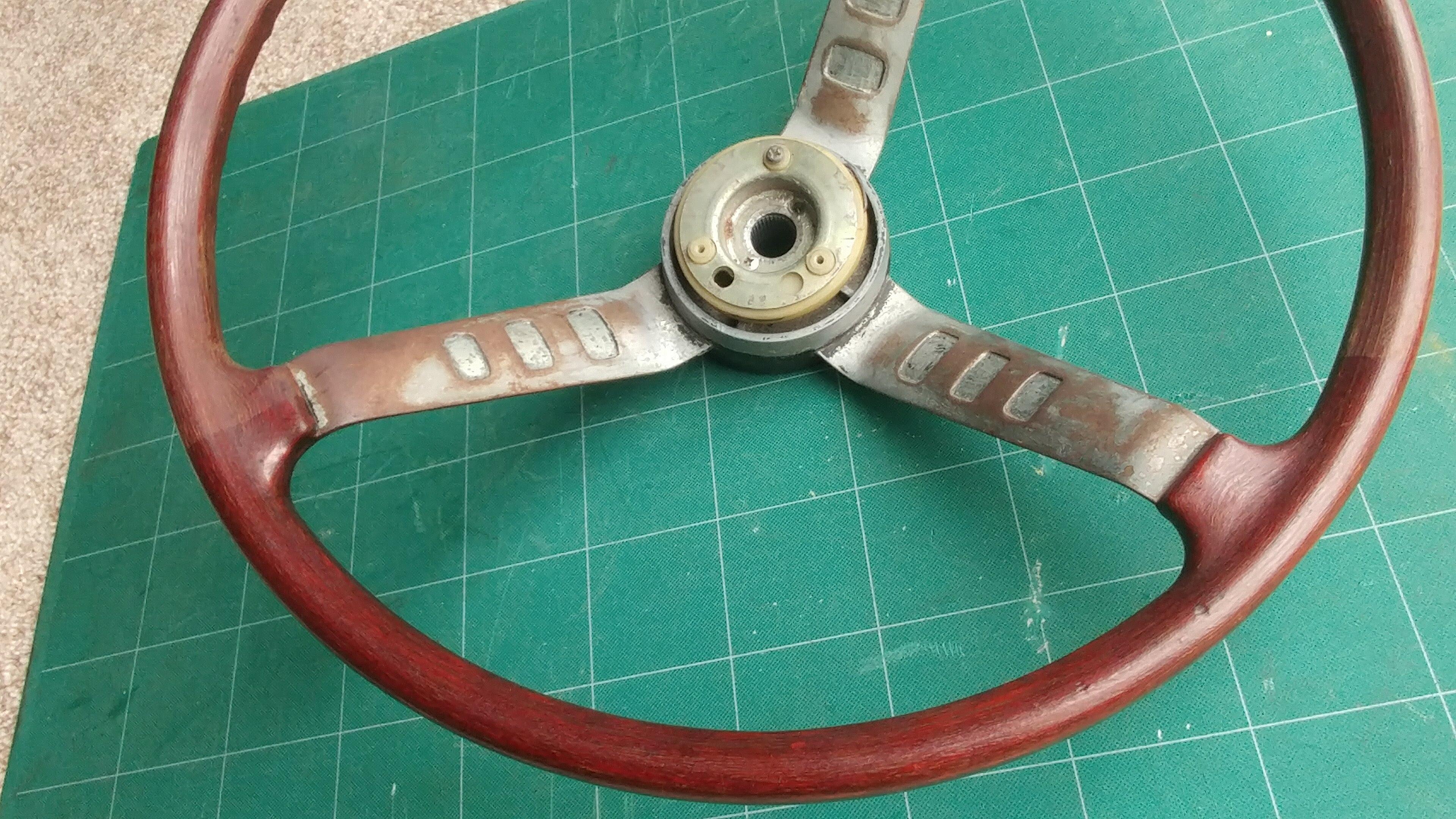

NICE! I did a simular wheel in mahogany (left pic!!)  in 2007 till this day a shiny wheel!  I layd 7-8 coats of varnish on it to make a deep shine, you made a nice wheel but i would have made it a bit deeper and not as wide (if you know what i mean.) There are pics of my wheel in another topic about steeringwheels..
Dutchzcarguy... My intent was to make it narrower, but I liked the feel of it. This wheel is really heavy, I guess because of the epoxy.

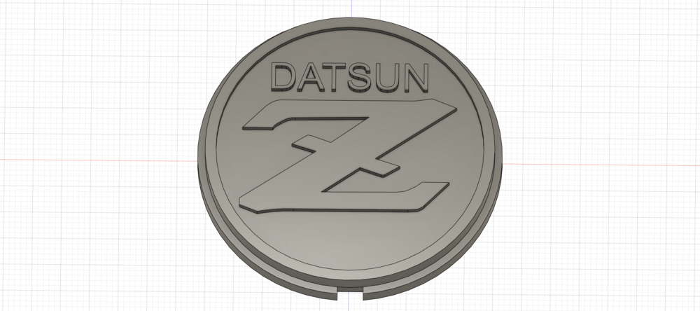

CO... I've not used the Haas mill yet but its available so its on my bucket list. I was disappointed when I pulled out the original steering hub coin and found it to be chromed plastic. My prototype is attached. If successful, I'll powdercoat it and then buff off the coating on the raised "Datsun Z".
Edited by Jeff Berk
Could it be that that Z is upside down?  you started with the z upside down and took a bit off of the left lower .. ?  If i look at a imaginary vertical line the original Z sign is shorter on the upper horizontal line (on the left).. this one is not..
Hope you know what i mean.. Also the foot of the z is normally longer on the right as shown above..  sorry am i nitpicking? 😟
