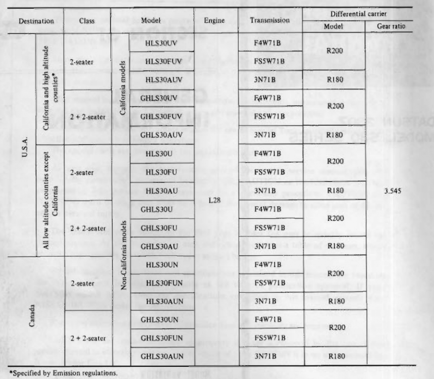

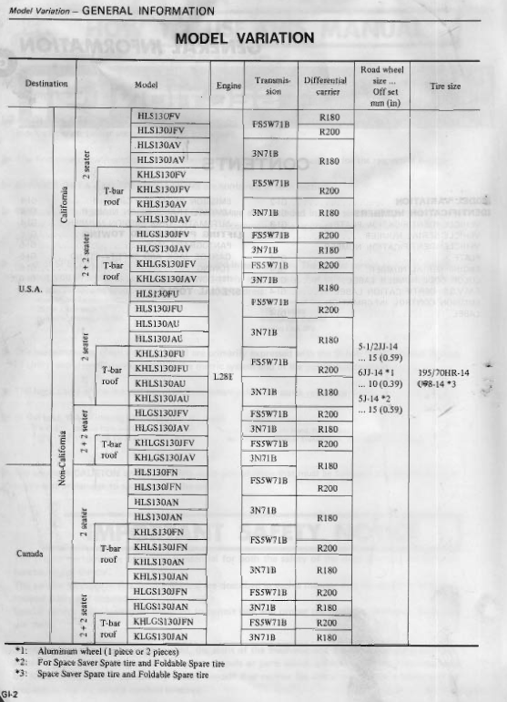

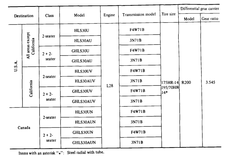

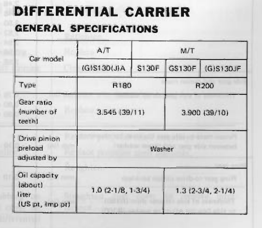

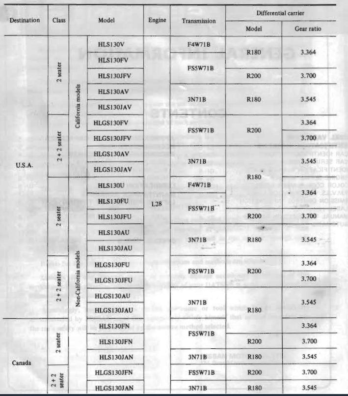

June 30, 20213 yr comment_624309 I think that Carl Beck has a pretty good description on his zhome site. I'll see if I can find it. You can't generalize by just the type of car. You have to go by year. Here are four examples. 1976 USA/Canada 280Z FSM 1978 USA/Canada 280Z FSM 1979 USA/Canada 280ZX FSM 1981 USA/Canada FSM Link to comment https://www.classiczcars.com/forums/topic/65551-datsun-nissan-z-and-zx-types-of-transmissions-and-differentials/#findComment-624309 Share on other sites More sharing options...
June 30, 20213 yr comment_624310 More from 1981, PD chapter. Link to comment https://www.classiczcars.com/forums/topic/65551-datsun-nissan-z-and-zx-types-of-transmissions-and-differentials/#findComment-624310 Share on other sites More sharing options...
