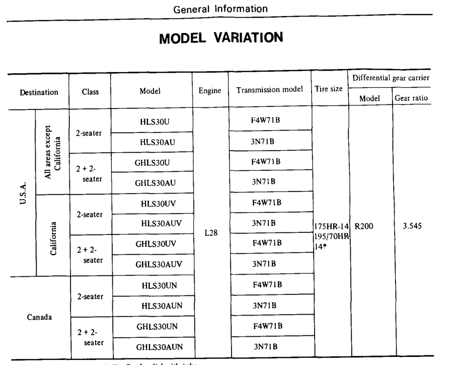

July 1, 20213 yr comment_624383 On 7/1/2021 at 6:43 PM, Zed Head said: Is it a 2+2? That was my key point. No, it is a 2 seater. I thought maybe the late 74 2+2 got the R200, but it doesn't show up in the FSM until '75. Of course, we all know that there were mid-year changes throughout the S30 run. I would think that something as significant as a differential would have shown up in the FSM since the dealers would have to service them. Link to comment https://www.classiczcars.com/forums/topic/65551-datsun-nissan-z-and-zx-types-of-transmissions-and-differentials/?&page=3#findComment-624383 Share on other sites More sharing options...

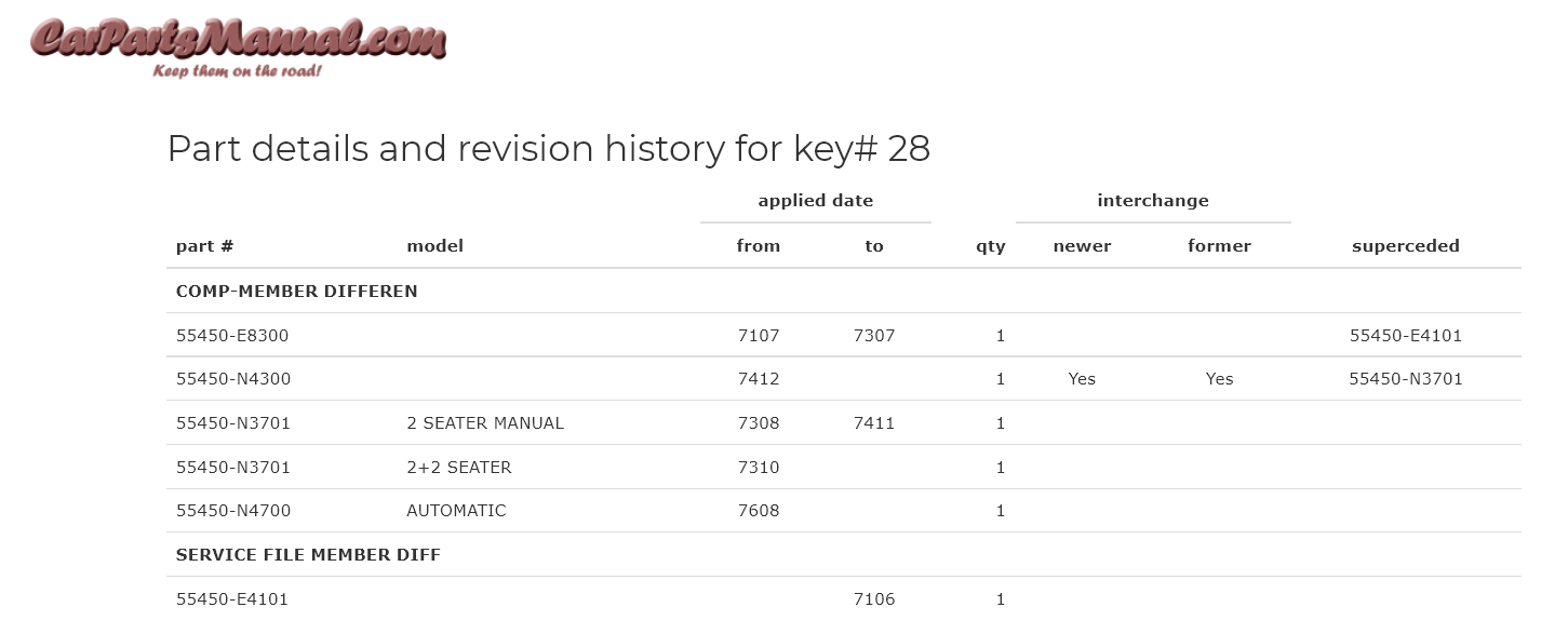

July 1, 20213 yr comment_624388 Here's a part that continued through the R180 to the R200. Kind of suggests that October 1973 was when "something different" happened with the mustache bar for the 2+2. Maybe I should be looking at small bumper 2+2's also. Edit - actually I did when I looked through BAT. Only one guy showed the diff. https://bringatrailer.com/datsun/260z/?q=260z http://www.carpartsmanual.com/datsun/Z-1969-1978/axle/rear-suspension/28 Edited July 1, 20213 yr by Zed Head +'s Link to comment https://www.classiczcars.com/forums/topic/65551-datsun-nissan-z-and-zx-types-of-transmissions-and-differentials/?&page=3#findComment-624388 Share on other sites More sharing options...

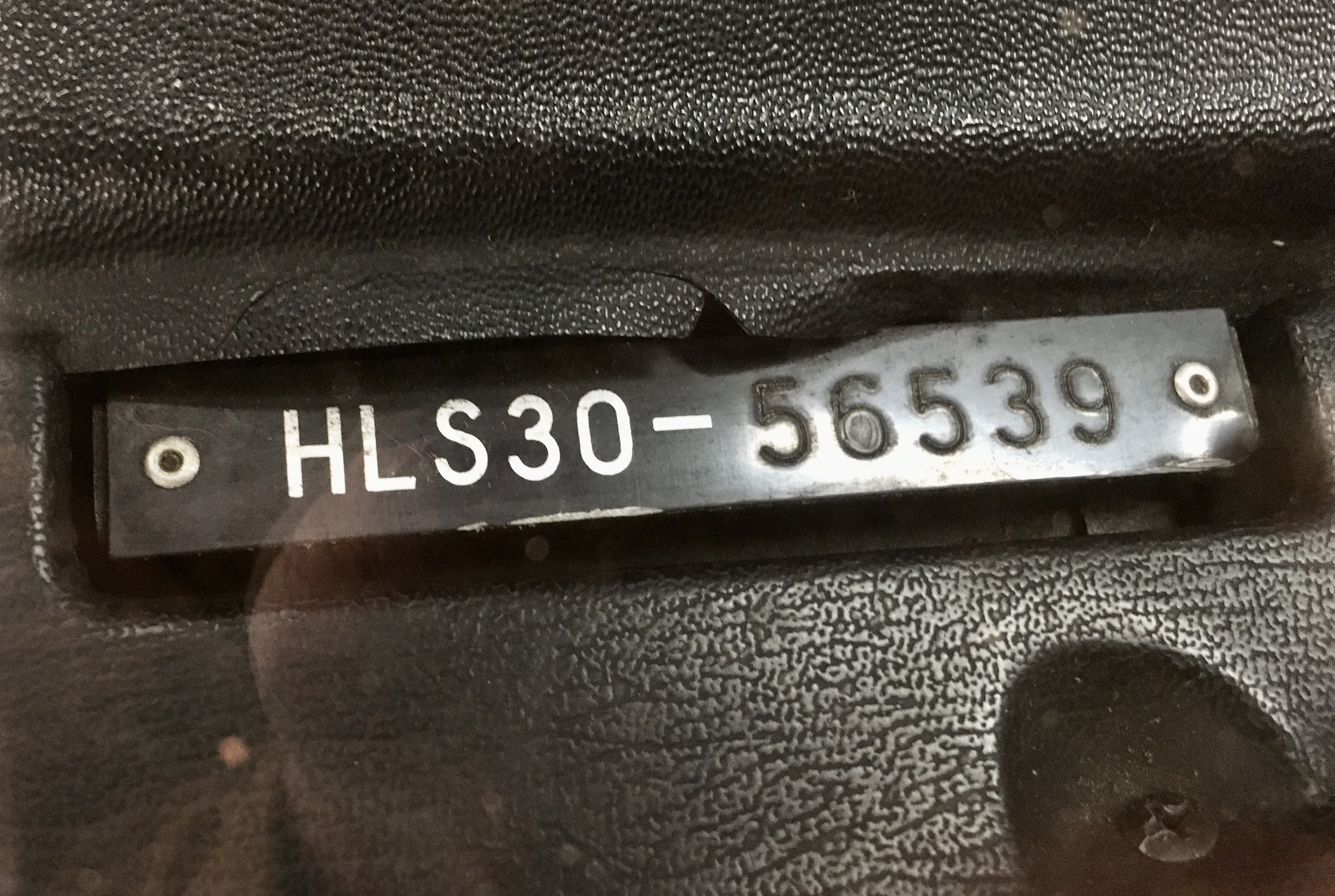

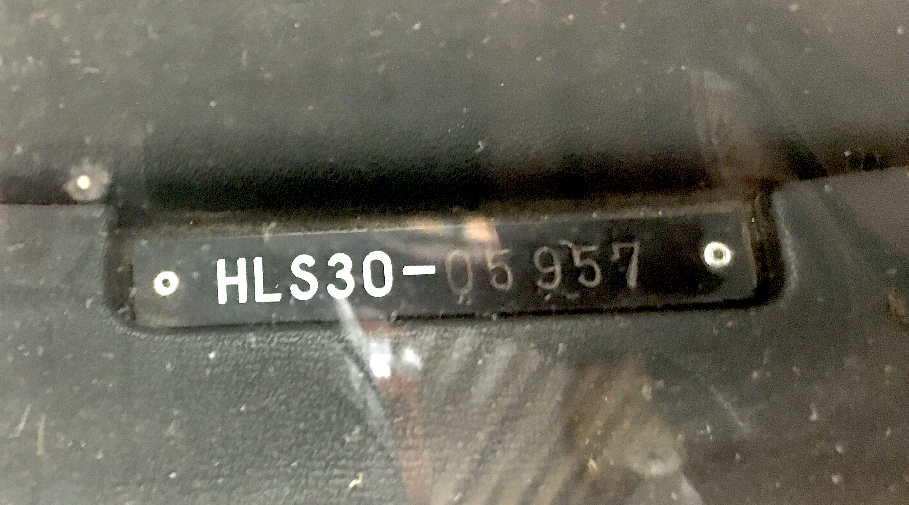

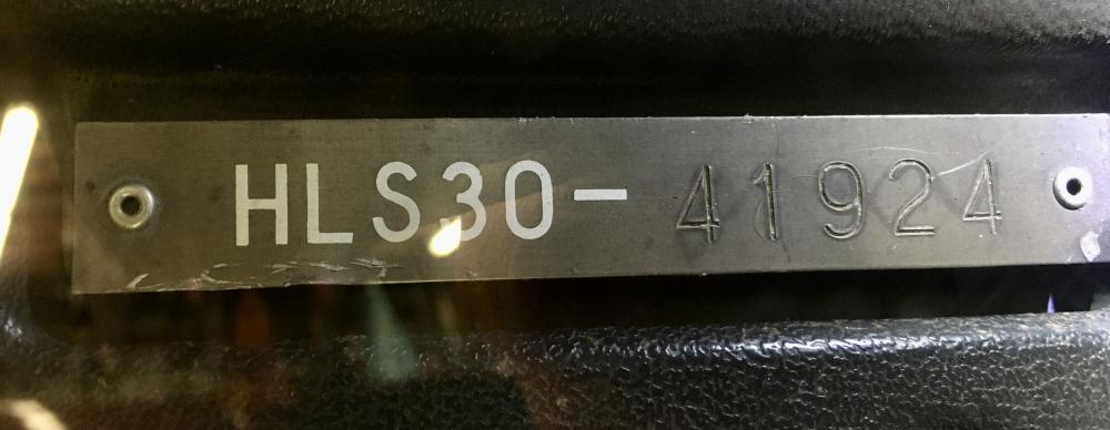

July 1, 20213 yr comment_624390 On 7/1/2021 at 11:15 AM, HS30-H said: Prefix for the USA/Canada Datsun 260Z model was 'RLS30'. Check your factory documentation. Really? I guess the 13 S30 Z cars I own must be something else then. Here are VIN tags of three of them. But then, what do I know? Edited July 1, 20213 yr by Racer X Link to comment https://www.classiczcars.com/forums/topic/65551-datsun-nissan-z-and-zx-types-of-transmissions-and-differentials/?&page=3#findComment-624390 Share on other sites More sharing options...
July 1, 20213 yr comment_624391 On 7/1/2021 at 7:39 PM, Racer X said: Really? I guess the 13 S30 Z cars I own must be something else then. Here are VIN tags of three of them. But then, what do I know? I'm confused by what you are saying. Yes, Nissan used HLS30 for the US 240Z and 280Z, but they used RLS30 for the 260Z. Link to comment https://www.classiczcars.com/forums/topic/65551-datsun-nissan-z-and-zx-types-of-transmissions-and-differentials/?&page=3#findComment-624391 Share on other sites More sharing options...

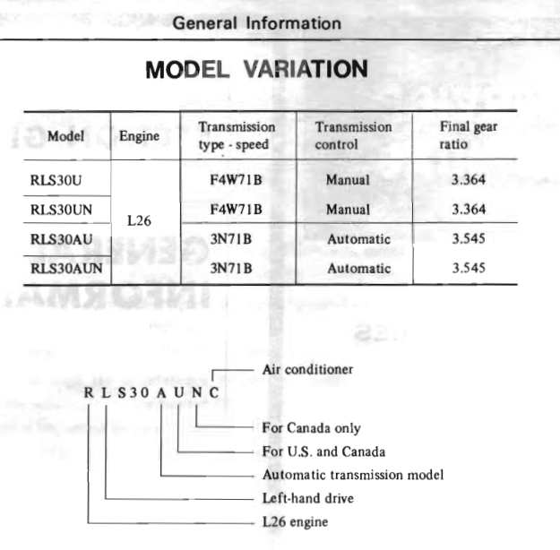

July 1, 20213 yr comment_624392 He said 260Z, not 240Z. Here's the GI from 1974. Oops. Edited July 1, 20213 yr by Zed Head Link to comment https://www.classiczcars.com/forums/topic/65551-datsun-nissan-z-and-zx-types-of-transmissions-and-differentials/?&page=3#findComment-624392 Share on other sites More sharing options...
July 1, 20213 yr comment_624393 240Z. Link to comment https://www.classiczcars.com/forums/topic/65551-datsun-nissan-z-and-zx-types-of-transmissions-and-differentials/?&page=3#findComment-624393 Share on other sites More sharing options...
July 1, 20213 yr comment_624394 And 280Z. Back to H. Nissan really made the 260Z an odd odd bird... Link to comment https://www.classiczcars.com/forums/topic/65551-datsun-nissan-z-and-zx-types-of-transmissions-and-differentials/?&page=3#findComment-624394 Share on other sites More sharing options...
