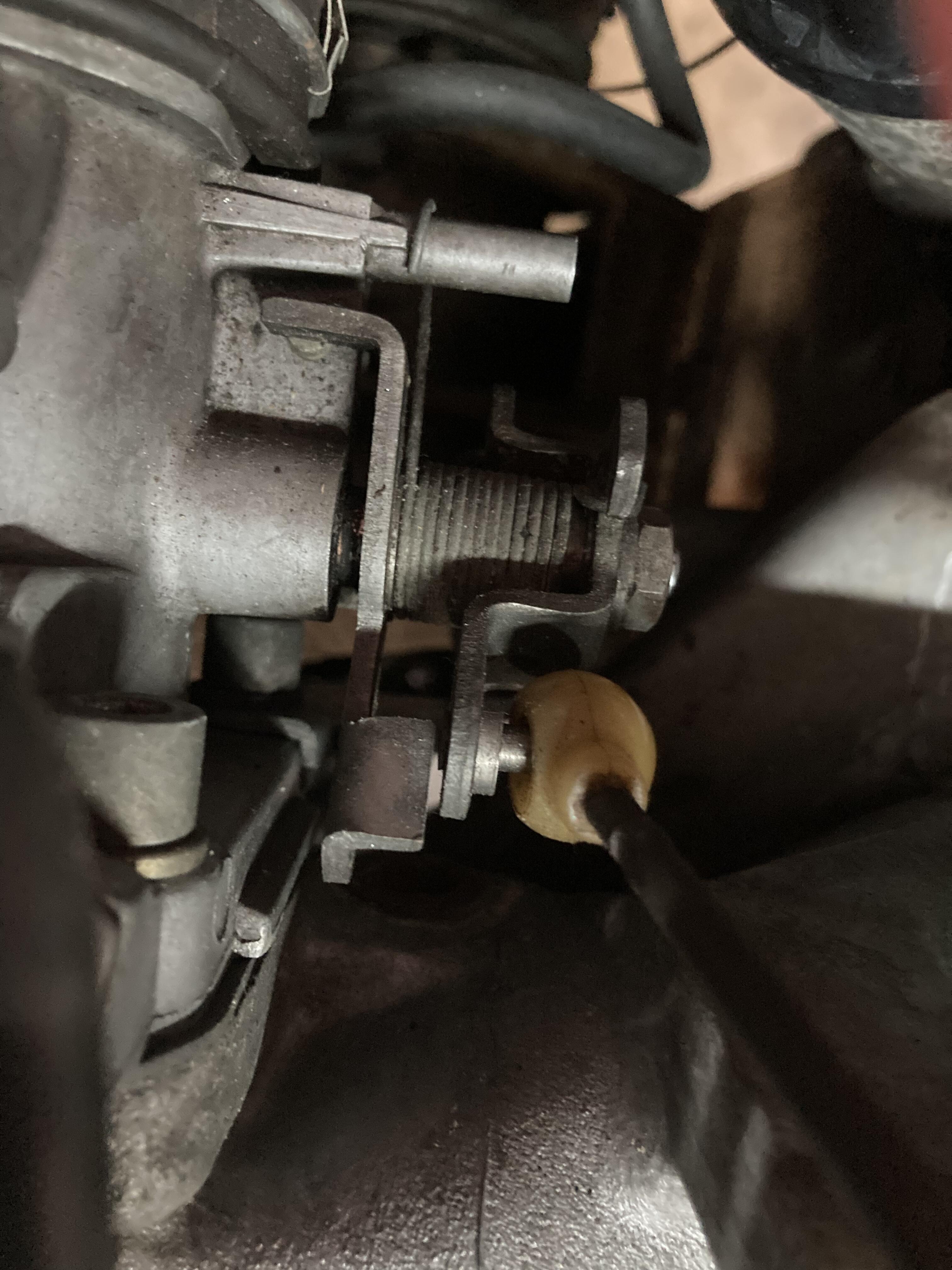

October 30, 20213 yr Author comment_630690 On 10/30/2021 at 5:14 PM, Yarb said: The canister and the vac advance are connected by a vacuum “T”. The bracket for the spring iirc mounts to the bottom bolt on the throttle body on the engine side.Okay thanks. I don’t see a bolt on the bottom on my TB even looked at my other one that I’m a box. I’ll take a pic of the bottom and post it shortly. Got it on the vac advance. So the “T” one side to Carbon Canister, one to Vacuum Adv and where does third part of “T” go? I need to buy new lines. Mine are super brittle Sent from my iPhone using Tapatalk Link to comment https://www.classiczcars.com/forums/topic/65616-putting-in-a-replacement-l-28/?&page=23#findComment-630690 Share on other sites More sharing options...
October 30, 20213 yr comment_630694 Theres a curved vacum port on the bottom of the throttle body Link to comment https://www.classiczcars.com/forums/topic/65616-putting-in-a-replacement-l-28/?&page=23#findComment-630694 Share on other sites More sharing options...
October 30, 20213 yr comment_630695 On 10/30/2021 at 6:25 PM, Yarb said: Theres a curved vacum port on the bottom of the throttle body John, your intake does not have 4 bolts where the throttle body mounts? Link to comment https://www.classiczcars.com/forums/topic/65616-putting-in-a-replacement-l-28/?&page=23#findComment-630695 Share on other sites More sharing options...
October 30, 20213 yr comment_630696 Look straight down in the pic. You’ll see the bottom bolt next to the recoil spring and you can see the edge of the spring bracket held on by that bolt. Here’s a pic Link to comment https://www.classiczcars.com/forums/topic/65616-putting-in-a-replacement-l-28/?&page=23#findComment-630696 Share on other sites More sharing options...

October 31, 20213 yr comment_630724 1 - Yes, the vacuum port on the throttle body that points forward is the one that supplies vacuum to both the distributor advance and the carbon can "DIST" (distributor) port. From the throttle body nipple, to the "T". Then after the "T", one side goes to the distributor and the other side goes to the control signal port on the carbon can. 1a - Yes, if you aren't running EGR, just cap off the other vacuum nipple. 2 - The "purge" line on the carbon can goes directly to the intake manifold. One of the ports on top that is always straight-up manifold vacuum. 3 - The bracket for the return spring mounts under one of the four Allen head bolt that hold the throttle body to the intake manifold. As mentioned above, the bolt is the one on the lower right. Here's a pic of an upside-down throttle body and you can see where and how the bracket mounts: Link to comment https://www.classiczcars.com/forums/topic/65616-putting-in-a-replacement-l-28/?&page=23#findComment-630724 Share on other sites More sharing options...

October 31, 20213 yr comment_630741 On 10/31/2021 at 12:50 PM, Av8ferg said: Looks like I need to pull my AFM back off to get the spring on. The only times I've messed with that spring and bracket was while I was bolting the throttle body onto the snout on the intake manifold, so I don't know if there's enough room to get in there and deal with it while the AFM and rubber tube are in place or not. You might have to take off that stuff in order to fit hands down in there to put the bracket and spring in place. Here's hoping you don't have to take too much off to get in there. Link to comment https://www.classiczcars.com/forums/topic/65616-putting-in-a-replacement-l-28/?&page=23#findComment-630741 Share on other sites More sharing options...
