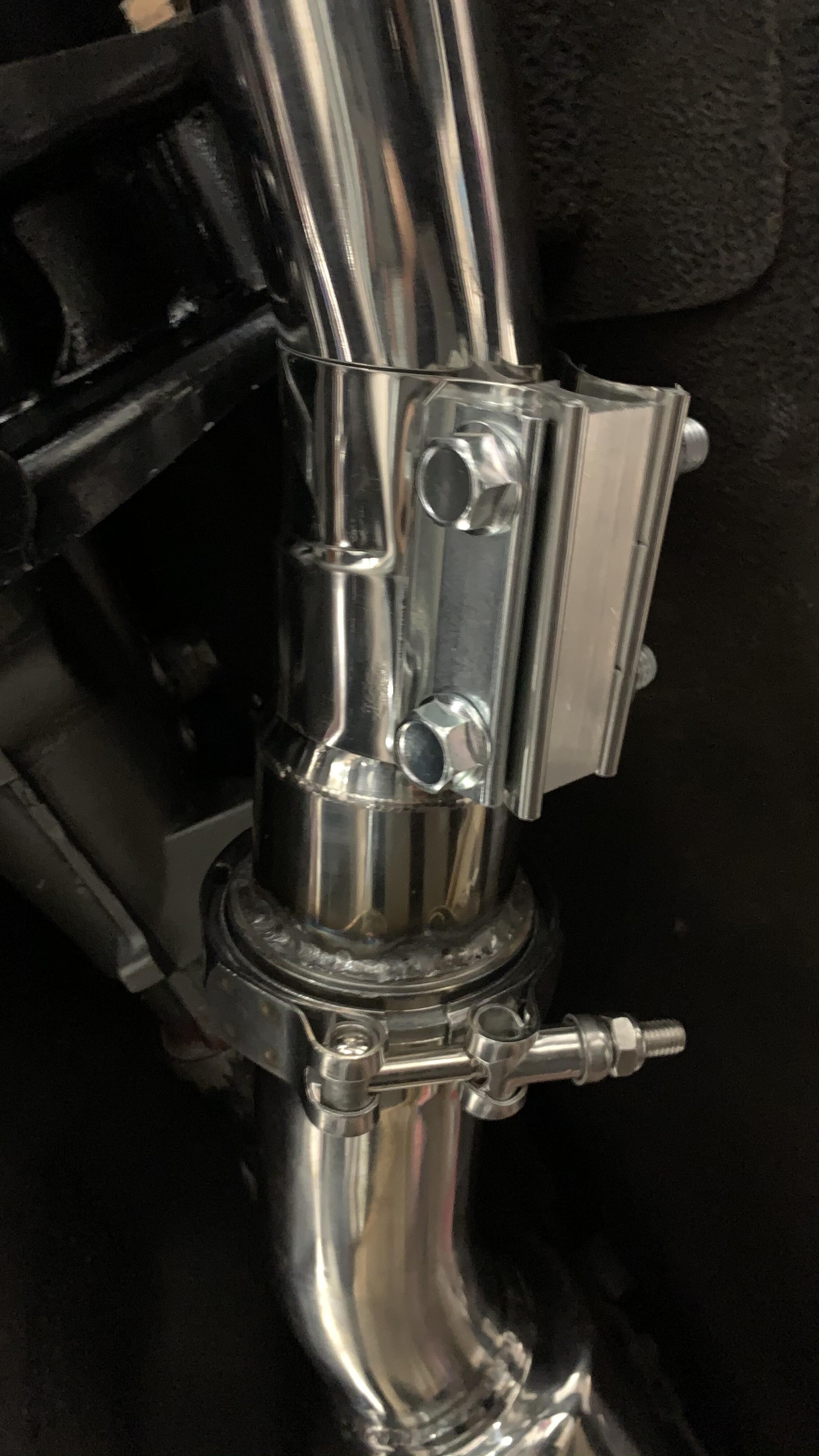

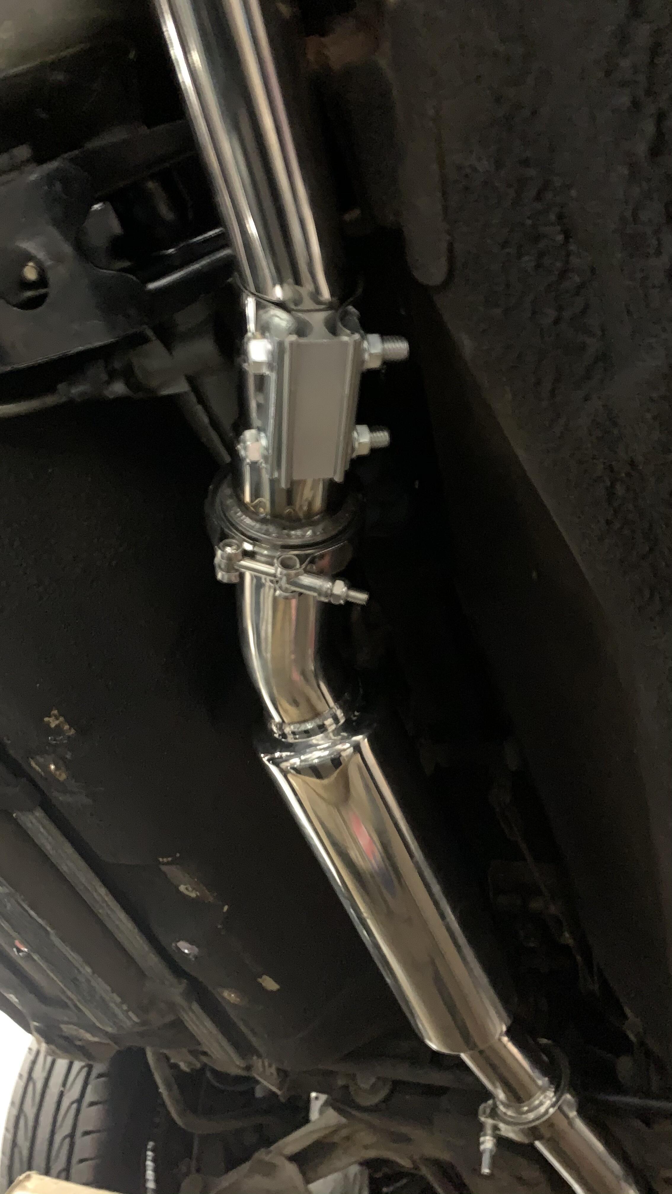

Finally got the exhaust mostly installed.   I still have some minor tweaks with hangars and I’ll be finished.  Spent a couple hours today hunting down someone who could weld stainless steel.   It began as a wild goose chase but finally found a guy.   Charged me $40 to weld the V-band fitting to the pipe 2”-2’5” adaptor.
Came out good and I got it all bolted up and the system sounded great. Will post a video tomorrow, once I’m done so people can hear the Z-Story classic muffler on a EFI L28.

Oh btw.. that clamp right behind your pre muffler .. give it a turn your scalp will be thankful  😉

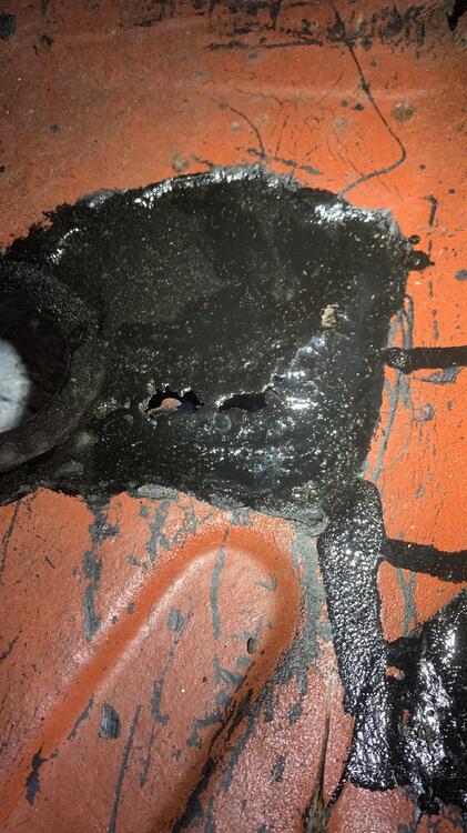

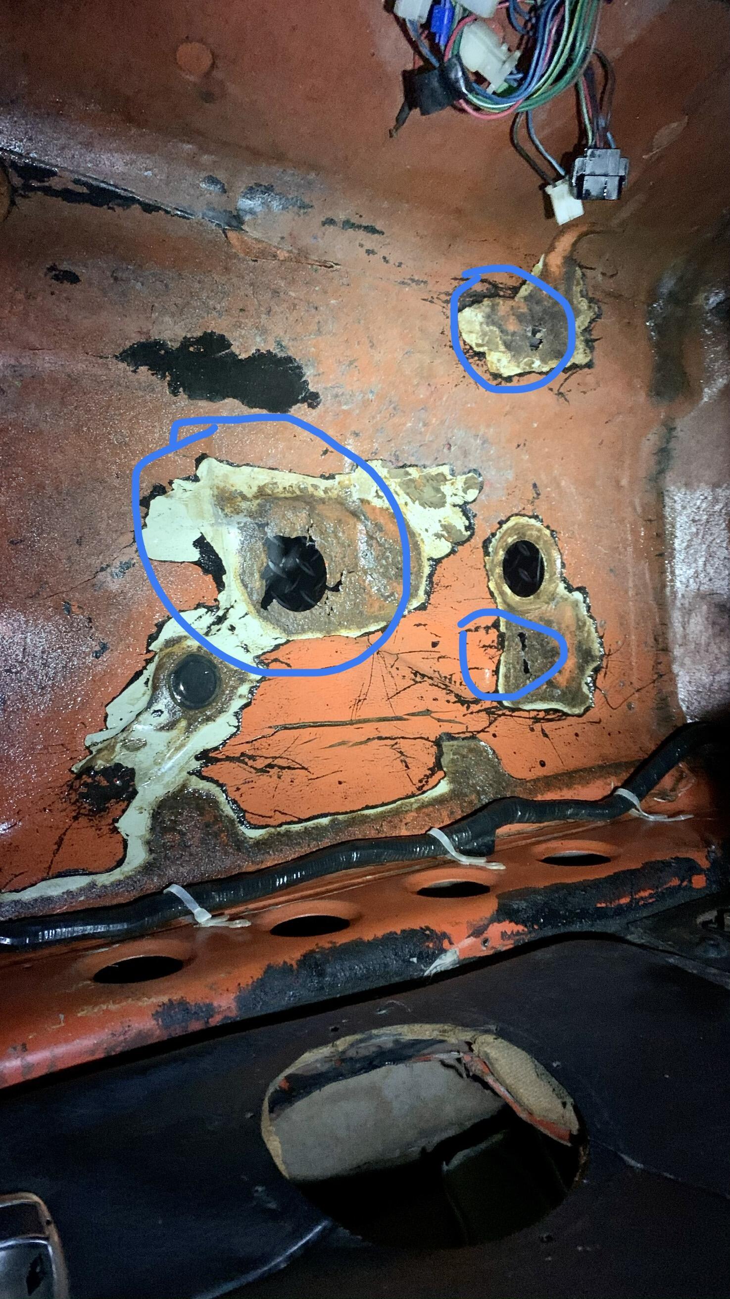

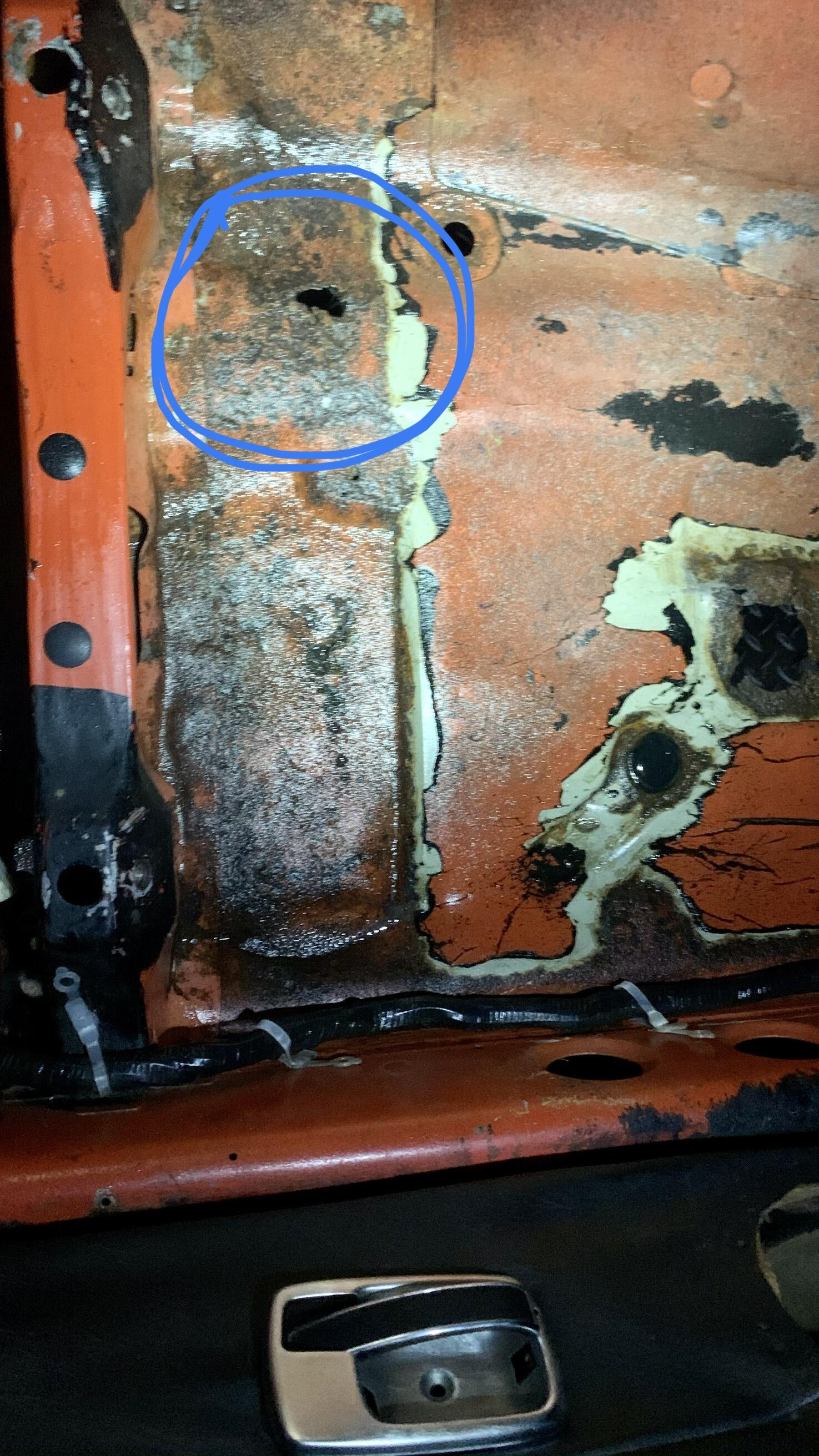

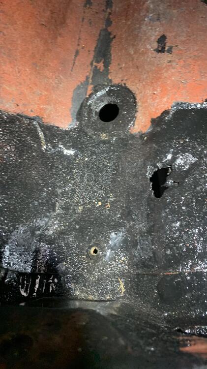

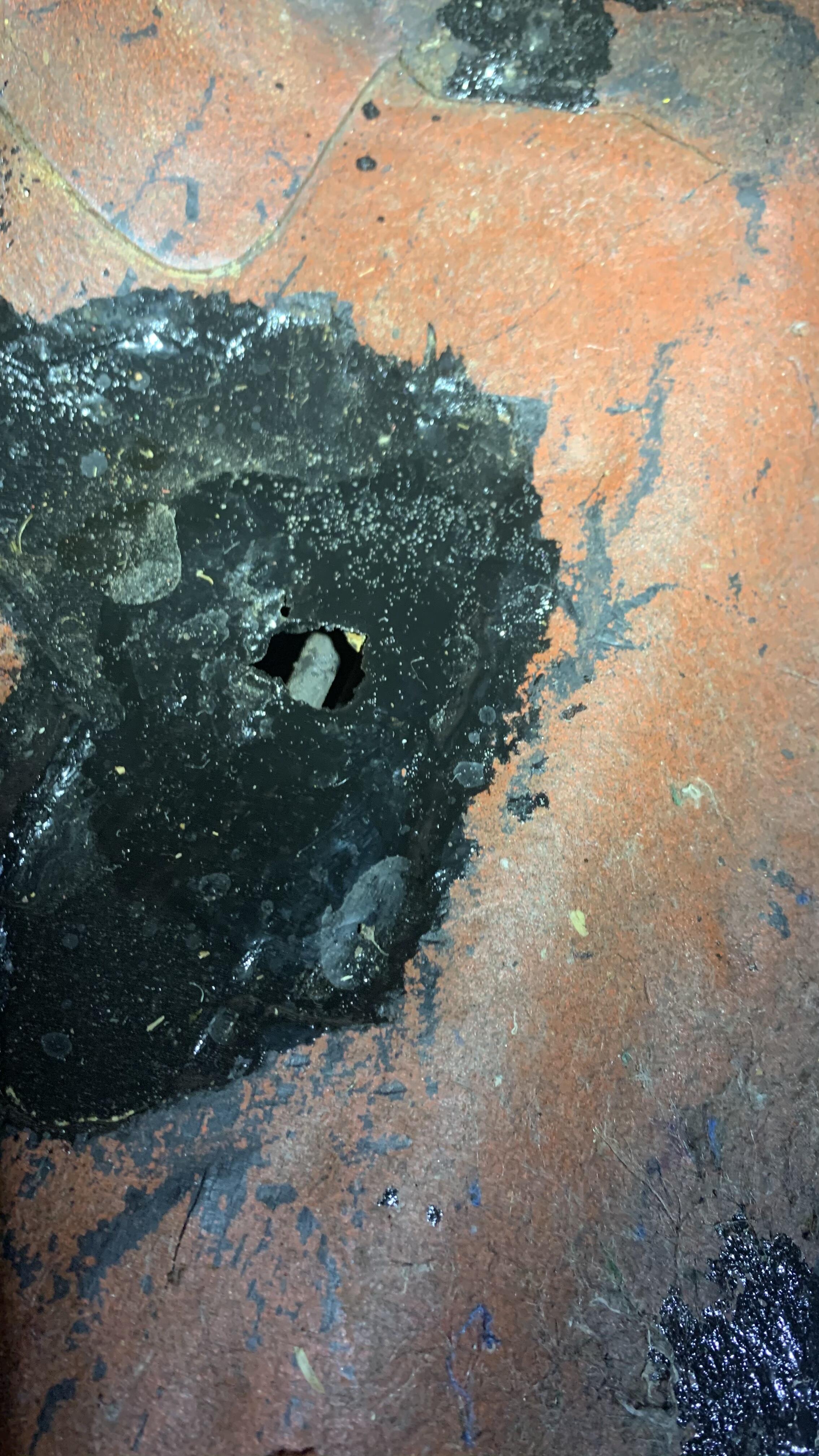

Yesterday I began to tackle the interior.  This car doesn’t have any rust issues I’ve discovered except for the passenger floor board.   The floor board has 5 small areas where there are holes.  I’ll post pics below.   I really can’t tackle the interior until I get over this speed bump so I wanted to get advice from guys on here that have done rust repair.   I have 3 possible ways forward the way I see it.  A few things I need to share is that other than these holes, I can’t find any more rust and the floor is solid otherwise. I chipped away the sound proofing until I found clean metal around each hole.  I did this a few months ago and put some POR-15 down to arrest any further rusting until I could get to this.  Posting pics pre and post POR-15 so you can have a better view of how they looked.
1. pay the guy that welded my exhaust pipe to weld in the patches.  Larges patch would be 3”x4”. He can do it Friday but hasn’t seen the job in person.
2. buy a welder and learn how to weld and do it myself.  (Learn a new skill)
3. Buy a full passenger side floor board and have a body shop to the job.
Since these aren’t flat areas, not sure how that is done and one areaI think you can see fuel lines below the hole.

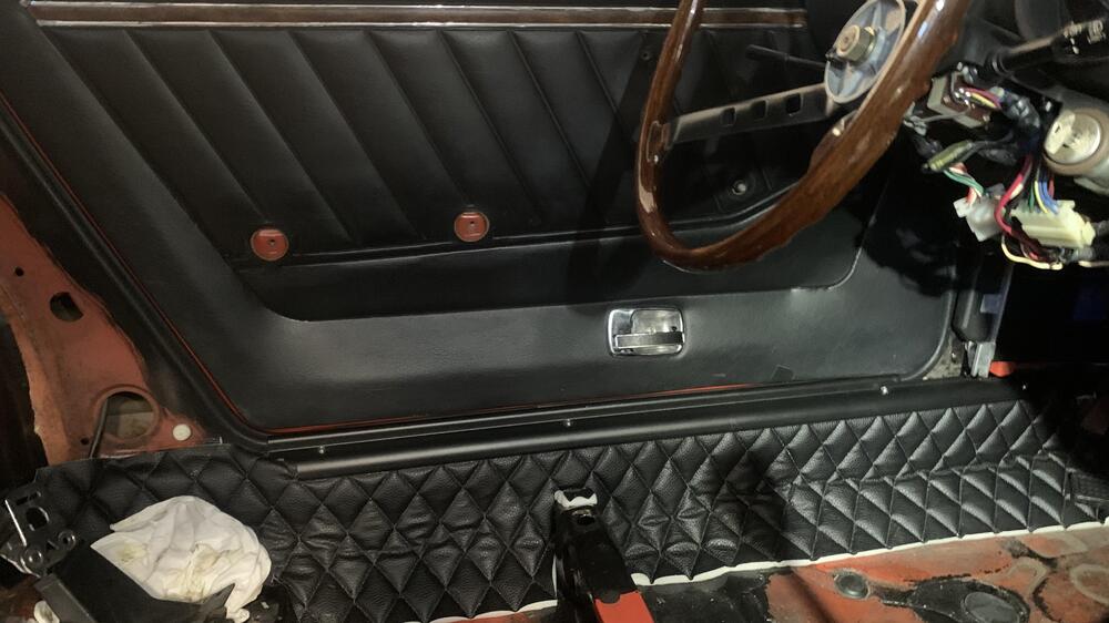

Take a look. Also have a pic of the vinyl I’m putting in.  I did the driver’s interior rocker yesterday.
Love that diamond vinyl!  Looks great!   Where did you find that?
Your floor does not look too bad.  Seen much worse.  I think you will be ok with welding in new metal patches.  Just make certain to get all the rust.
Thanks Jim,  I agree on the patch work,   Just don’t want a hack job.  It doesn’t need to be pretty but in need to be done right.  That fuel line scares me.   I’ve always wanted to learn to weld and have 2x 220v 30 amp plugs in my garage,  I’ll sleep on it after more advice.
The diamond stitch vinyl I picked up on Amazon.  Quality it’s pretty good, and it’s not expensive either.   I’m going to build a template out of a thin cheap U-haul moving blanket (not those heavy moving blankets)  I have laying around,  it the perfect material for a template and it cuts really easy.  Once I’m done I’m happy to share the template with people on here.  Here the link to the vinyl.

I would probably patch those.
No need for a full floor.
I would advise you to just get your exhaust welder to weld it up. You could possibly bend up the patches for him to save some time
Lower the line under floor down and throw a wet rag over it.
