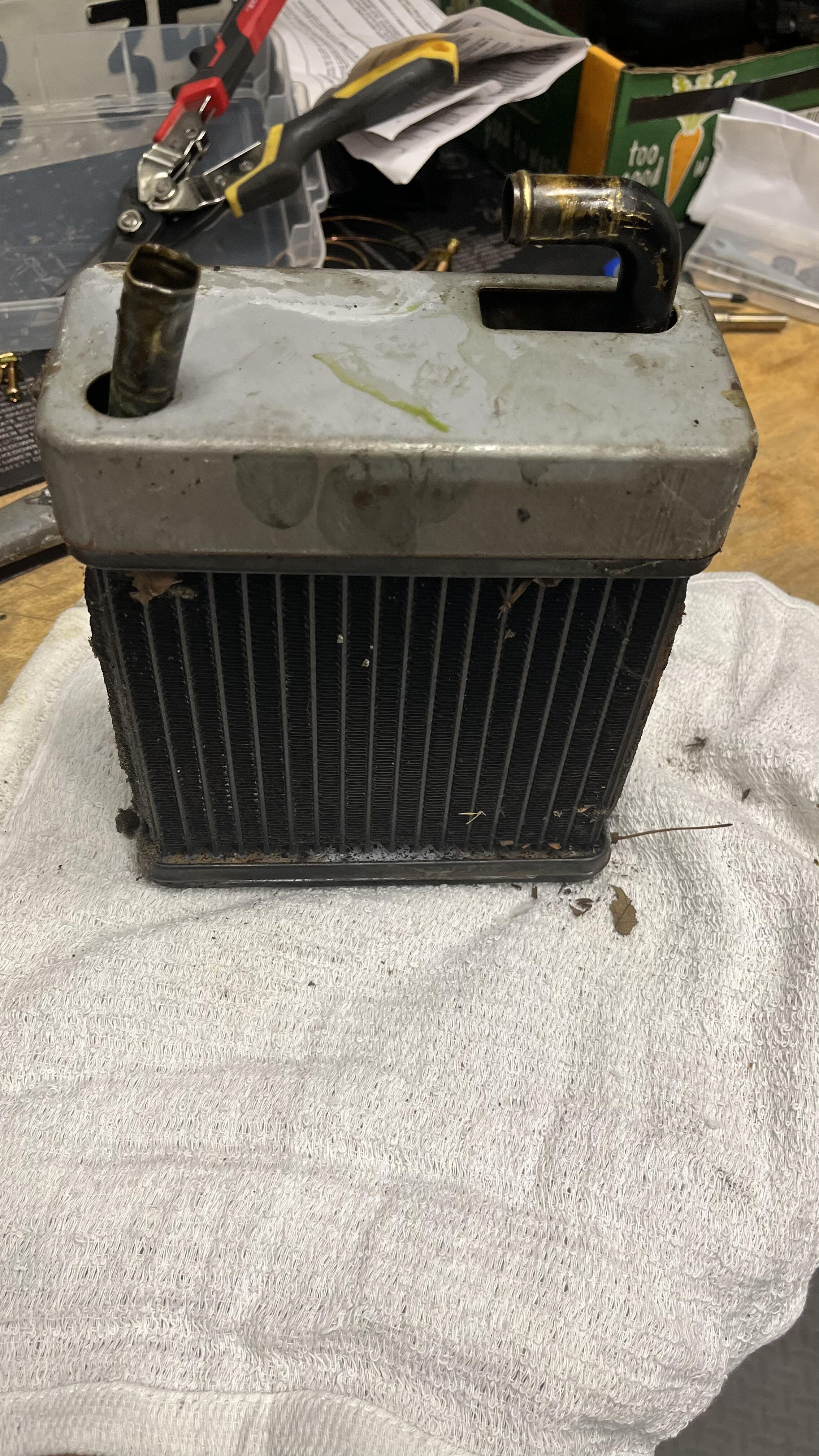

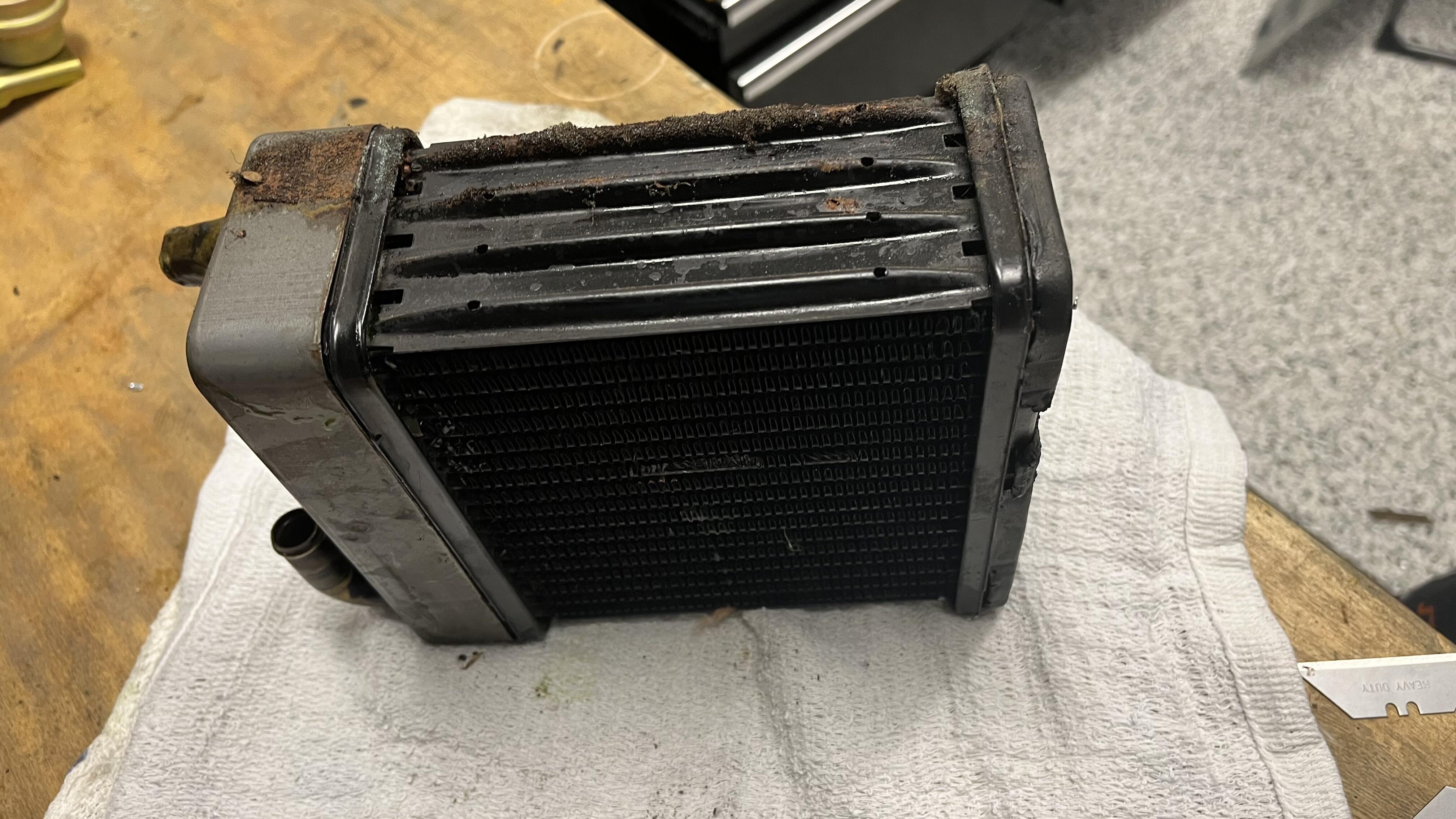

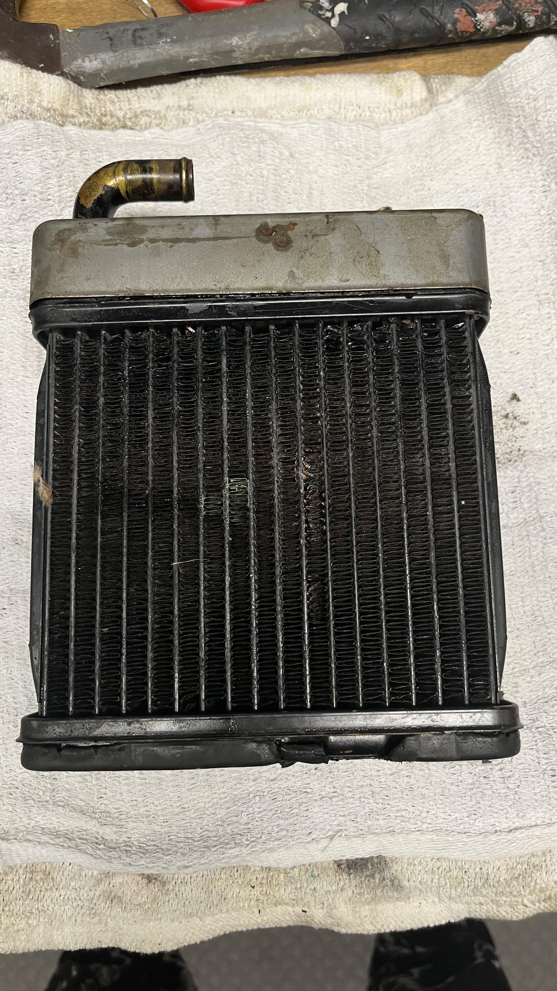

Here are some pics of my heater core.  I’ve email two companies that rebuild them  and sent them pictures to get a quote,  the heater control valve is another story,  anyone know what this copper wire that attached to it?   I’m guess it’s some sort of sensor to send to the valve to open and close and it looks difficult to remove.  What happens if just remove the valance all together, does that mean you get either full hot or no heat?   I’m not sure if my valve is functioning, repairable or just trash?  It looks pretty rough.
Couple pieces of input.
The metal end-cap on the heater core where the inlet and outlet tubes are attached should just pull off. If you're going to send the core out, don't send that end cap. It's just one more piece to get misplaced along the way.
And as for the tube coming out of the valve... Yes, that's an automatic temperature compensation feature that is supposed to regulate the temperature of the heater core. There's supposed to be compressed gas inside that capillary tube (freon maybe? Nitrogen maybe?) that expands and contracts with the temperature and opens/closes the valve accordingly.
But, that said... None of that probably works anymore. The gas has probably leaked out, and the valve has probably either frozen up solid inside, or the seal inside has turned to dust and dissolved into the coolant over the years. In any event, I would be very surprised if that valve is any good at all.

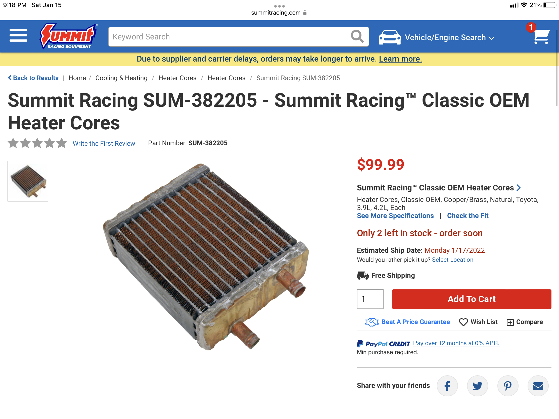

So here is some good news….the dimensions of the 280z heater core is 7”x 6.75”x 3”.  There is ones for cars that are almost the same size, most are 2” thick.   I found several and price ranges between $40 and $120 depending on brand and copper vs aluminum.  Like Captain Obvious did, you’d have to make a 1” shelf for the core to sit on or it would  be banging around in there on the Pot holes all over Philly 😂.

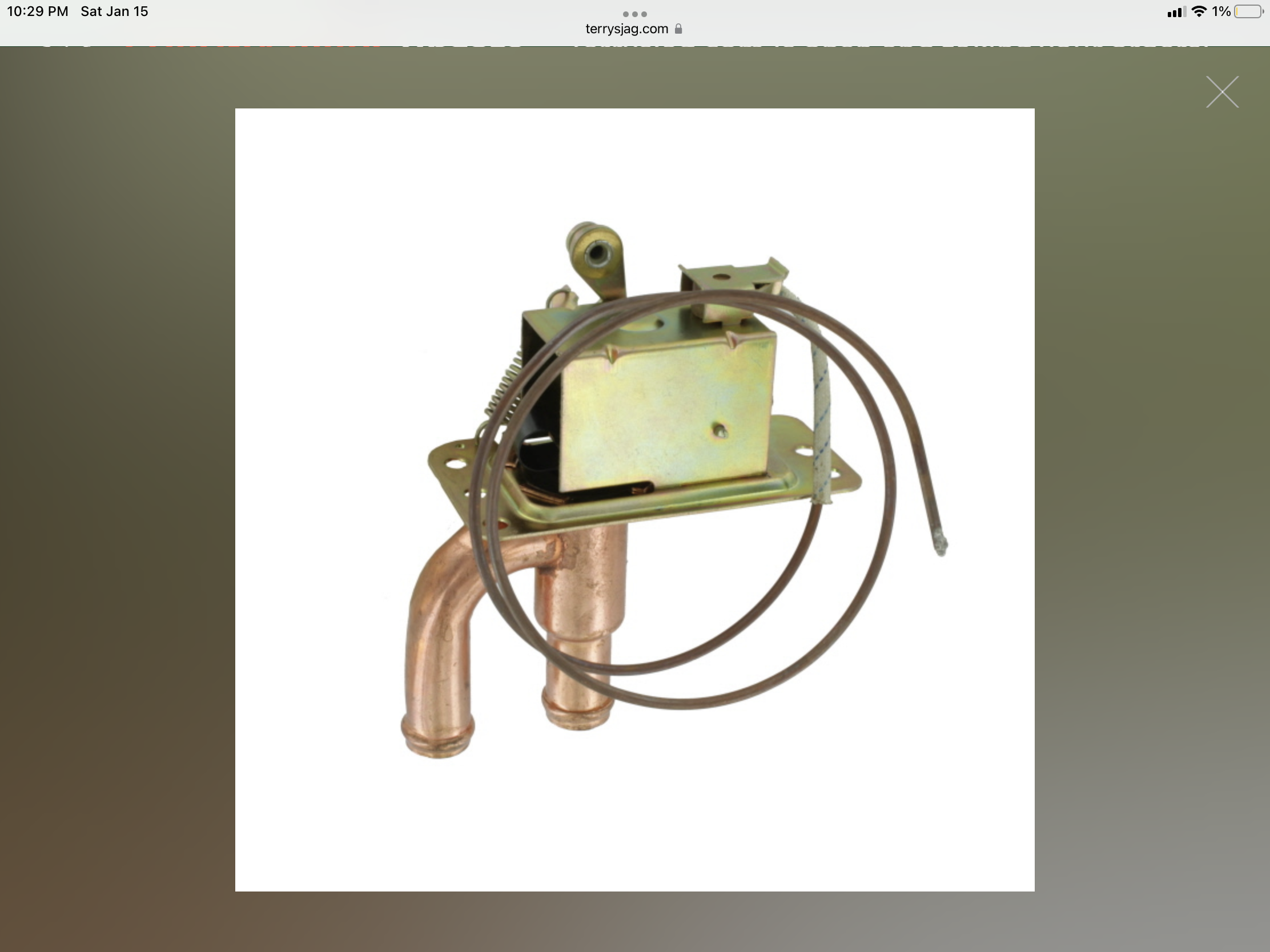

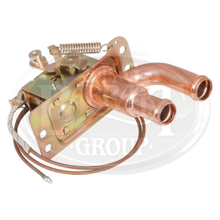

Now the heater control valve.  I think I found a possible candidate for replacement with the temp control feature as in the later 280z ( ones with copper wires). A 1971-1974 Jaguar Hester control is almost identical except the spring Cntrl is on the opposite side.  See pics below.  I’d like someone who is more familiar look at the photo of the Jaguar one and see what you think about compatibility. The vacuum section looks similar too for the other half but the mount I’d on the wrong side.  It looks like Nissan may have copied the Jaguar one or vise versa.   Also the Jaguars ones are available from several retailers.
Thoughts?

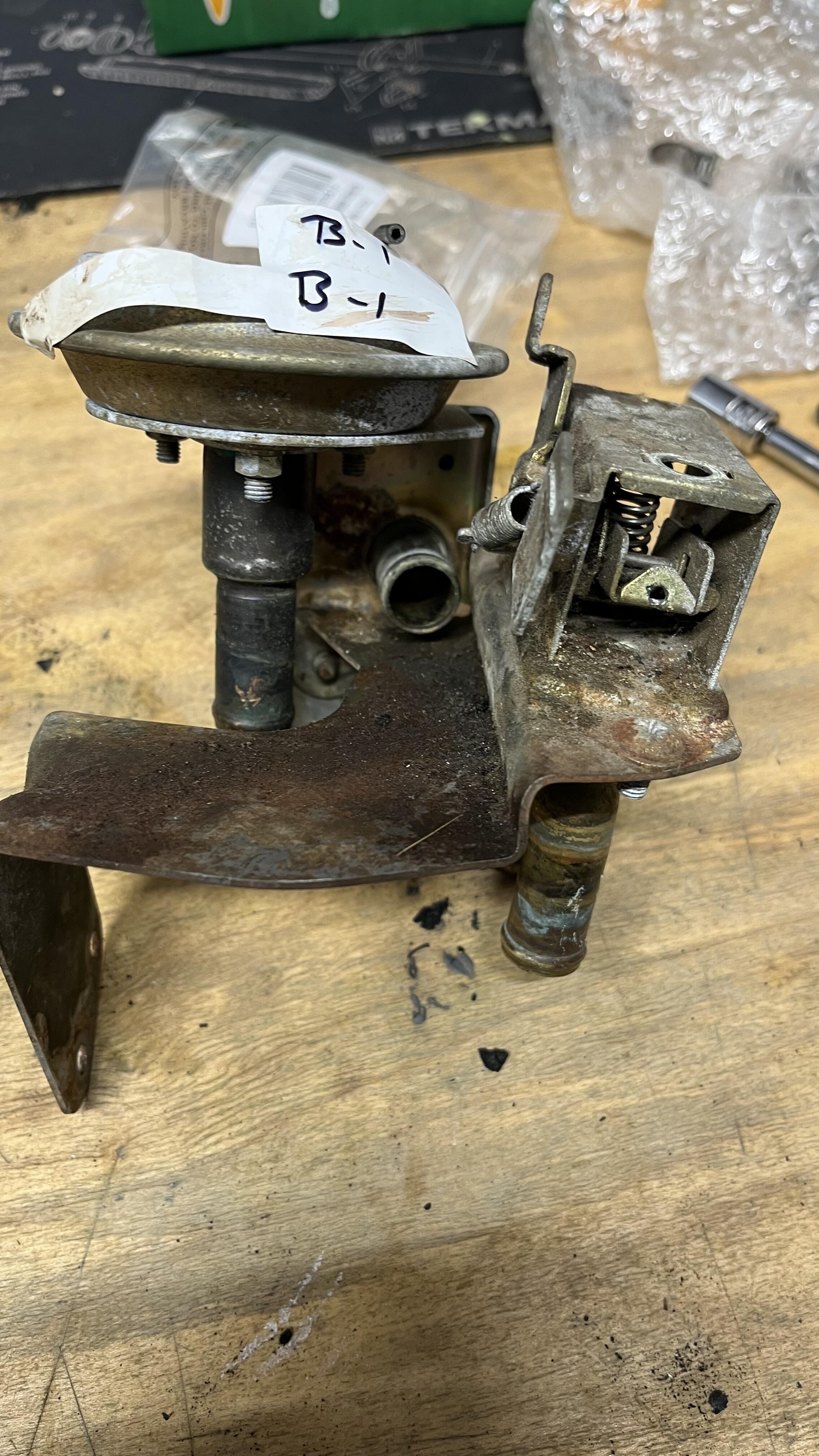

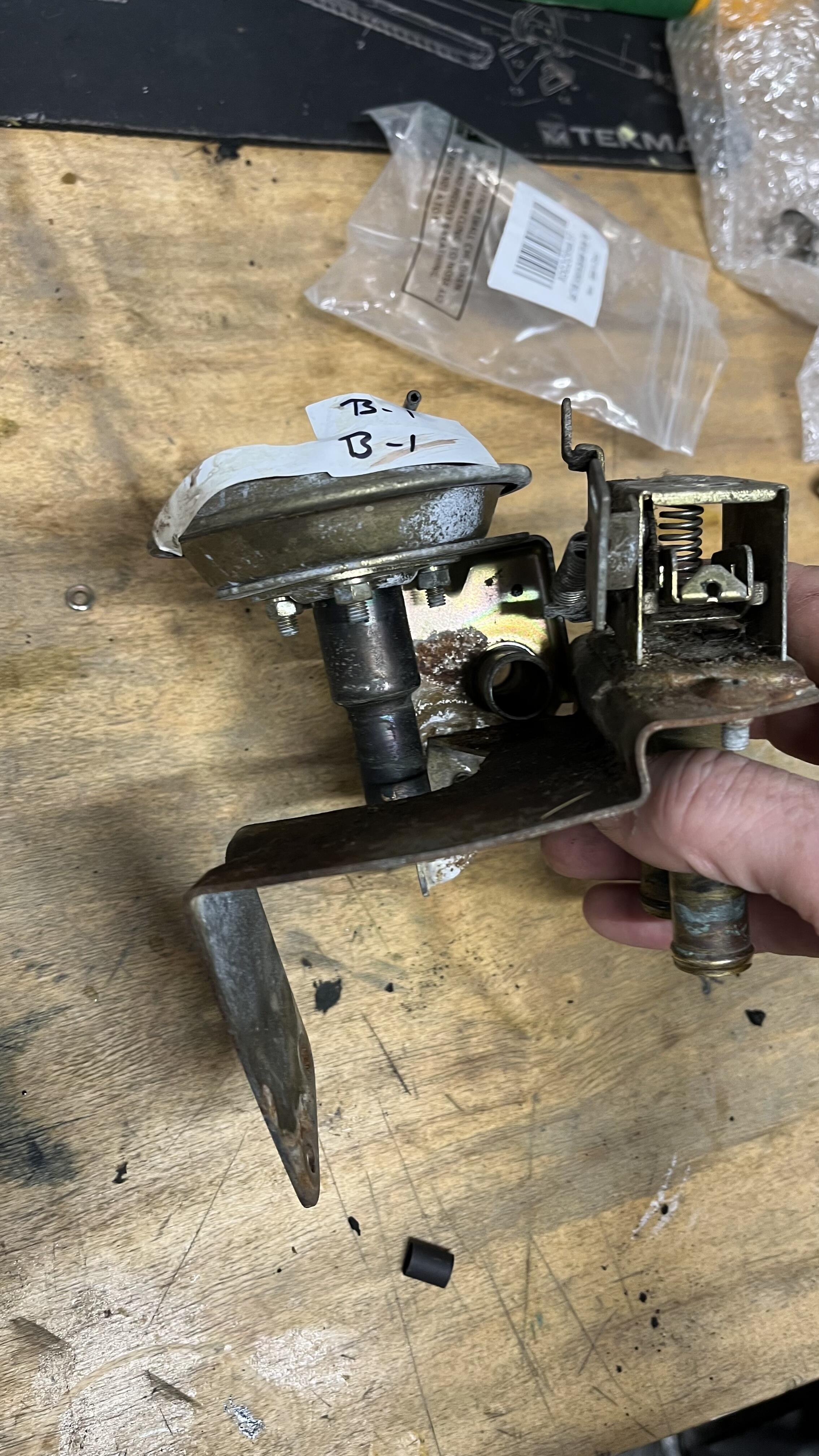

Persistence once again prevails.  I’ve been searching for a heater valve replacement and it not been going well.  My style valve is no longer obtainable and alternates have fitment concerns.   But I found a guy in WI that rebuilds them.  I’m sending him both the vacuum AC valve and heater valve where is will inspect and recondition.  Price is reasonable considering the cost of replacements.  $100 plus shipping and he has a 24 hr turnaround time.
Here’s what mine look like right now.
