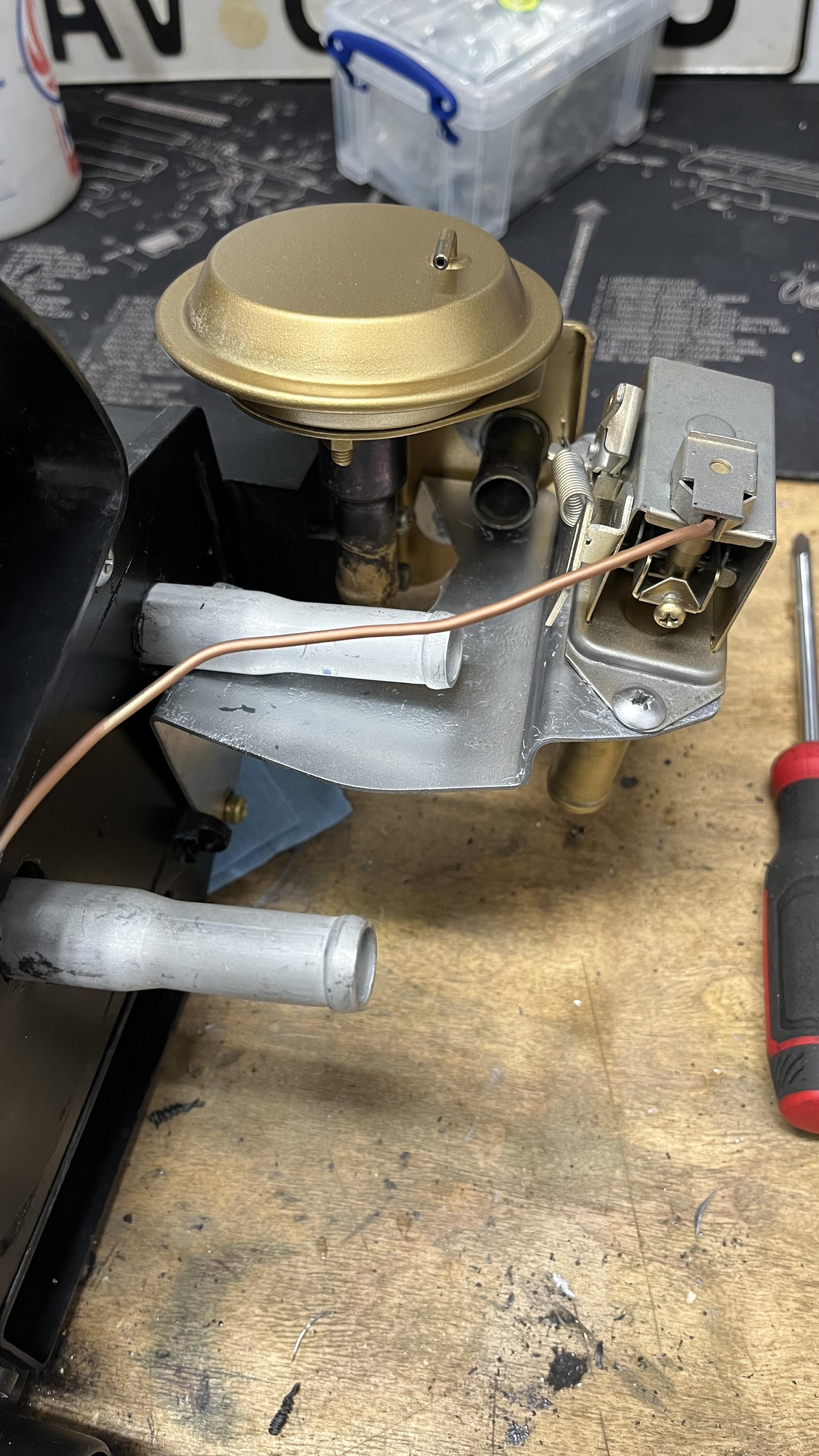

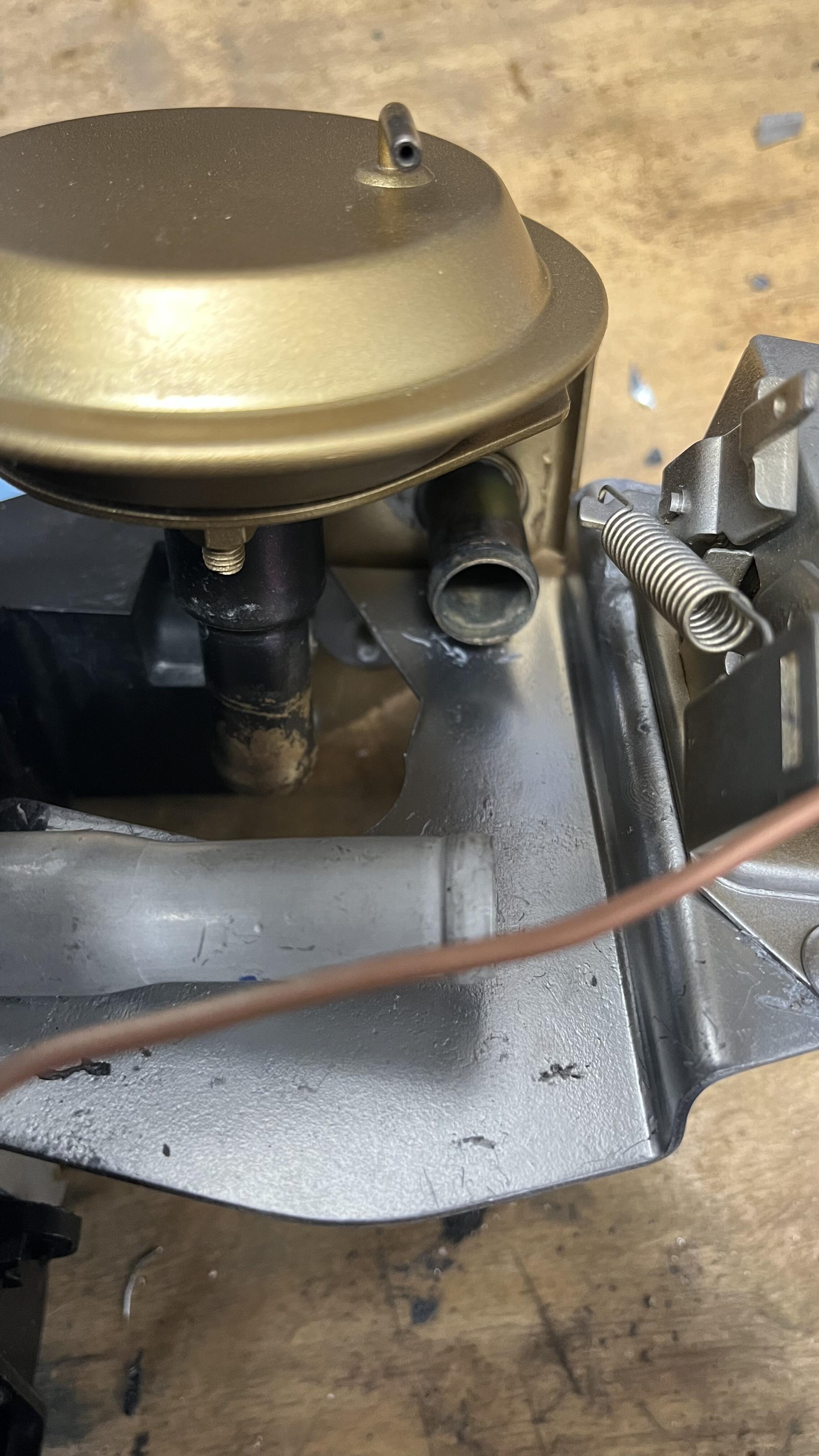

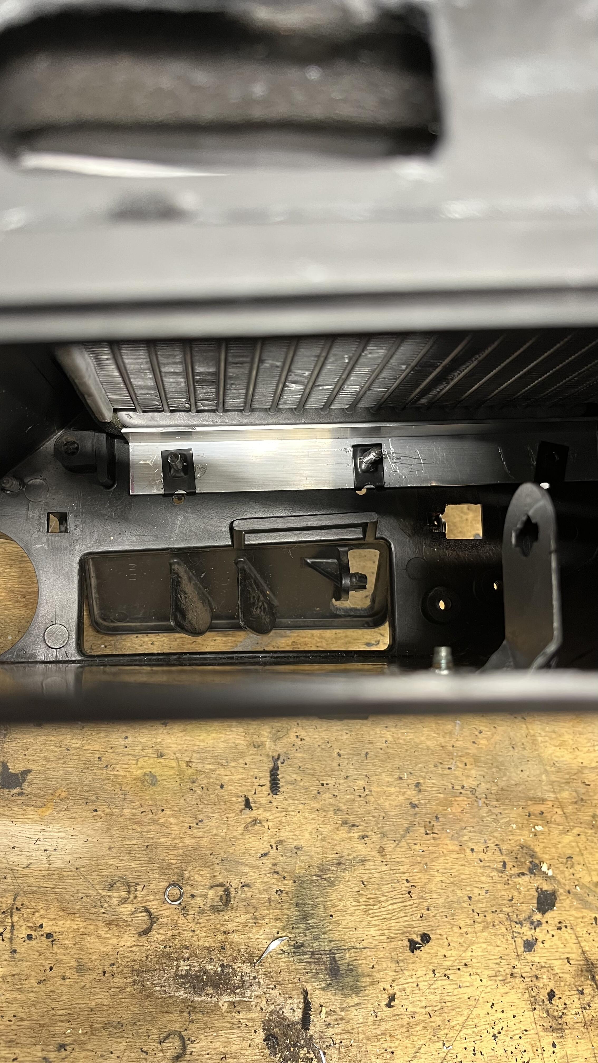

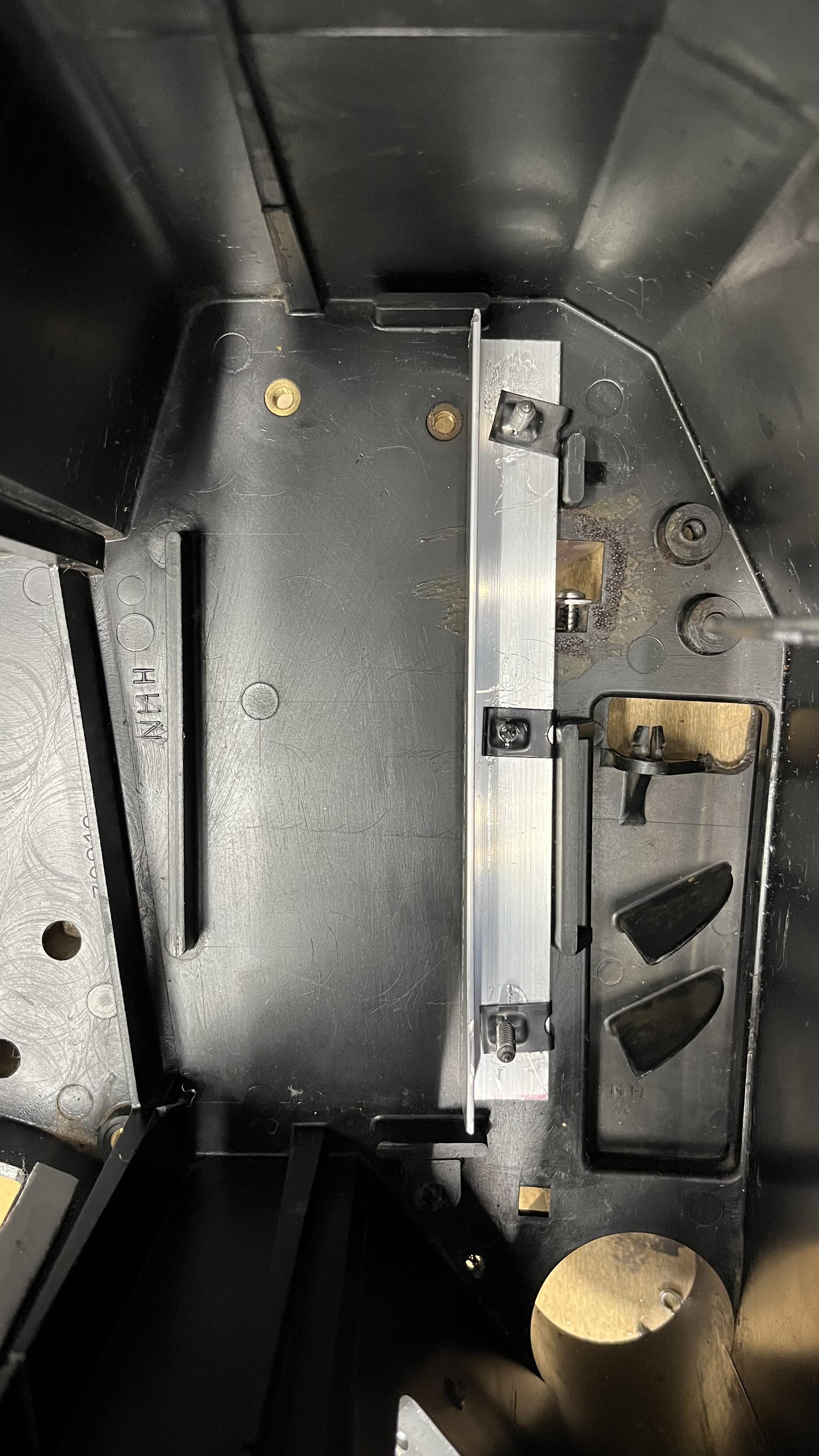

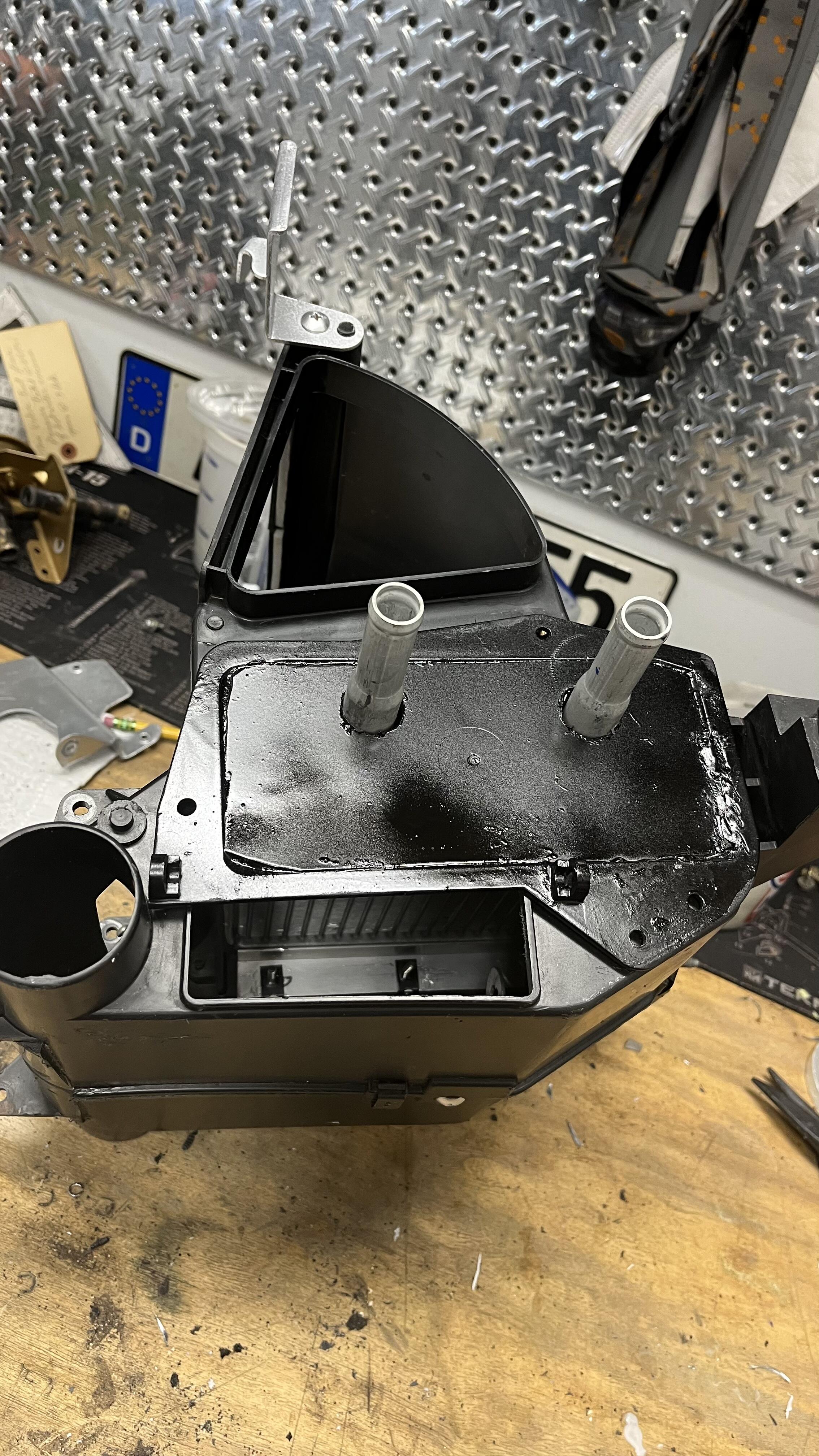

Made some progress on the heater core box mod to accommodate the Spectre aftermarket core.  Followed Captain Obvious’ write up on this. In the pics you can see the aluminum shelf I had to install to fit the thinner heat core.     Hopefully will have this all back in shortly so I can start the work on my new Vintage Dash swap out.

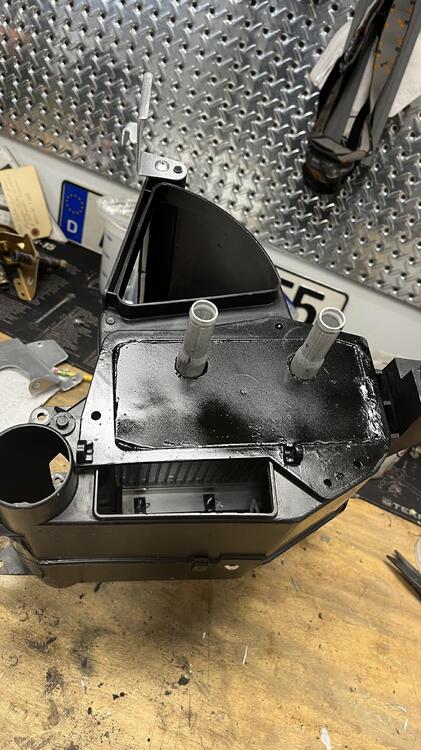

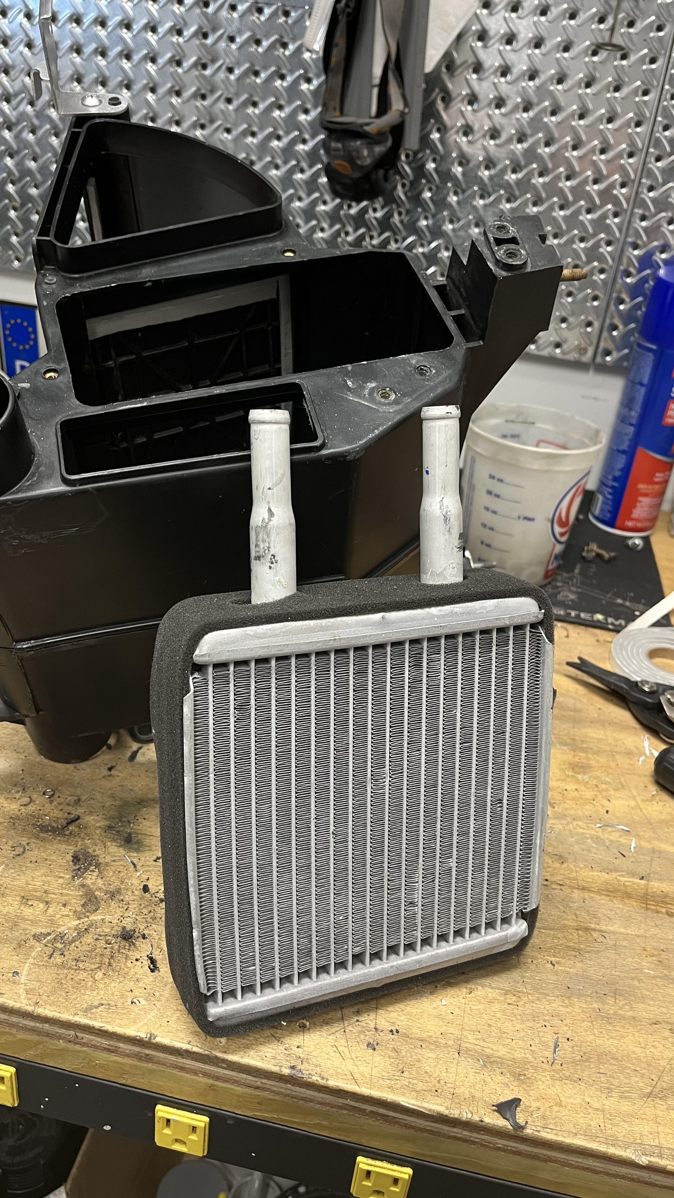

Here are pics of the heater box and the mods.  Once I get the valve bracket and valves attached I will take it to the auto parts store to find hoses that will work.  Stock hose won’t work now because of where these new core pipes enter and exit at different locations than stock.
Question: I’m making an assumption that it doesn’t matter which pipe is and “in” and which is the “out” on the Spectre Heater Core.  It made no mention of this the the supposed paperwork.  Anyone know?

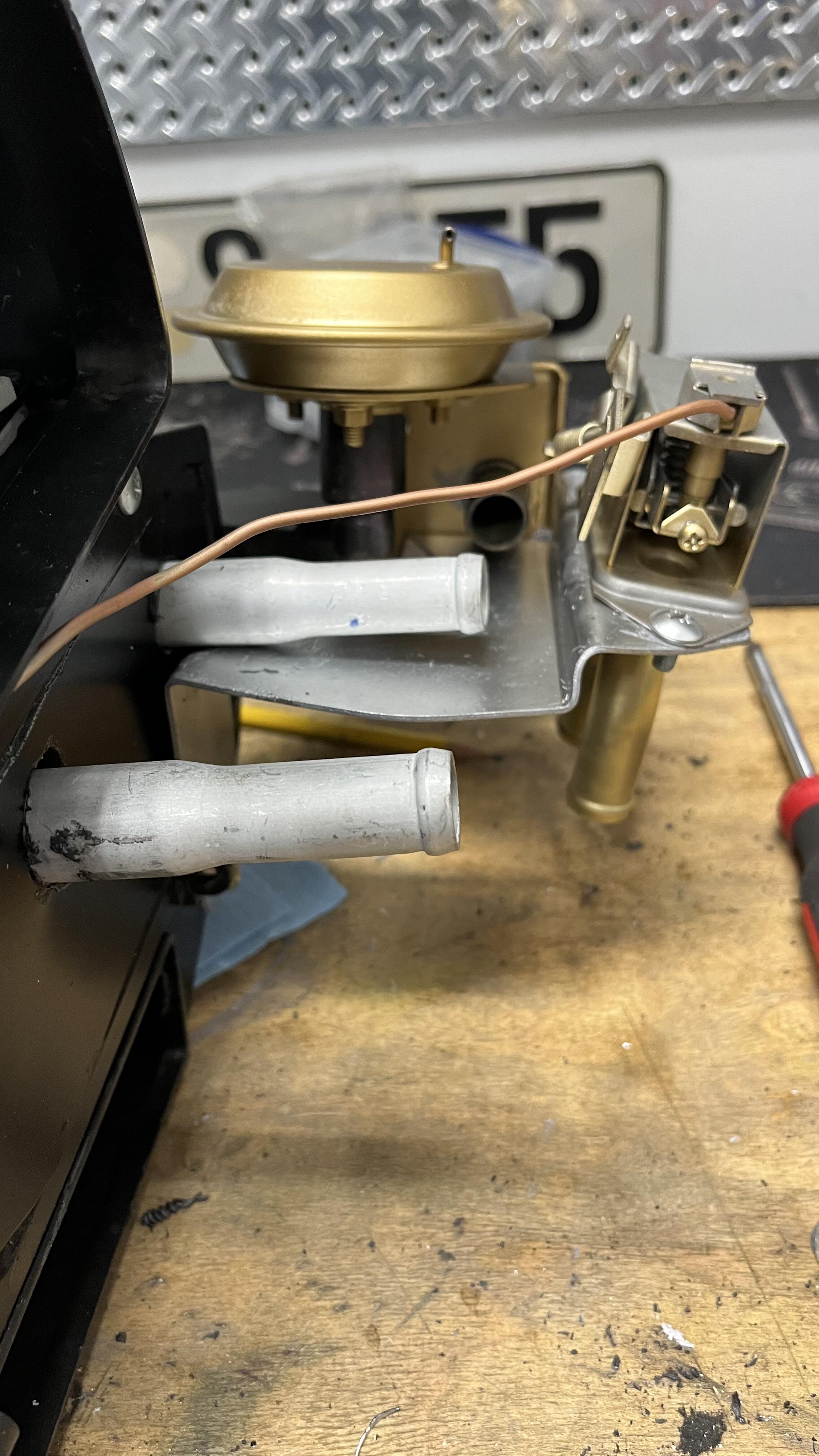

I got the heater box all back together but ran into another problem.  The heater core pipes are too long and will cause a kink in the line without cutting it down.  I don’t have a pipe flare kit and with a flared end on the pipe I’m probably inviting a leak.
Ylu can see in the pics what I’m working with .

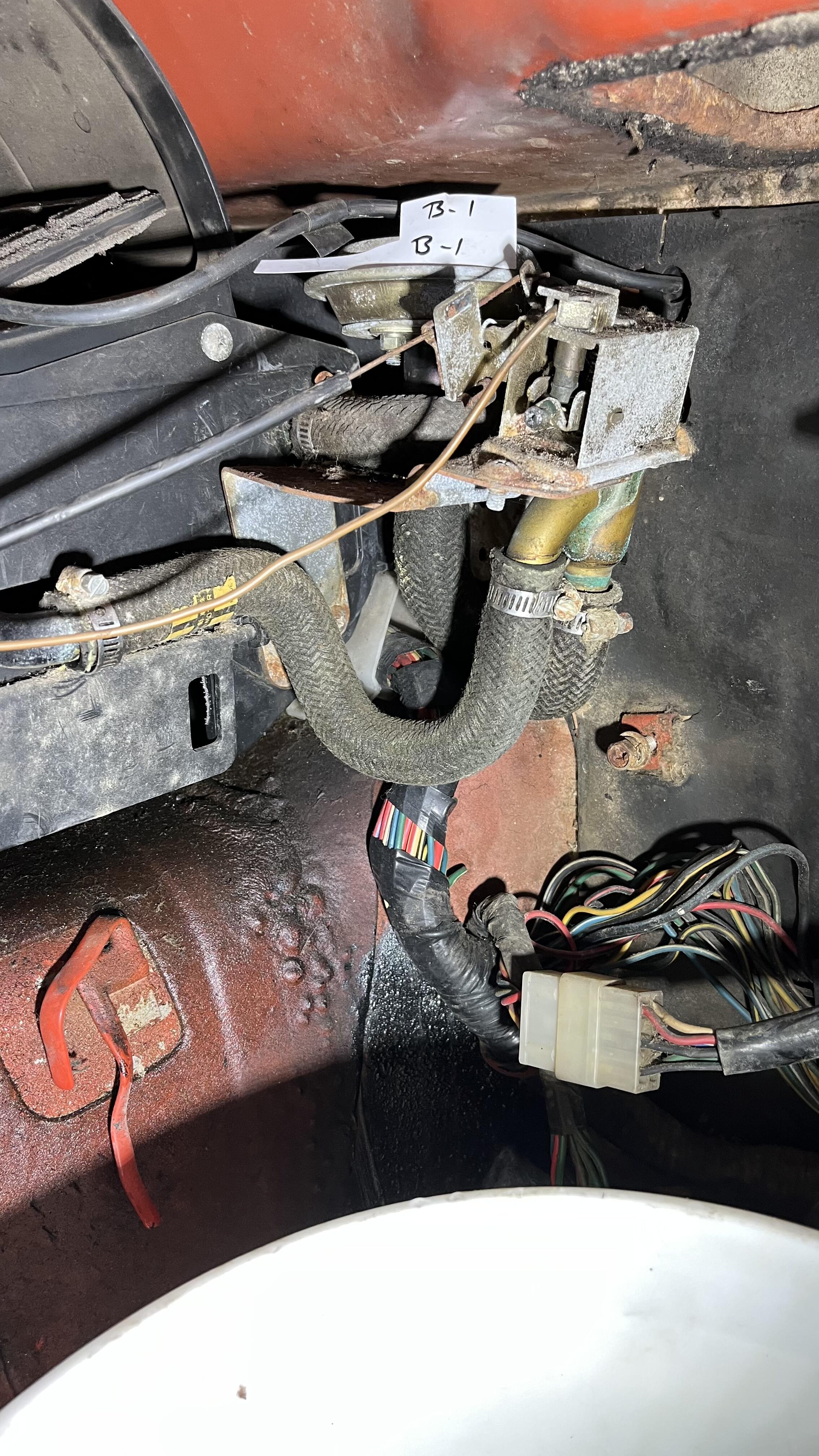

I also put a pic of the stock set up before removing everything.  You can see the pipe on the core closest to the firewall is a 90 deg bend immediately after leaving the heater box.  My pipe on the new core is ~3” longer so the bend is now a problem.

Could you find a molder 90 bend and snug it on to the core deep enough to fit? I imagine you can gain a couple mm of clearance by sticking the core “into” the bend rather than leaving it in the straight portion. It may inhibit flow a little but I don’t see it being a huge deal? In lieu of a flare tool, do you have access to soldering equipment like used for plumbing? Last thought would be something like a PETG fitting. I know they are used in computer for water cooling and no flares are needed, allowing you to trim down your pipe as needed
What is the overall curved length from the end of the valve to the core tubing and what does the ID of the hose need to be?
I've got an impressive bunch of original braided rubber hoses here at home with all sorts of molded curved sections to them.
Might be we can match up a length and ID from a section of one of them.

So, I was fortunate that a member on here was kind enough to cut and use a special tool to flare the pipe end so now I’ll have a easy 90 deg turn.   It was the best solution but I just didn’t have to tools to do it.  Great to have awesome people come to your rescue.
