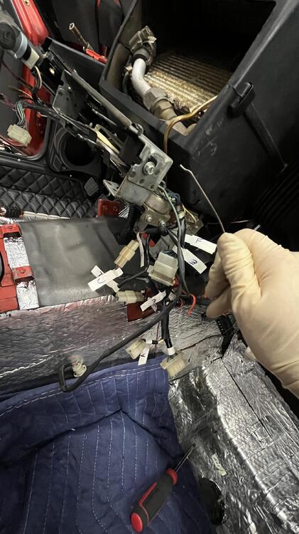

February 28, 20223 yr Author comment_636577 Getting close to getting everything reattached so I can re-install the new dash. When putting the heat box back in I has to push the heater controller back and while doing that the cable the connects to the heater control valve pooped off the end on the control panel. Now if can’t figure out where it attaches. My assumption is it would connect tot the temp lever but I don’t see a connect point. See pic below. In the pic I’m holding the cable. The other end is connected to the heater control valve. This has all be en apart about 6+ weeks so I can’t recall every connection. I also see a cable connection to the right side of the blower motor. This must be the fresh vs recirculate switch. I don’t even have this cable so I’ll need to find or make one. Edited February 28, 20223 yr by Av8ferg Link to comment https://www.classiczcars.com/forums/topic/65616-putting-in-a-replacement-l-28/?&page=42#findComment-636577 Share on other sites More sharing options...

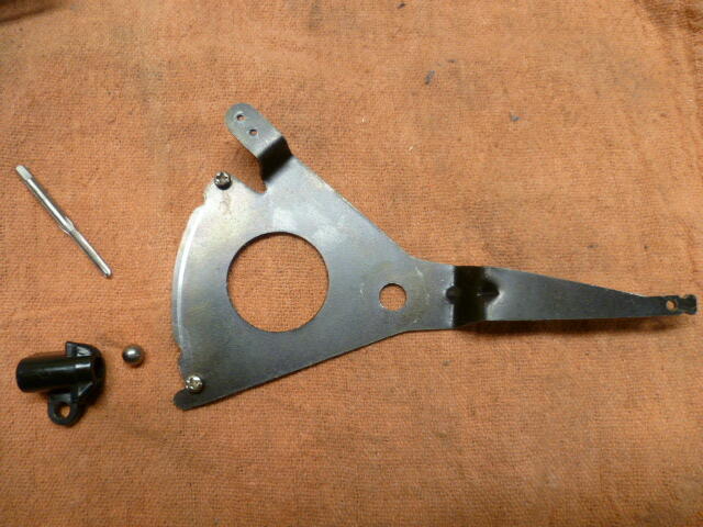

February 28, 20223 yr comment_636585 On 2/28/2022 at 8:26 PM, Av8ferg said: the cable pooped off the end. Now if can’t figure out where it attaches. Man I hate when that happens. So here's a pic of the temp control lever. It's on the underside (the radio side) of the assembly. That might be why you can't find it. I don't have a good pic of it in-situ, but here's the lever solo. The cable connection point is one of the small holes at the top in the pic: And here's a pic of the whole airbox assy. The temp cable is the one that comes out at the 6:00 position. The jacket is supposed to be held in place by one of those ubiquitous cable clamp thingies: Link to comment https://www.classiczcars.com/forums/topic/65616-putting-in-a-replacement-l-28/?&page=42#findComment-636585 Share on other sites More sharing options...
