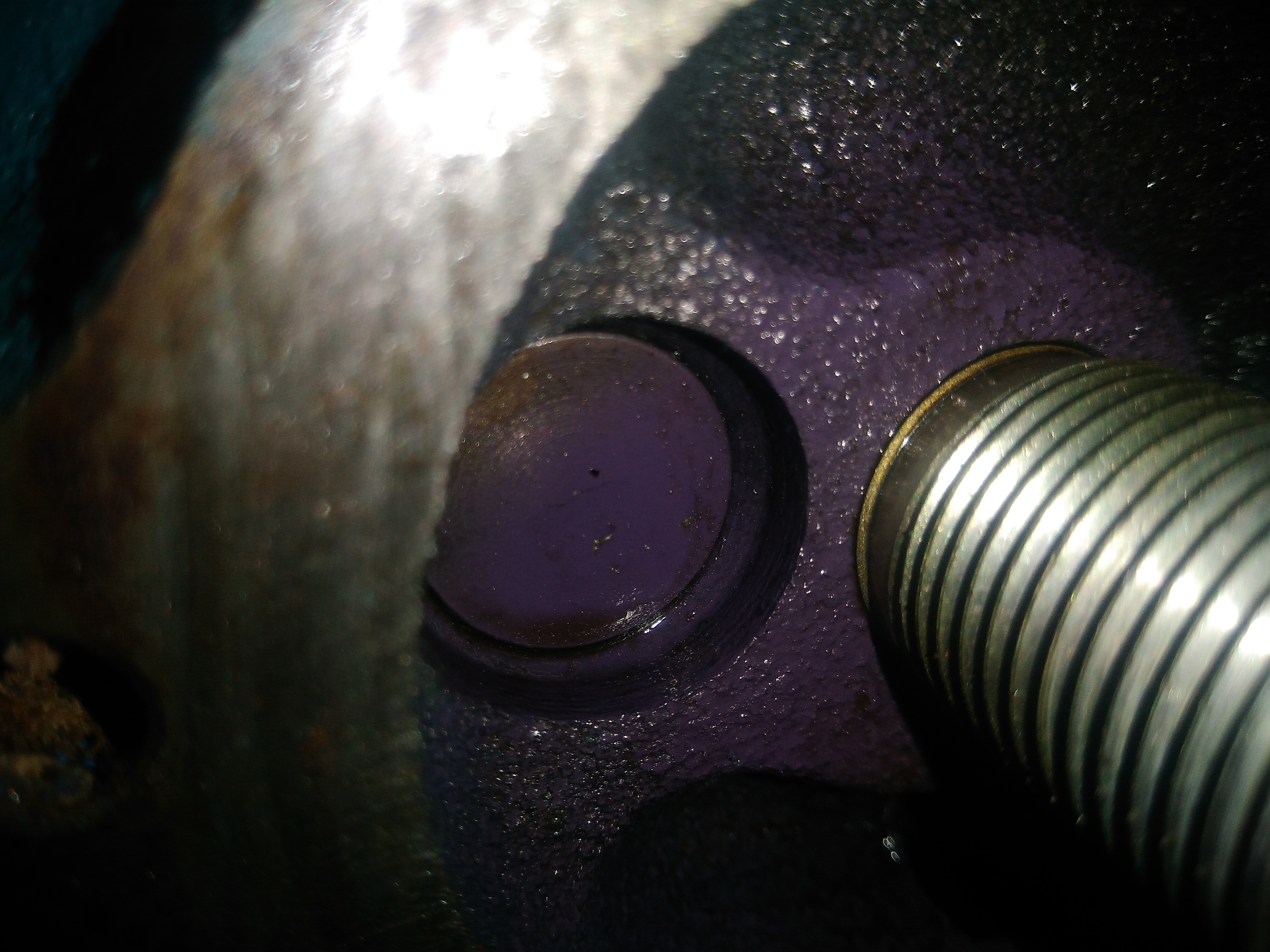

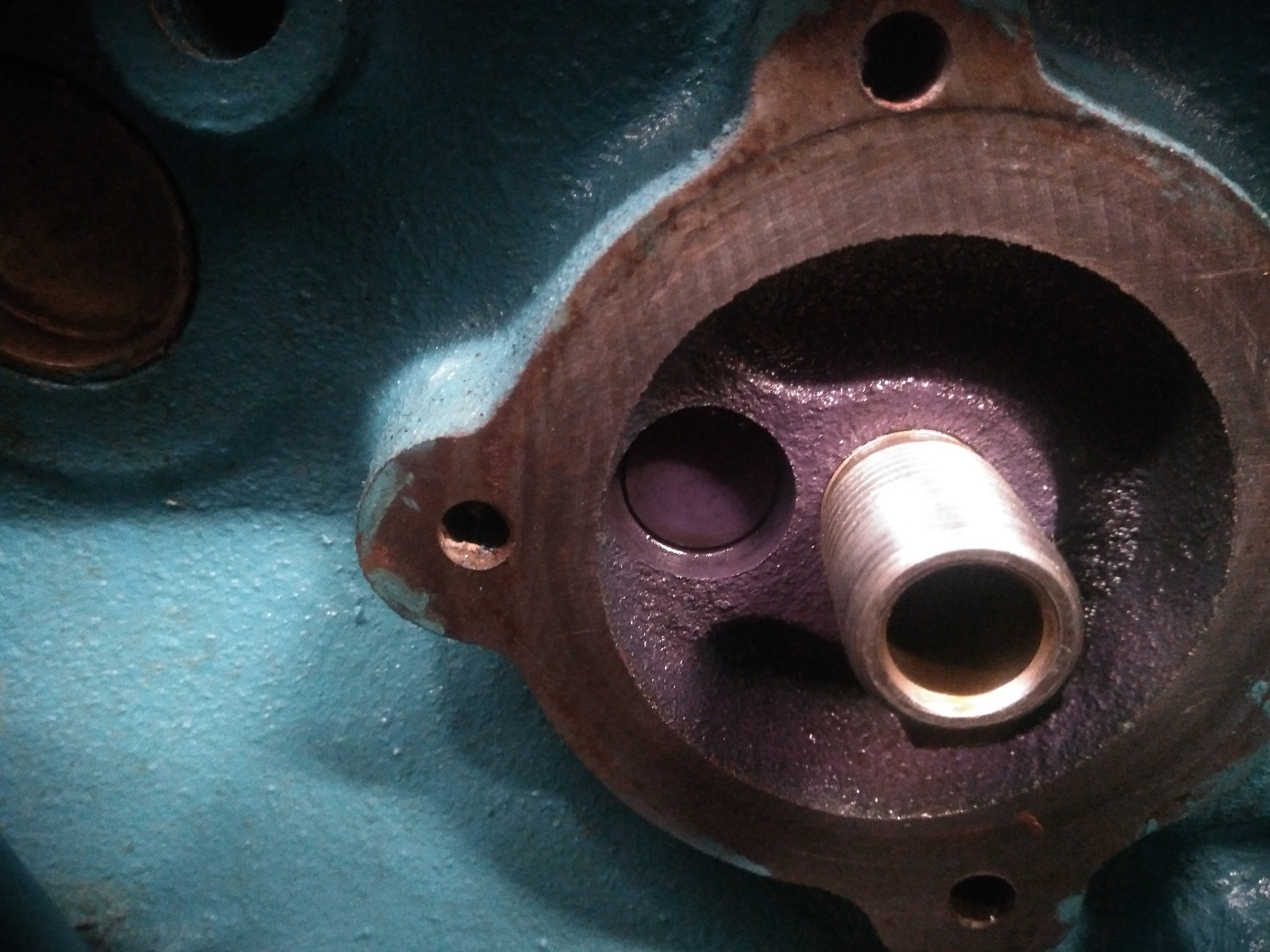

When I recently built up the new motor which now has 300 miles and running well. I somehow missed the plug in the oil filter boss which normally has the spring loaded bypass valve.   I changed the breakin oil / filter the other day and noticed it.  I must be getting older....    I know it is important should the flow become blocked thru the filter to not let the motor starve for oil.
My question is, can I safely drill out what appears to be a plug,then pull it out with something, mabe use a magnet and vacuum to not let any metal chips get ingested and replace it with a new bypass valve?   Its a F54 block that was originally set up for a turbo if that makes any difference.
Also, my oil pressure seems high compared to my original motor. 40 psi at idle and goes up to 85 psi while driving, varies with engine rpm of course.  I think this is normal for a new motor and the bypass valve missing should have nothing to do with it.   Turbo oil pump is installed as well.
Please ignore the purple paint.... lol

Pretty much all of the new filters these days include a bypass valve built into them. You might not need that bypass in the block at all?
3 hours ago, Av8ferg said:
My quick Google search supports Bruce’s comment....let her go! Wish I were coming too. I promise my car will be ready next ZCON
Alright, two concurring votes of confidence is good enough for me!!   I'll leave it alone and go with it.
Thanks guys!
What filter are you running? I'll see if I can dig up details on the internals.
And by the way... In theory, the filter bypass only ever comes into play if you let the filter get so dirty that it clogs up the filter media. I know you're going to be changing your oil on your nice new motor way frequently enough that's not going to be an issue.
I was led to believe that the filter would bypass at around 7 to 15psig (0.5 to 1.0BarG). If the differential pressure reaches 7 to 15psi the bypass will open accordingly. It is just a spring valve and not a calibrated releif valve.
It is not uncommon for a percentage of the oil to bypaas the filter depending on viscousity, oil temperature, pumped volume and degree of clogging in the filter. The oil pressure (85psi) you are reading doesn't say much about the bypass. A new engine can have higher pressure due to the finer tolerances creating more backpressure.
I think I would cut the filter open and check to see the filter I'm using does have the bypass function. Most do these days, but just to be sure.... If it does, then leave it at that and keep using that brand and type of filter.
