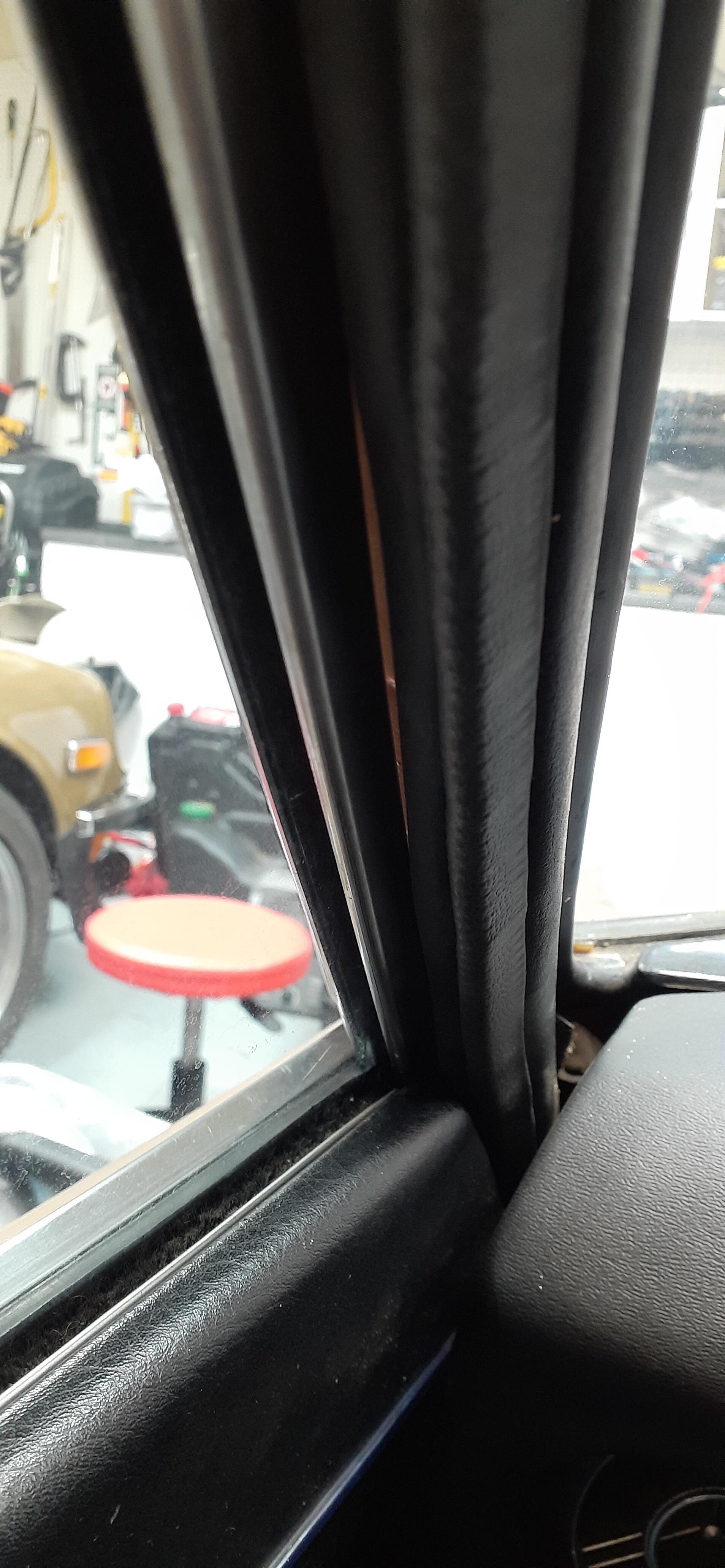

 I could see a long gap between the window frame and the door seal on the driver's side.
Can you snap a pic of this? I didn't get into details before, but I think I've got the same issue and I believe that's where the majority of my wind noise comes from.
If it weren't for the fact that the window fits fine, I would have guessed that my stainless frame was bent out of shape. But if that were the case, the window would bind or something (and mine doesn't).

I've spent WAY too much time on Amazon studying generic door seals for the 240Z. I even tried some with mixed results.
The first one I tried had a "bulb" of 3/8 of an inch (9.5mm). It left gaps, allowing wind noise. I took a chance and went big on the next try with a 0.7 inch bulb (17.8mm). The door would not close properly. Okay, so I figured the "mama bear" size would be about 0.5 inch (12.7mm). I got it today and installed it. It had a nice snug fit around the doorway. The door takes a fair amount of effort to close, but it will close completely. There are no gaps that I can find around the door, either.
Here's a link to this door seal on Amazon: https://www.amazon.com/dp/B097MPM512
 Now to get more for the passenger side.
By the way, you'll need about 11 feet of material to go all of the way around the door.
I received the other "mama bear" door seal today and got it installed on the passenger side. It's a little different from the driver's side, but you'd have to look close to notice. Here's a link to it: https://www.amazon.com/dp/B00NELWRJ4
Now I have to drive the car to see if it is better than the Kia Sportage seals on the 260Z. (I think it is.)
