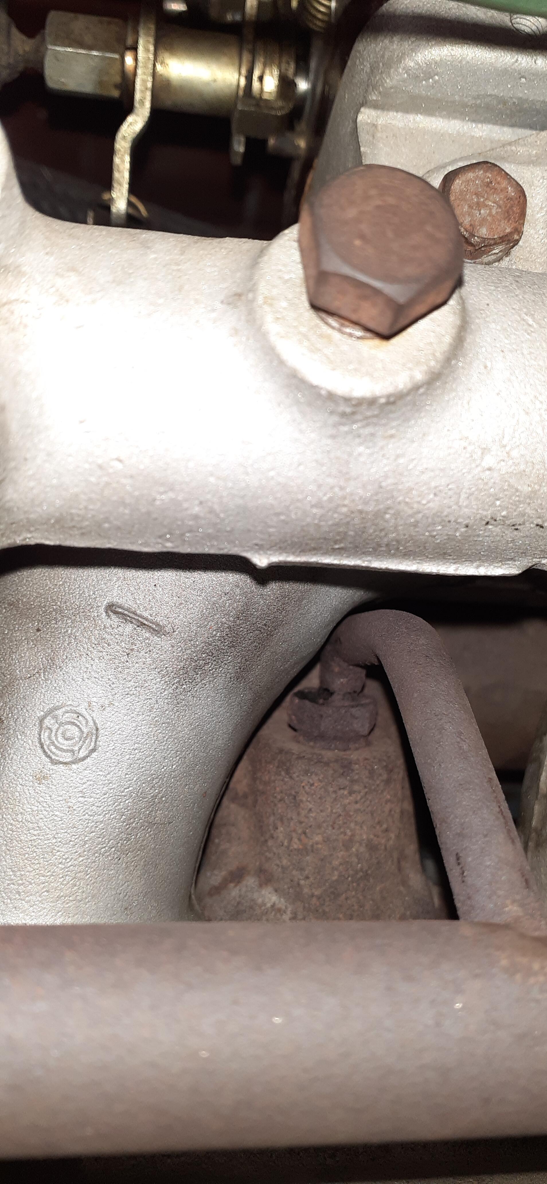

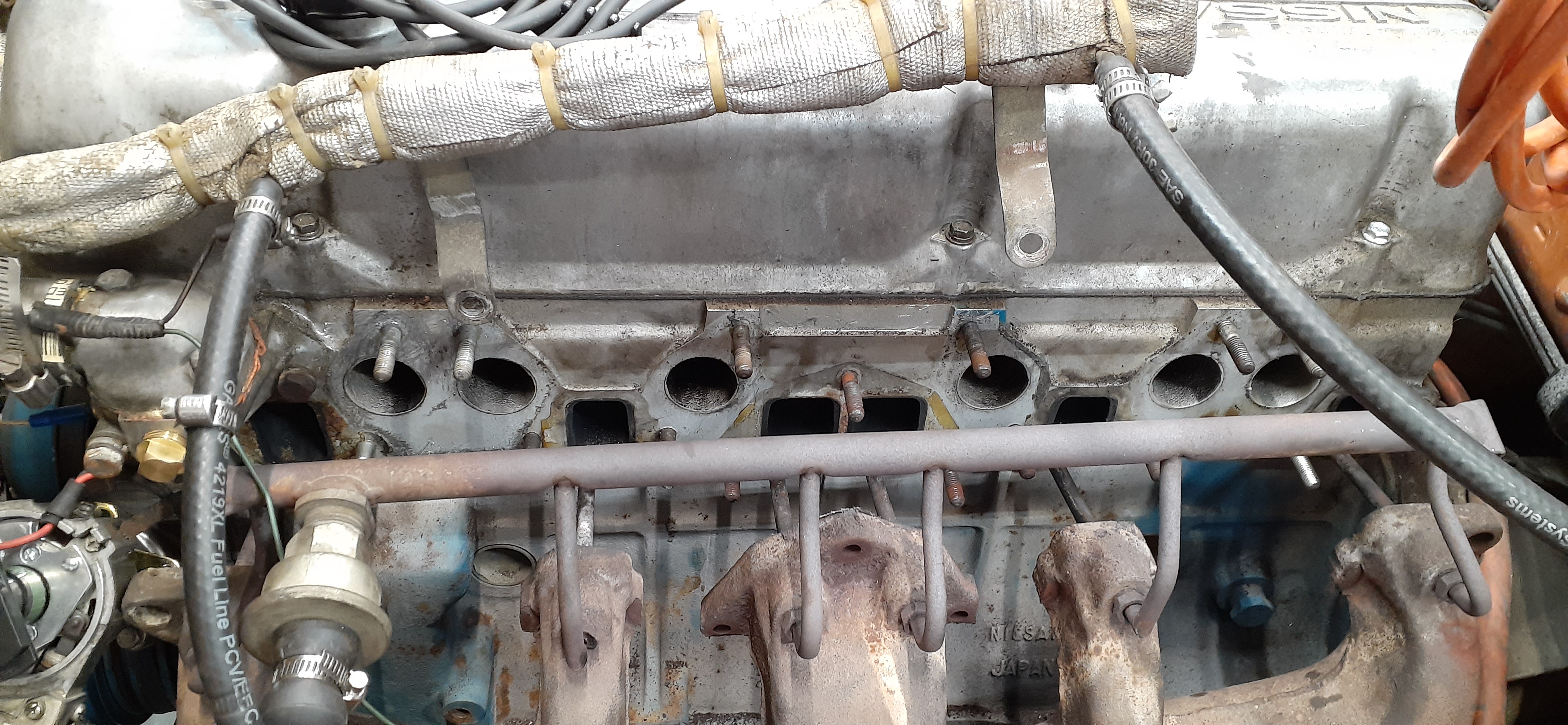

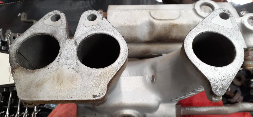

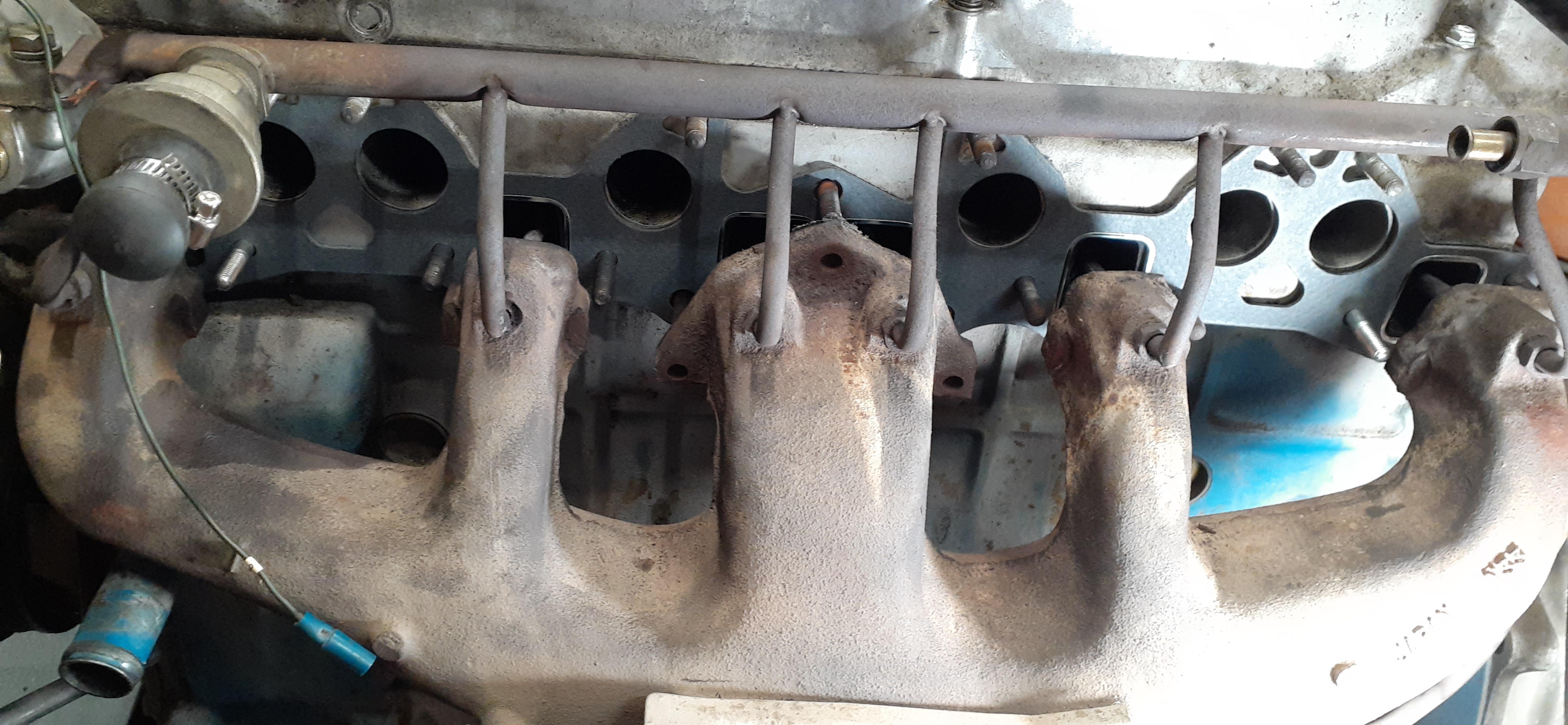

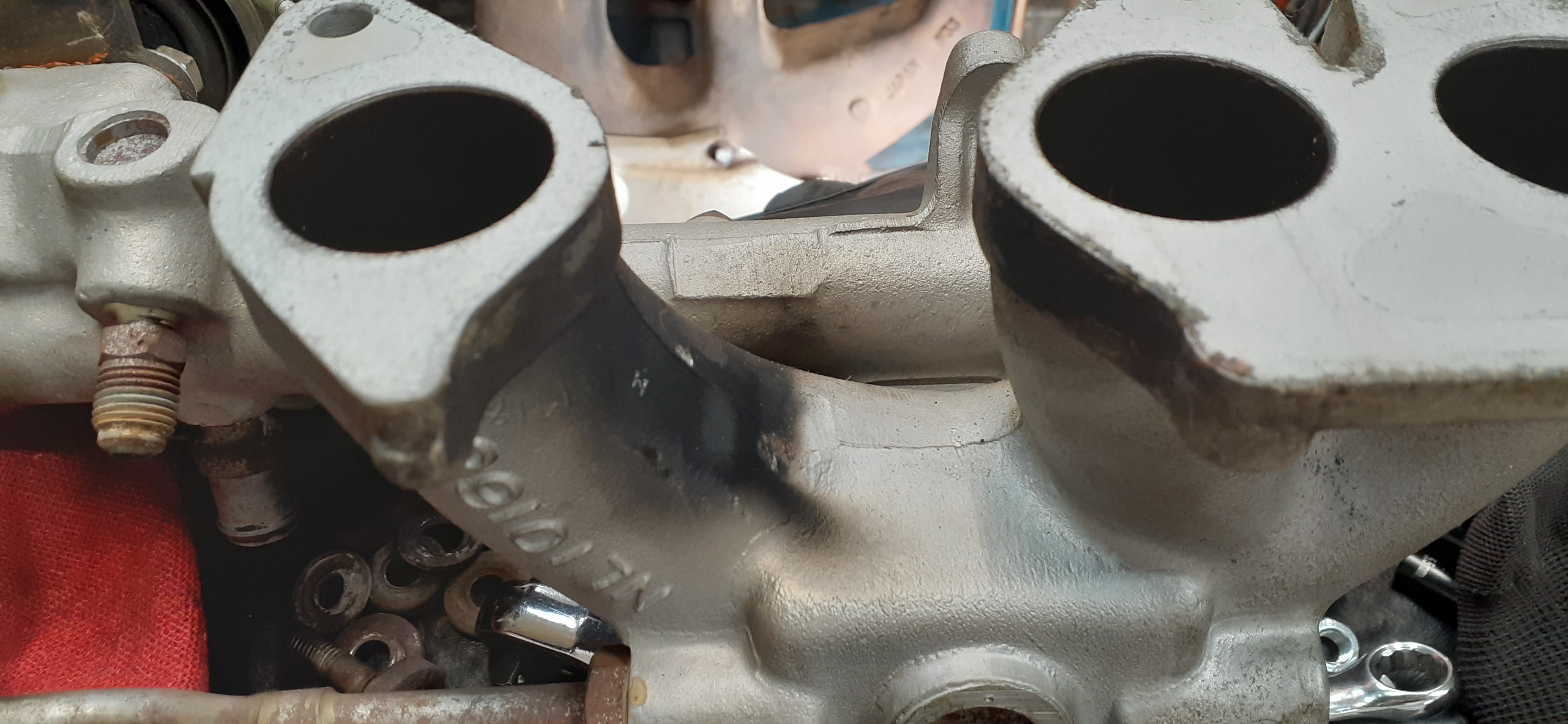

September 19, 20213 yr Author Popular Post comment_628706 I finally decided to replace the gasket for the intake & exhaust manifold today. I also found some clues as to why my previous effort to tighten the intake didn't work. Among other things, I got a really good view of where about 17 years ago I found that a stud was missing near the #6 exhaust. I just didn't have the skills back then to take things apart and put in a new stud. I also found the nut was missing under the #5/#6 intake runners. More on that later. I also had one stud around the exhaust come out with the nut attached. Fortunately, I had spare studs already on hand. After working everything loose, I removed most of the old gasket. I had to scrape off only a little remaining material. I thought it was clean enough for the new gasket. I worked the new gasket into place relatively easily. Before putting the intake back in place, I took a quick look at it. There was definitely an exhaust leak at #2. Also, there were signs of a leak below the #5/#6 intake runners. I did wipe it down a little. You can see the smears below the intake. Anyway, I got the intake and exhaust cinched down nicely, and the carburetors are back in place. Tomorrow, I will re-balance the carburetors since I hope I have rid myself of all of the leaks around the intake and exhaust. Link to comment https://www.classiczcars.com/forums/topic/65643-getting-the-73-back-on-the-road/?&page=5#findComment-628706 Share on other sites More sharing options...

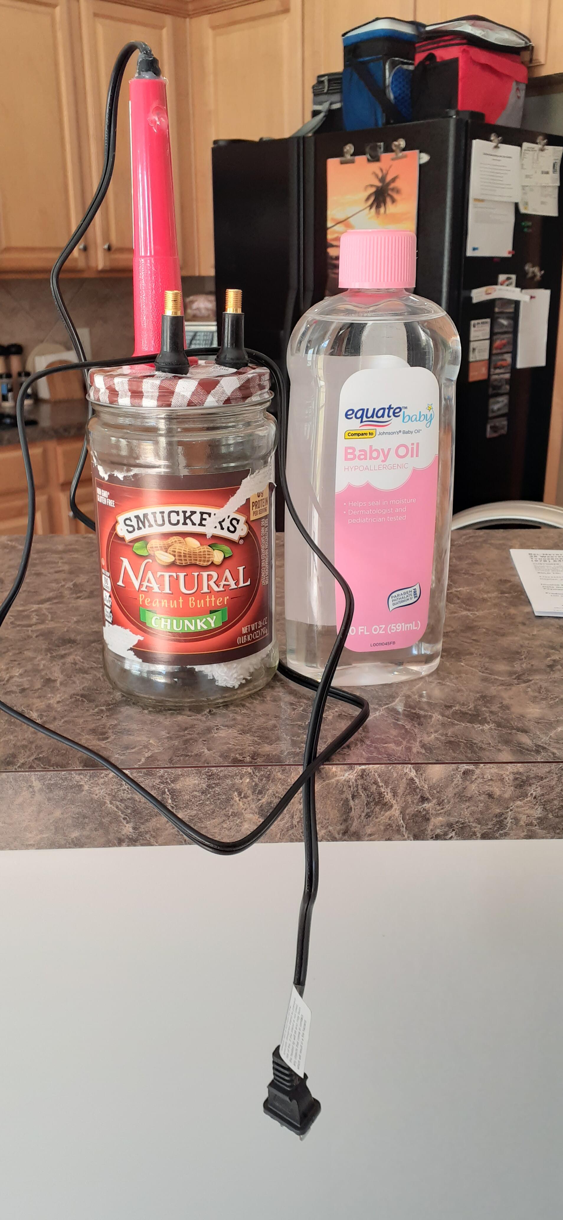

September 26, 20213 yr Author comment_629024 So, I thought I try some experimenting in the garage today. The wife agreed to join in, too. We generated some heat, and thanks to the baby oil, I found both holes. I felt very satisfied. Now I need to fill the holes. I'm man enough to do it. If I can't remove the old fittings, I'll probably use my cheap wire welder to fill in the air injector. Link to comment https://www.classiczcars.com/forums/topic/65643-getting-the-73-back-on-the-road/?&page=5#findComment-629024 Share on other sites More sharing options...

September 26, 20213 yr Author comment_629029 On 9/26/2021 at 10:11 PM, SteveJ said: Is there a different way of describing the use of a smoke machine to find exhaust leaks? I used this video as the basis for my design. I modified the design to use valve stems for the air inlet and outlet. I removed the valve out of the outlet valve stem. I also used a towel as the wick and soaked the towel with baby oil. I used 1/4 ID vinyl tubing from the outlet stem to the engine with the plan being to use a compression tester hose in the spark plug hole. I forgot that the compression tester hose had a one-way valve pointing the wrong way, though. That meant I needed a small length of 1/2 OD tubing to go over the 1/4 ID tubing. That provided a seal around the spark plug hole that was adequate for the task. With the cam holding open the #2 exhaust valve, I used the soldering iron to heat up the towel. The wife was good enough to operate the tire inflator to supply the air to push the smoke into the cylinder. It didn't take long to see the smoke pouring out of the holes in the air injector. Link to comment https://www.classiczcars.com/forums/topic/65643-getting-the-73-back-on-the-road/?&page=5#findComment-629029 Share on other sites More sharing options...
September 26, 20213 yr comment_629030 Great vid. Smoke is also a brilliant way to locate leaks in the body that allow exhaust fumes an ingress path. I learned this somewhere, but cannot recall to give credit where due. I've located several holes at the rear of the car that I was never able to find previously using this technique. Link to comment https://www.classiczcars.com/forums/topic/65643-getting-the-73-back-on-the-road/?&page=5#findComment-629030 Share on other sites More sharing options...

September 27, 20213 yr Author comment_629032 On 9/26/2021 at 11:03 PM, ETI4K said: Great vid. Smoke is also a brilliant way to locate leaks in the body that allow exhaust fumes an ingress path. I learned this somewhere, but cannot recall to give credit where due. I've located several holes at the rear of the car that I was never able to find previously using this technique. I can't take credit for the video, but I agree that it's great. Link to comment https://www.classiczcars.com/forums/topic/65643-getting-the-73-back-on-the-road/?&page=5#findComment-629032 Share on other sites More sharing options...
