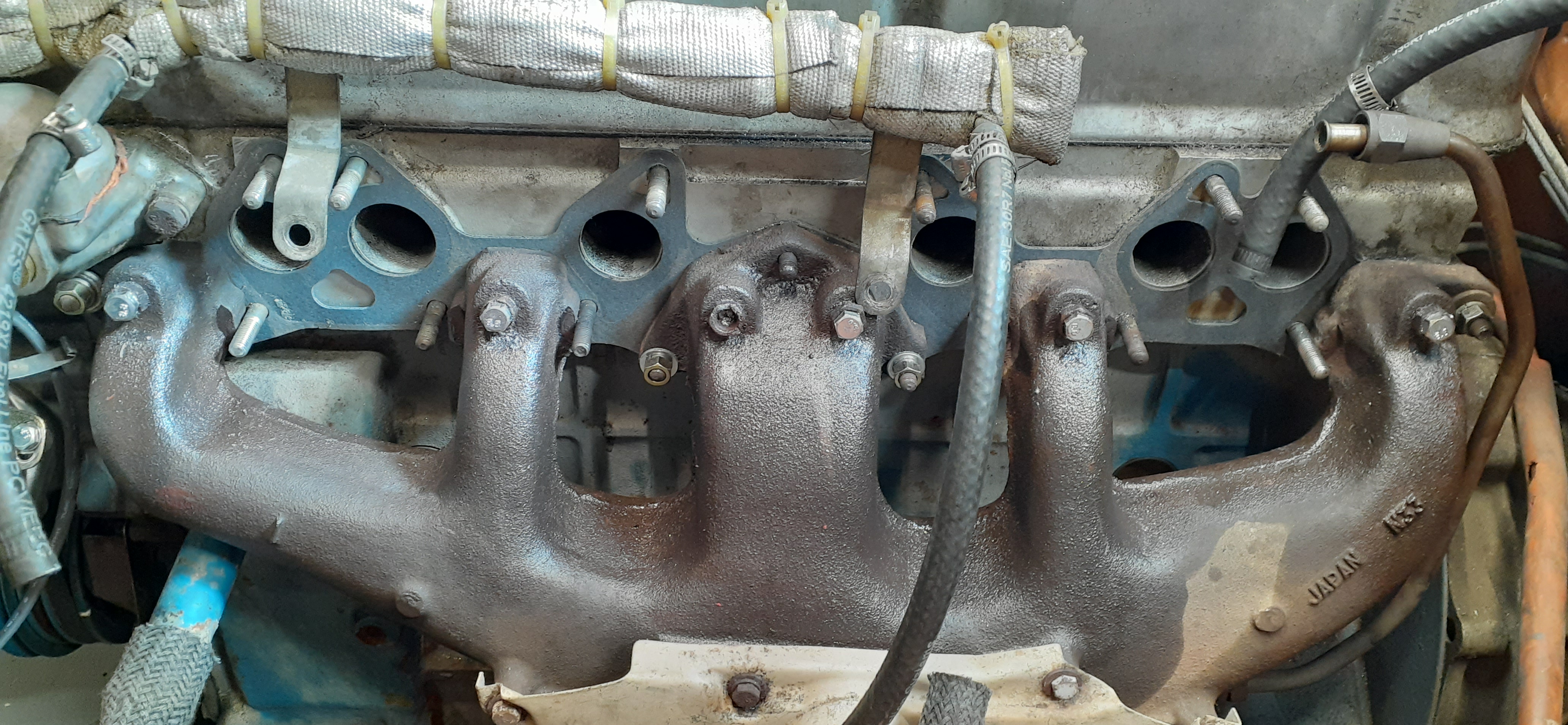

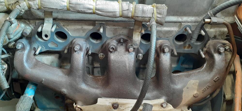

Today I pulled off the intake to address the exhaust leak.
I cut off the air injectors and proceeded to tap the fittings with an M7x1 tap. One bolt broke as I tightened it, but I think it's sealed. I'll find out with another smoke test in a little while.
It passed the smoke test. Well, there was smoke coming out around the gasket because the exhaust manifold wasn't bolted down where it shares studs with the intake. Anyway, I buttoned it back up, and I'll be testing soon to see if I hear anything that I shouldn't with regards to an exhaust leak.
