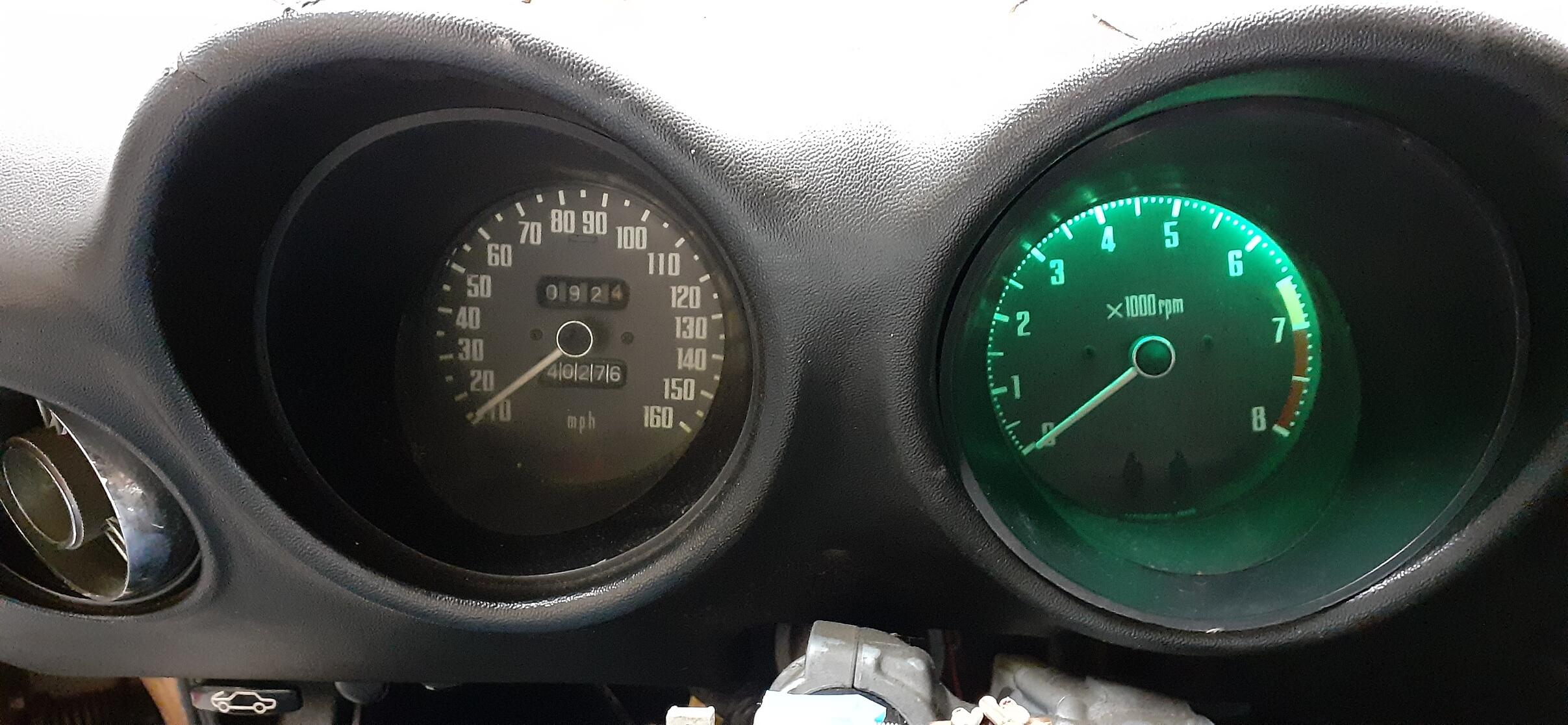

9 minutes ago, Captain Obvious said:
I'm impressed you were able to actually get all up in there and replace those bulbs without pulling the gauges. Good work!
Let us know tomorrow how your back and shoulders are.    :excl:
Trust me, I've made in a concerted effort in the last 2 hours to do a red-neck spinal adjustment on myself by twisting my back frequently at various angles.
I was definitely spent after all was said and done, though.

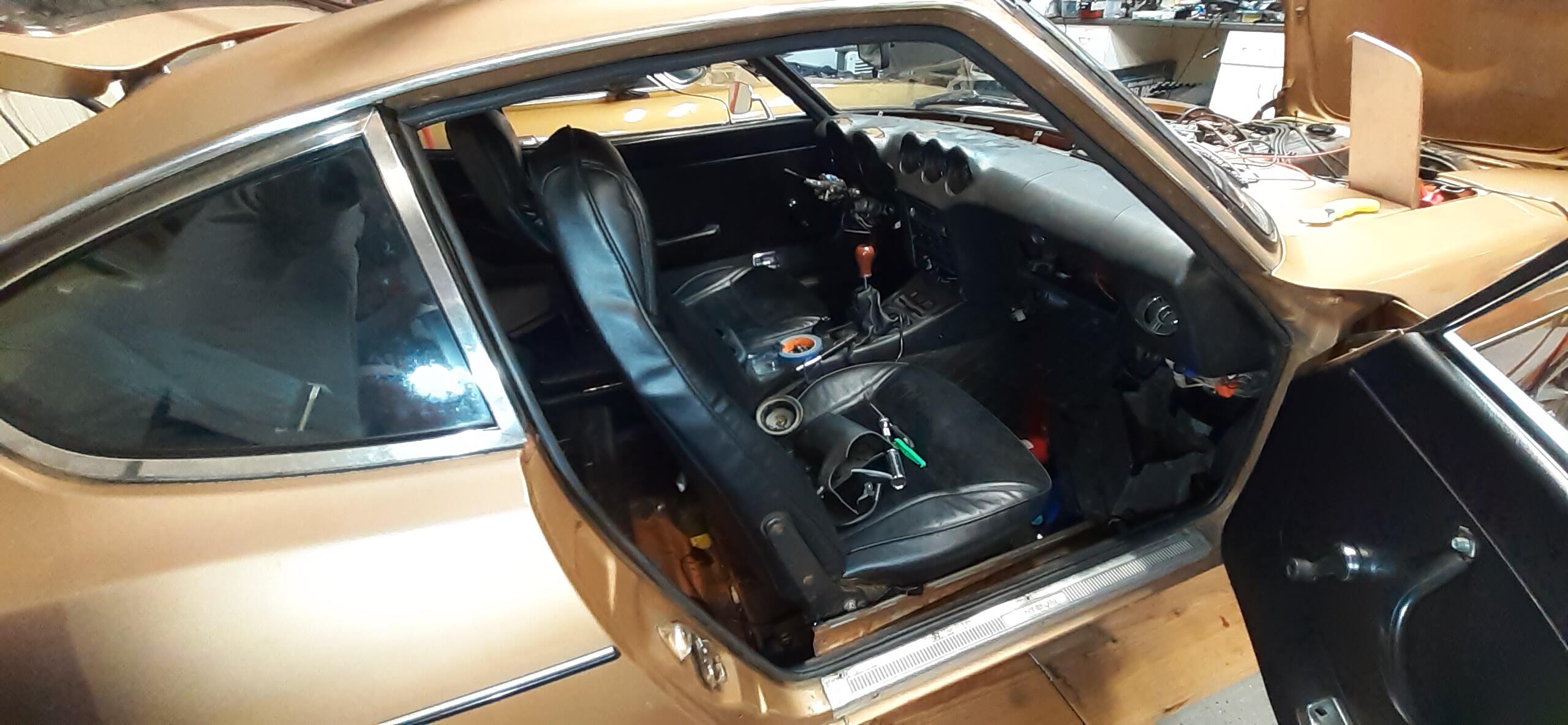

Good news! So far I'm upright and functional. My upper back is a little sore but none the worse for wear. I'll put the dash back together today and experiment with door weather stripping today. I have two similar types arriving today that bear a strong resemblance to the Kia Sportage door seals. That should be a lot easier than the gauges. LOL

So I got the seal for the passenger side today. I wasn't sure it would be thick enough when I did my first test fit, but I took the plunge and installed it on the full door seal. The door doesn't compress it much, and the door closes easily. I did use the top corner for the meeting of the ends. I got it just about perfect, too. Thank goodness.
Anyway, the door closes easily, and it doesn't seem to rattle. I'll take it on the freeway tomorrow to see.

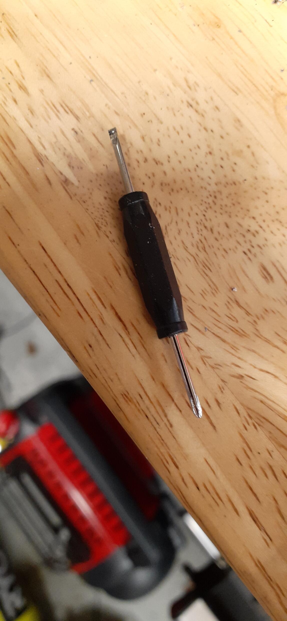

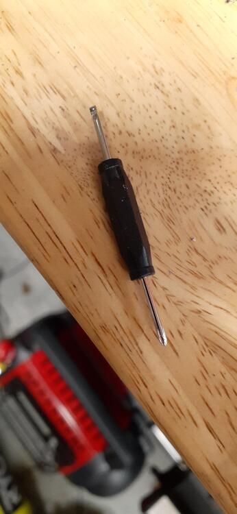

After that it was time to put the dash cap on. At first it wouldn't fit right. Then I remembered that I needed to remove the knob for the hazard switch, first. After that, the cap fit just right. As I fiddled with the lights, I noticed that the headlights were not coming on all of the time. There is an issue with the switch. At least I have a good stock of switches. The first switch I grabbed had a bad 9-pin connector from overheating on the parking light circuit. I replaced the connector, and I found this little screwdriver did a better job releasing the pins in the connector than the de-pinning tool.

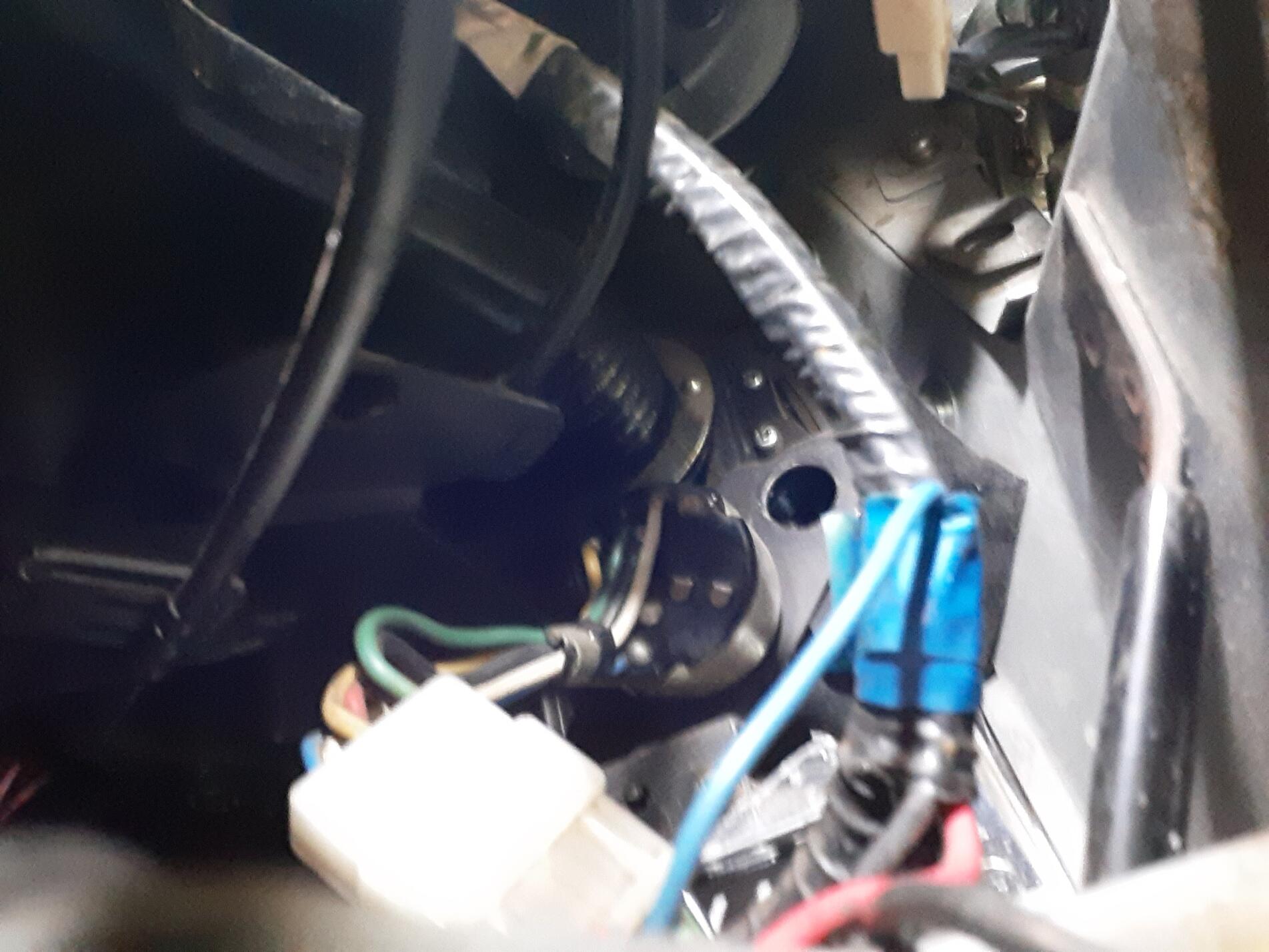

Well, I was going to put some miles on the 240Z today, driving over to a guys shop to see his GTU prepared 240Z in BSR livery. I got in, turned the key, and the engine wouldn't fire. I made sure it had fuel and tried again. I tested for no spark and confirmed. I then tested for voltage at the coil - nothing. Well, I figured it probably had something to do with my work from a couple of days ago.
I took the 260Z instead and enjoyed looking at the GTU 240Z. The owner went over the car in detail, and I look forward to seeing at the track at the Mitty in April.

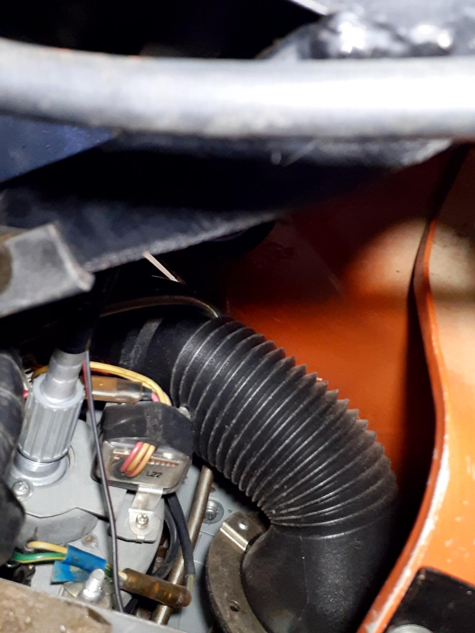

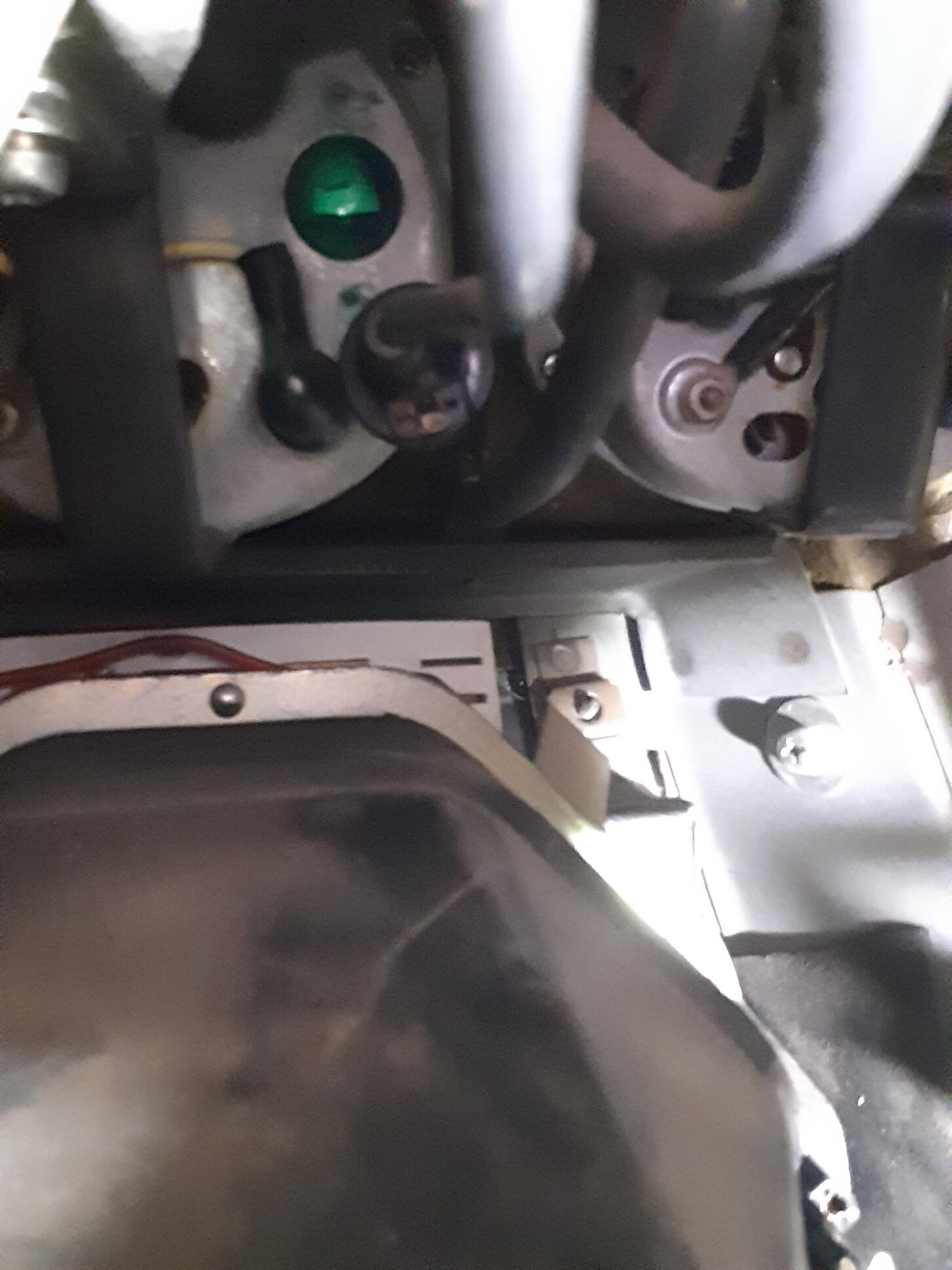

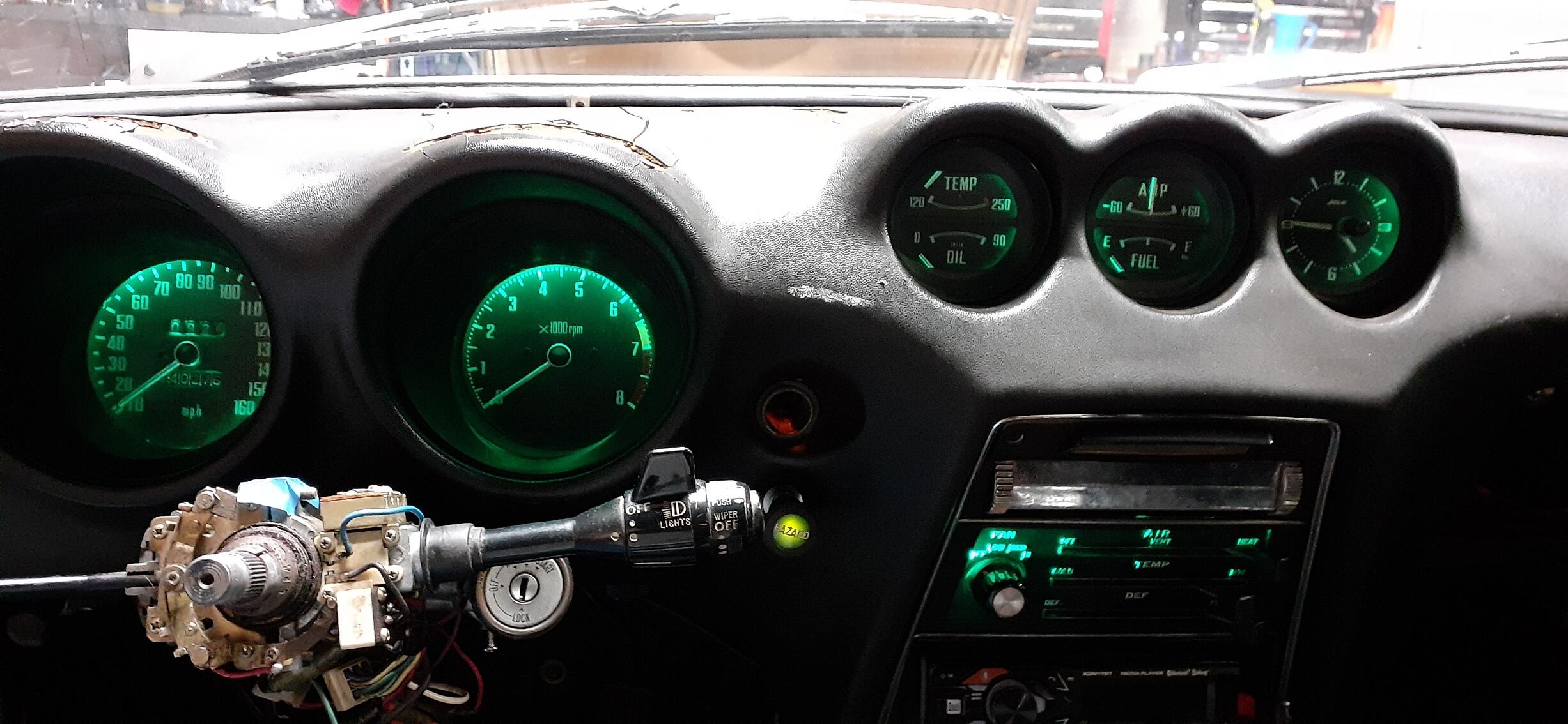

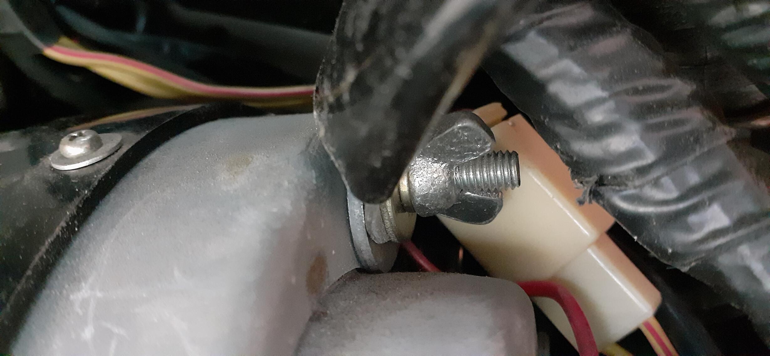

When I got home, I tested for continuity between the black/white at the coil and the green white - open line. With my suspicions confirmed that it was at the tach, I went to work. First, I tried the shortcut - blindly feeling behind the tach. I could find the connector on the back of the tach, but I couldn't find the connector on the dash harness. Okay, pull the gauge. Since I have the dash cap (not glued down fortunately), I went through the process of removing it. As I reached behind the tach to get the wing nuts off the back, I noticed that I pulled the turn signal lights away from the tach. I also found I pulled loose the wedge bulb that lights the cigarette lighter and hazard switch. Not only that, I noticed bits of plastic falling that I could tell were from the socket for the wedge bulb.
After getting the tach connected, secured, and lit with dash lights and turn signals, I took on my next distraction. I didn't like the how my electronic flasher relay was working with the LEDs, so I got out one of my EP34 flasher relays, added a ground wire to it, and plugged it in. It blinks faster than I would prefer, but it does click, giving it an advantage over the other flasher relay.
Now it was time to turn my attention to the decaying wedge socket. I have some replacement wedge sockets, so I grabbed it and tried to fit it into the housing where the old bulb socket resided. I couldn't do it with the housing in place. Anyway, I also noticed the old bulb had a connector in the dash harness. It was a 3 pin stacked 2.8mm connector. "Great!" I thought, "I have plenty of those." And with that, I wired up the replacement socket to a male three pin after verifying I knew the polarity of the new bulb/socket. Then I went to plug it in, and it wouldn't plug in. At that point I compared the old connector to the new and noticed they were ever so slightly different. That meant I had to de-pin both connectors so I could use the new socket with the old connector. Then it was time to put the socket into the housing. I took the optical fibers off the housing and removed it from the dash. I ended up modifying the socket and housing slightly to get them to work together. Then I tried to put the optical fiber back on...only to find I needed the housing mounted to the dash to have the leverage to put the optical fibers back in. To keep this shorter than a Tolstoy novel (at least by a little), I finally got it all back together and working. At that point I quickly put the dash back together.

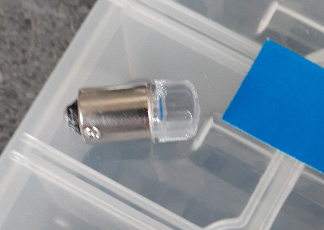

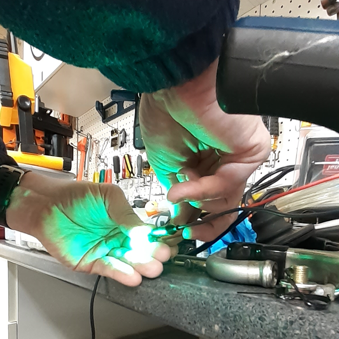

  2. I found the 1157 bulbs in front and back failed and were cross-feeding. I was seeing signs of that last night, but I realized the problem and confirmed my diagnosis today. New 1157 bulbs are on order front & rear.
What were the symptoms I saw? Well, first, I saw the heater panel illuminate with the turn signals. I thought it was just stray light. Then I noticed the same thing happening with the brakes. I removed both the front and rear bulbs from the driver side and tested the turn signal on that side. The cross-feed was gone. (And, yes, these were 1157 bulbs with 2 contacts and oriented properly.) I took one of the bulbs and a spare 1157 socket over to my power supply. When I applied power to the brake lamp circuit on the socket at around 13VDC, I could see 12 on the positive wire for the running light circuit. Dang Chinesium electronics! Anyway, I ordered some red 1157 made by the same company as the H4 LEDs I'm using. The new 1157 ambers are from another company since Auxito doesn't sell amber 1157 bulbs on Amazon.
