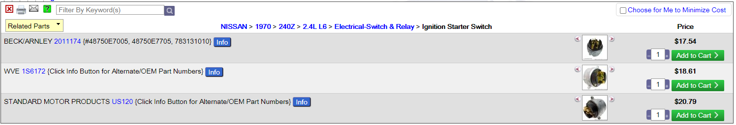

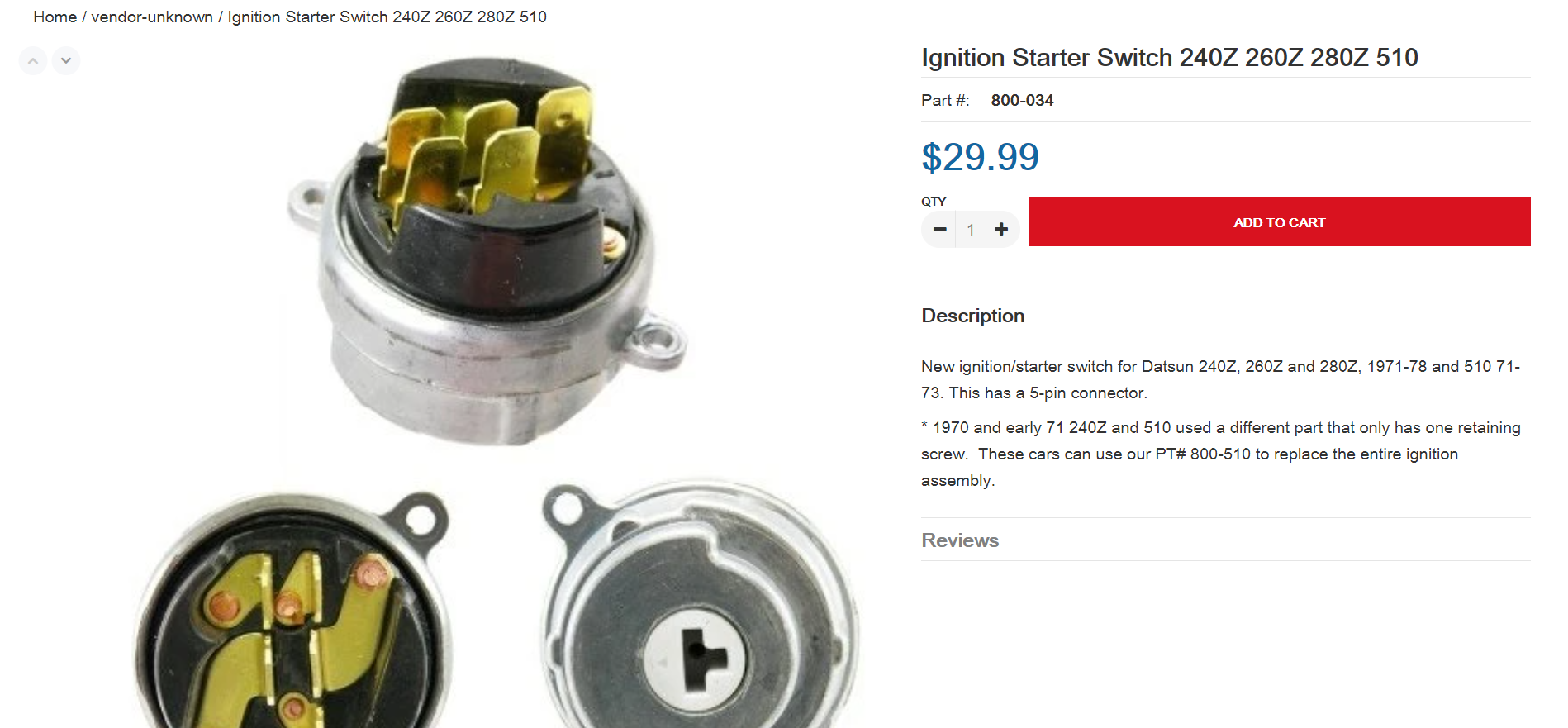

July 29, 20213 yr comment_625909 https://www.rockauto.com/en/catalog/nissan,1970,240z,2.4l+l6,1209147,electrical-switch+&+relay,ignition+starter+switch,4700 https://zcardepot.com/products/ignition-starter-switch-240z-260z-280z-510?_pos=2&_sid=8b6530aba&_ss=r https://zcardepot.com/products/ignition-switch-with-keys-240z-260z-280z-510?_pos=2&_sid=6af94aebf&_ss=r Of all of the lights, only the turn signal switch power goes through the ignition switch. Based on what is on the Z Car Depot listing for the part, you may want to get their 800-510. It's up to you. Link to comment https://www.classiczcars.com/forums/topic/65650-intermitent-start-and-no-turn-signals-when-it-does-not/#findComment-625909 Share on other sites More sharing options...
