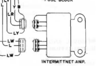

You should see power at the plug.  Any chance you disconnected the intermittent amp?  That's what controls the power.  I think it's in that area where you were doing all of your relay work.

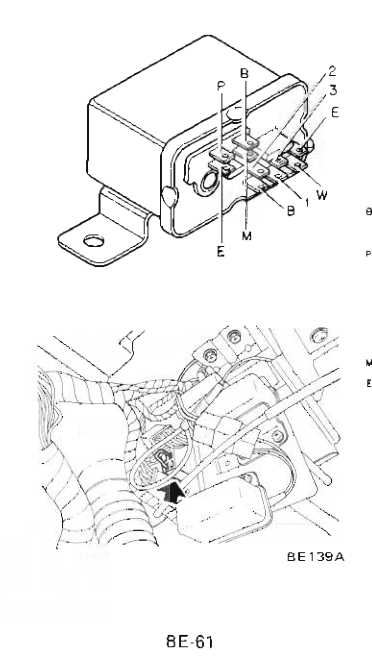

i can also check if i undid the intermittent relay by passenger foot area....

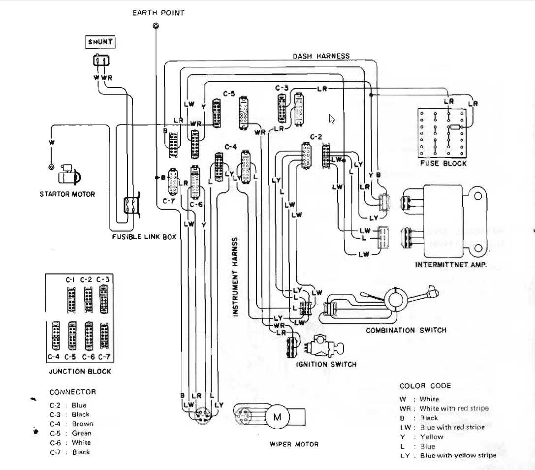

They get power depending on where the switch is, I think.  There's slow, and fast, and park.
Find the pin on the motor that matches the B wire and that would be your ground.  Ground that pin and apply power to the other pins and something might happen.  I'd work through the diagram and description and pick a pin but that would be work and it's Saturday.

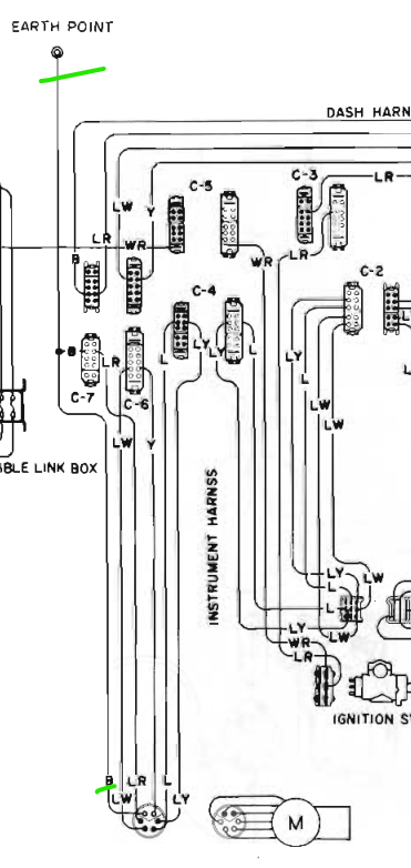

Here is the FSM for the Body Electrical of a 74 260. And the picture that tells most of the story.
LR is power the motor, B is the ground and you ground either L or LW to get low or high.  LY has something to do with the park function.
