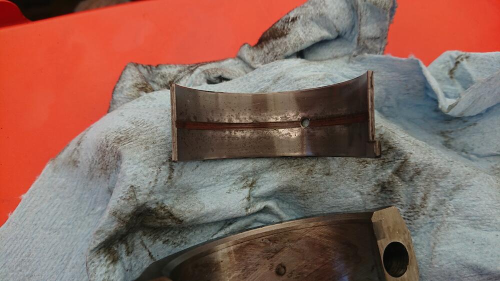

I removed the oil pan to have a look at the big end bearing on cylinder 3 and check the end float (I was worried about piston slap.)
No metal shavings or anything shiny looking.
I wiggled all of the other big ends while I was at it, and number 4 also moved a bit more than the others, although checking with a feeler still under .3mm. It's an L28 block.
So I removed number 4 and noticed that the bearing had a groove down the middle unlike number 3.
From pictures in the manual, I know that main bearings have that groove and big end bearings are smooth.
Would this cause an issue?
Side note: It was a blown exhaust manifold gasket causing the noise on cylinder 3 that had me worried.

8 minutes ago, siteunseen said:
If I remember right that groove is an oiling feature.
Why I am a bit concerned is that it seems like a feature of the main bearings and not rod bearings.
Any product image I see of rod bearings show them smooth:
3fff6dbc94f7472307cfedbcf0d8553a_600x.jp
It always amazes me how durable and forgiving the L Series Motors are. I’ve pulled engines that have the wide main bearing inserts mixed up with the narrow main bearing journals etc., but to no detriment. My guess is that you’ve got a rod bearing on a main and ended up with the main bearing on number 4. If the engine runs good and no oddities like oil usage, leave it alone........unless you want to pull the motor and replace all the bearings, I’d run it like you stole it! The important bearing is the center thrust bearing......its hard to mix that one up LOL.
19 minutes ago, DuckManNK said:
Might have to replace it..
What does the journal look like?
If I found a bearing that looked like that, I would pull all the caps off and have a look at them all.
